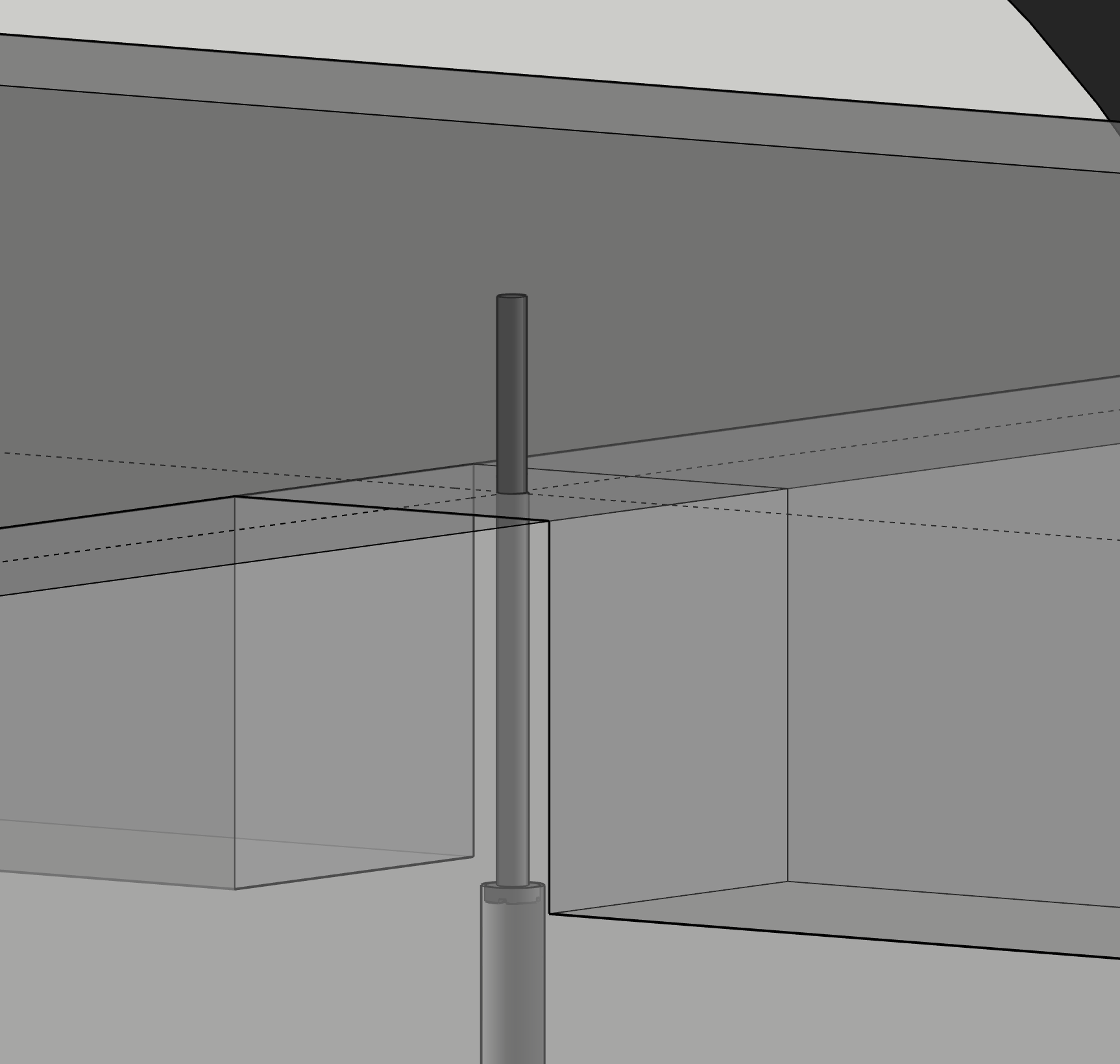

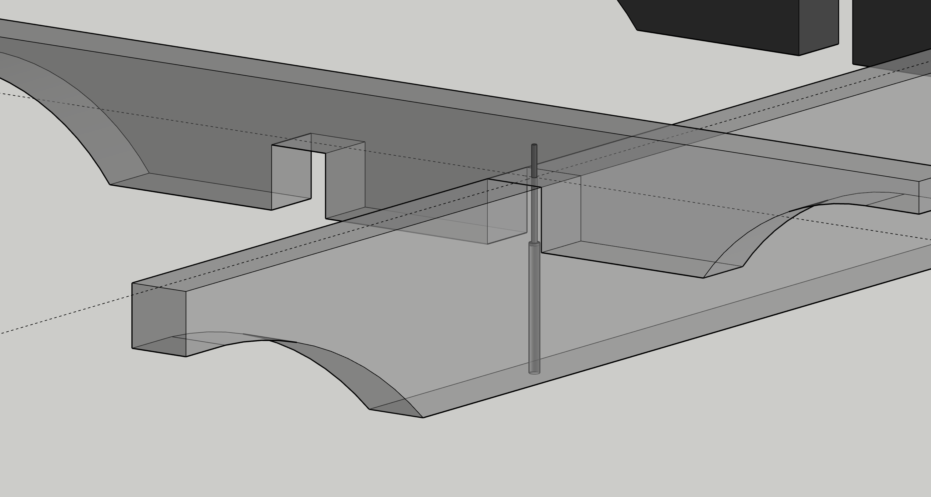

So for fixing 2 to 3 are you suggesting something like this where I drill a hole then a deep counter sink? Then I could use a stainless steel screw 75mm long.

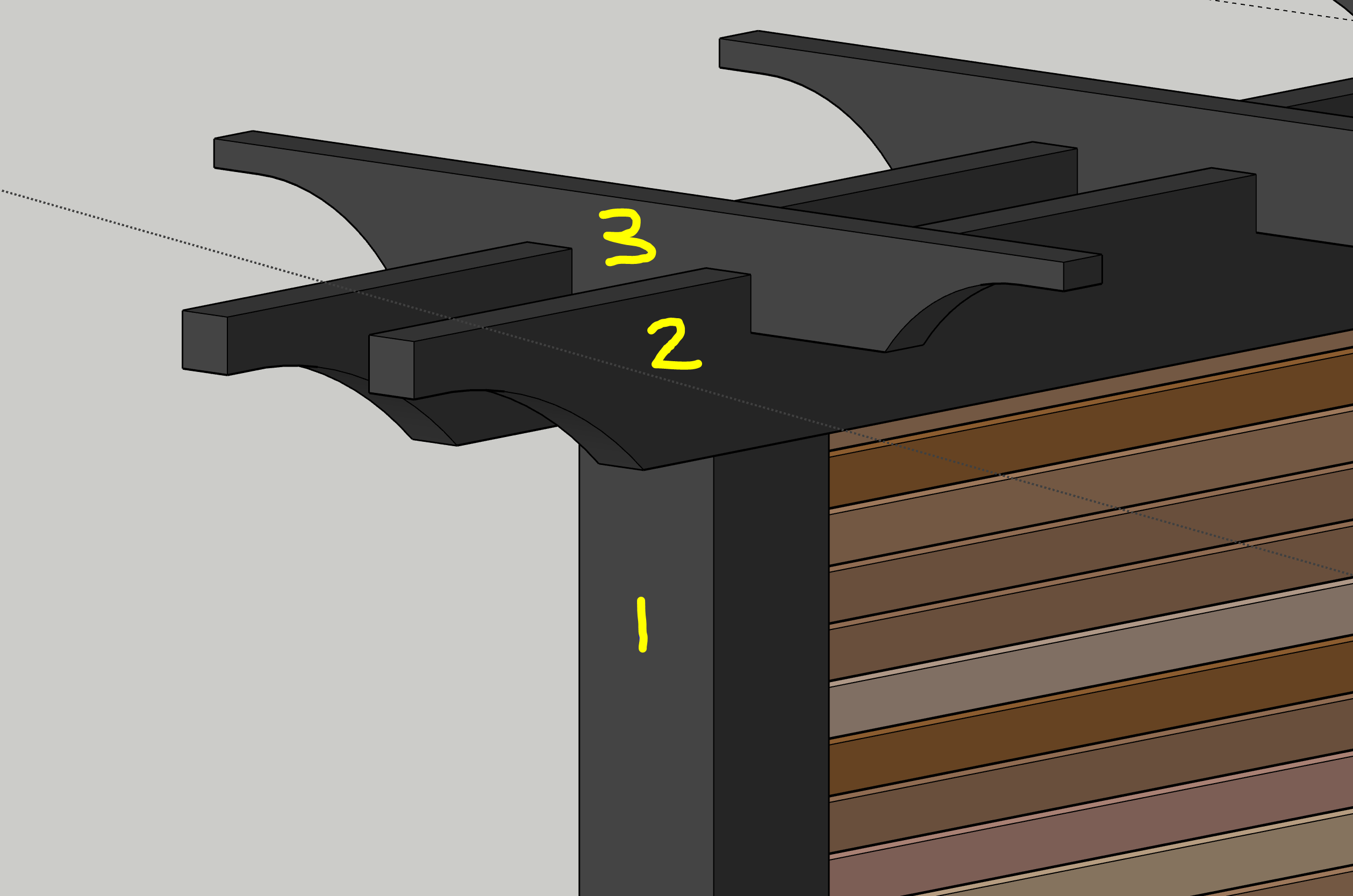

Sloping is possible. Maybe I can set up my circular saw with a fence to do it. How crucial would you say sloping is? The upright posts is fairly straight forward. Also joining the decorative rafters is not as straight forward as screwing 3 into 1 as the rafters are also between posts so I will have to screw 3 into 2 somehow. What about pocket screws at an angle?

Yes I’m an avid follower of Robin and did see his Oak work. Looked lovely. Would be nice to do something like that but time is not my friend at the moment. Interested to how I could achieve something similar to what I’ve got with dowels alone?
Nice ideas. I especially like the recessed screws with dowels. I will have to move the position of 3) as at the moment it is situated directly above 1). Also sloping 1 is a good idea.

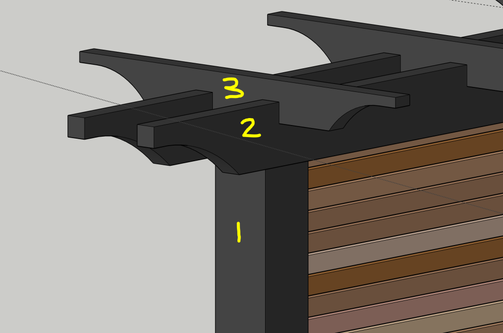

Hi, I've bought some Eurpoean green oak timber and am now thinking about the best way to fix the crossbeams (2) to the 150 x 150mm posts (1). The decorative rafters (3) on top will also need fixing. I know normal screws/bolts will rust so I should use stainless steel. Given the assembly I don't think dowels are an option. Any ideas or recommendations? Many thanks, Ed

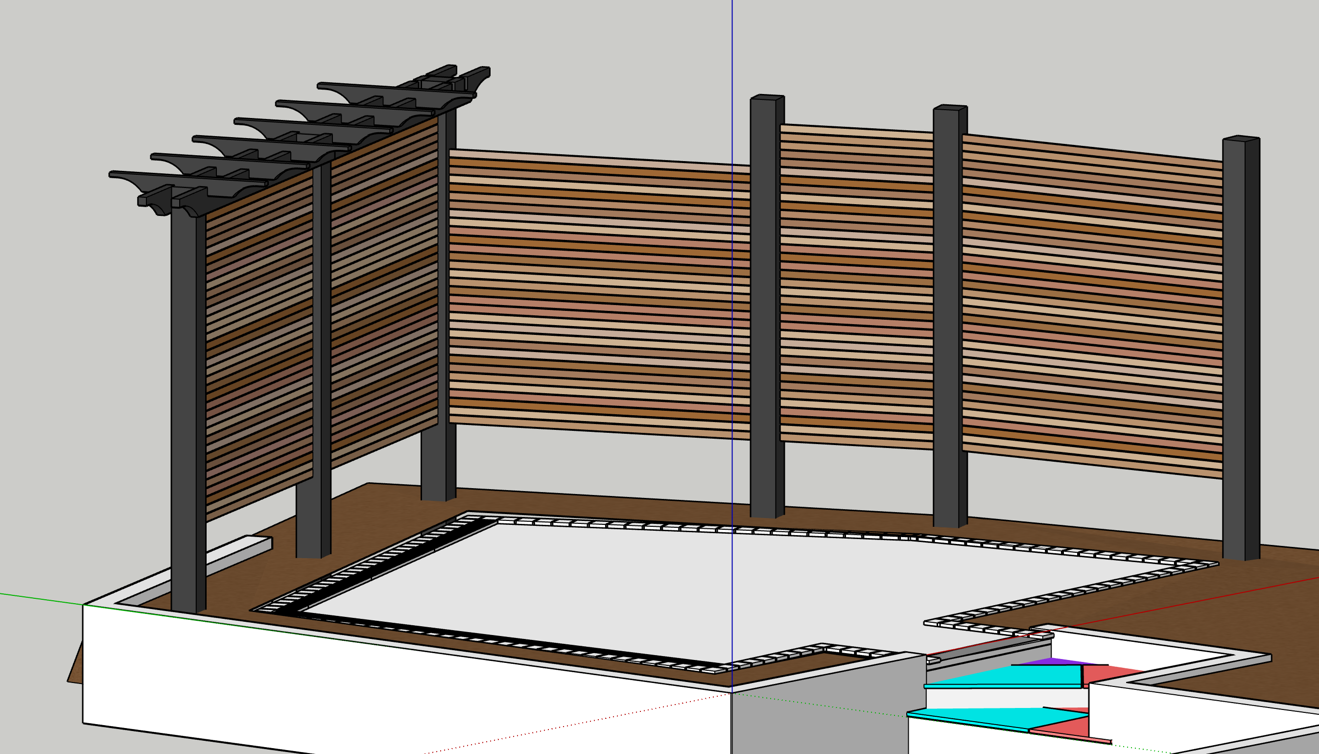

Hi, I now have a design for the screen structure (see image below) that I want to build in the corner of the garden. I've been trying to find the planning rules for this type of structure but cannot find any. Can someone point me in the right direction please? I have found lots of different bits of info regarding max height etc but nothing definitive from planning portal website. If someone could provide a link to the definitive info that would be great. Many thanks, Ed

Hi everyone, I’m mulling over pergola design for our garden. Still haven’t decided exactly what we want but one design is basically an L shape around the patio area. I was going to secure the posts into the soil with postcrete, like a fence post. Then we’ll be able to plant climbers that climb up the pergola (see photo) However, I’m now thinking a more convention pergola might also be good as it will provide more shade - square, 4 uprights type thing. With this there is potential to secure to the patio. I haven’t actually laid any slabs yet and if we do go down this route I’m guessing digging out where the posts will go and filling with concrete will provide the best foundation for the posts. Or is securing to the patio OK too? Any recommendations would be good. Is there a good guide on the internet. Something similar to pavingexpert? Many thanks, Ed

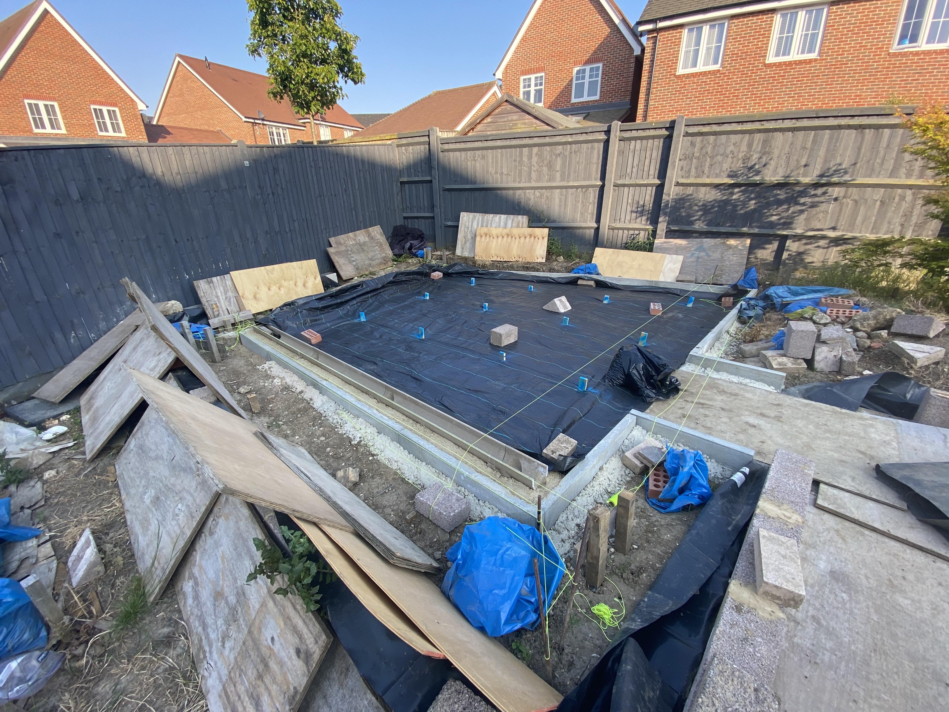

Thanks for the comments everyone. It was mainly to stop weeds but I hear what you’re saying jfb, the mortar and slabs should do that. Being a complete newbie I was just going by advice I read on the pavingexpert website. Anyway, I’ve put the fabric down and knocked some pegs in. Off to San Diego tomorrow but I’ll put the MOT type 1 down when I get back. Only taken me 3 years to get to this point. 😂 my wife loves me. 😂 -

It’s not holding it in place which is the problem it’s that I want to hammer legs into the soil to show me what level to apply sub base to. -

Hi everyone, I’m going to be laying sub base for the patio soon and have woven geotextile fabric to put down beneath it. Ideally I’d like to knock in some pegs at the required sub base height at various points to help me gauge levelling etc but that will mean the fabric will have holes in it. Is this OK? Any thoughts/guidance appreciated. cheers, Ed
