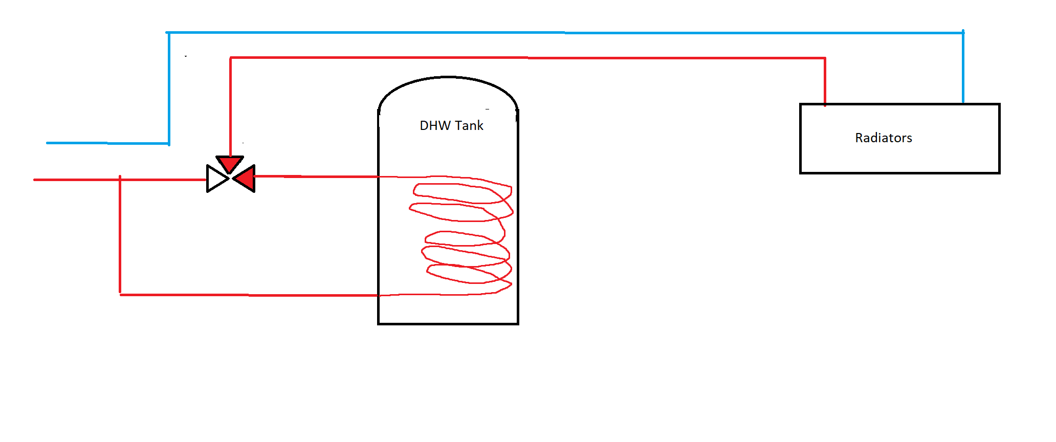

I meant you ask the pump to make 40 degrees to the flow pipe feeding the central heating, meaning it'd actually be higher than that because of the heat loss through the cylinder. I think @sharpener is right though and it wouldn't really work, there likely wouldn't be enough of a drop at those temps, or if there was the heat pump would probably need to be oversized.
Well my thinking was it only needs to go through the tank when the tank needs to be topped up, and then can service the rads with the lower output temp at the same time meaning you don't have to choose between heating and hot water. Could just set it up as a zone valve aiming for 40 degree heat temp etc, itll lose the heat in the cylinder.
There's only one path in this scenario. Valve changes back to only doing the rads. Yeah, I'm assuming the minimum you would want to be putting through a heating coil though would be around 50C, even a 15C drop across the coil would probably still be useful in the rads no? Yeah, I'm not sure how much resistance a cylinder coil would add to it, presumably that could be overcome with a suitably sized pump though. I was also thinking if you monitored the flow temp after the DHW circuit, the heat pump would overshoot automatically and heat the water as a biproduct of making X flow temp for the radiators.
Any reason you couldn't plumb a hot water tank in series with the radiators? Would make sense to me given you normally want a higher flow temp through the tank than the radiators themselves. Crude diagram below
