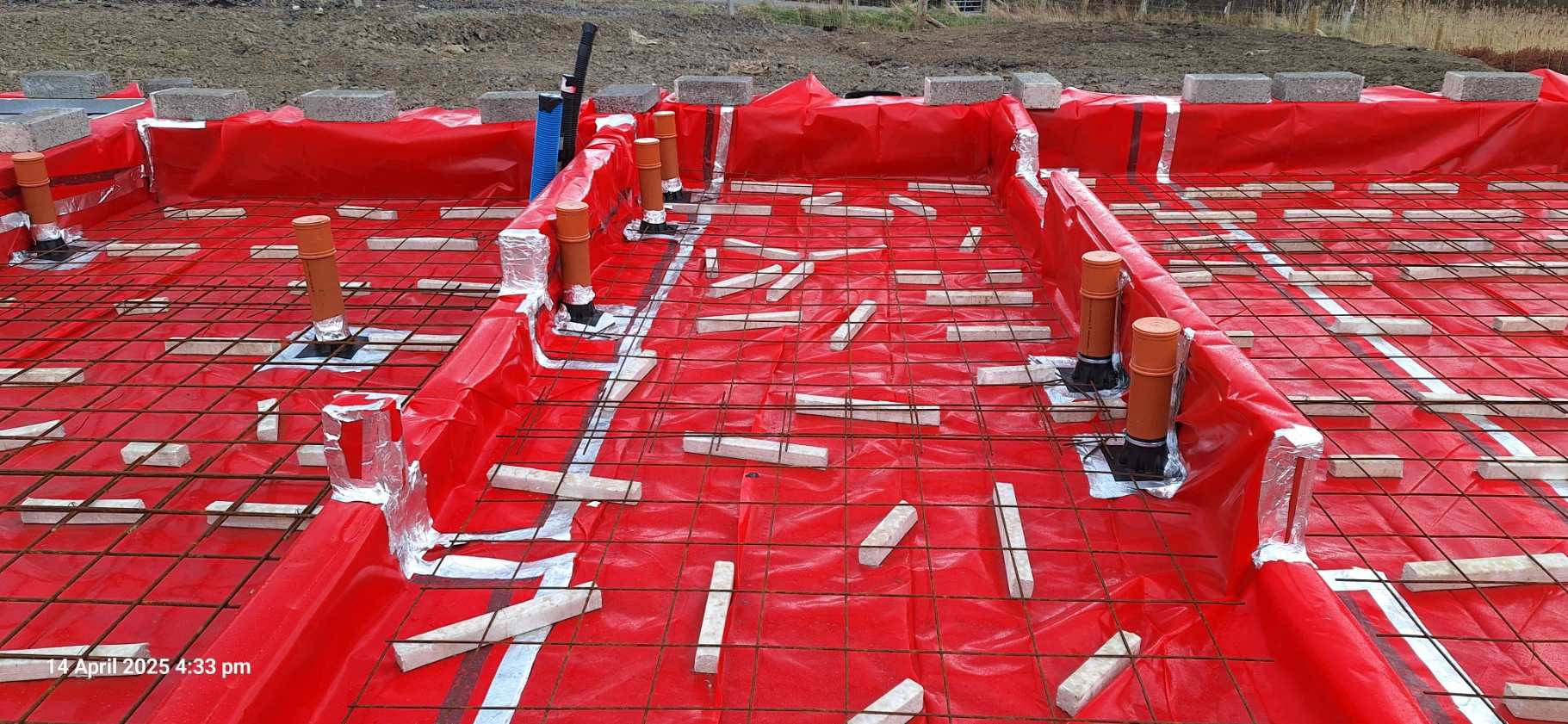

  1. Another MBC build here. No soil stack through the roof (have a separate branch outside to do the venting bit and an air admittance valve at the top of the stack internally to do the anti-vacuum bit. Is that an option for you?). However, as Nick above, we have MVHR ducts and terminals penetrating the inside membrane in the upstairs ceiling (i.e. the airtight layer). Brendan taped them all up no problem at all and the building achieved 0.3 ACH. On that basis all you would need to worry about is your roofer getting a watertight (rather than airtight) seal on the outisde.

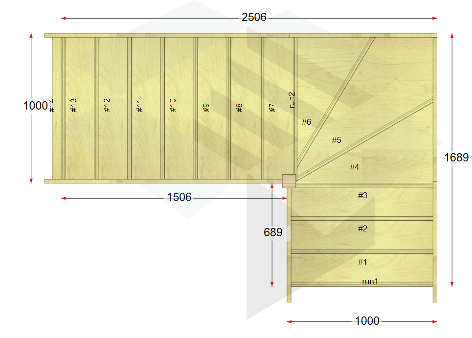

  8. Yes was hoping to install the stairs myself.... Yes, stud walls are full height and already in place because they are structural racking. Only the stub wall is not structural. I suspect that one at least will have to come out. I'm reassured that I haven't missed something obvious!

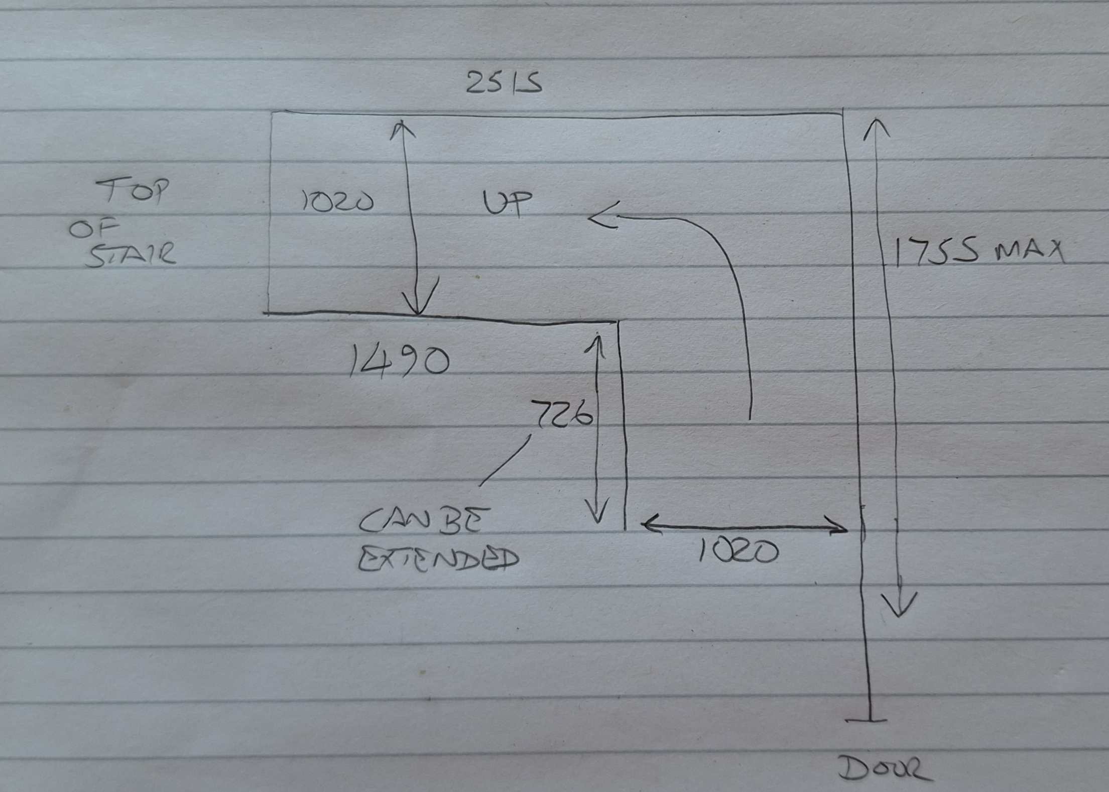

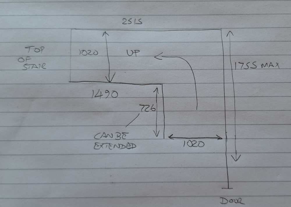

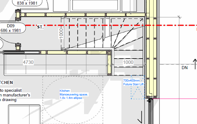

  9. I need help understanding how a winder staircase can be installed in a fully-enclosed stairwell, please. CAD drawing shows the as-measured openings between stud/structural walls. Architects plans for context also attached. Stairbox have suggestd an over-stringer width of 1000mm which in principle fits with 20mm tolerance. However, the newel post at the inside corner of the winder overhangs the stringer by 29mm which means it doesn't fit between the walls. They suggested trimming back the studs on the inner corner to set the newel post into the wall. But I can't see how the stair would be constructed and inserted into the available opening as the newel post would have to pass all of the other studs first if the upper run is installed from the first floor with the post attached (which I belive is how it's usually done?).

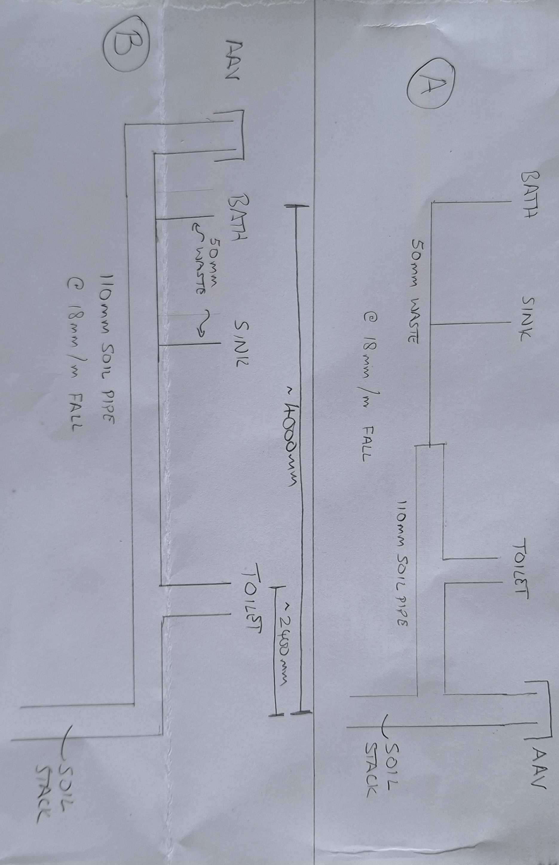

  12. To be clear @Nickfromwales whichever scenario is used, the soil stack and AAV (and everything else in the drawings) are indoors on the first floor - the soil stack does not penetrate the ceiling or wall here it just drops to below the slab and exits there. Hence the requirement for the AAV inside to let air in. Gas venting is outside. Access not a problem as this is all in a service coomb behind a false wall. Does this change your view of Option A?
  13. In the upstairs bathroom I have bath, then sink, then toilet running "horizontally" (18mm/m fall) into the vertical soil stack. I need to install an air admittavce valve for the stack. Venting is provided separately, outside the house. If I install as in (A), in the highly technical drawings below, is there risk that the bath and sink would be vacuumed by the toilet flushing? Would (B) be a better arrangement?
