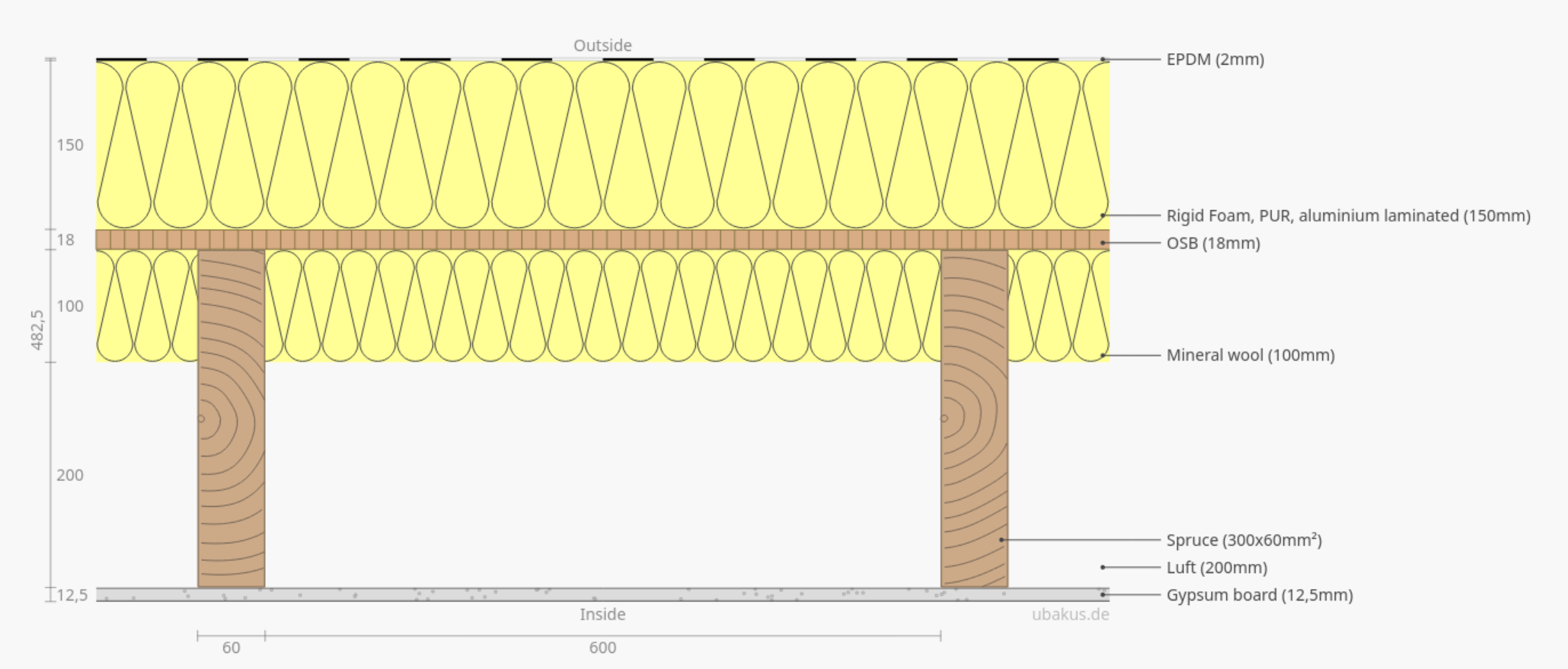

  7. There is an increased chance of condensation in the internal wooden structure with a so-called hybrid roof, as moisture can travel through the mineral wool and the wood is now cold (as it's in the middle of the insulation temperature gradient). This contrasts to a warm roof where the wood is warm so there cannot be condensation, or a cold roof where there the moisture barrier should stop condensation, and it's ventilated. There would be no way for the moisture to escape your roof except the same way it got in - back to the inside in summer when the thermal gradient works the other way around. However, looking at your particular insulation thicknesses, it doesn't look like condensation is actually going to happen - see attached screenshot.
