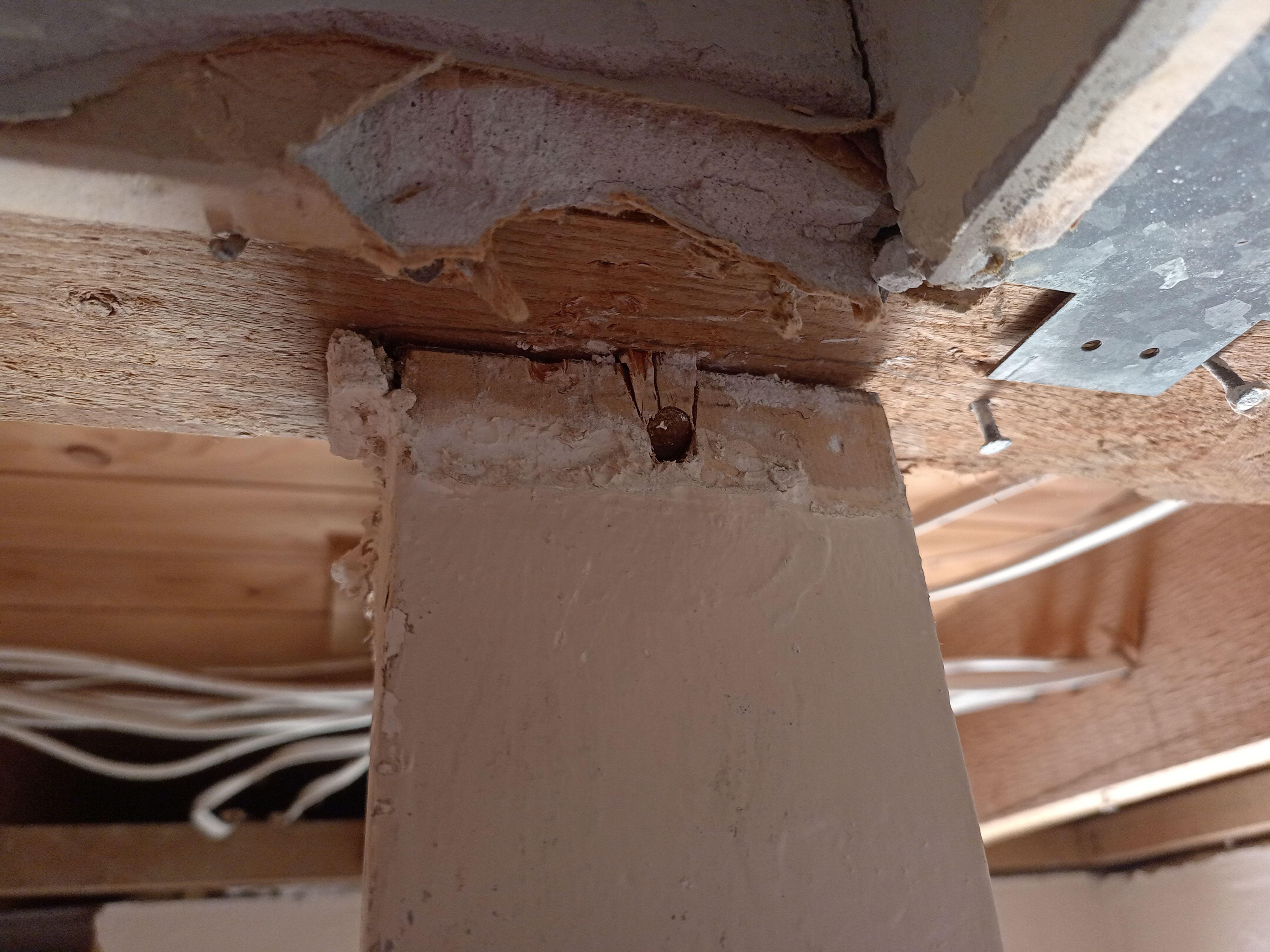

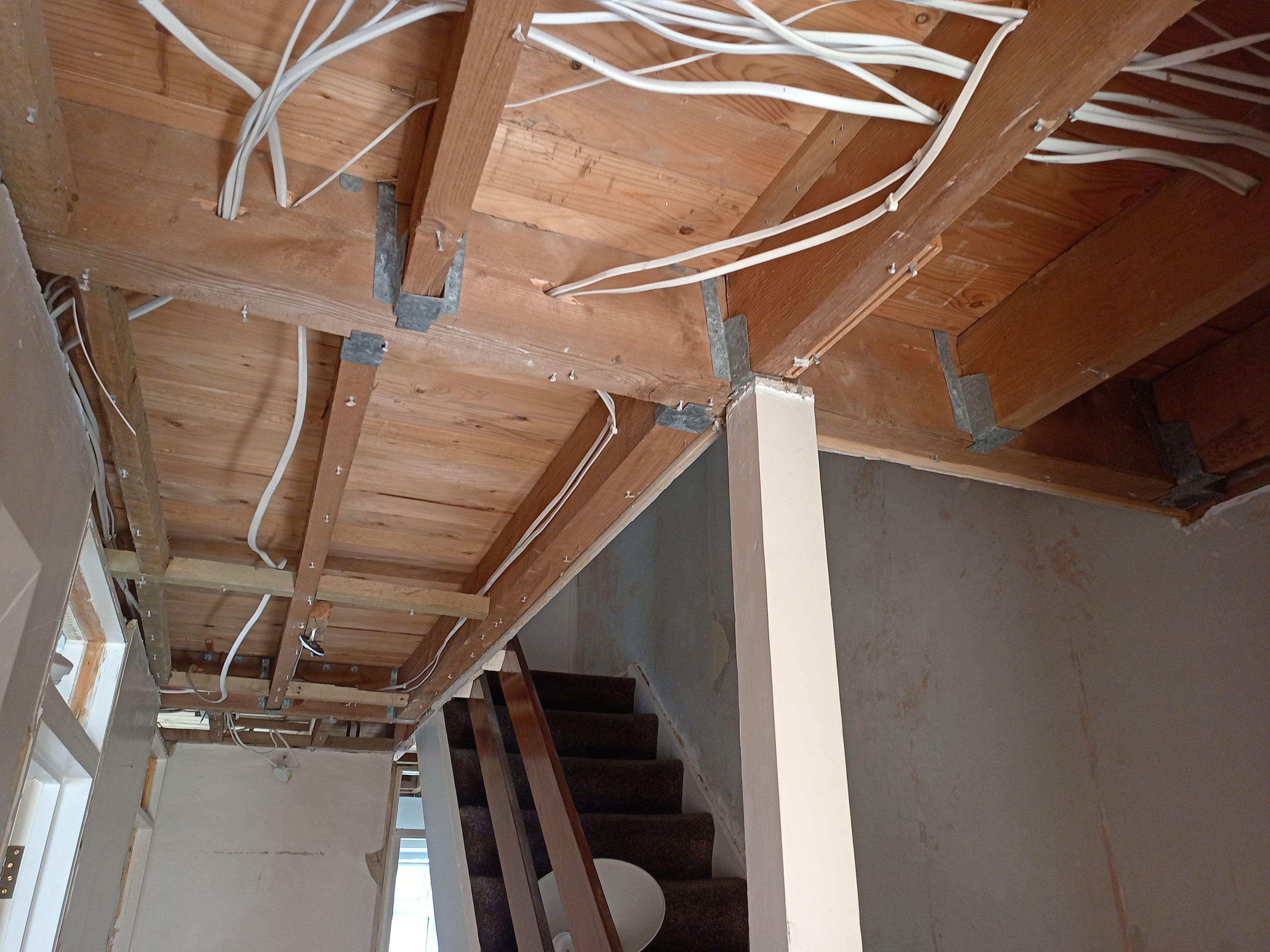

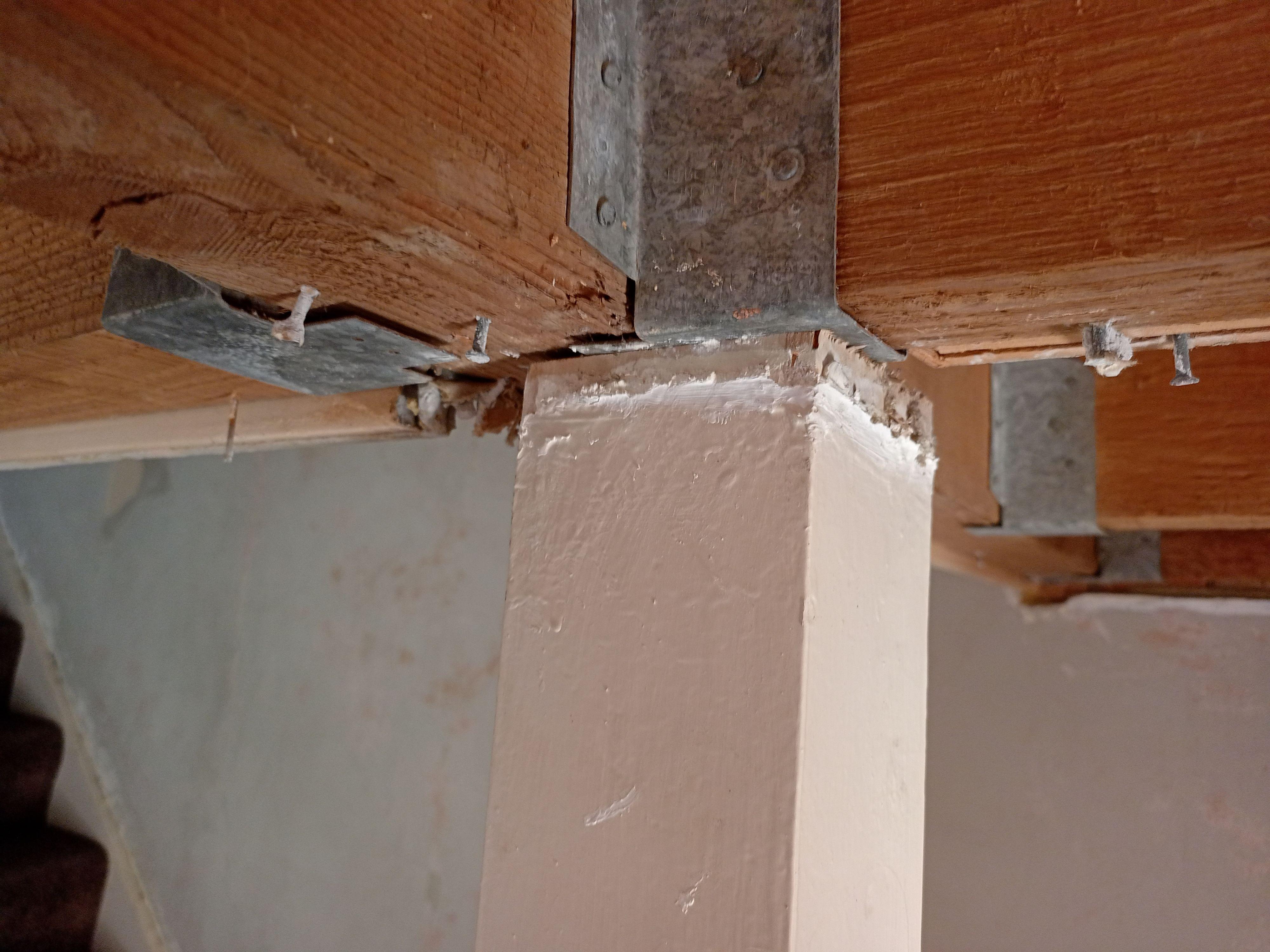

  8. Thank you both for the input. The acro idea is a good shout. The horizontal joist in the 2nd at both ends is supported. On the left is a wall and the right it's on a heavy duty hanger that's toothed into the party wall. It's just the hung joist front to back that also bear weight adding to it. If there's any doubt I will consult a SE before 👍
  9. Hello, undertaking major refurb work and one of the things I want to do is cut down this ugly newel post. Property is 70's build ex local authority. The rh wall is the party wall and the lh wall is load bearing. Directly above the newel post is a bedroom cupboard built with thermalite blocks and a blockwork banister that will be demolished. Is there any chance this is load bearing or just there for handrail support? It's 4" held in place by a single nail. Many thanks
