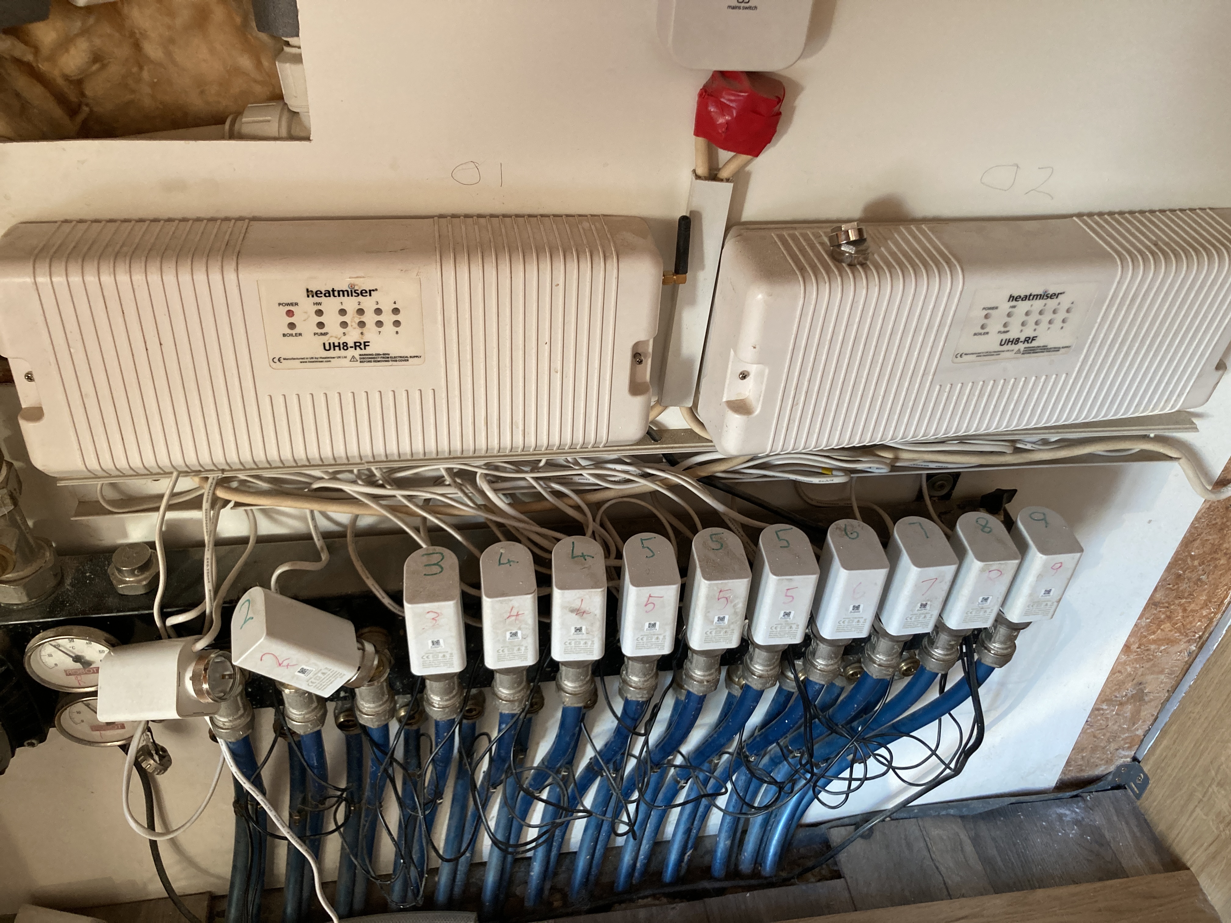

Ok I’ve had the 3 actuators off that aren’t working, the pins are moving ok but the actuator doesn’t respond when there’s a call for heat, I’m guessing these 3 have stopped working but is it not odd that it’s 3 that are positioned together? It’s zones 7,8 and 9, I can send for replacements but don’t want to waste money if it’s something else like the wiring centre, although it lights up ok when there’s a call for heat. Would it be a straightforward enough job to replace the 3 that aren’t working? -
Help with Salus auto-balancing actuators
recoveringbuilder replied to europa's topic in Underfloor Heating
Hi, I’m having a bit of trouble with a couple of the salus auto balancing actuators not operating, thermostat calls for heat but they don’t open, only two of them that I can see. I’m about to unscrew them and give them a spray with a silicone spray in case the pin is seized but my question is- is the pin in the head of the actuator or on the pipe it is screwed onto? -

Still on my own here 20 weeks later, hubby still critically ill and no signs of getting any better. That’s a whole other story.! some of the zones in my ufh are not opening when heat is called for, had a flying visit from heating engineer a few weeks ago who opened up a couple of them manually for me to enable heat into two of the rooms when another zone calls for heat which has been fine so far but it’s annoying me. I unscrewed them all today and made sure the pin wasn’t seized on the tops but it hasn’t made any difference, the heating guy thought the controller had stopped working, can probably get someone to come and replace but just wanted to check if you all thought this could be correct
