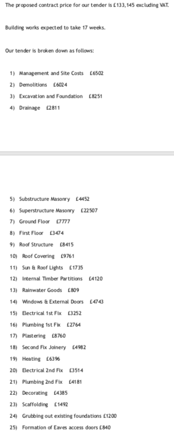

  14. Cheers again guys. This is the quote we are looking to chop away at...any big red flags there?

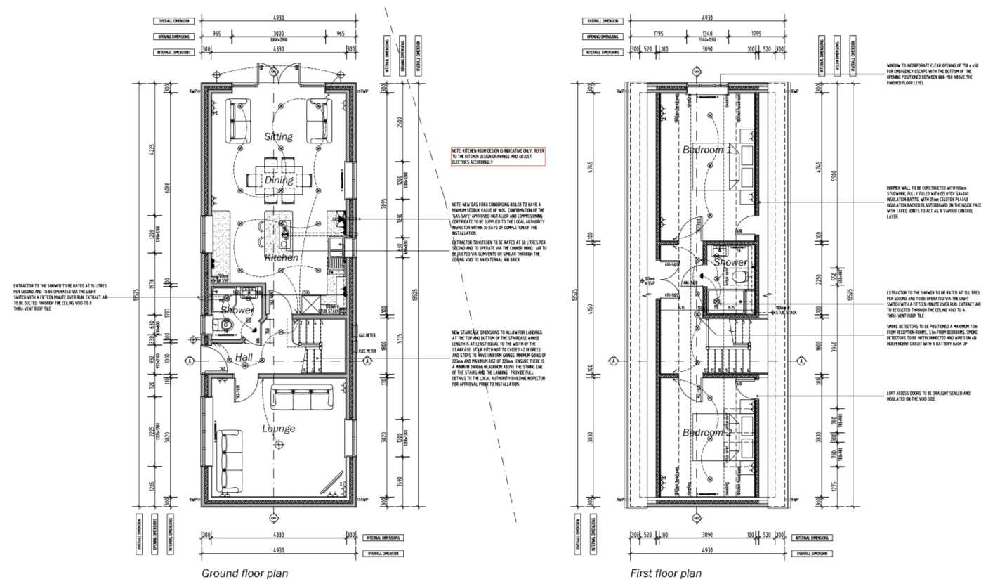

  18. Thanks all. These are the draft plans. Note these are a bit of a work in progress, we are hopeful of securing the extra width to turn what is described as the lounge, in to 2 bedrooms. I am not particularly practical which is why I'm feeling the heat to select the right build method. I feel like if I can get most of the way there (ie. built, minus kitchen and bathroom and fixtures and fittings) for around £100k, then I can reasonably swiftly cashflow the rest. But from the above, this feels seriously unlikely!
