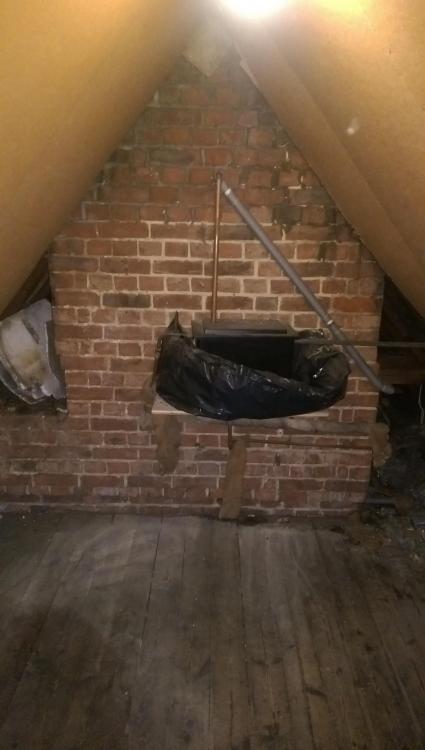

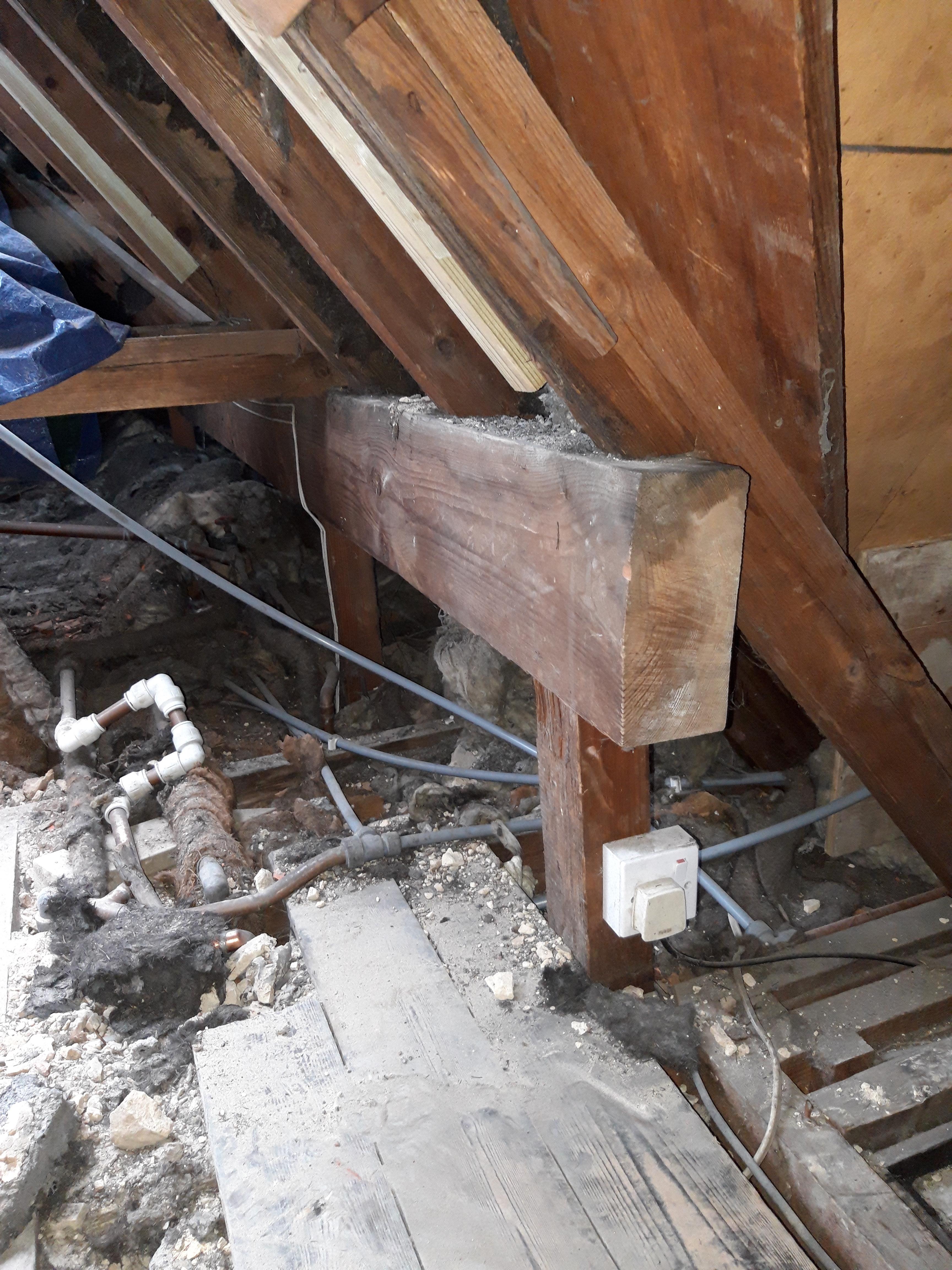

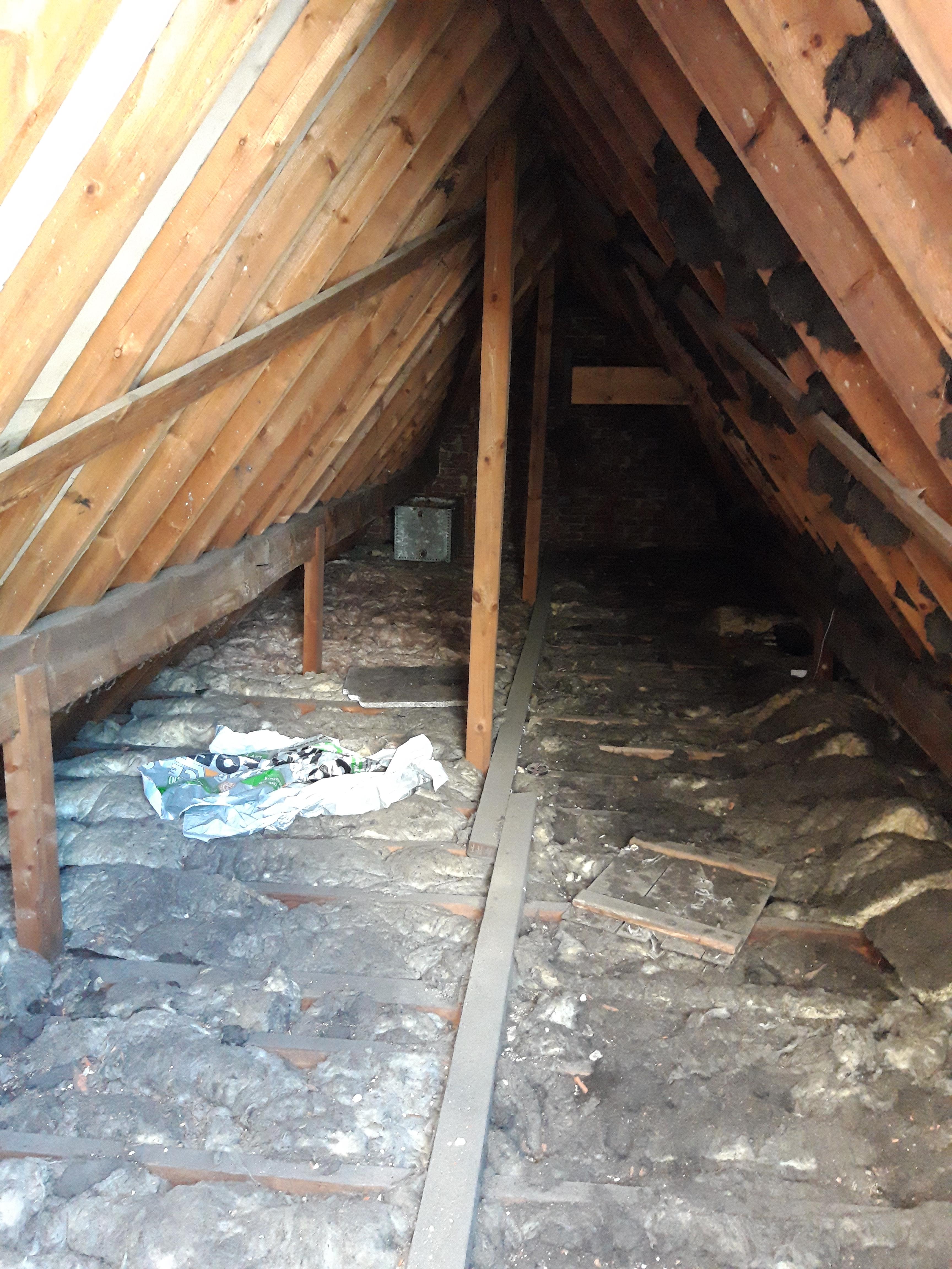

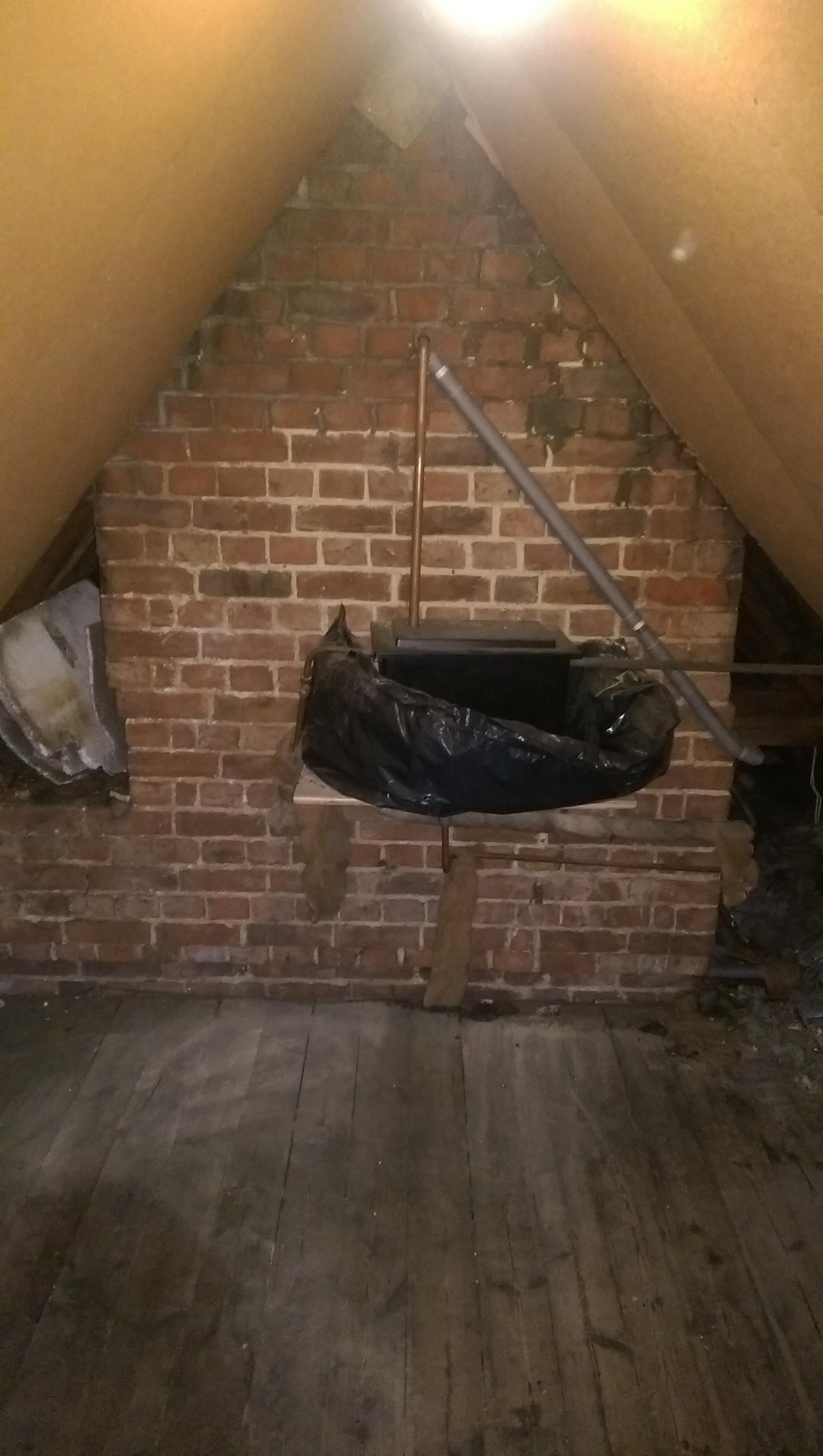

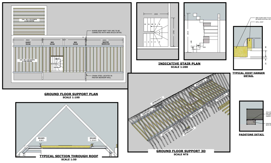

Looping back on this. Slightly losing my mind over the fact that, as I droned on about above, a 350kg+ water tank can sit up in this loft, unsupported by anything other than the joists themselves and one (note, one purlin), for c. 100 years, forcing its weight down within a c. 2m2 space, without any issue at all.... Yet... We've had one quote to support the loft floor as displayed below and it's come in at £50k. This just feels absolutely batsh*t to me. Can anyone with a better understanding of this suggest an alt solution? As I see it we are only missing 1 supporting element as the current support incorporates: 1) far left supporting wall 2) old, massive chimney that's been taken down to loft floor level and 3) far right supporting wall. Ergo we are missing a support for the middle of the far right room, yet fortunately the house's other chimney (as shown below) occupies this precise position, and could be used somehow... I've got a success fee for anyone who can suggest a totally legit alternative that IS going to cost fair money but isn't going to cost preposterous money! -

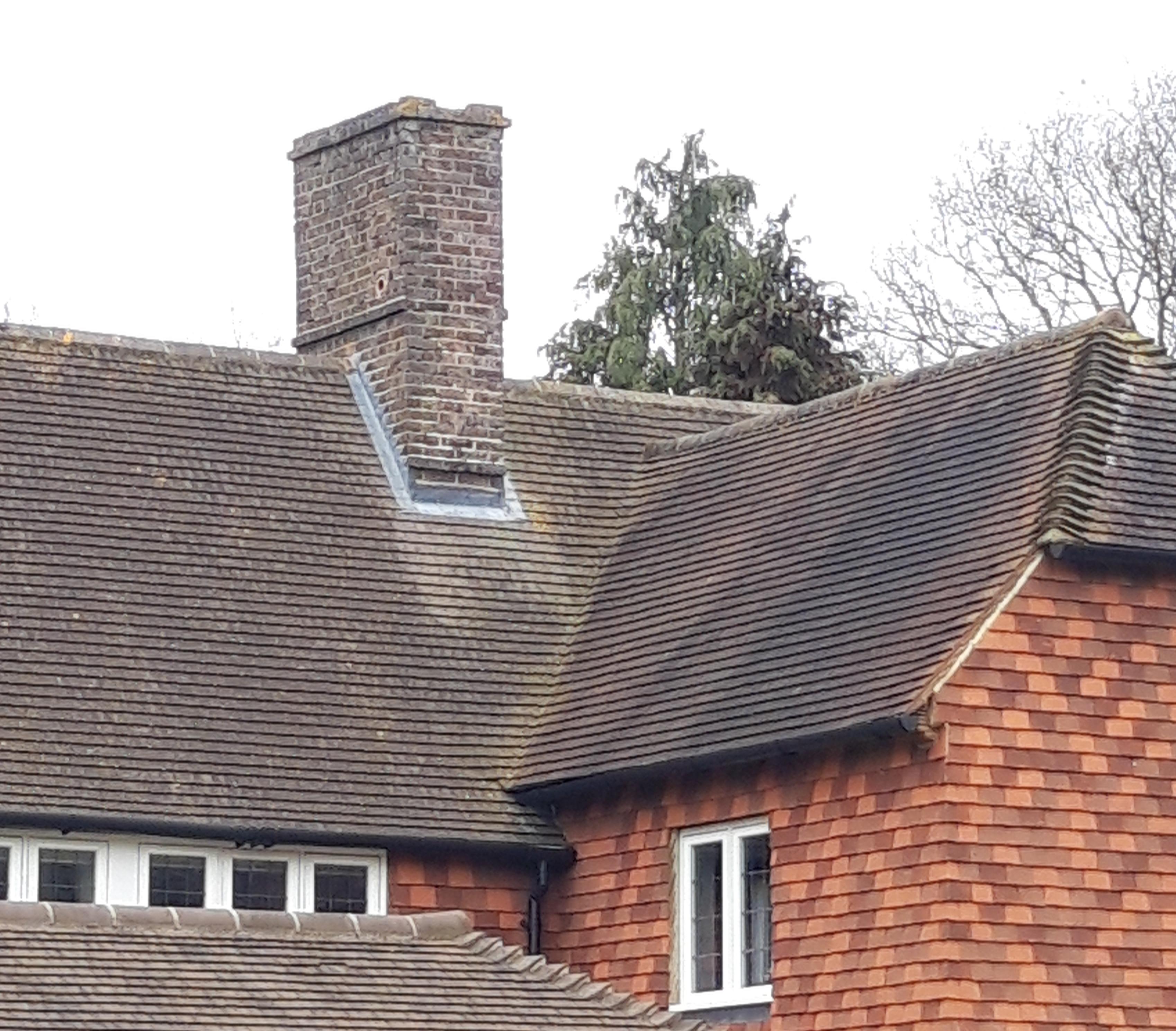

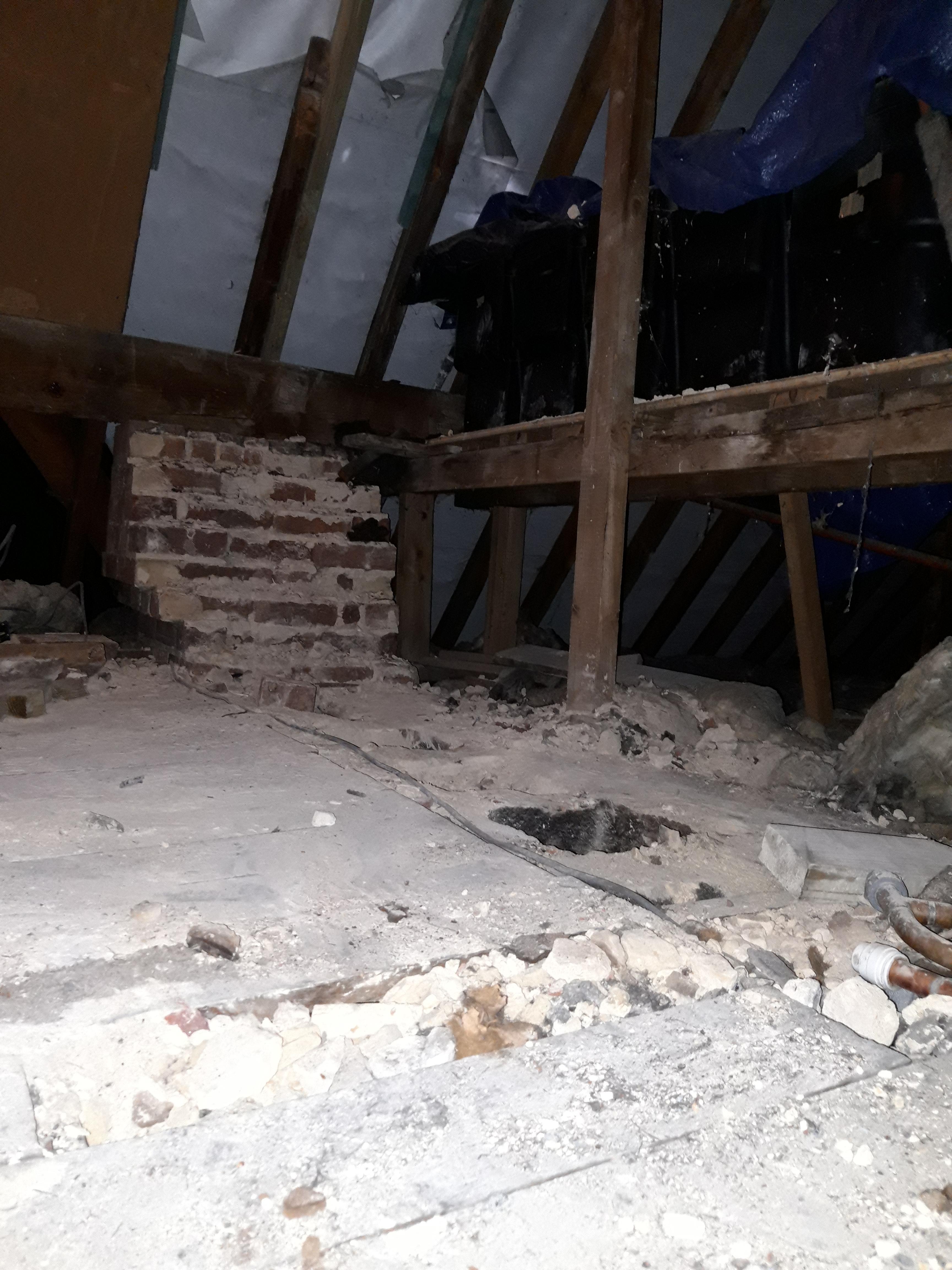

@DevilDamo I believe they do have skeilings along the first floor, yes. That appears to be both the SE's point, and the builder who visited over the weekend. You can see the 1st floor bedroom windows in the image below... Any ideas? Like I said, from my POV there are potentially 4 support points presently in play: Rear ext wall front ext wall Old chimney now capped off* Current chimney still present But there's 12.5m to length to span...? -

Cheers guys, sorry I'm a little late in responding. I'm not being notified of any replies, which is weird... @DevilDamo I don't fully understand the situation but the SE's point is that the loft is sitting on the roof/skeilings, and isn't fundamentally supported by the ceiling below. To my understanding over the c. 12.5m x 4m floor area of the whole loft there are only 3 support points: 1) one external wall 2) the original massive chimney we have just taken down to loft floor level and 3) the far external wall. Some support may be available in the form of the original load bearing walls on the ground floor, and at a push the 2nd/remaining chimney breast, but that's it. @joe90 a builder visited on saturday and basically placed 2 bricks one on top of the other to illustrate the space we'd lose by NOT taking down the ceilings below. This rendered the space right on the edge of not worth converting. (Probably still worth it, but you know what I mean) Put frankly, we can't really entertain the idea of pulling down all the ceilings, with all that BS that entails. So I need a different plan. Pic attached of the space as it is now... All help v much appreciated -

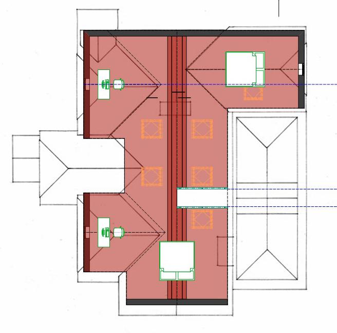

A lot of people think we shouldn't convert our loft. Their reasons: the head height is 2.35m in the pitch you'd lose a bedroom on the 1st floor to create the staircase the house is a 1918 build where the loft sits on the roof rafters, not the walls below However I take a different view because: I'm in the south-east where sq m is clearly astonishingly expensive The views of open countryside that would be unlocked by the loft would be amazing the space, while not vertically large, would deliver c. 55m2 of extra floor space Supporting the roof should be fine, the floor up there is trickier. Due to the 2.35m existing pitch, going up on top of existing floor is tough. The structural engineer just told me that to take all the bedroom ceilings down, and reinforce the whole thing is a 4 week minimum job. With the bill to match. The bill is less of a factor than the 4 weeks of absolute carnage as ceilings come down, mid COVID. I'm assuming there are just no other options here, but if there are, would absolutely love to hear them....any kind of technological innovation which massively reduces the referred impact of movement? (ps. stating the obvious that this is not a weight thing - there's a 400kg water tank up there now, it's a movement issue which will result in ceilings cracking below...)

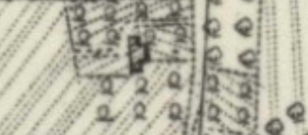

"The curtilage of the dwelling house" is a notoriously tricky thing to define, regarding properties with land. And on this subject, I found an 1870 map of my plot recently (see below) which clearly shows a building of some description smack bang outside what the council would probably deem the curtilage of the dwelling house. The dwelling house in question was actually built in 1918, so doesn't even appear on said map. This new (old) outbuilding then disappears from later maps, as do some other thin buildings which appear to be agricultural buildings (stables or pig pens at a push). My question is: this big outbuilding that I've discovered...can I leverage this in any way? Under PD could I construct a similar sized building exactly where it used to be and if pursued argue: a) I did it under PD (and it's vaguely equidistant from current dwelling house, as other outbuildings are)* b) this structure merely replaces what was originally there (in 1870) Or do outbuildings/what was there pre a certain date simply not count? Love to hear from anyone more learned than I! * vaguely is probably stretching it. Slightly.
