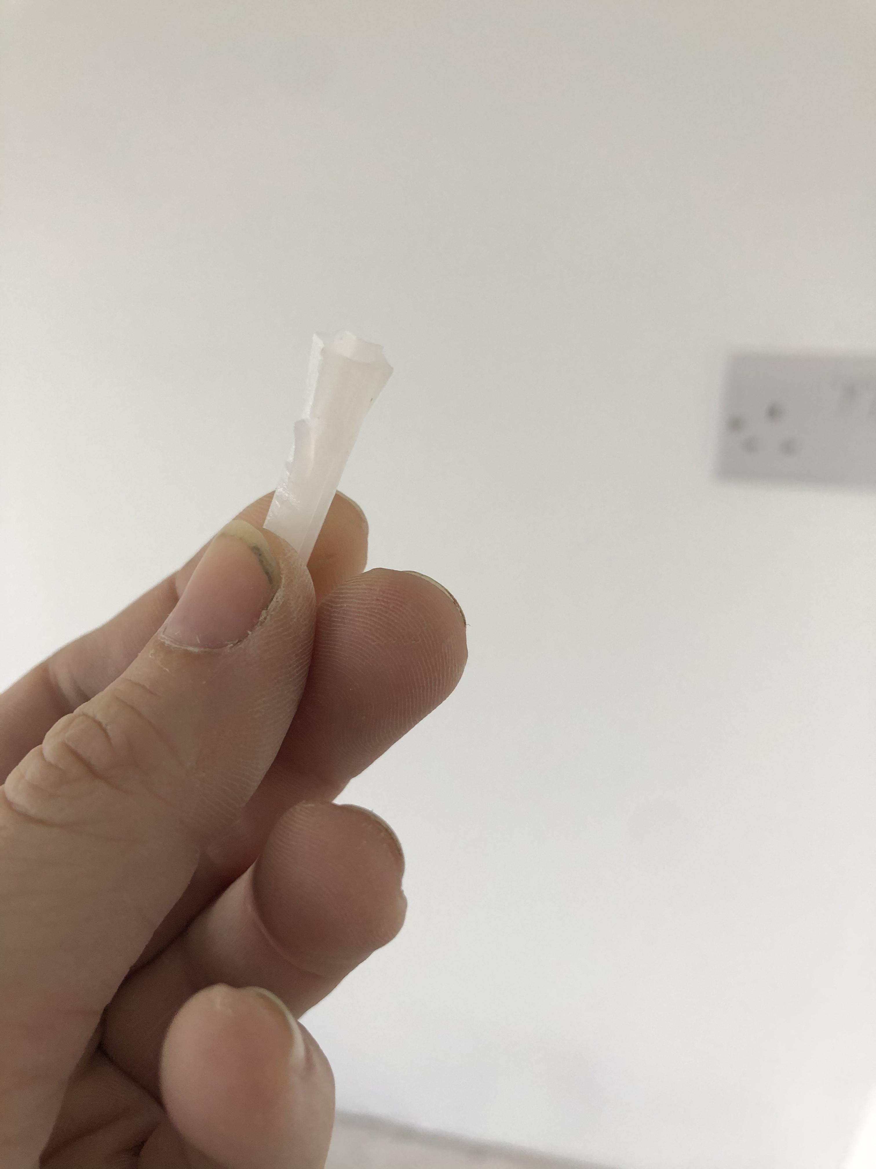

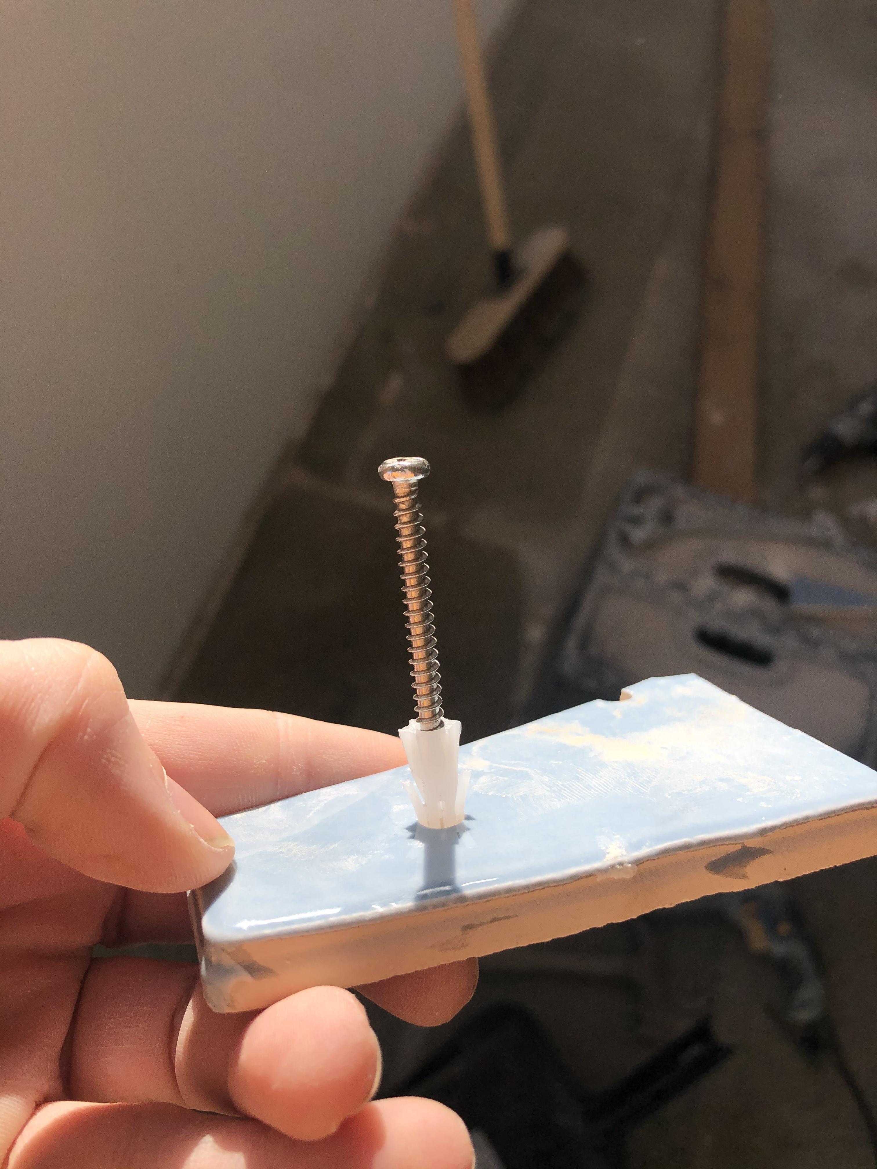

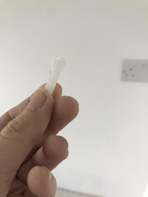

  9. Hi hub! It’s been a while. Partly because the site keeps bugging out on my computer so have to use my phone, and partly because things have been slow on site. I think I need to close some of the gazillion tabs I have open! I have a shower screen to install on some 9mm tiles, which are fixed on tanked plasterboard, which is on 50mm batten against SIPs. Do these plugs look good? They seem too big for a 6mm hole and go straight through an 8mm hole, so I should buy a 7mm bit? I wanted to check that, but also check that they are the right plugs for the job. They came with the screen
