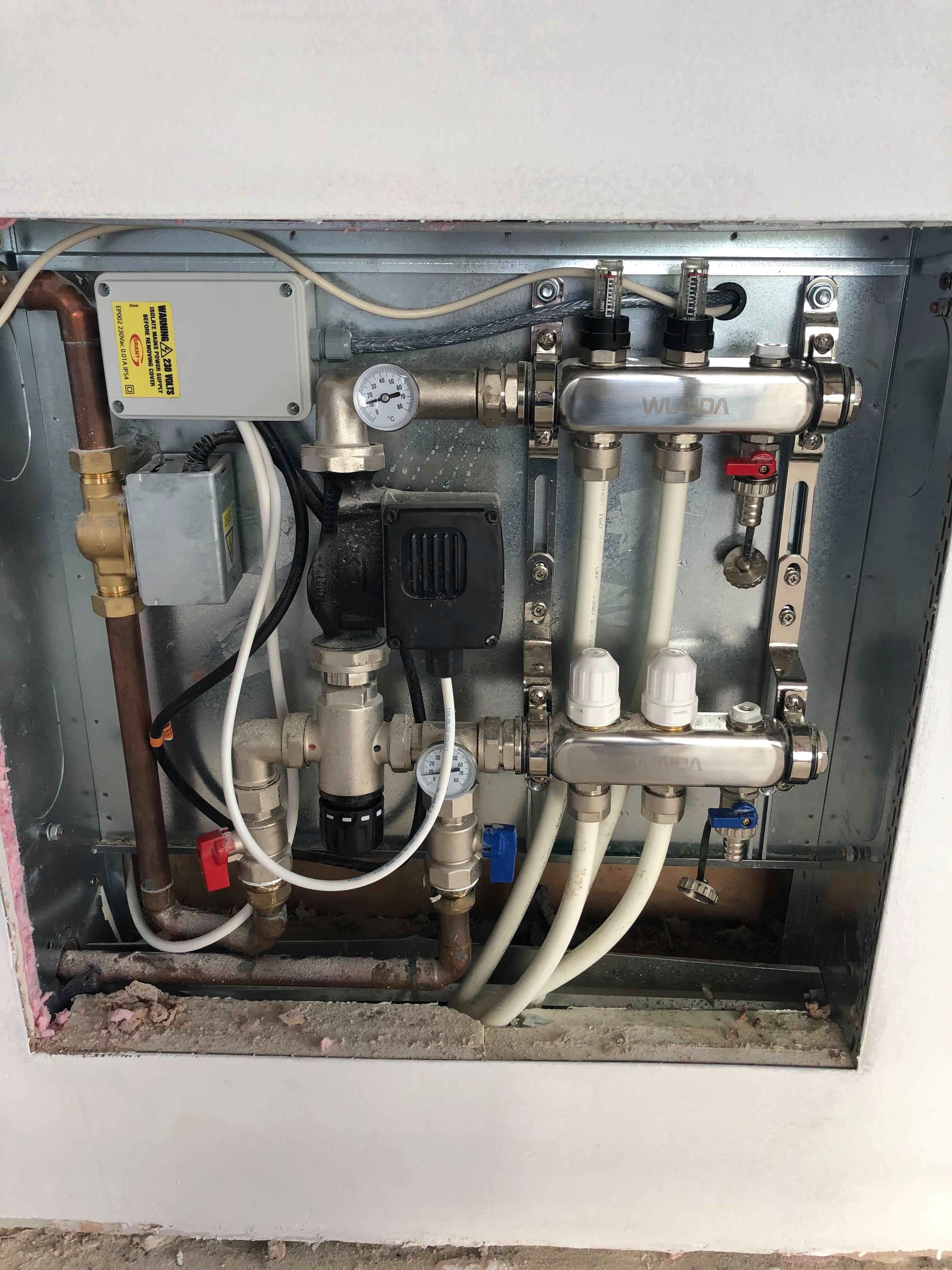

  3. Oh I didn't know what temperature they went up to sorry if the preheat thing was throwing us off track It's a Grant Aerona. There's this next to the manifold,(photo before installation) which has the ashp right outside it, but I was told there weren't any settings for me to be messing with in there...

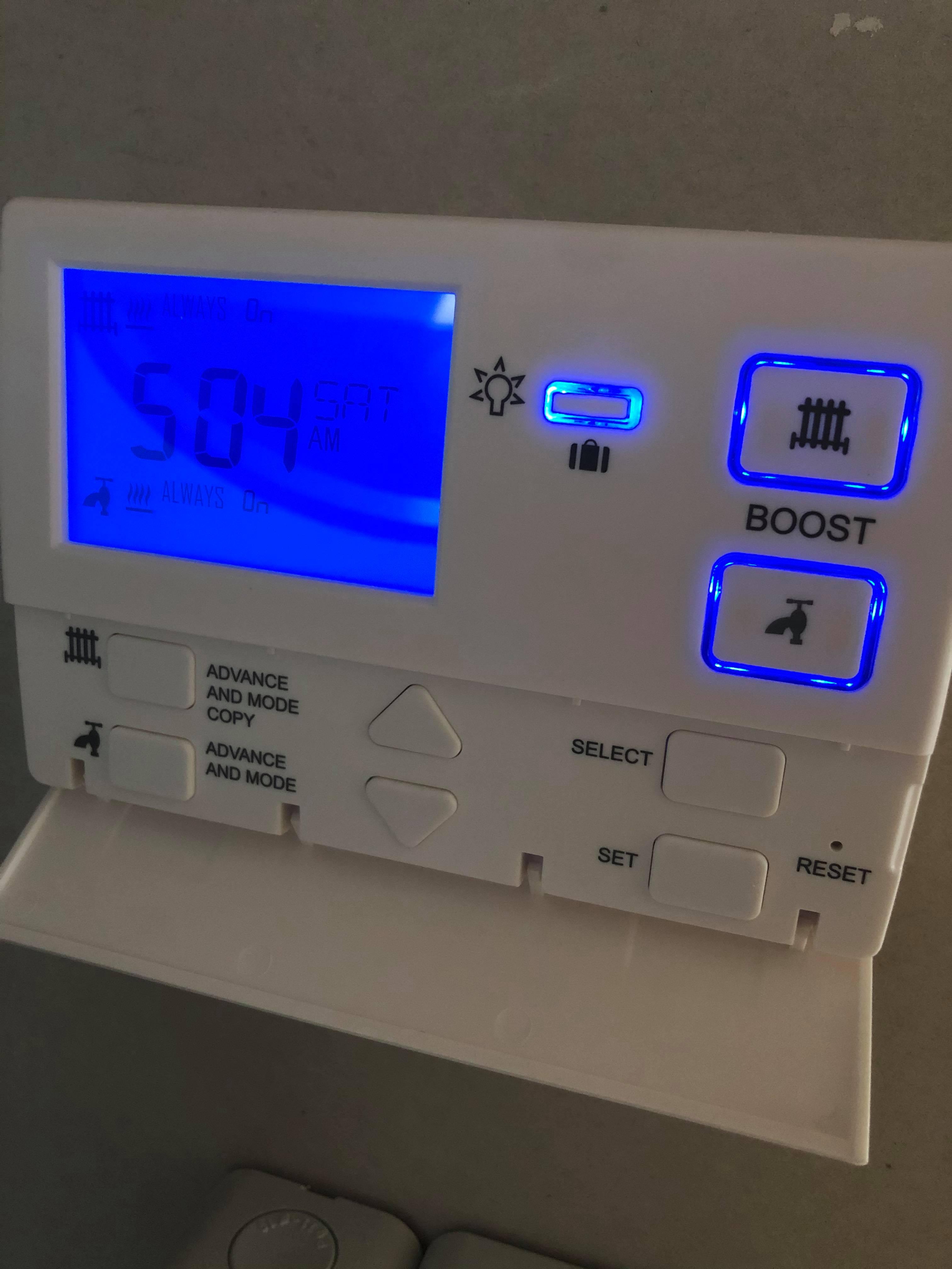

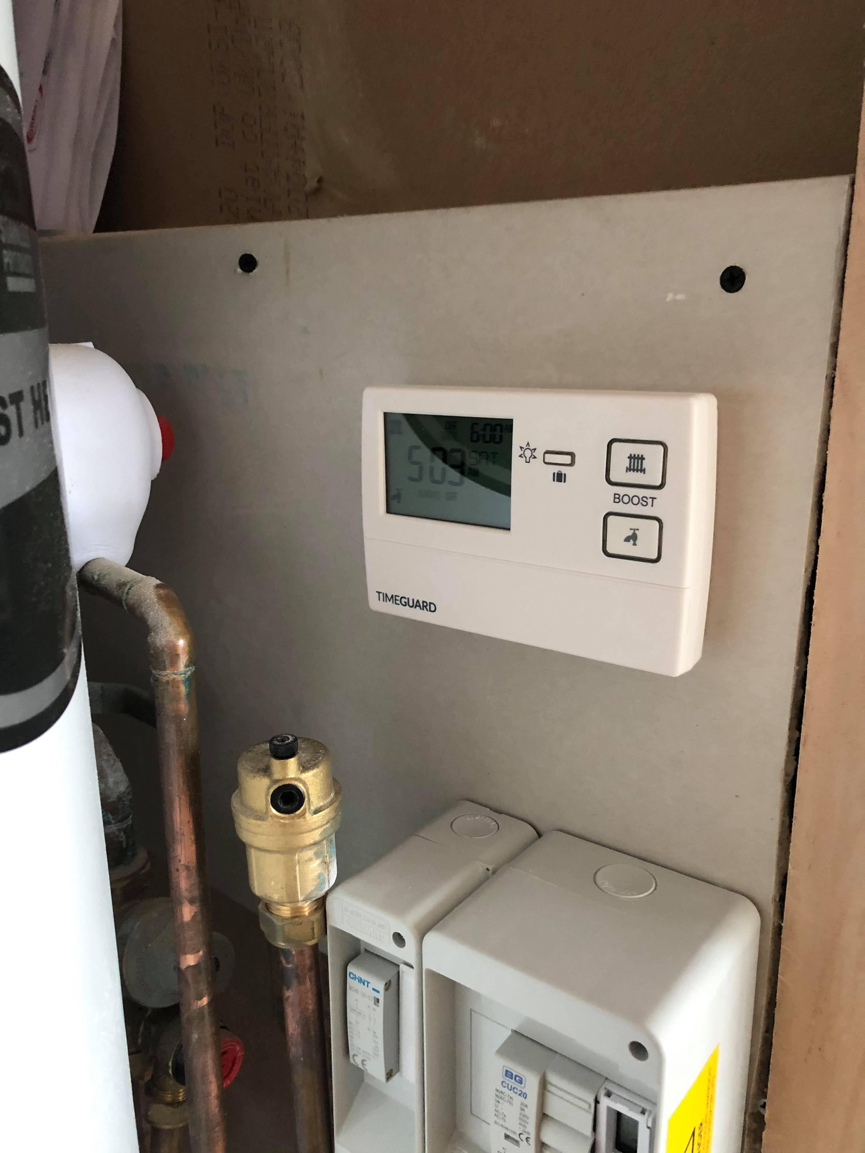

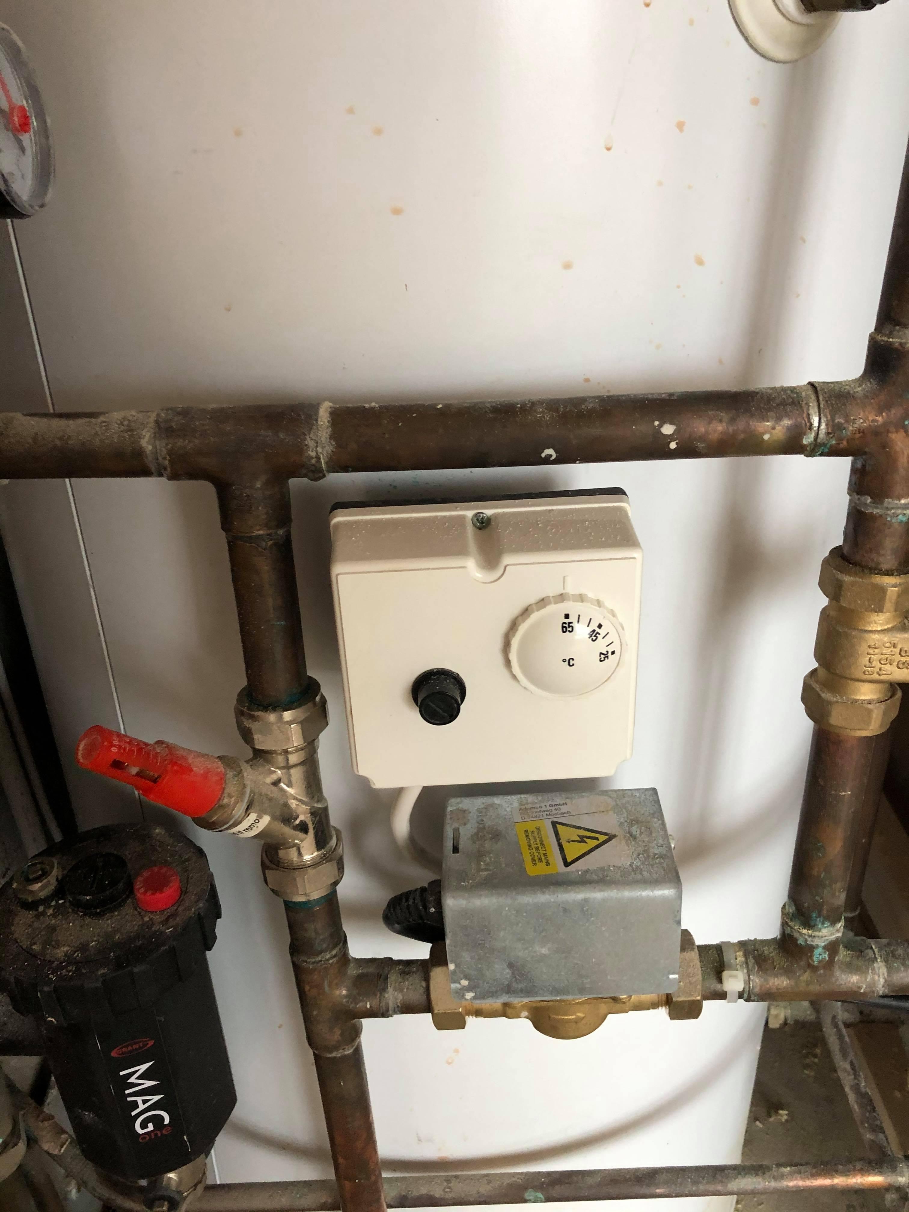

  4. Hi everyone We had our ASHP commissioned with our unvented cylinder and underfloor heating last week. They told me to increase the temperature every couple of days by a degree or so to protect the slab from cracking. I presumed they just meant increase via the room thermostat but now I'm thinking I should be looking at the flow temperature? Anyone any idea how to do that and if I need to? The ASHP should be heating the UFH directly, and also preheating the cyclinder forthe hot water. I've just set the hot water and heating to always on, as hot water was off before and heating had been put on a schedule. Also, our downstairs is currently 17 degrees when we get there in the morning even though the room thermostat is on 15 degrees, I think the dehumidifer is kicking out a lot of heat. Attached are some photos
