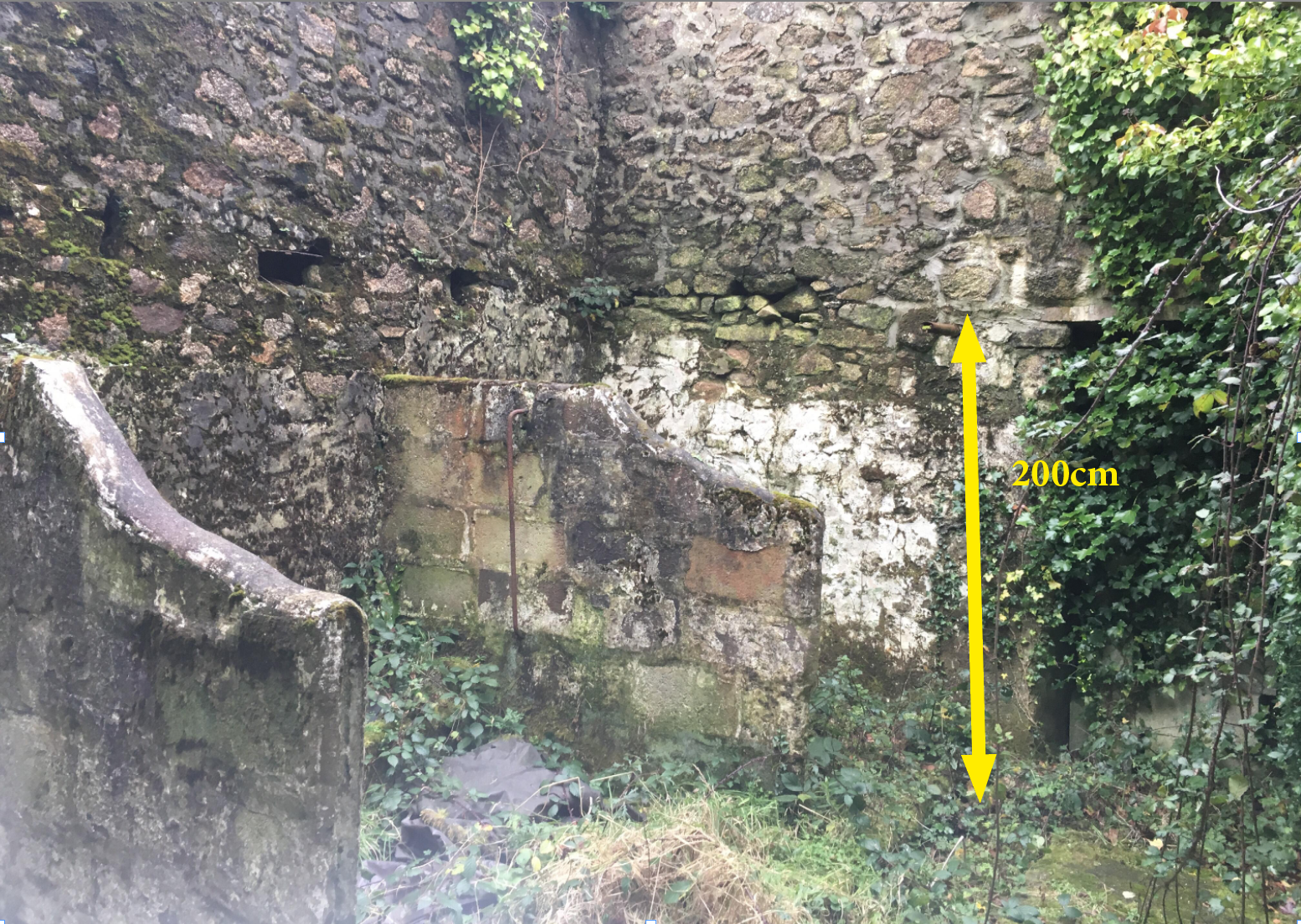

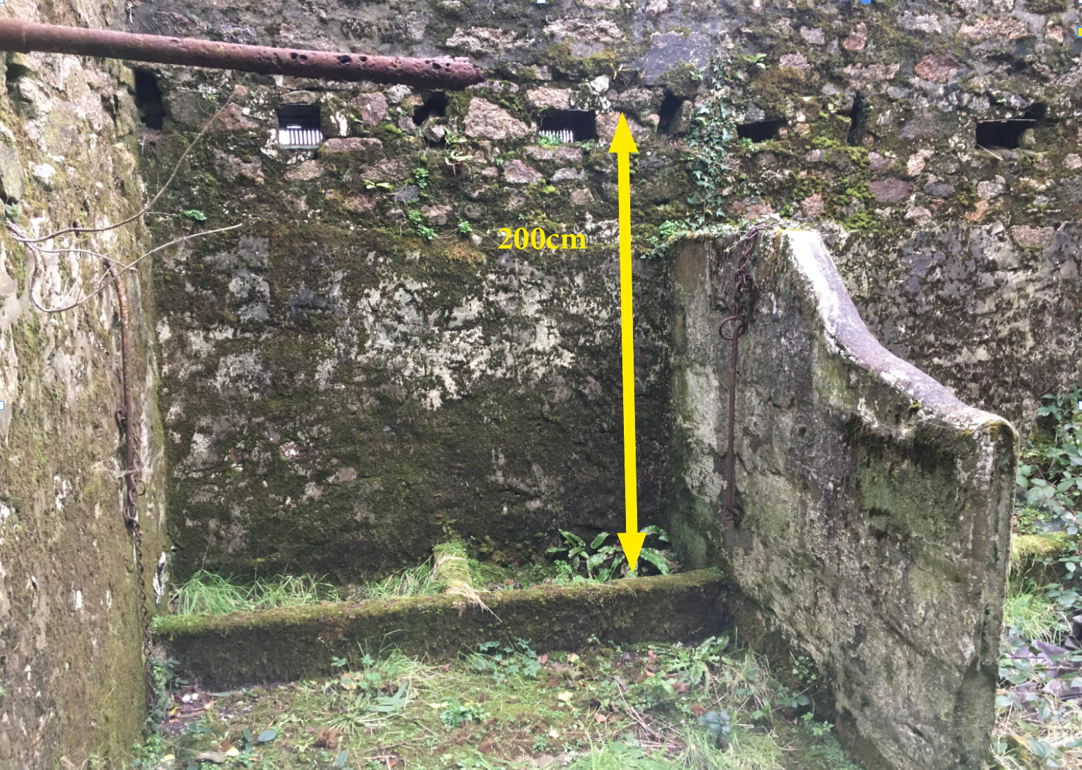

Hi everyone, Thanks a lot for having me I value your feedback! The other question I have been wondering (and need to decide on before applying for planning) is about the groundwork. The structural report says that it's sound and doesn't need underpinning. However, the barn is quite short. I think it's 4m tall, not at the top of the gable - I couldn't get my tape measure up there. It used to have a first floor and has the holes where the beams used to go. We'll be wanting to put the first floor back in. I had originally thought I would raise the first floor so there's more head room downstairs, and upstairs will be fine as we'll have it open to the ridge inside. However, as we'll be hoping to put on an extension, and will need to be doing some insulation and slab laying in the main barn anyway, would it be better to lower the whole floor level? If you're already doing groundwork, how much extra would I expect to pay if I wanted to lower it 30cm or something? I think I am leaning towards just raising the first floor level. I personally don't mind the walls being a bit lower than the top of my head, as there's so much extra space that will be open from keeping the roof open. But worried I am missing a trick that might not cost much more!

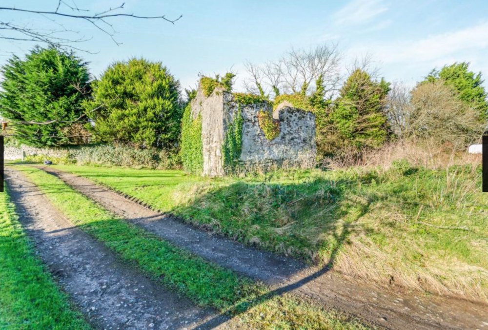

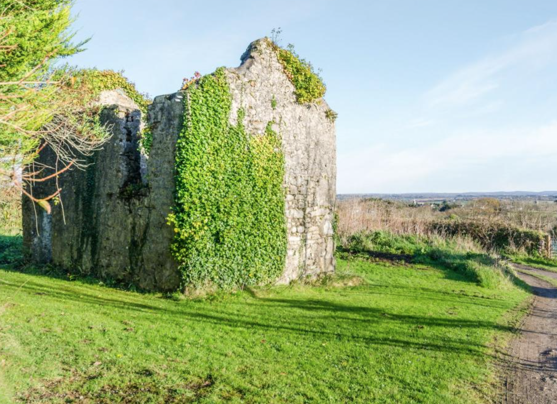

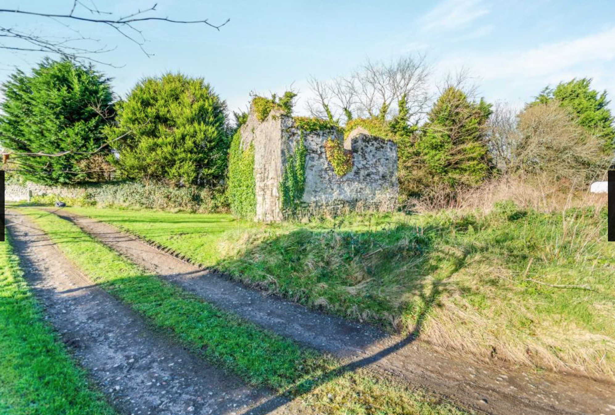

Thanks everyone! Some interesting thoughts. I'm hoping not to have to rebuild too much as it's got a good structural report at the moment. Plus, the council is quite against extensive rebuilding happening. So perhaps I'll give up on this recess idea! I was just trying to be clever about where to keep coats they're so pesky. I've also read comments on other applications on the council not liking porches on barn conversions, but perhaps it depends on the type of porch. I'm not sure I'm that mad on them either to be honest and they seem so expensive for the space you get. To the left of the picture is the boundary between the barn and the next door property. A few people have asked about whether we will knock it down. My feeling is that the council wouldn't be keen. We might be able to afford a slightly bigger house from it, but our budget isn't big. Part of the attraction of this place was that it's a barn, and if we do it well although it'll be small it'll have good resale value down here. Our current plan is to extend about 3.5x3.5m off the back as you see it in the pic, and also put in a SIP garden room as I work from home so we could use it as an office and also a guest room. We're wondering at the moment whether we should include the garden room on the first plans to the council or not. Or wait. But if we did it at the same time we could construct it first and stay in it whilst the rest of the work is happening. Lots to think about!

Hi! I’m new - thanks for having me! We are about to start the process of planning and converting a tiny barn in cornwall the walls are granite and rubble filled. Due to the size, I have been pondering ways of creating space and I was wondering about the feasibility of creating an alcove in the wall on the inside to turn it into a coat cupboard? It wouldn’t need to be that deep if it was just peg hooks and place for a few shoes. Is this the sort sort of thing you would tell me not to even think about? I wouldn’t do it myself. I’m unsure about the stability and whether it’s possible to stabilise it. Im sure I will have lots of other questions but I thought I would start here! thanks for your thoughts i know it looks a state in the pic but it’s had a good structural report
