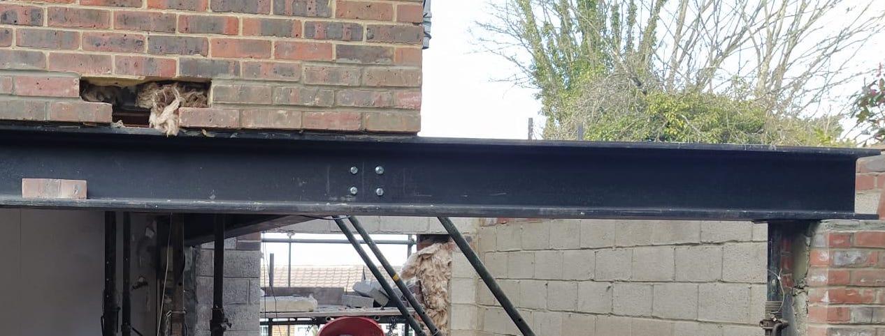

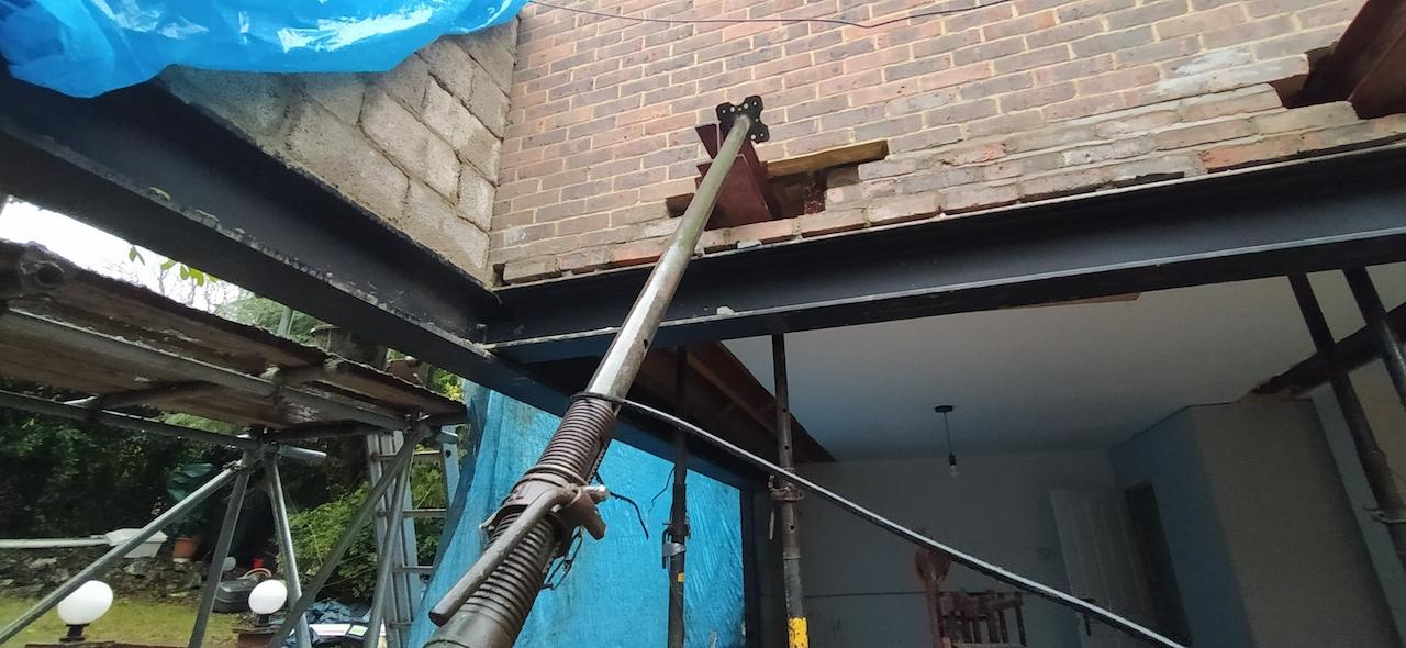

  2. I'm not entirely sure if that acro is doing anything at the moment and they just haven't got around to clearing it. A few days after the steel beams went in, they started taking them out and they were leaning like in the picture but they definitely weren't before. I assume they haven't got around to tidying it away?
  3. What's the likely consequence of this? It's one thing if the steel fabricator hasn't taken pride in their work, it's another thing if they've been supplied something that's not fit for purpose in quite an important part of the house. My builder ordered the steels.

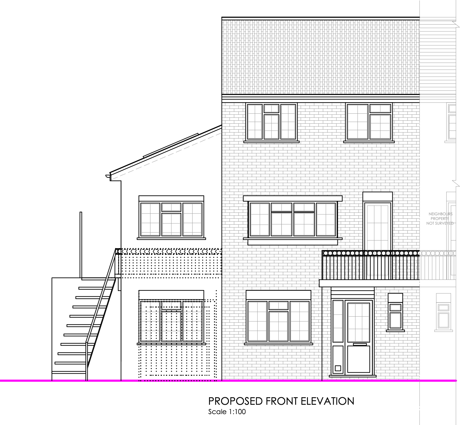

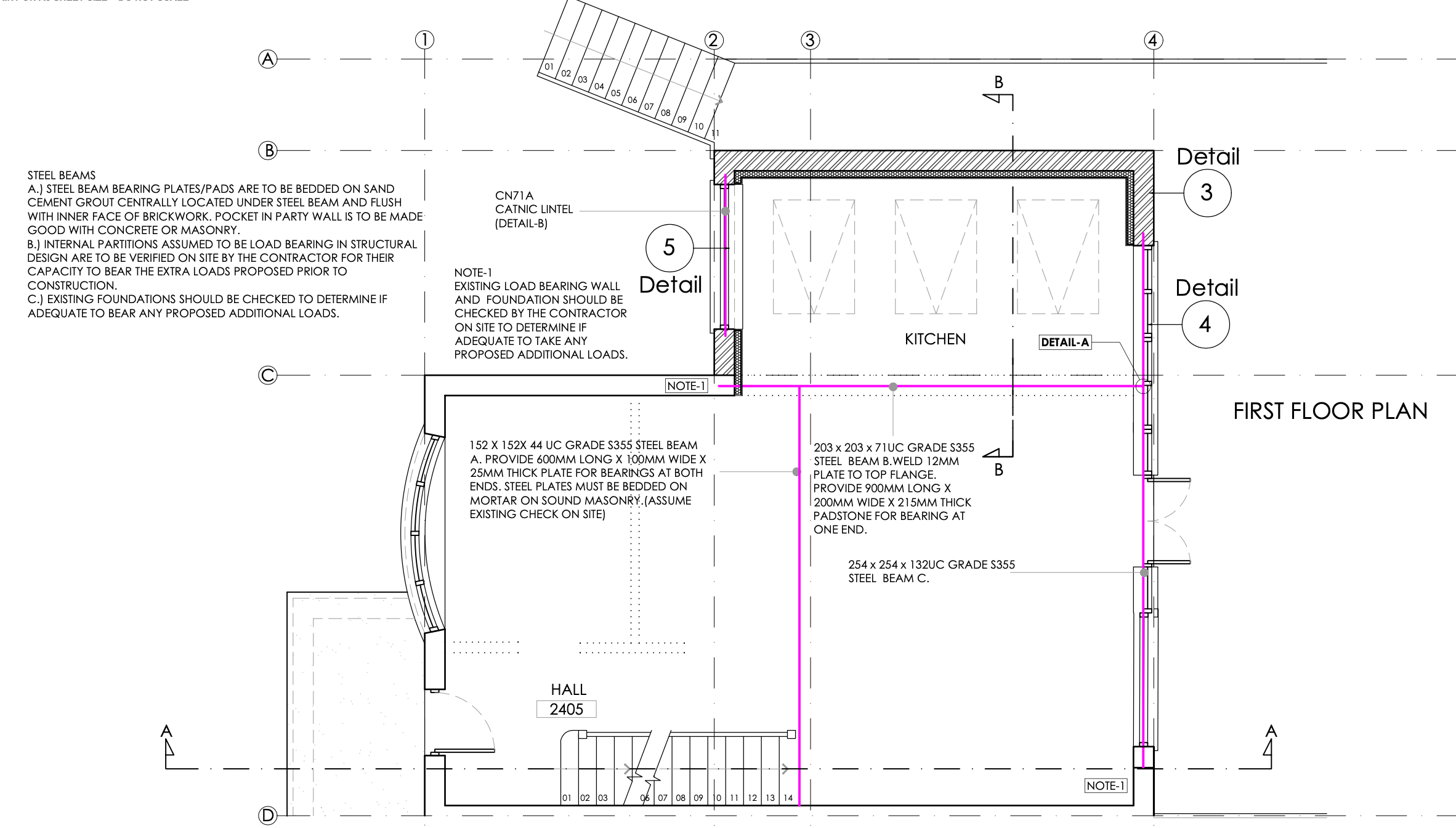

  4. I attach additional pictures taken from today as well as the architectural/structural engineering drawings of the steel beams. I can't make heads or tails of it but hopefully someone on here can point out how the implementation has differed from the drawings. I queried the cut out with the builder and whether this was part of the original design and he said it was. He said they hadn't made any adjustments to the steels since delivery as they don't even have the equipment to make a cut like that. I'm struggling to find a clear enough photo of that part of the beam when it arrived to confirm this though. Don't know if this makes any difference but the beam with the cutout is joined to a much chunkier beam that sits right across the back of our house and on to the extension. The extension is above the garage and won't have a floor above it, so no weight apart from a pitched roof. But the beam with the cutout is supporting the load of the side of the house where there is a floor of living space and roof+loft space. Attached are also images from the plans. The one showing the layout with the purple lines are for the steel beams. The one with the proposed elevation shows the extension above a garage. We removed from scope the conversion of the garage into living space. Foundations were dug and confirmed by both builders and building regs that they were sufficient for our plans.
  5. Here's some additional shots. In picture 2 where the steel is resting on some sort of plates - is that good practice? Picture 3 at the end shows the other side of the largest steel beam showing the bolt holes.
  6. Thanks for taking the time to comment. It gives me things to ask the builder about. I'm sure he'll have a good response but I can usually get a good read on whether he's trying to wing it. The beam where there appears to have been a cut is interesting as it didn't get delivered like that. i also note that the bolt holes aren't centred as they are in the drawings. These steels should have been ordered according to the structural engineering specification. I've got the docs which have all the calculations - none of it makes any sense to me though. The building regs guy has also been around to check it out - would he have raised any of the same concerns as you have or do they not check those sorts of things?

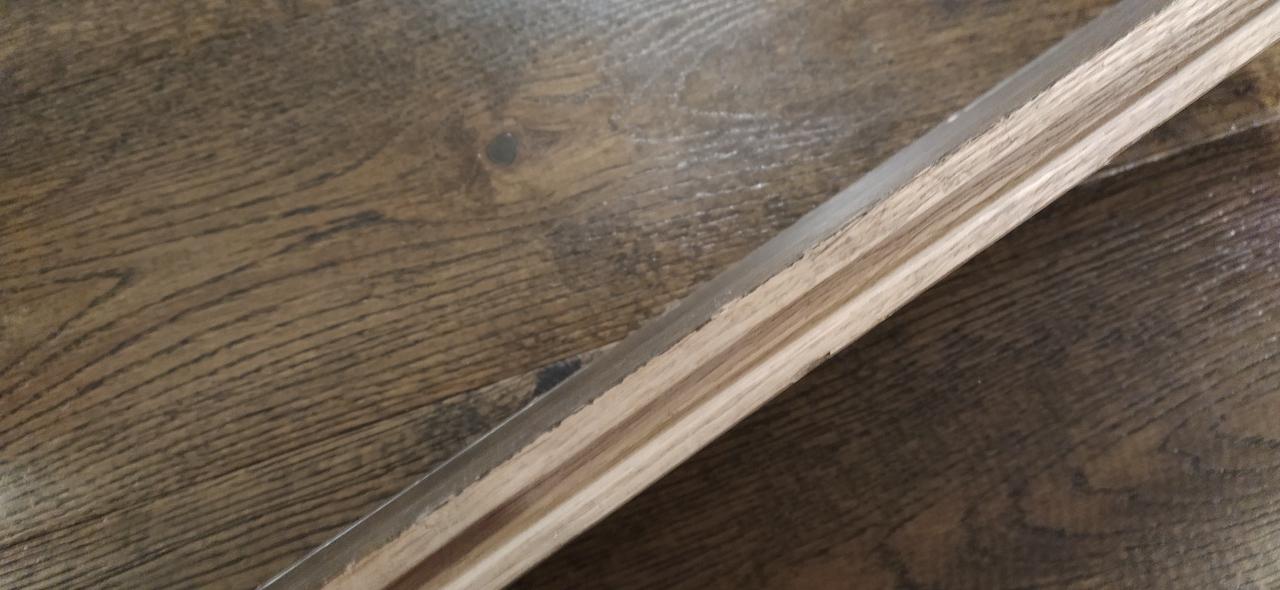

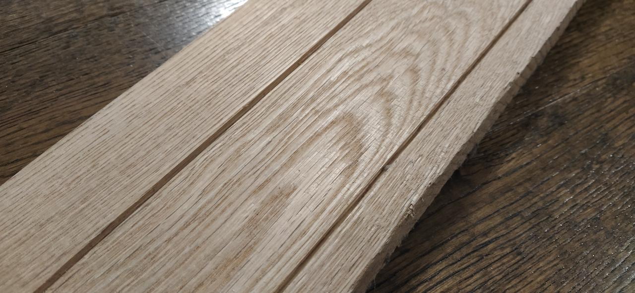

  8. So I think the answer to the first question is yes you can sand it down. But any ideas where or how I might source the same wood for the additional floor space?
  9. The previous owners must have gone to great expense in putting down hardwood flooring in the living space, stairs and entrance hallway. I thought it was engineered wood but I found some spare boards and noticed that they were made of the real stuff at 20mm thickness and 100mm wide. The issue with them is that they're a very dark brown/chestnut colour in an already dark space so we're thinking of getting rid of it all and replacing it with a lighter or warmer colour engineered wood. But before we commit to doing that, I wanted to check if we can somehow re-use it but also get more of it to fill the new floor space created by the side extension. So two questions: 1. Can the hardwood be sanded down to remove the dark colour and re-oiled to a lighter colour or is this wood stained forever now? 2. How do I go about getting new matching boards to cover the floor where the extension is going so it doesn't look like I've got two different floors?

  16. I've had the designs and structural engineering calculations done for a side extension which has a pitched roof and three skylights of dimensions 140cmx94cm each. I wasn't really consulted about the size of the windows or given any options for sizings before all of that was done and have no seen that there are larger sizes to maximise light. I now want to bump the size of those windows to 160cmx94cm. Should a change like this require structural engineering re-calculations to be done? I can't make heads or tails of the calculations that they've produced and not even sure if they even do calculations for the roof and the skylights? Wanted to get advice as this is the third occasion where we had agreed one thing with the builder verbally but when it came to confirming in writing they come back to say that's not what was agreed and anyway you'd need to do XYZ before we could change it.
  17. They don't note the size explicitly but the skylights are in the drawings which I believe are to scale. So I'm guessing you can work out what the planned size is for each window. I'll try and give the council a call tomorrow but they've never picked up or replied to my emails whenever I've tried before so I'm not hopeful.
