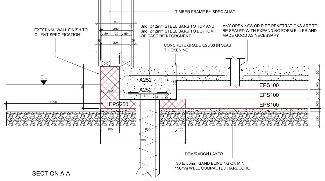

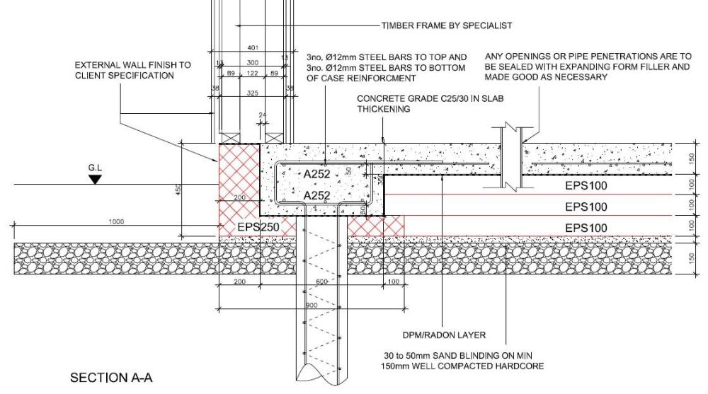

  12. @ToughButterCup Thanks for your detailed previous posts. Can I just ask which contractor you used for the raft and what your proximity to other buildings is? (T&C Vibro - although their website states VSC's "Installation produces very little noise and vibration, reducing disruption to the surrounding areas compared to traditional piling techniques." - They felt our site might be unsuitable due to proximity to other properties; that'd be a real shame as it does look like a good solution.)
  13. Thanks, would you think the potential for cold-bridging of the piles is significant enough to consider a structural raft - which would mean finding a separate contractor for the works. Whereas MBC offer the foundation (insulated raft only it seems) along with their timber frame - thus reducing the possibility of timber frame contractor blaming the foundation contractor for any issues. Having one supplier for the lot is one of the main attractions with MBC. But I appreciate your point that a structural raft would be a better way to do it in this case.
  14. Thanks, but do either of these avoid the cold bridging issue with MBC's insulated raft?
  15. Thanks looks like a creative solution. So the piles don't tie in directly with the concrete - just support it from below? Did you use a local contractor for the job? Or was it an MBC job? (Sorry haven't had a chance to dig through your blog etc yet).
  16. Would also be grateful for any opinions as to the significance of the piles affecting the thermal performance of the slab - is it a reason to avoid this foundation type entirely or is the impact minor and nothing to be concerned about?
  17. Was nearing a decision on timber frame supplier and drawn to MBC's package of founds and frame. However soil survey shows we needs piles and MBC have sent a general sketch of how they might implement piles with their insulated raft. I'm no engineer but to me it seems criminal to bridge the EPS with the piles as the drawing seems to illustrate. I'm told the area is small and thus the cold bridging isn't significant enough to negate the overall benefit of the insulated raft. Apparently they have done a few like this - is there anyone here with their foundation and piles? I recall @TerryE calculated the impact from rebar to the external masonry footing was significant but I guess that involved significantly more metal than the limited number of piles typically needed for a raft.
