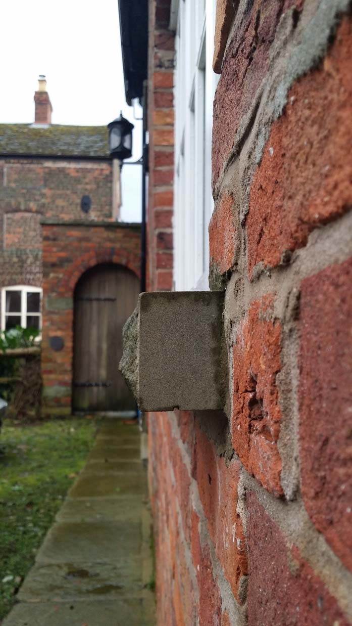

Another Rationel Forma+ Alu clad + secondary cill detail Aftermarket cill sourcing and application does seem to vary. Not sure if this is optimal but it seemed to make sense for our application. We were dealing with "too flat" existing deep granite exterior cills in a refurb and we ended up like this. Windows sized to allow for aftermarket Alu cills. Upstand Groove to rear edge of cill only. No additional interlocking profile. 3 lines of arbo full length to cill top face far enough back to avoid visible gloop or compromising the drip/free air draining to front profile. Screwed cill up onto bottom of frame. Then Compriband trio around the cill and the frame as a unit. Fit to aperture (brick and a rough flat granite cill in this case). More arbo to front cill edge to granite. Insulation and Alu plate to arch as picture. We now have a sensible "drip" with no timber sat in the water on the granite so hopefully these windows won't rot as quickly as the old ones. The school solution would probably be a full depth Alu cill to come out to the front edge but it would look bad in this application hence the compromise in the photo.

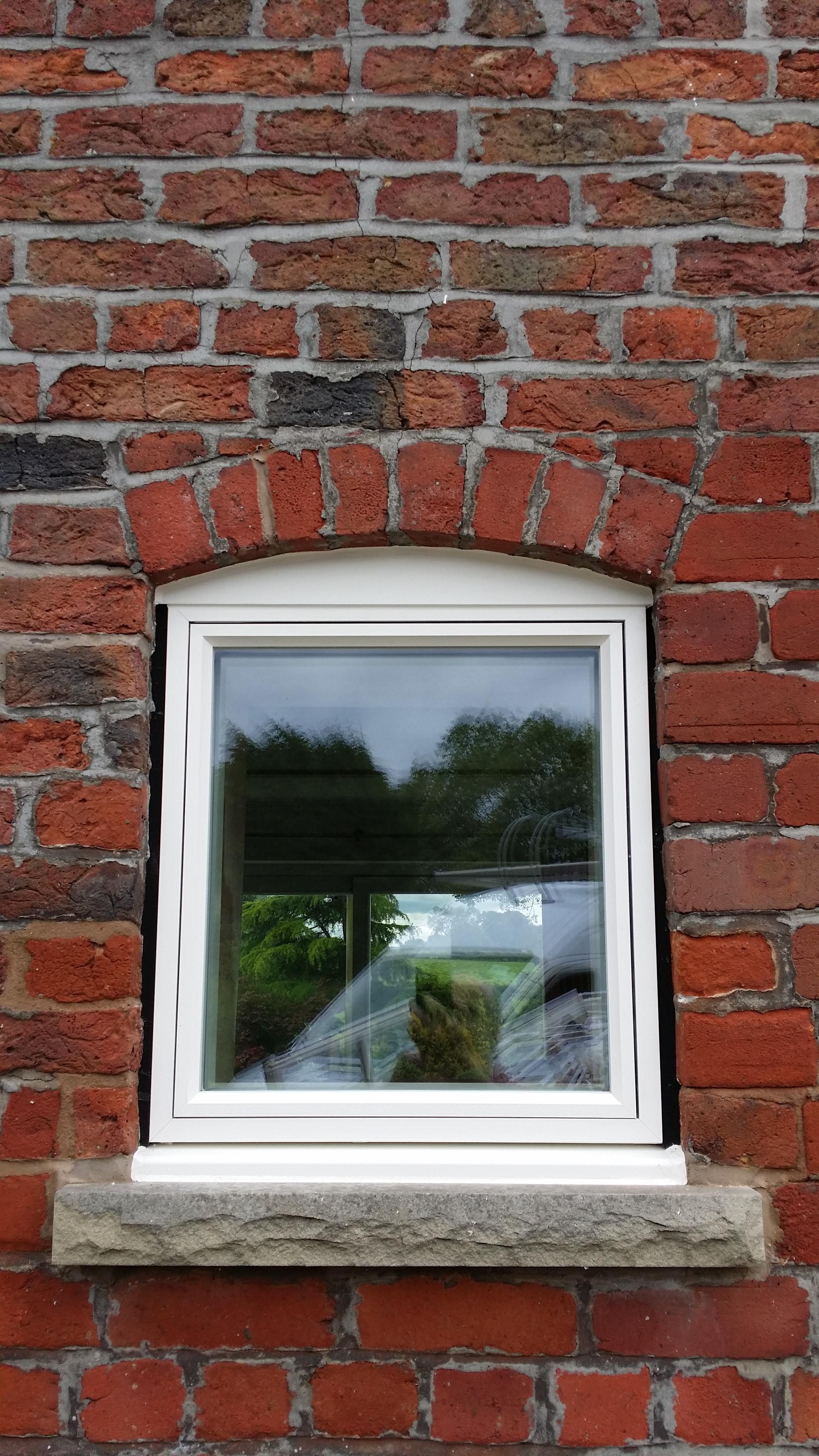

Rationel Forma+ 3G Alu clad From the local Rationel reseller (Heswall) Barn refurb scenario - remove, replace, redo reveals. Very happy. It's early days for longevity but very happy with the installer support to design process and the attention to detail on the job. Memory of paying the final invoice is slowly fading. Rationel also did some custom multi-section windows for larger barn apertures for us. These were expensive and in hindsight likely could do better. They are OK and we sorted out the issues arising with multi-section and air sealing but I remain less than convinced that Rationel are good value where you go that far off piste. It did keep it all inside one supply and fit contract though. My reading here suggested they were a fairly safe but not a cheap choice and I do not disagree. For my outward opener traditional look (planning) and becuase of some size issues I didn't have a huge market to choose from in Alu clad timber. The install was refurb with profile change not fresh build so the installer who would take it on was also difficult to find. (Job too small for builders, too big for joiner with a van). -

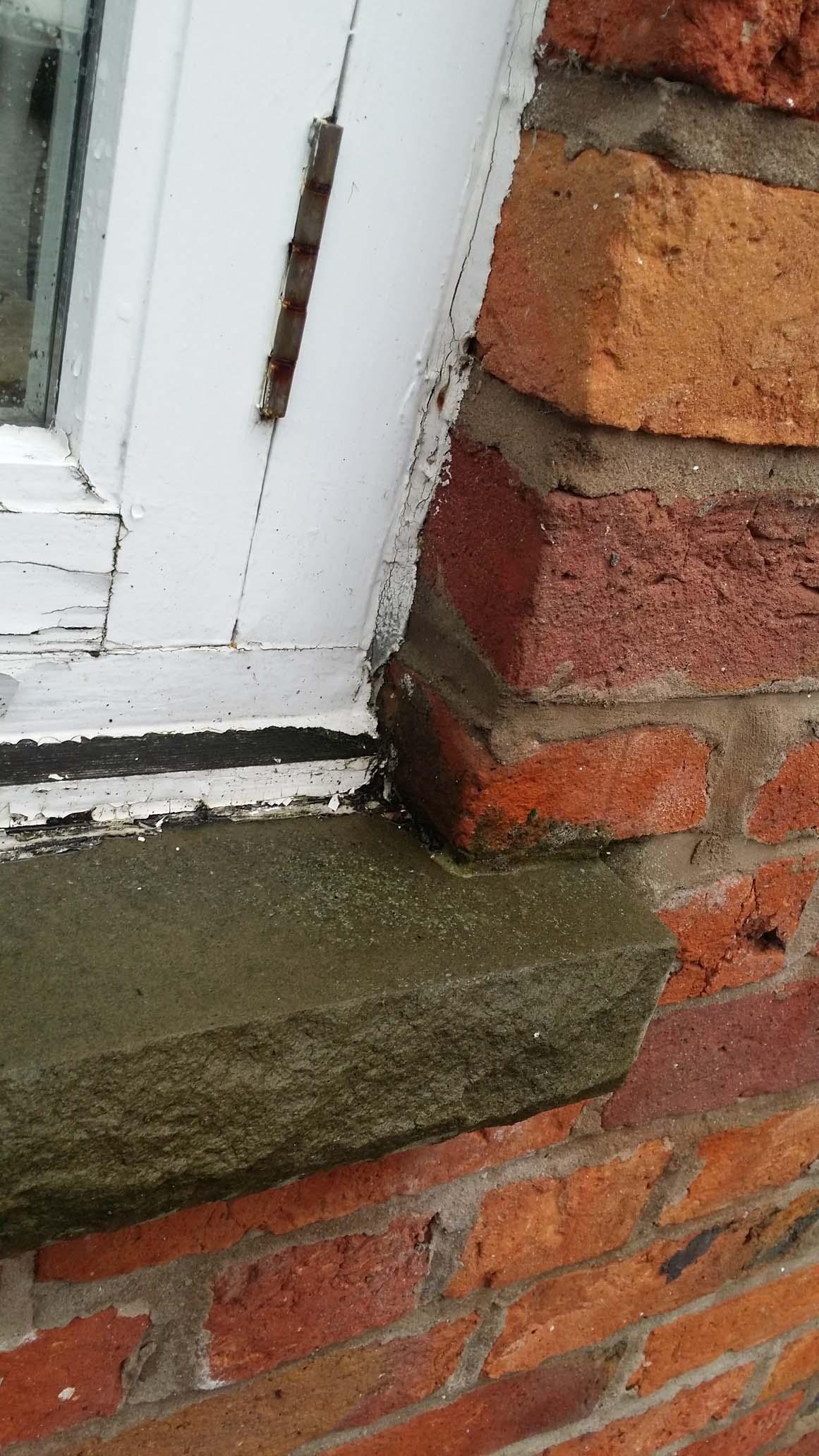

One of my potential installers has suggested the following for alu clad timber to address a site difficulty with suspected insufficiently sloping granite cills. Is this a sensible design tweak or a case of everything looking like a nail if you are holding a hammer. Situation: Deep brick apertures, wall batt and block construction behind - rough granite exterior cils protruding (they are not flat yet could likely do with being steeper). See photo. The as is existing timber deflectors in front and the bottom of existing softwood frames have shown the worst paint loss and rot. Some water may well be being retained on the granite. It's rough so it runs off when there is a lot (from a jug) but surface tension holds a certain amount I have been uncertain about the merit of standing the new windows on the existing granite and relying upon the compriband at front timber line given the exposed edge along the line of the compriband seal. We have also looked at fitting some kind of "stub" cill water deflector (clipped or screwed to the face according to system) which will help run off, reduce direct volume, but not eliminate water retention on cill. Discussion with this approach has been on whether to silicone behind face mounted Alu stubs or not (i.e. making a bucket for water to sit in vs keeping it out). Have rejected full clip on Alu cills out across and down over the rough shaped granite edge as not a practical choice - too ugly although it would work. Grinding or even replacing the granite during the swap out was considered but undesirable on cost, logistics, difficulty with existing edges/finish etc. The fitter's suggestion is to use deep Alu cills for the windows to rest upon installed well back on the granite into the aperture leaving a lot of granite cill in front (appearance OK). Approx. 25mm of sloped down Alu in window finish protruding out from underneath the elevated window bottom sitting above the granite. The window being bedded onto the Alu cill behind and forward to the normal compriband weather seal line with some form of wet seal he used the phrase "arbo" and argued a special kind should be used for longer life. Then normal Compriband around sides/top etc. Thoughts on these two ideas, materials choice or alternatives to address the underlying constraint with potential water retention.
