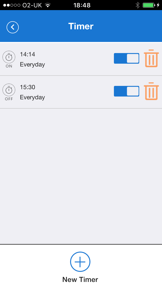

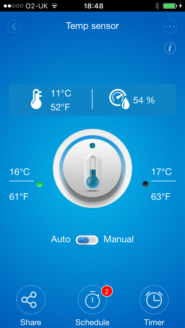

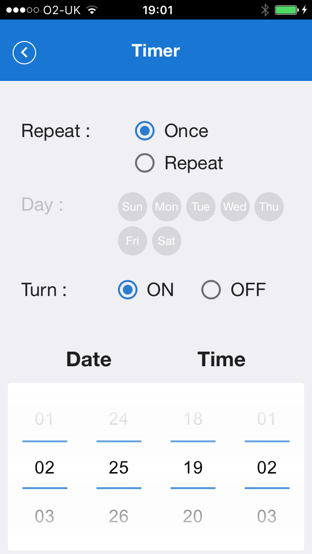

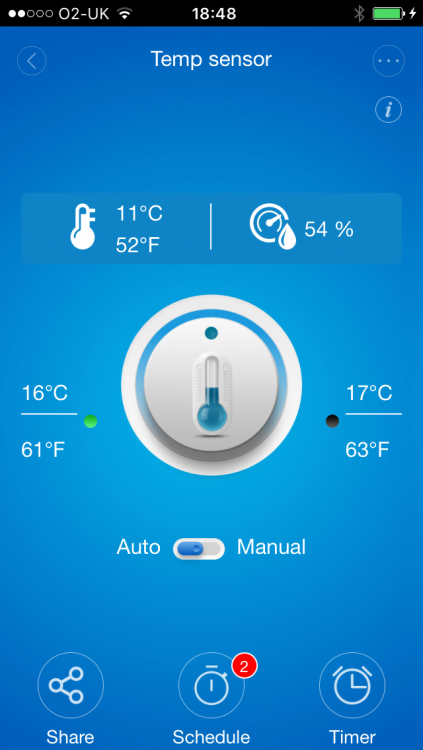

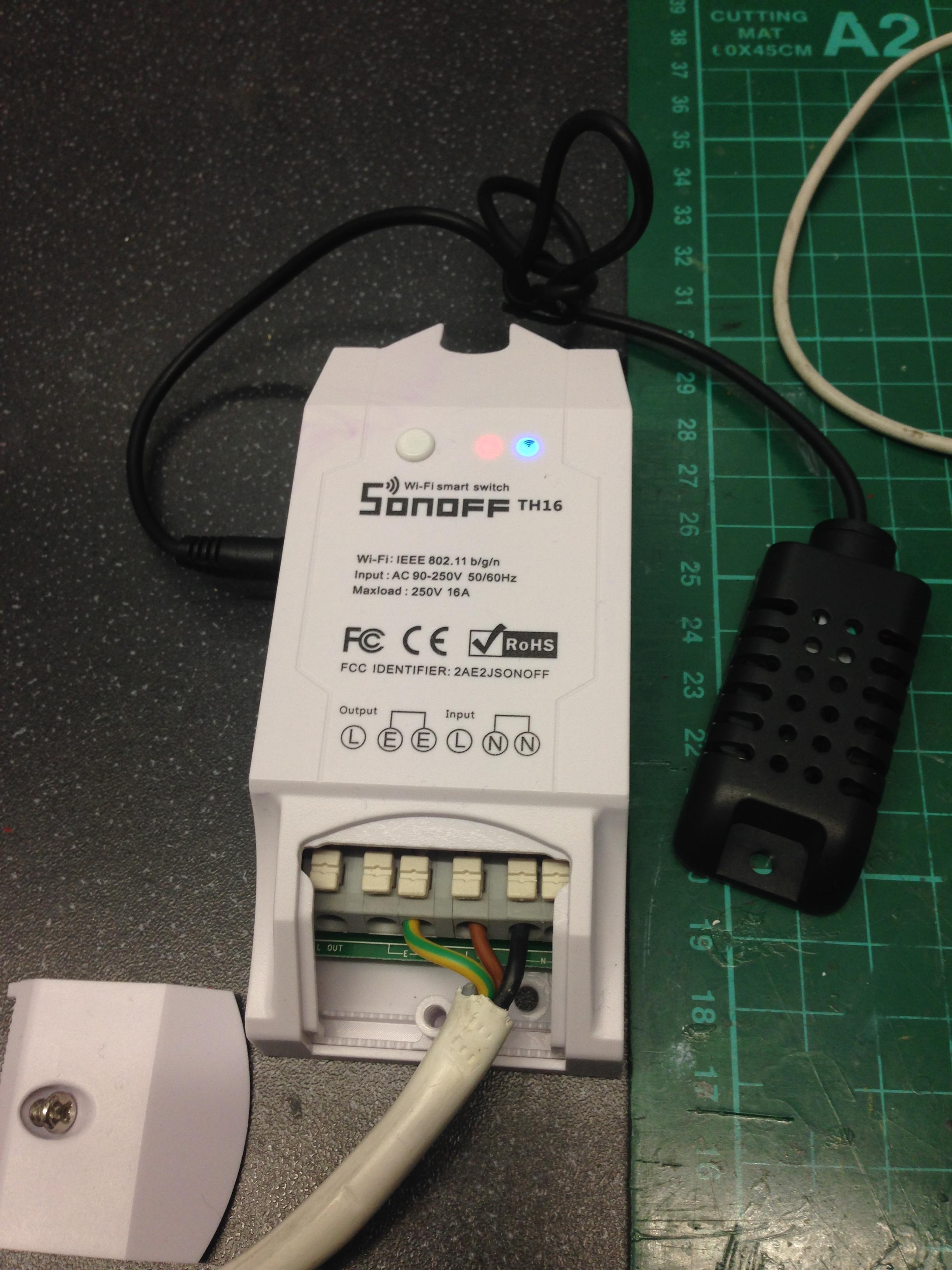

SteamyTea - Sonoff's are based on ESP2866's and if you want to you can reflash them with Tasmoda etc. However with the amazing offering of products and prices from Sonoff, and the compatibility with IFTTT I would ask if its worth the stress? AndyT.
The 16 amp unit looks like this and as you can see its both FCC and CE compliant. The temperature / humidity sensor (black bit on right) has a 2.5mm 4 ring jack socket. EWeLink links the sensor with the button to the WiFi in the App and then you can set it up with either temperature going high or going low or taking manual control all from the phone. Once you have done that you can set up on and off schedules for every day or selected days dates and times as you wish. Even more powerful is the ability to trigger an activity with geolocation of your phone or from another application. This is called If This Then That or more commonly referred to as IFTTT platform - the application is free at https://ifttt.com/ Some examples; You and your wife are entertaining this evening and might want to link a Sonoff device to your Outlook calendar event to bring the heating on 40 minutes early so the house is cozy. The same Sonoff device might also be linked to the Underground Weather (look it up) so it could weather compensate the boiler. i.e There's a yellow weather alert for snow. As you approach home (geolocation) you might want the drive lights to turn on for 5 minutes then turn off but only if the clock said that for your location it was past lighting up time. Your intruder alarm system tells one Sonoff device and that interlinks with another Sonoff to instruct the MVHR to reduce speed to 50%as the building is unoccupied. The same Sonoff unit has as an MVHR night time setback to 25% to keep the noise level to a minimum and a day time faster speed but only on Saturday and Sunday. So I hope you begin to see that these low cost devices can help you automate anything so helping you save energy and time. Enjoy, Kind regards AndyT
