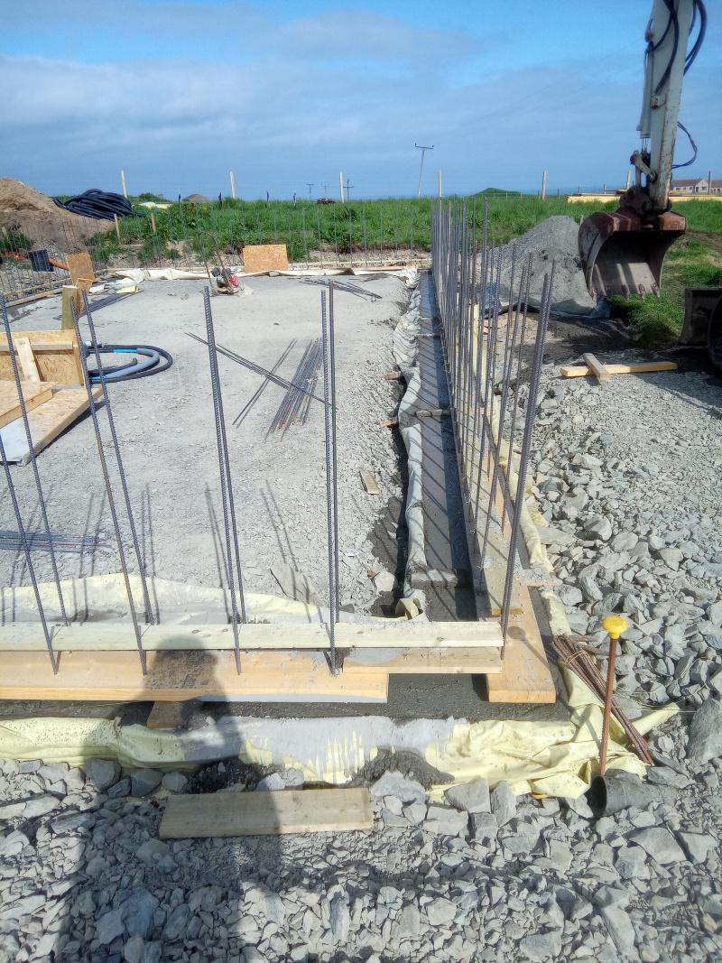

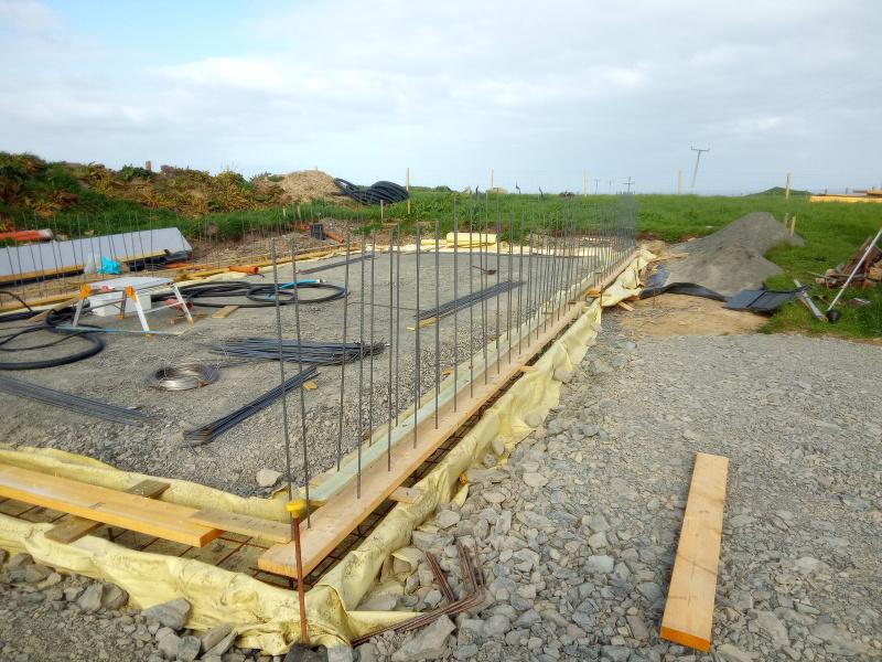

It seems that the engineers really worry about the wind here, which is fair enough, but you would think no house has ever stood the test of time.  The 40M perimeter of the house required 288 H10 starter bars, after installing the radon barrier inside the shuttering, I used some 8x2 timber, (that will later be used to frame the gables), and drilled lots of holes and feed the L bars though.
These were spaced as per spec and to suit the poly steel blocks.
Checking the dimensions, diagonals and rechecking this was all secured in place.  The 8x2 timber made pouring the shuttering difficult.
I made some pour boxes, but this had limited success, so ended up using the 7 ton 360 & bucket method, a Caithness speciality, and the bonus was the concrete truck driver is also a very skilled 360 operator, which speeded up the pour. I think Stuart now counts as the 3rd bit of labour on the build.
 Rebar work in progress.
4 cube of concrete and all dimensions still bang on.

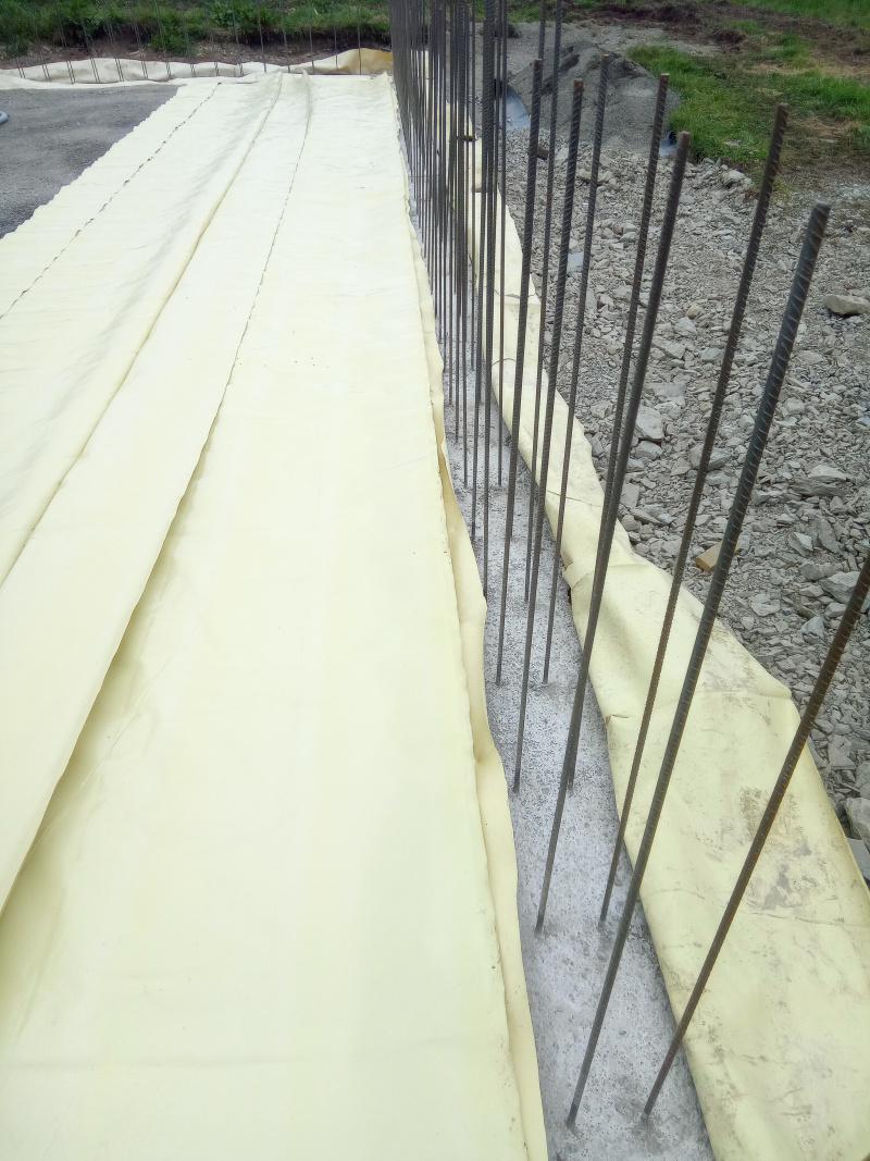

Next day stripping the 8x2 was to be honest, a pain in the ass. But a few hours later all the shuttering was removed and we were ready to install the radon barrier over the sub slab joining it to the previously installed barrier now under the footing.
 Sand blinded, and then added 20 ton of 40mm be to dust in preparation for the slab  after the foundation block pour.

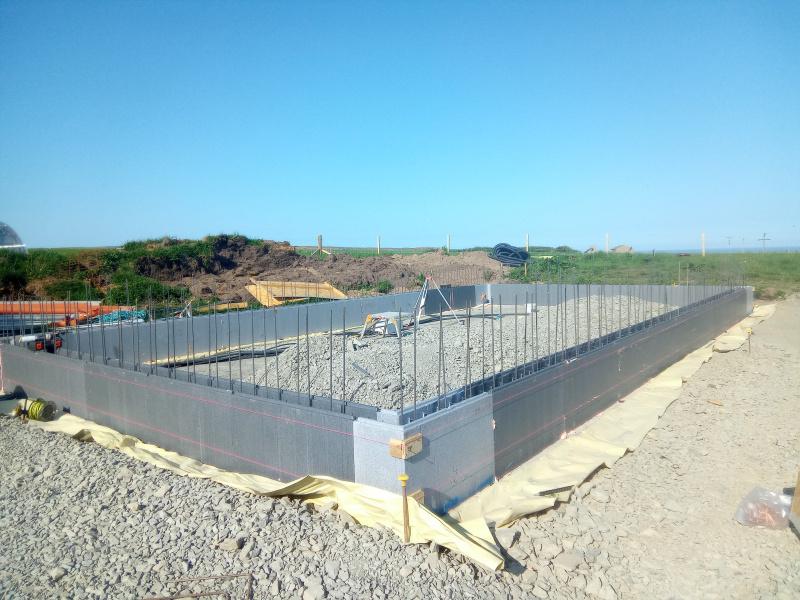

Installing the poly block we loosely set all four corner blocks, leveled them using plastic folding wedges, and measured the lengths, widths, and diagonals. We strung string lines around the blocks to ensure the corner blocks were in line.
We sprayed the footing with marker paint, and then marked the blocks in position onto the footing.
Then one by one we set the blocks in position and fixed in place with fire rated expanding foam.
Checking the level with a laser level  and double check with a dumpy level.

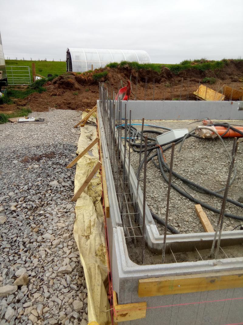

Next day we filled in between the corners, gluing the blocks in place and ensuring the blocks are straight level, again using the string lines and levels.  We cut holes for drains, ducts, and sealed the gaps with foam.
The poly steel block are t&g and also come with clips that lock  the blocks together.

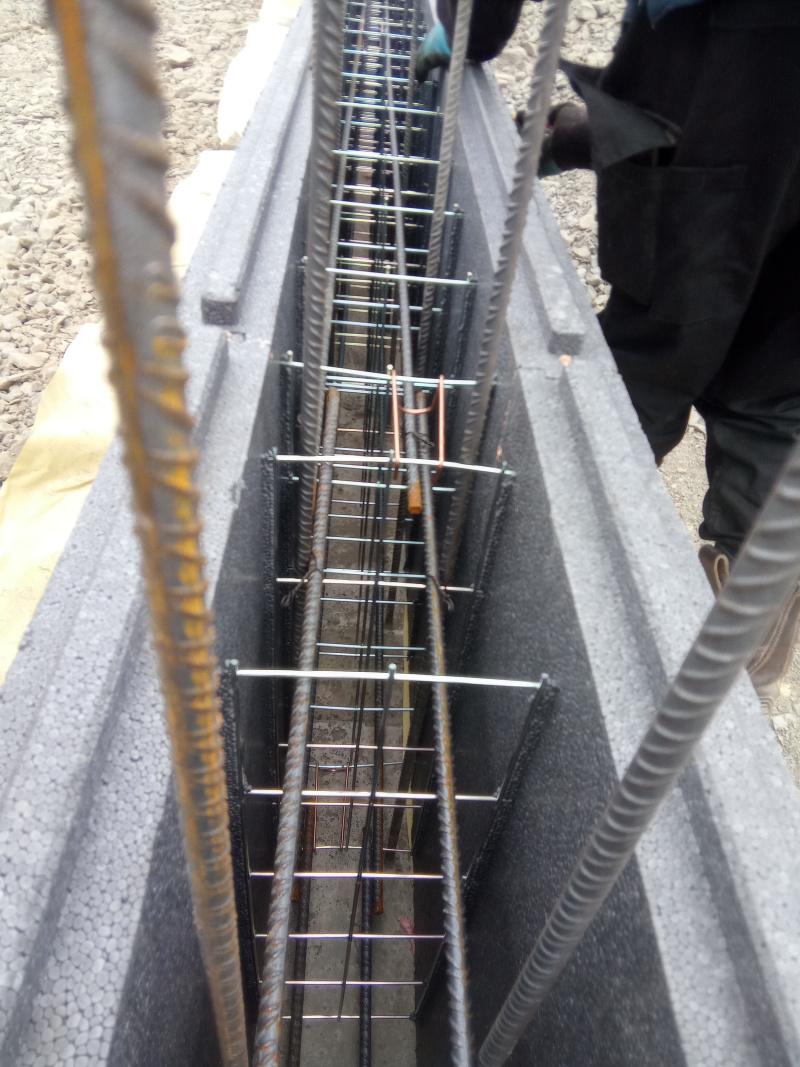

Before we closed the sides we needed to feed in horizontal H10 rebar🙈.
We tied the horizontal and starter bars together, and also tried the rebar to the metal grids in the blocks.
To close the runs the blocks needed cutting, luckily our cuts didn't cross the metal firings in the block, so it was simply cut with a hot knife.
Then glued (foamed) in place.
These cuts were braced with 4x1 screwed into the metal firings with bay pole screws.
Foundation course in place.
Mandy starting to tie the bars, you can also see the clip between two blocks.
