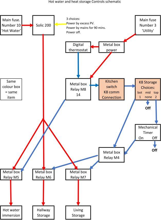

PV to hot water and heat storage controls schematic:
This system only uses the excess PV power (unless the Solic 200 button to use any power is pressed, and then it will allow any power for 90 minutes).
There are three output choices. Firstly to the hot water tank immersion until the tank reaches the temperature set point, then to one of the two storage heaters as chosen.
Although some people have mentioned that the Solic 200 (other types I cannot comment about) will limit the power through it, this design is limited to one output at a time which is a maximum of 3kW.
When the hot water tank has reached its target temperature the controls automatically offer the excess power to the MK 3 way switch( K8).  This part of the system is designed for our home.
The choices are power to the hallway day storage heater or power to the timer which switches between the hallway and living room one.
Today we stored about 2.8kWh for overnight heating.
Any questions, let me know.

It seems a little over complicated.  In winter you won't get more PV than the cylinder will store, and in summer when you might, the last thing you want to be doing is heating a storage heater.

If I had PV, I would let the DHW take priority.  I am happy to let the house float around 19°C at the moment, which is 1°C lower than in the past.

Can't comment on the complication of your system, I can't follow the sketch.

But the controls don't need to be so complicated.
Simple changeover relay that is energised by a tank thermostat to swap the PV diverter output to something else (the storage heater) if the tank reaches maximum temperature.
But I wager there will be very few times this happens except in summer when you won't want it.

It depends on how you use your HW though. Early morning showers at any time of year will require the import of power and in the winter this may leave the cylinder close to full. It's just not easily predicted. If there is any spare PV, a cascade priority system such as this makes perfect sense to me.

Hi @ProDaveYes very complicated.
Your quite right, I forgot to show the heater control switches.20230109_164807.thumb.jpg.a140bdd9dfc62b503a00b6080eeffd53.jpg
Yes I have trouble..
The design is to protect the relays from over amperage.
Actually today the tank was heated and some went in a storage heater.
