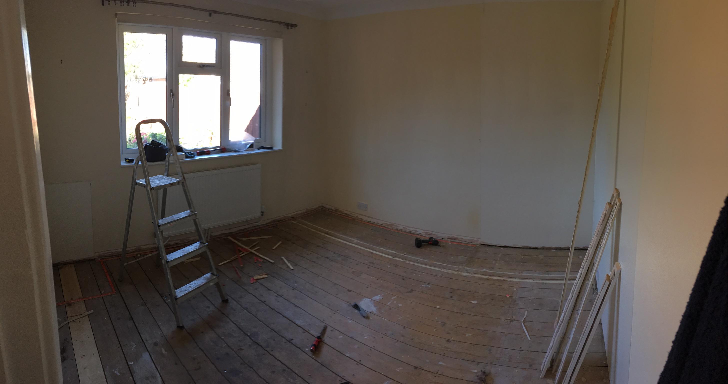

This was a before photo once all the fitted furniture was removed

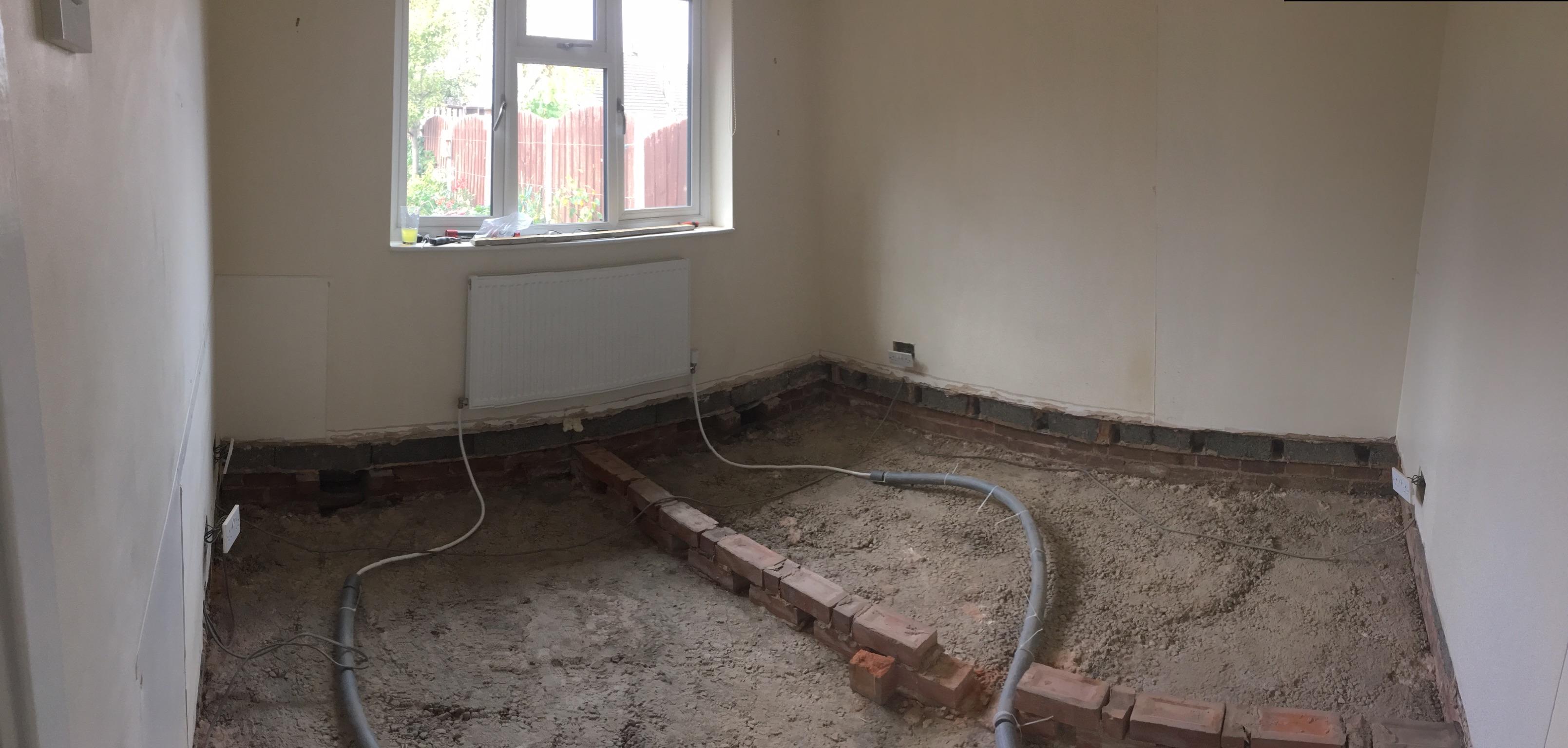

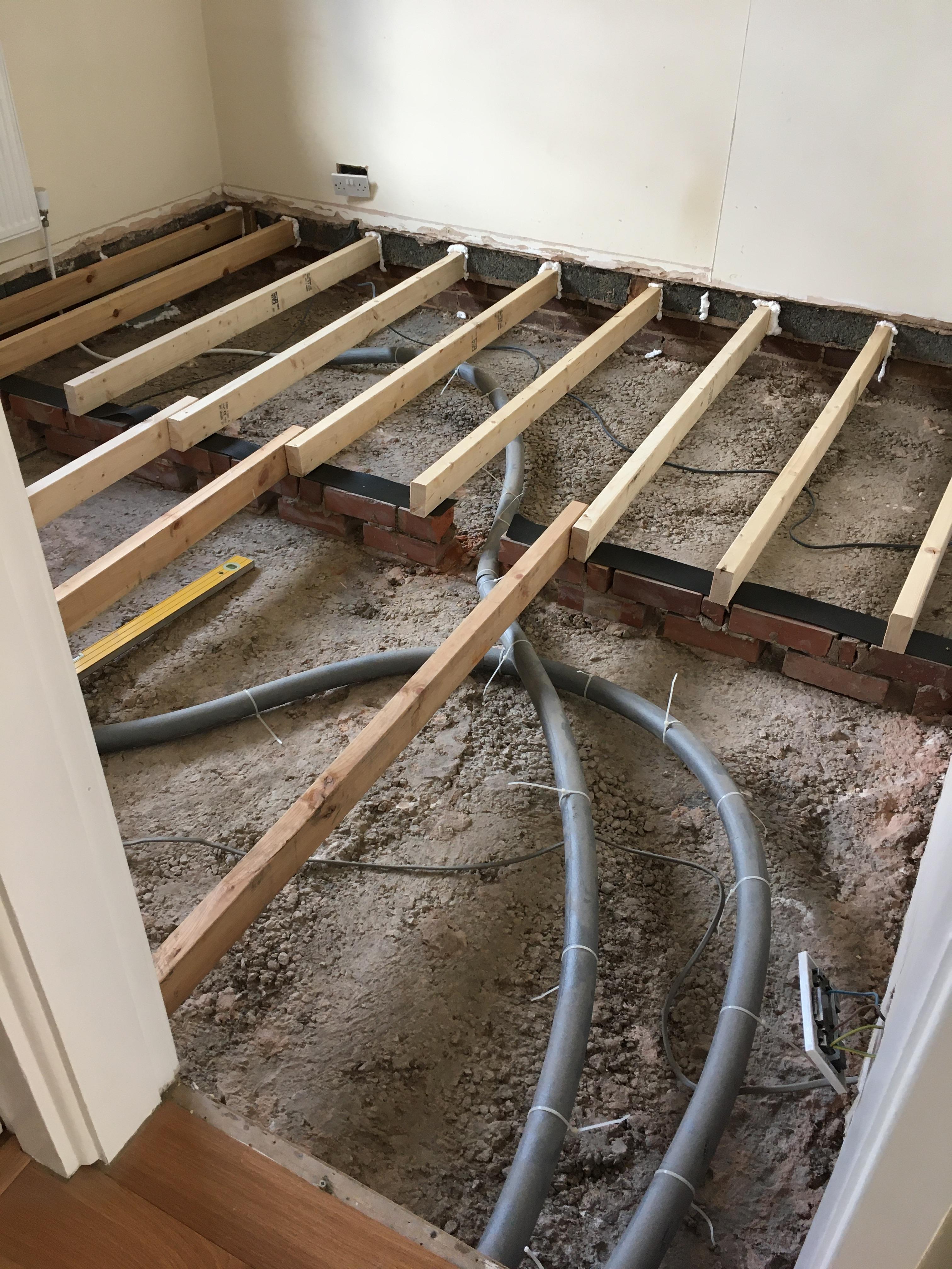

Everything stripped out, and underfloor fully cleaned and hoovered

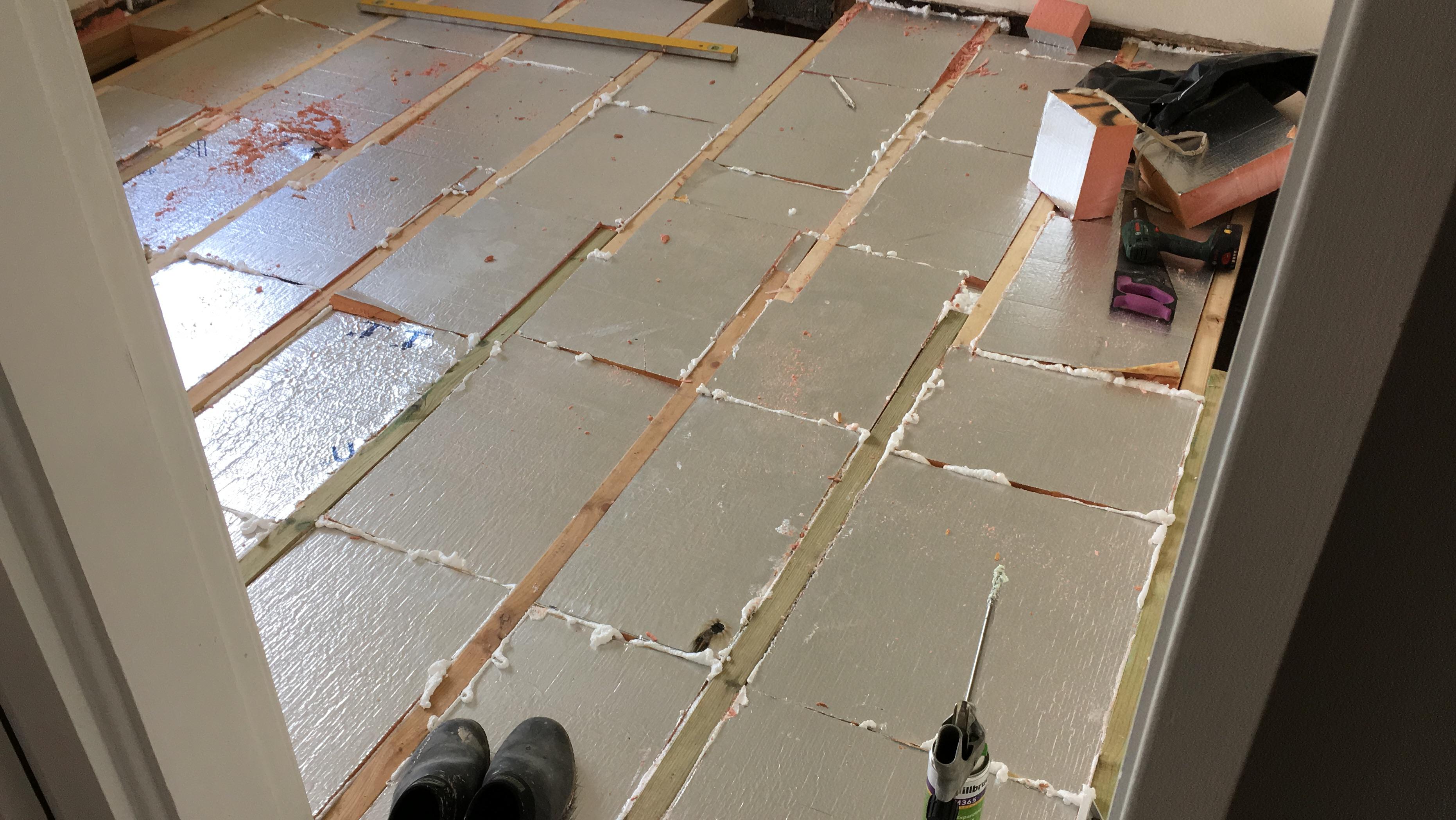

New timber put in which has been post-delivery treated (bloody builders merchants delivered wrong stuff and then couldn't get hold of them to complain!). All plug sockets also rewired.
Majority of insulation in, and foamed with flexible FM330 foam.

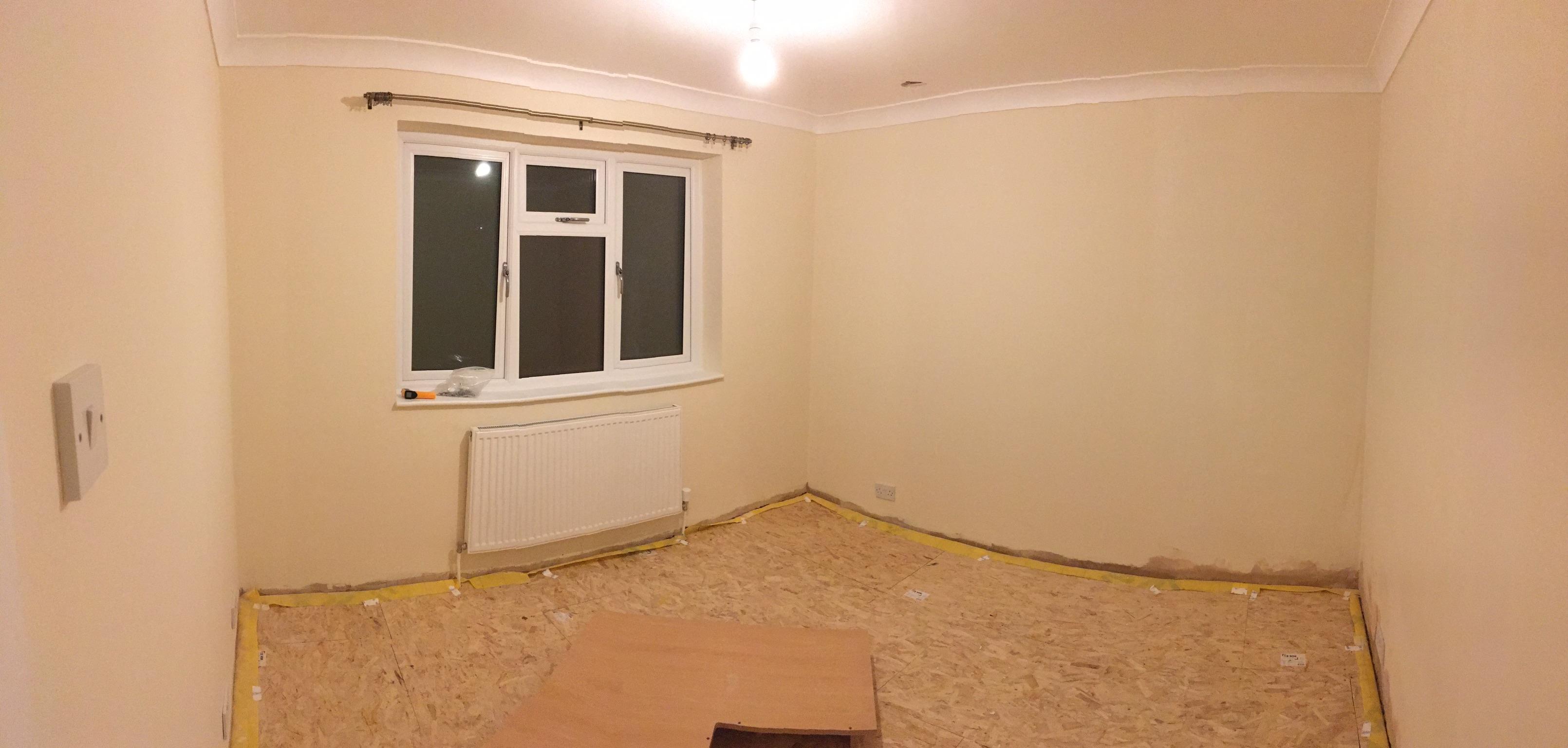

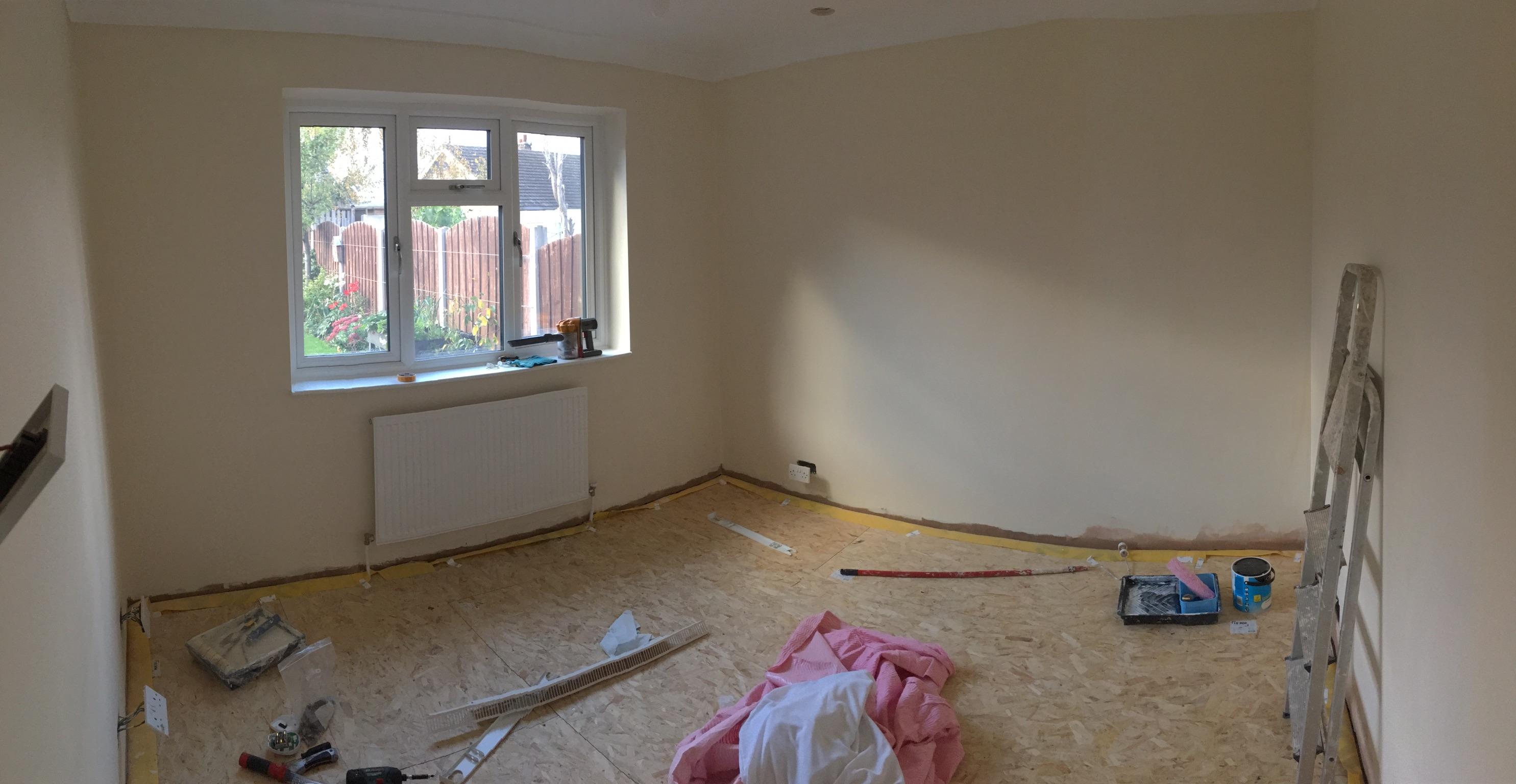

Airtight membrane and floorboards installed. Perimeter plastered to cover where the skirting board pulled old plaster off during removal.

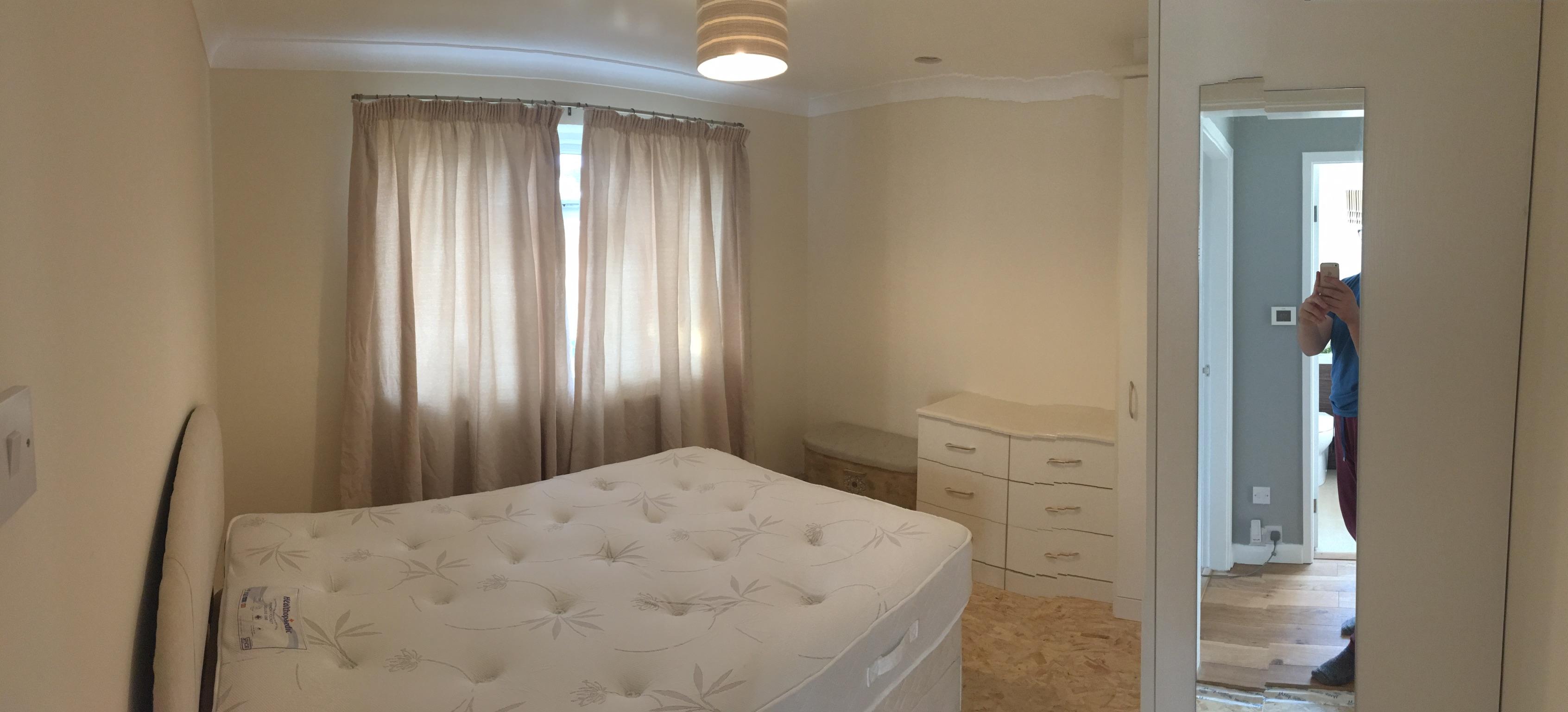

Everything decorated, and curtain rail reinstalled.
Job complete!

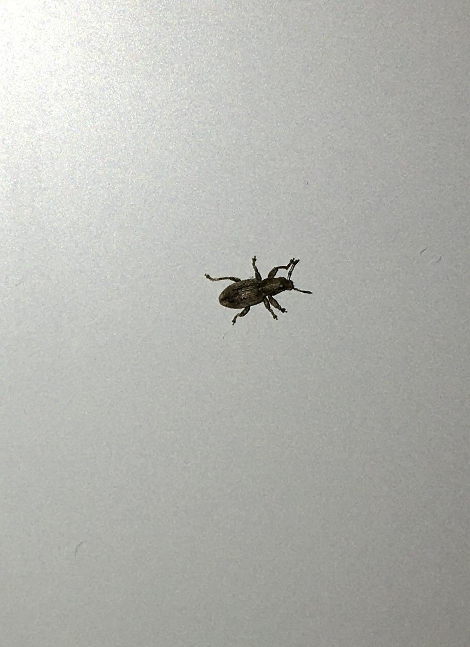

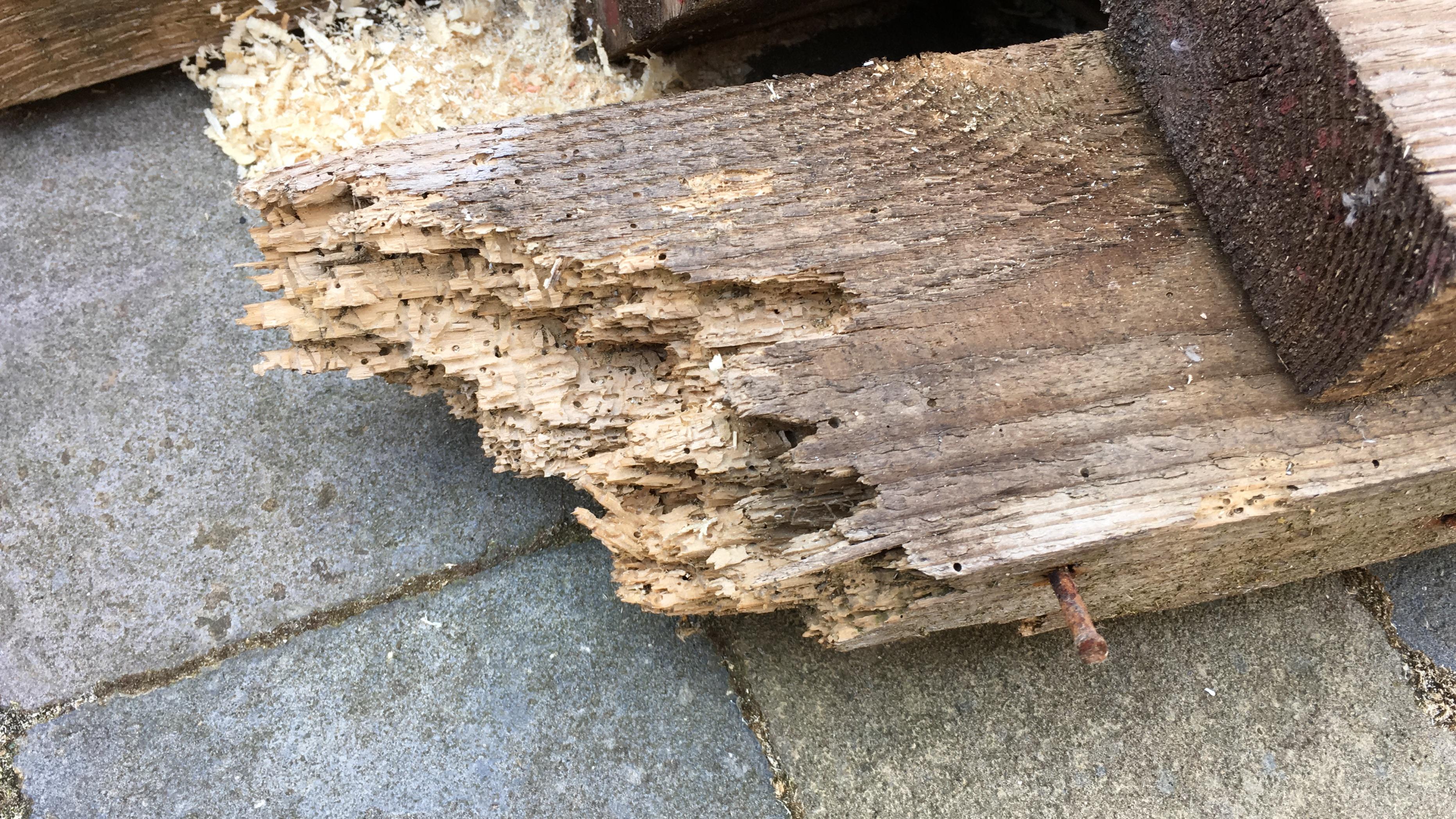

And the reason behind stripped all of this out!
A couple of days later I found this crawling up the fridge unit in the kitchen!! Pretty sure its an adult woodworm beetle.

Well done mate, grand job. My friend recently bought a bungalow and had a full structural survey (£900) which found a few roof problems, on moving in the removal man (carrying a tv) fell through the floor!!!, turns out the whole ground floor was riddled with woodwork and all had to be replaced. They tried to claim from the surveyor but the reply was “we are not allowed to lift carpet so could not see it” .?

Yeah its a horrible thing, and not covered by normal house insurance. The people who had the house clearly knew about it, as there were sections of timber which had been replaced in the bathroom, but of course nothing was said.
Its not the end of the world I suppose, at least I can sort it myself, and having done the loft, those timbers are all OK thankfully! I too have fallen through the floor in the existing kitchen, one of the floorboards was so bad.
We never paid for a survey, i've lived on the street all my life, so I know the houses well, and my dad was a builder, so we just had standard valuation, i don't think we would have found anything else out having paid for a survey to be honest, all the bad things have been covered up which i'm now uncovering and fixing.

How have you dealt with potential moisture permeability in your new floor?
Was the strategy been with close off the airbricks to keep moisture out, or perhaps deem it to be marginal given the use of PIR?
Air bricks are fully open, the original ones which were built in with the house (one double airbrick either side of the sleeper wall), but they had piles of soil behind them due to previous owners building the level of the patio up, which we reduced in height when we first bought (there was 5 layers of different materials patios under there!!). I've also lined the airbrick channels with Marmox Multiboard to stop anything dropping down from the cavity, and also to stop air going up quite as freely into the cavity.
Remaining build up is:
Treated Timber with 100mm Phenolic foam
AVCL in the form of Protect Barriair Membrane
18mm OSB3 TGV4 Floorboards
