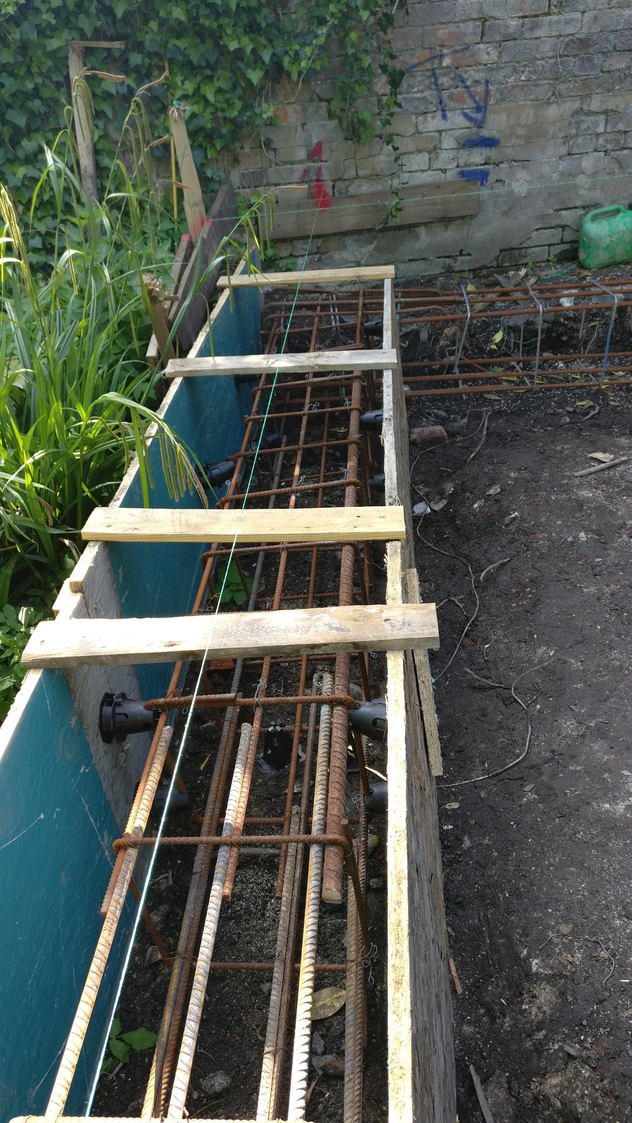

above ground ringbeam . Underground Drainage and shuttering.
Patrick
1542 views
IMG_20200424_173631.thumb.jpg.815799b43ad85549b211f7d6965c656b.jpgSo finally managed to update the blog. Seems like nothing happened , but a bit of progress still.
Now just have to get this monstrosity past Building Control . Challenging task but I will manage. As always. I can tell I will not become a Groundworker in this life . Or the next.
http://tintabernacle.blogspot.com/2020/05/rc-beam-or-ringbeam-preparation.html

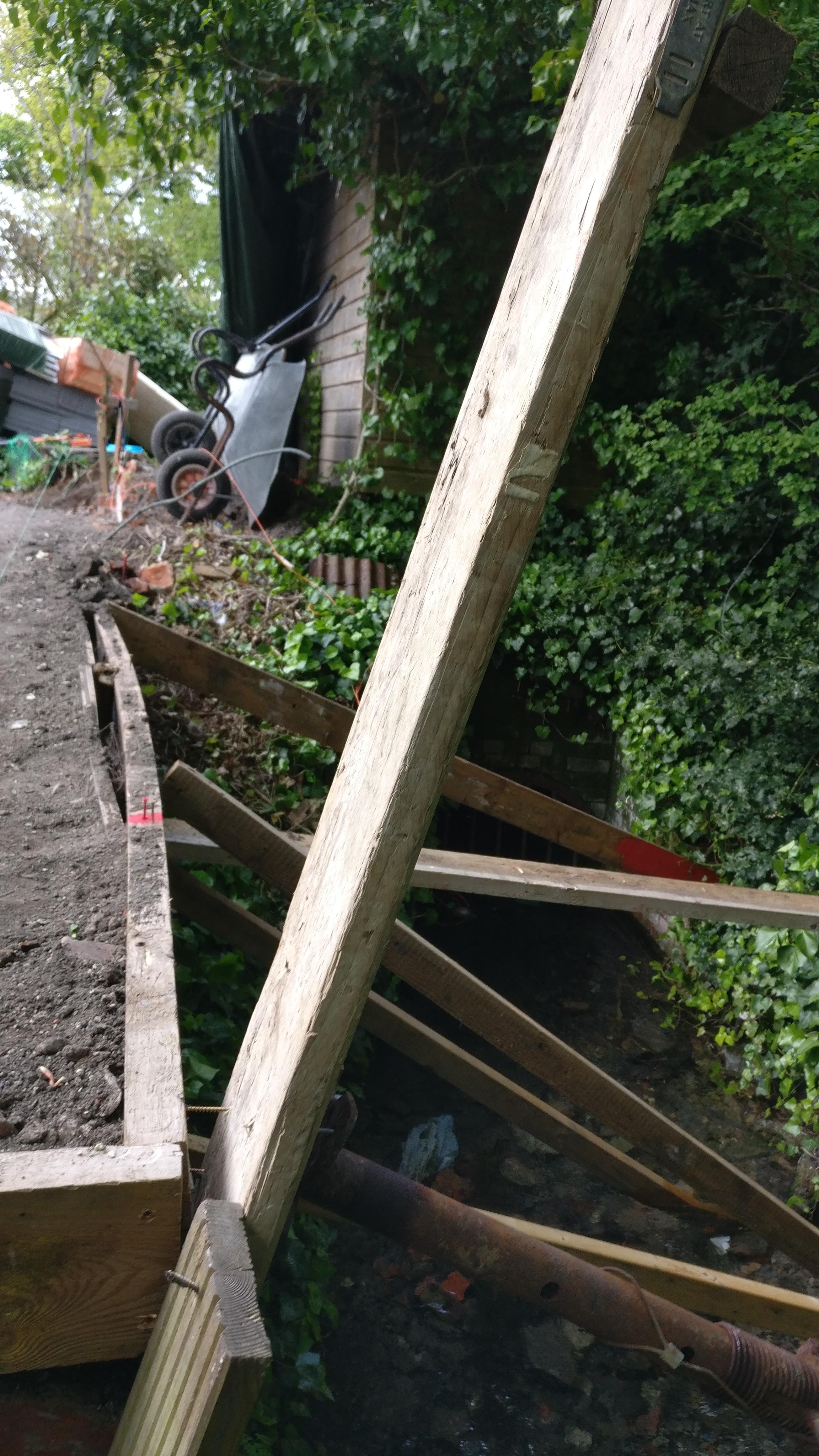

Here are some entertaining pics from this :

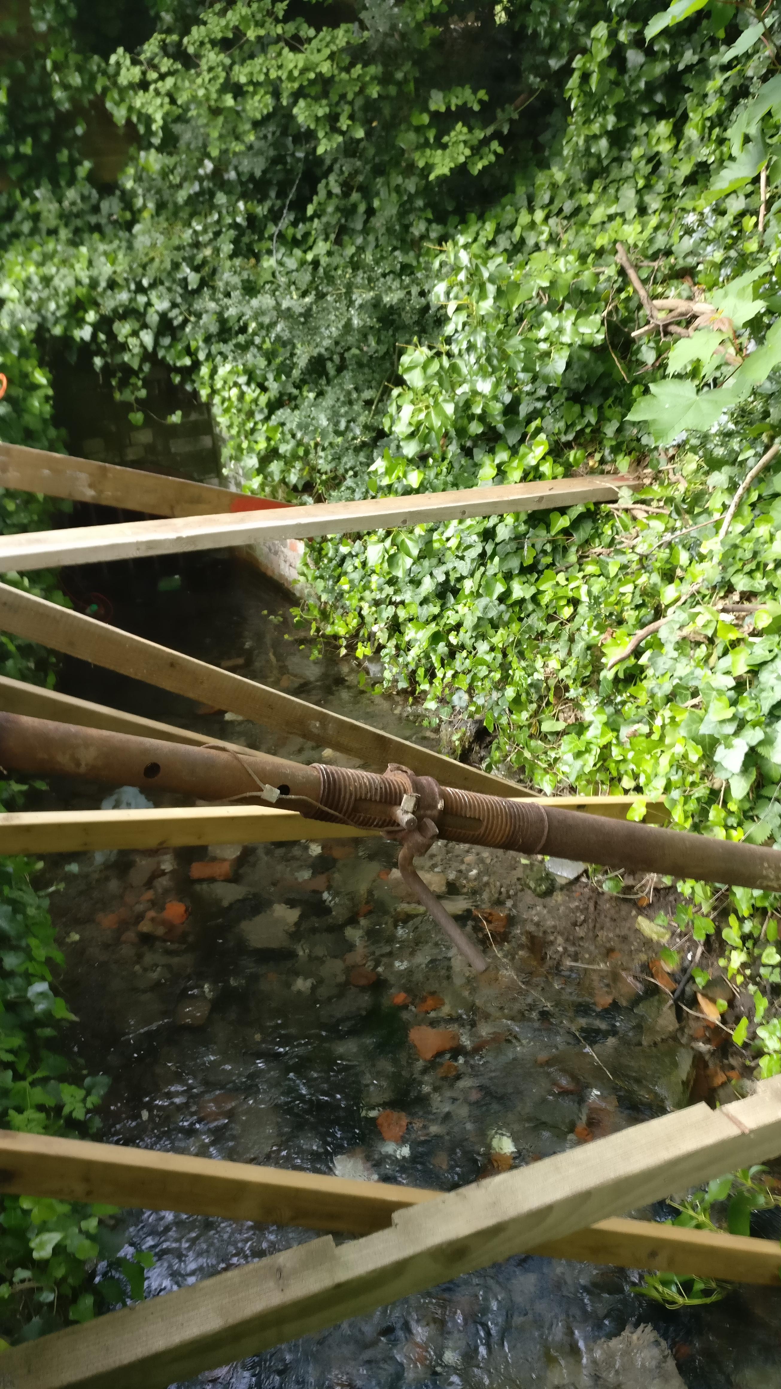

Above ground shuttering takes a bit of timber
Give over - it s gonna be inside a pile of concrete anyways ?IMG_20200424_173634.thumb.jpg.77e93ca398e61738ed3111f49ae0652b.jpg
Let s just assume this will hold.
