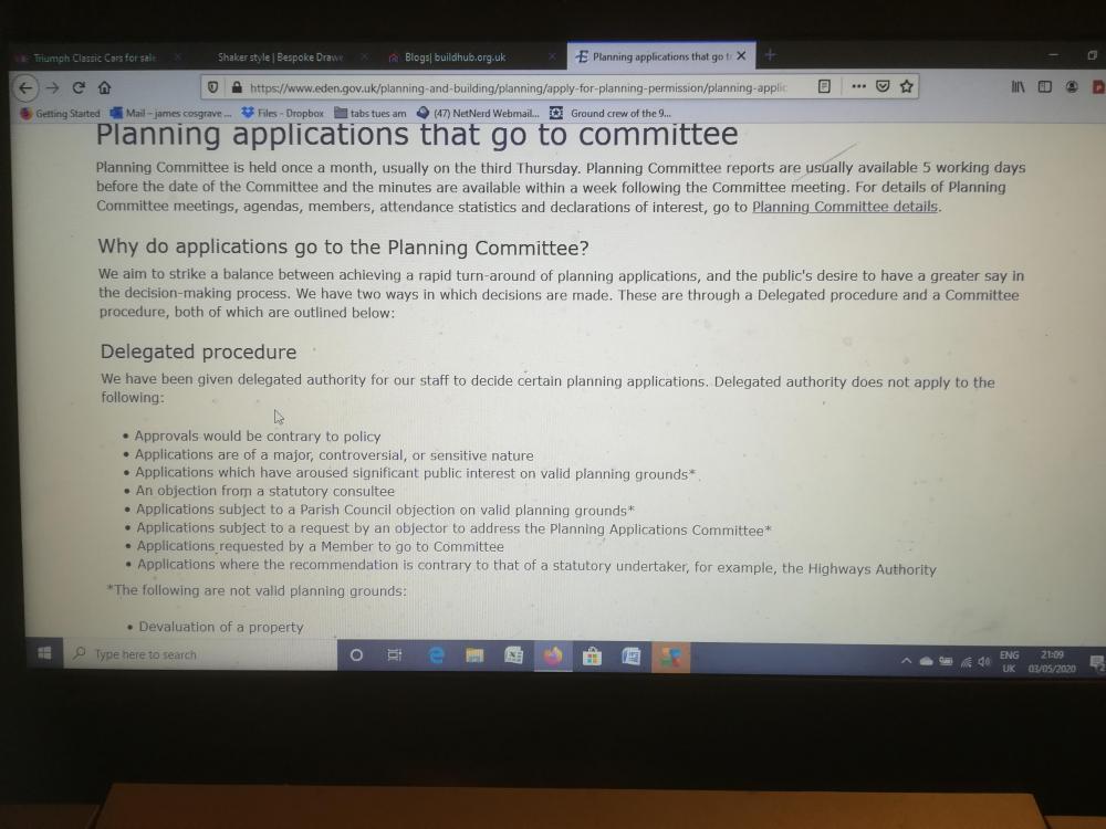

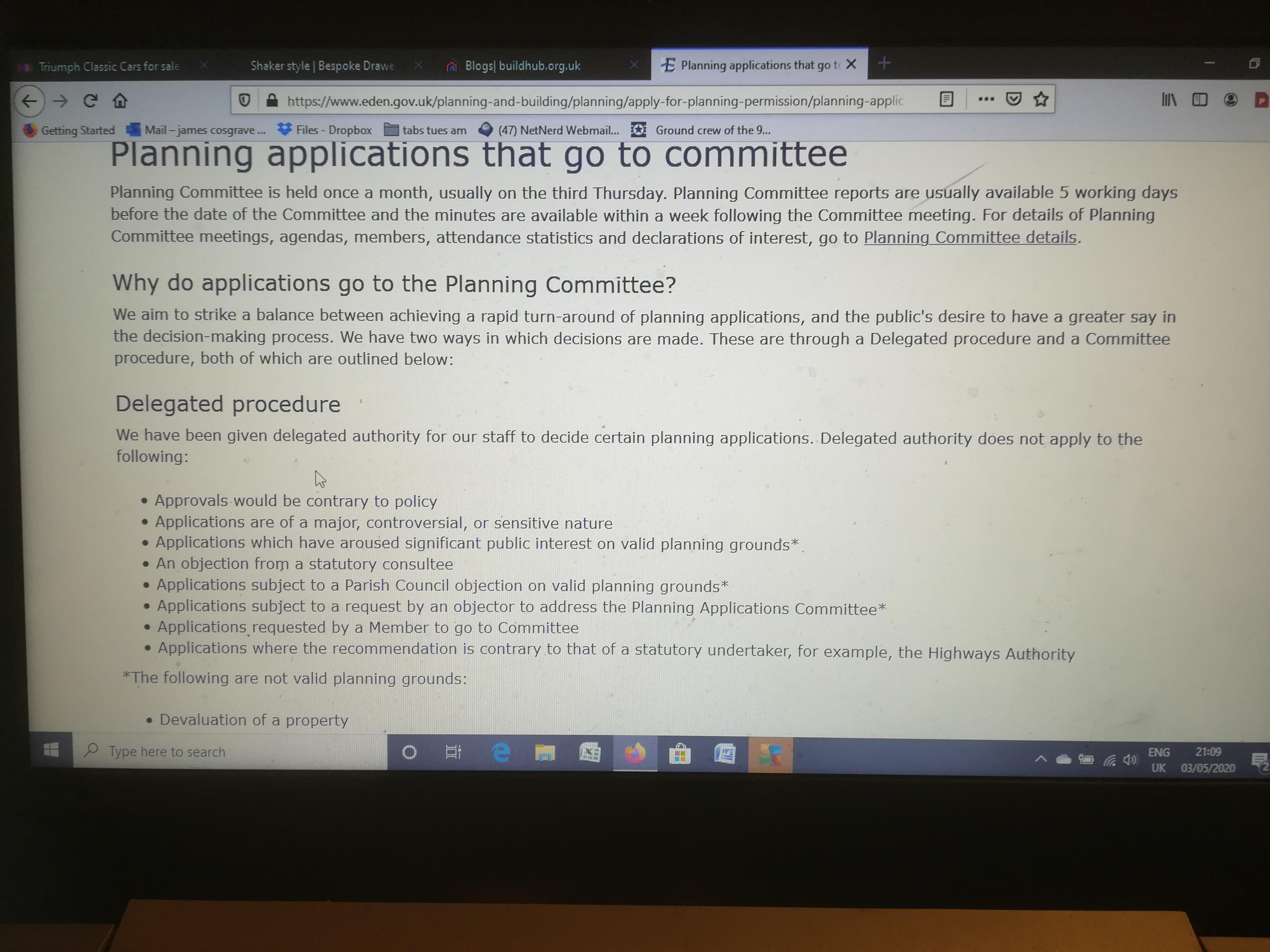

You keep saying that Jeremy, and in the case of your local Parish Council that may be the case. However, in mine, and several other councils, an objection from the parish council, means that an application HAS to go to the planning committee. A total waste of time and money.....All because jumped up twats who sit on Parish Councils.....

Jeremy, have you bothered to read what i posted ? Eden..... clearly says that a planning app will need to go to comittee if the P.C. object to it....What am i missing here ?

Eden district council is a local authority Jeremy.............They decide on planning apps for several areas
You're missing the point, though.  You're now talking about District Councils, that have employees, manage and run planning departments etc, not Parish Councils, that can do none of those things.
