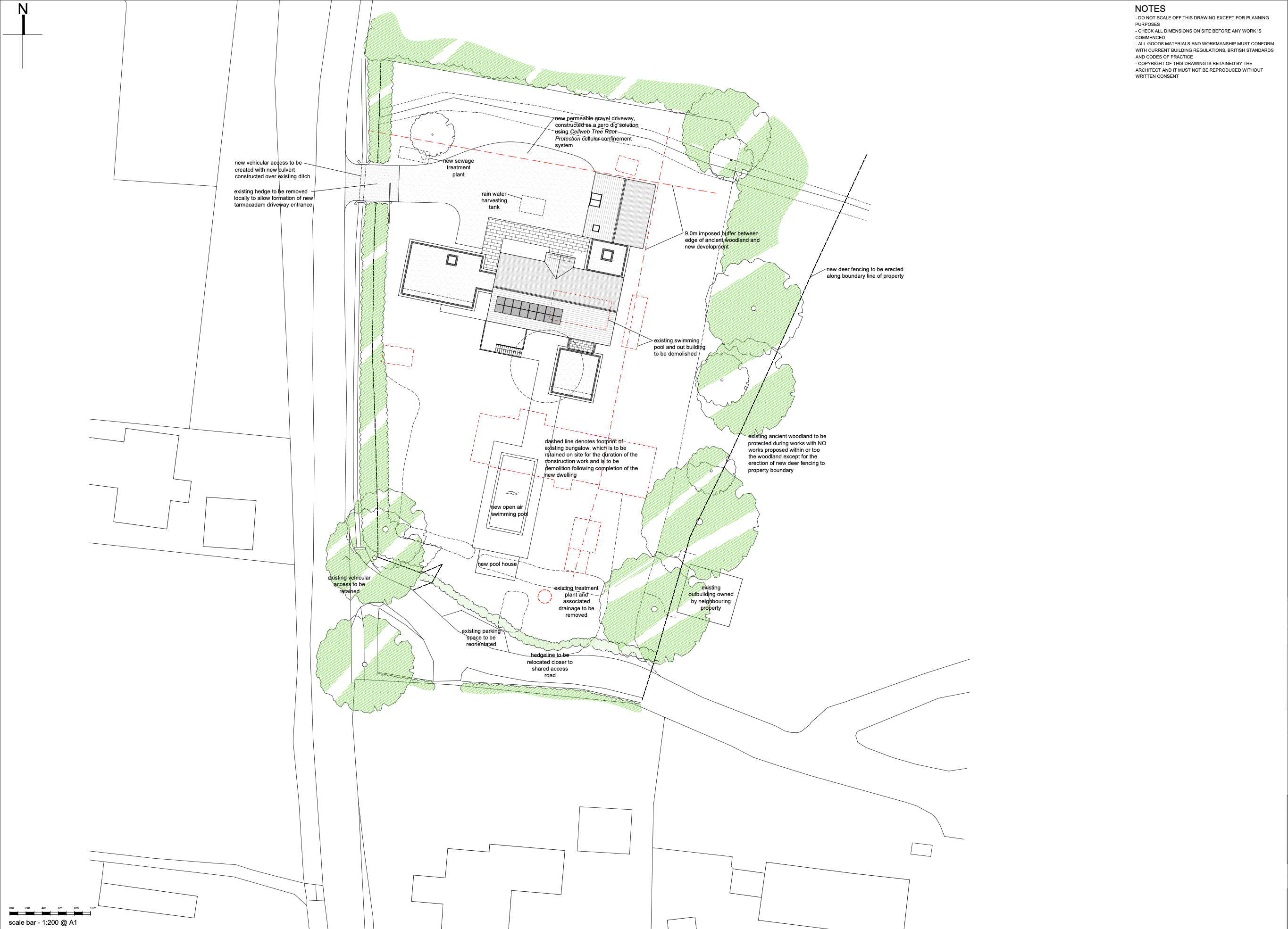

Anyway, on to the plans...here is the site plan

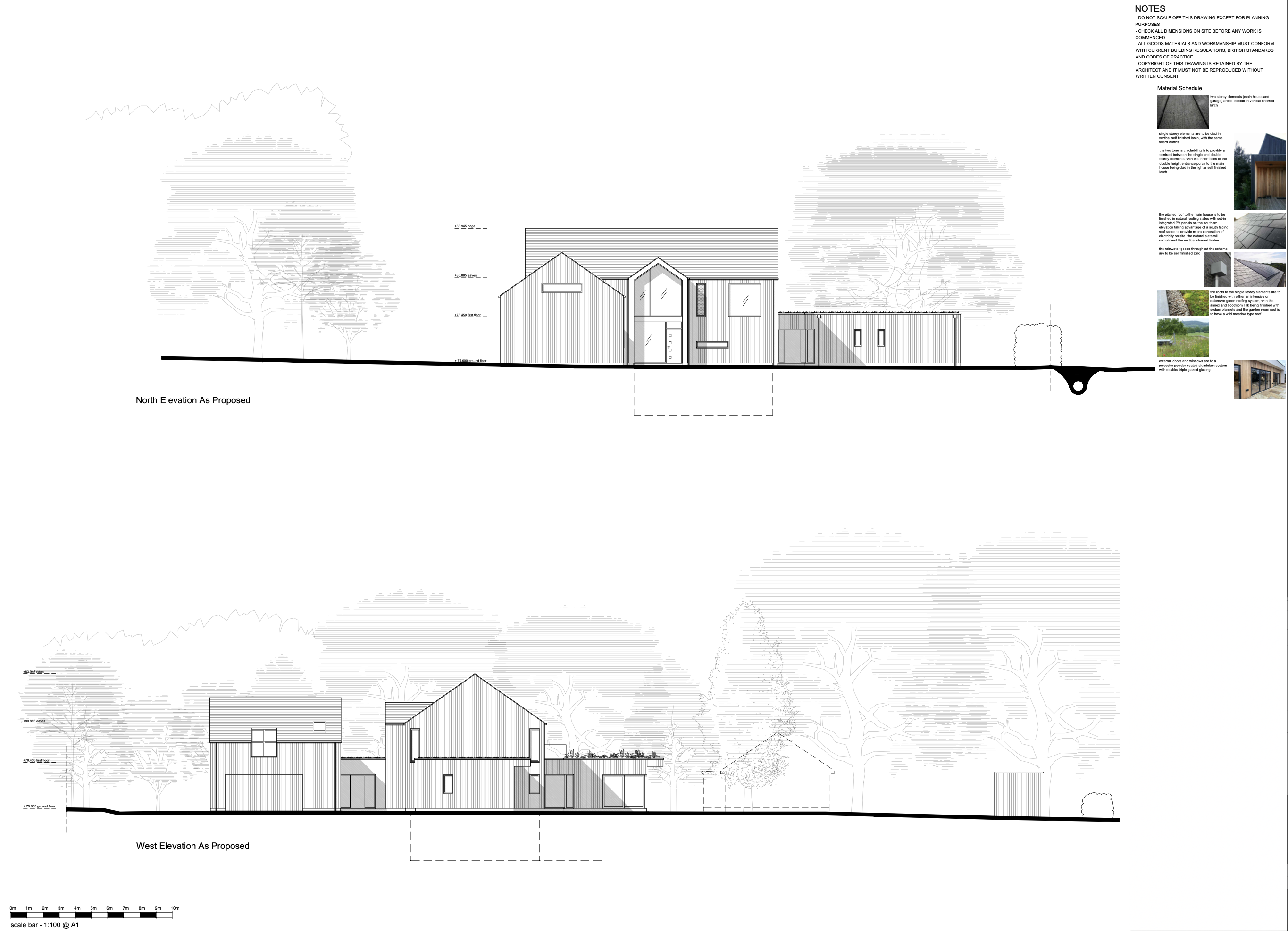

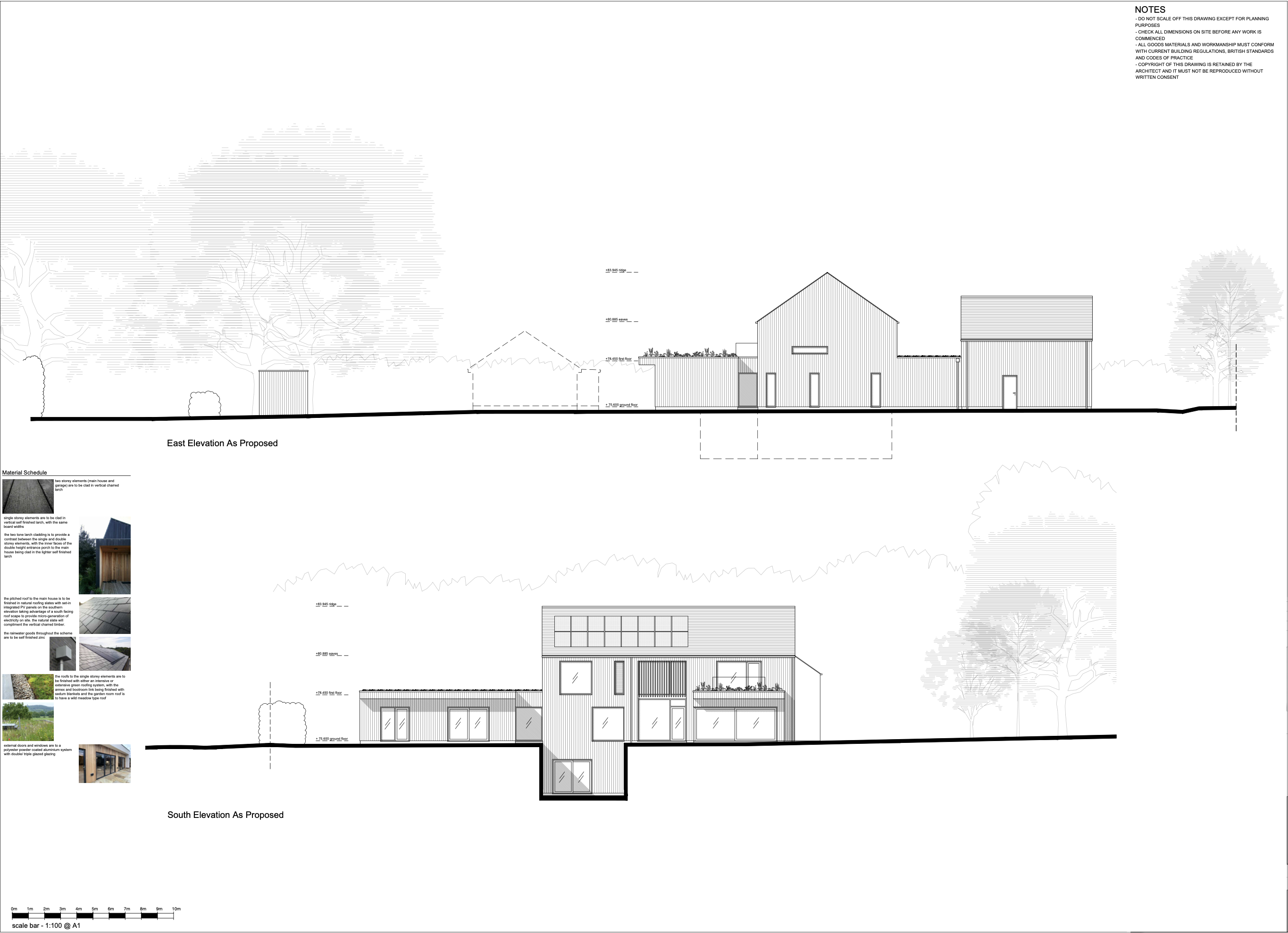

and the elevations
473969313_Screenshot2020-04-24at10_29_28.thumb.png.ddcb42edd8117e9c7792df9fb879354a.png
458231123_Screenshot2020-04-24at10_29_57.thumb.png.2ffc4980510aefff84f96db1fca752cd.png
we love what the architect has come up with. loads of glass and a fabulous entrance and full height hallway and windows that go from the floor (although the quotes from the window companies are pretty high and, in some cases, are about the same as the timber frame!).

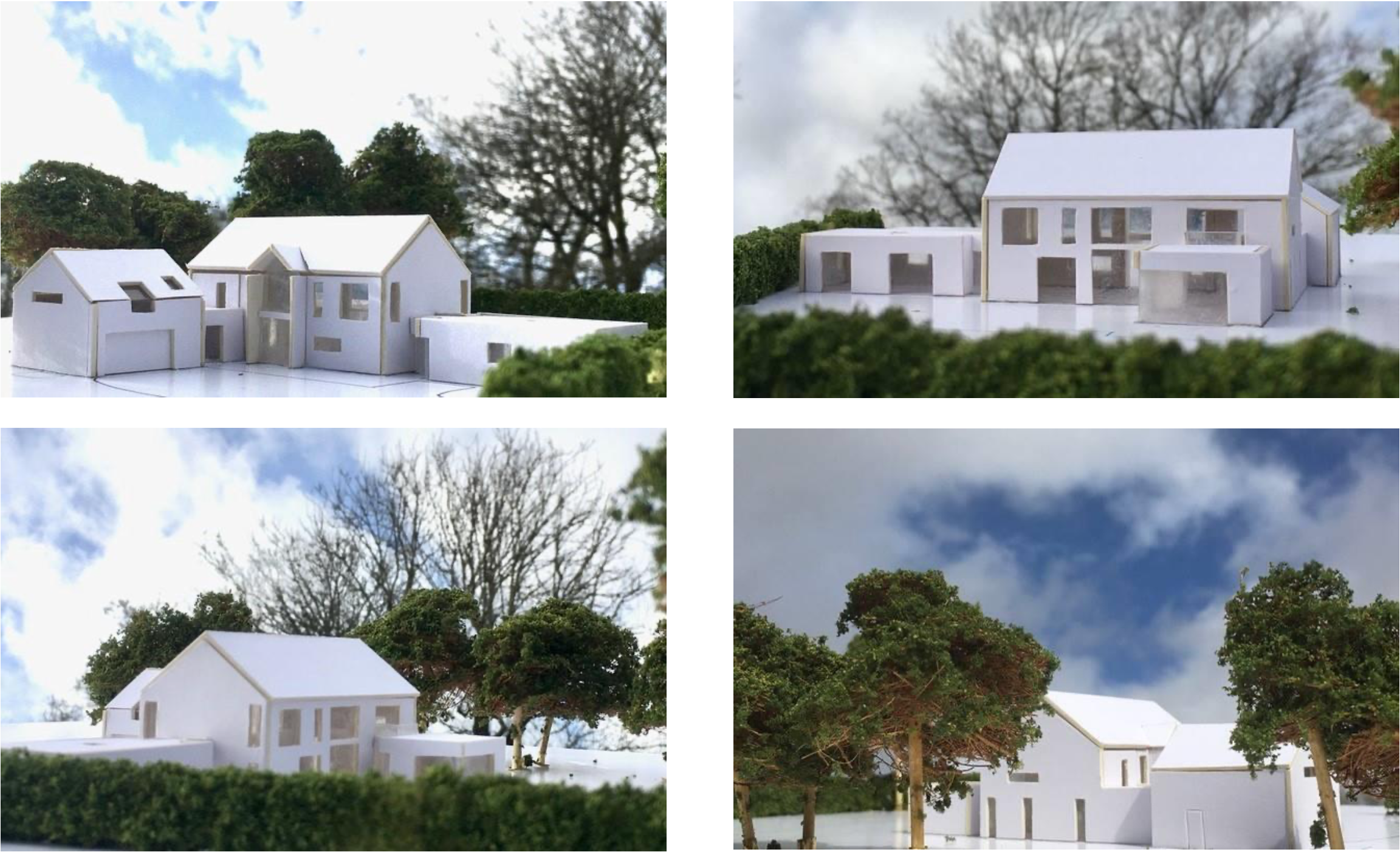

Forgot to mention that we built a scale model of the house (not including the basement), plot and surrounding trees and hedges. it was fun to do!
