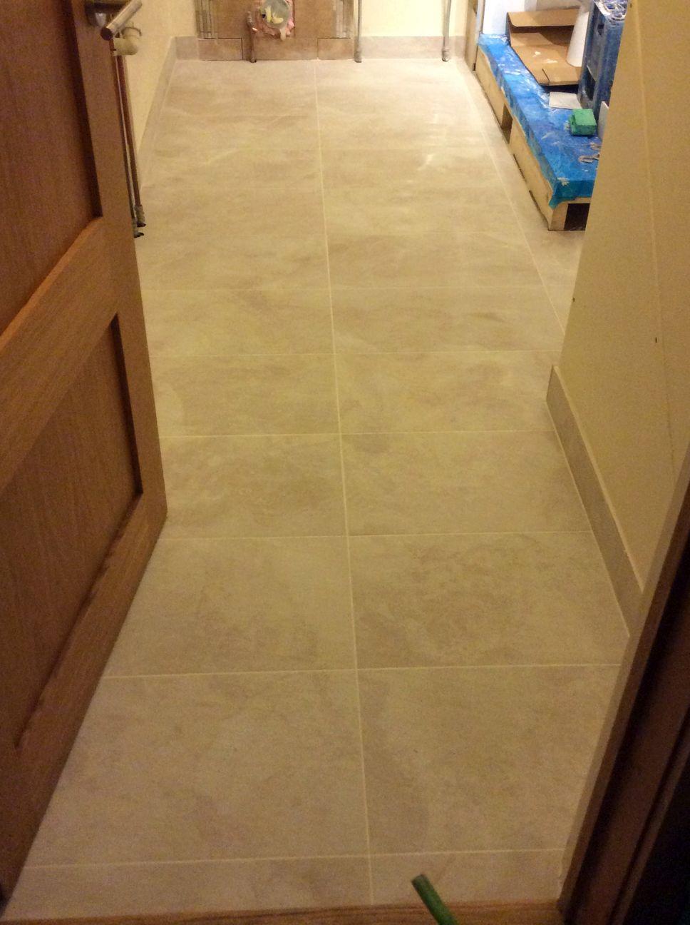

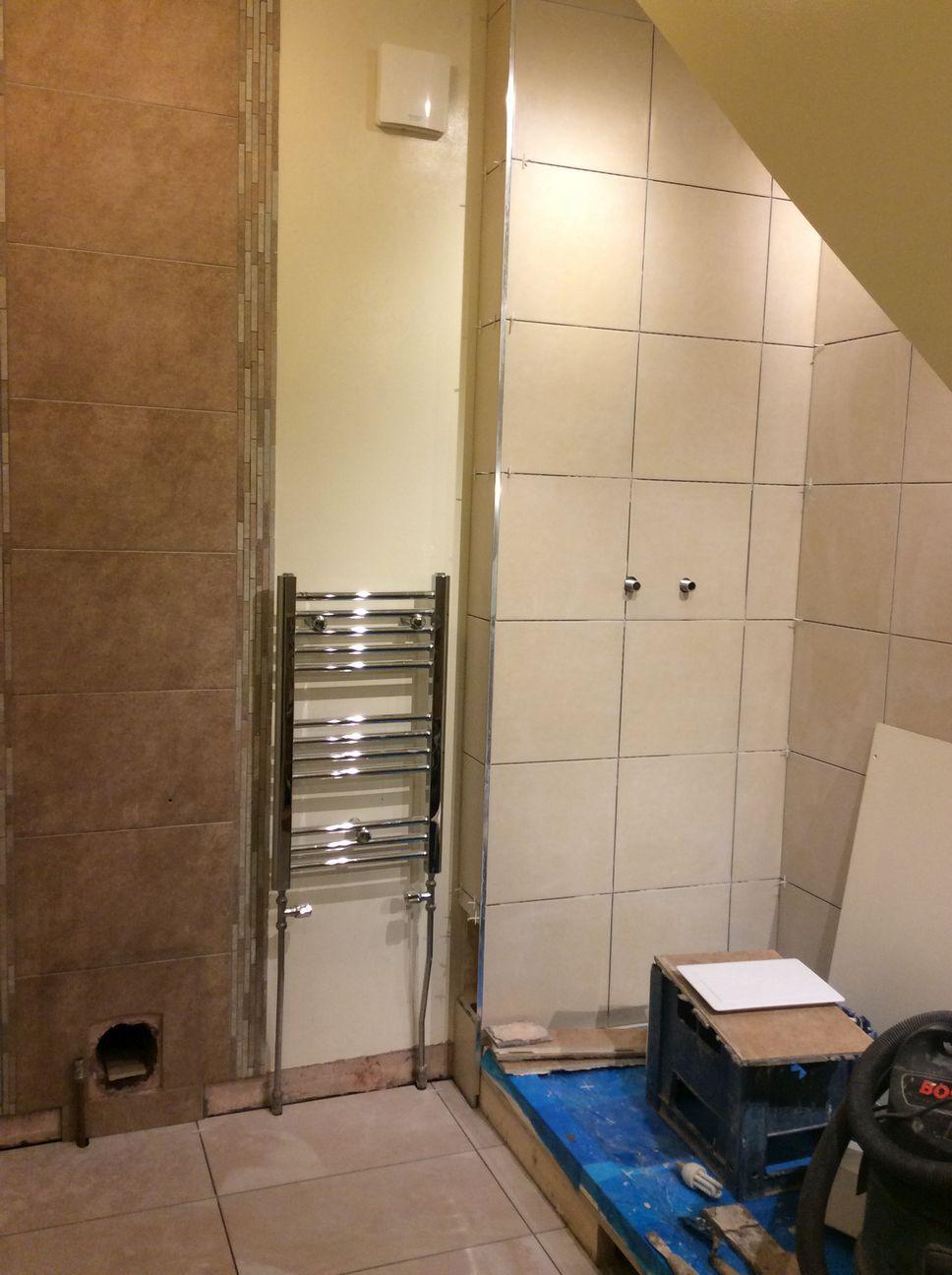

Tiling and grouting has been done, and it is now just to fit the shower, the loo, and install shower screen and those grab handles etc that we have obtained so far. Then it will a case of experimenting and putting the final touches in as the shower is used.

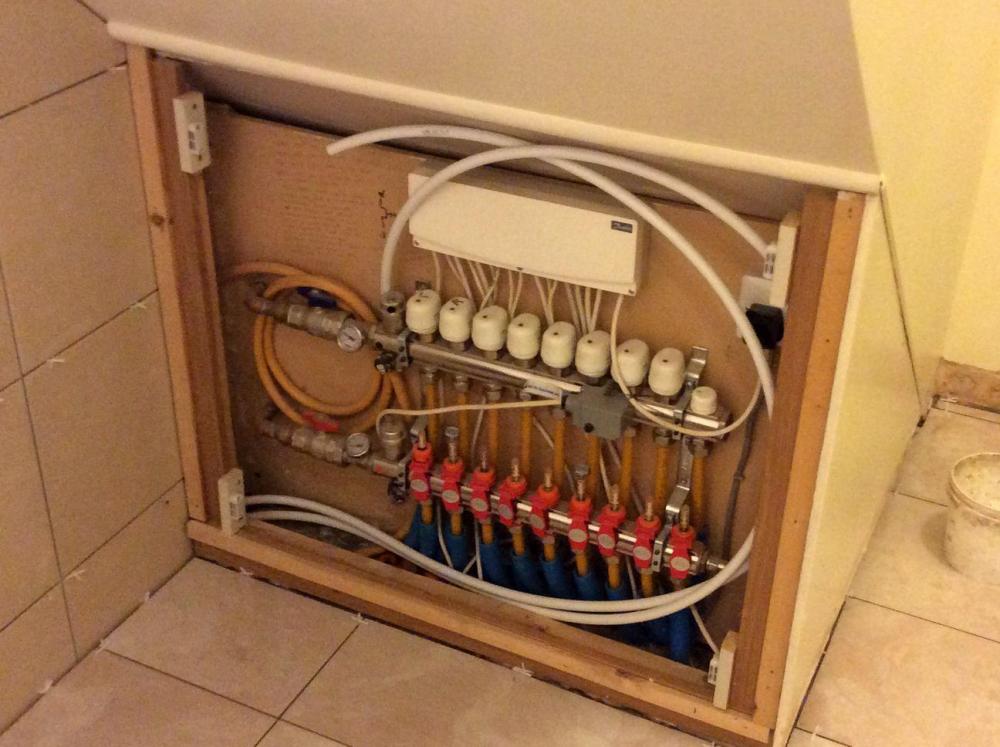

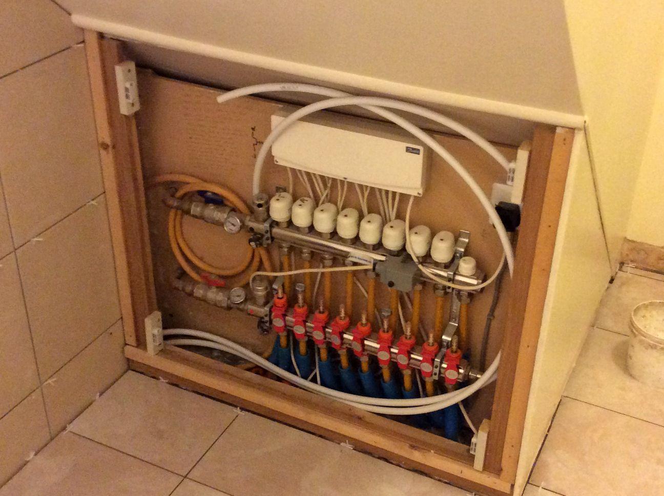

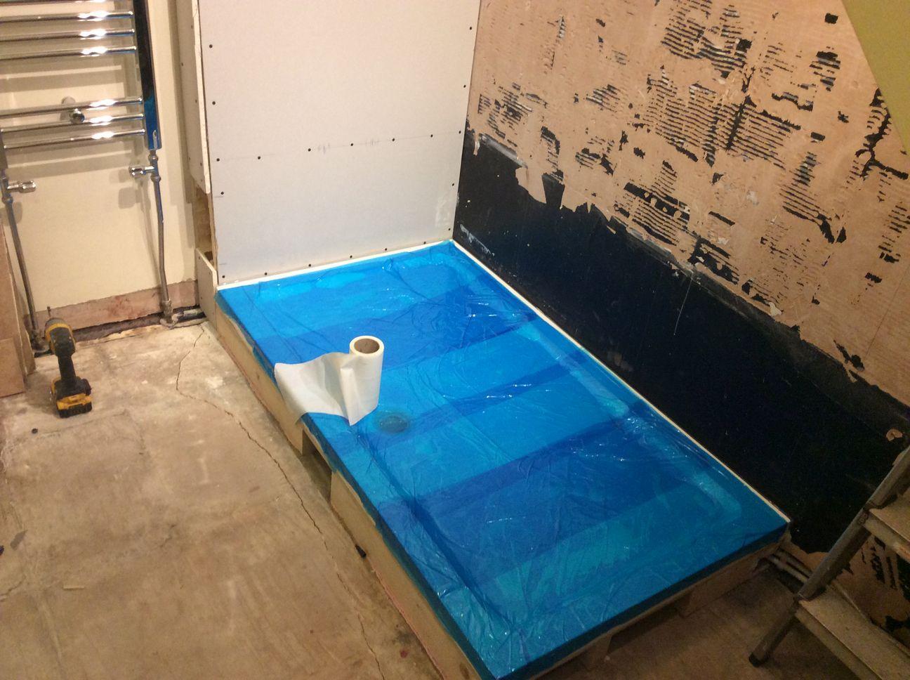

Two runs of pipe installed for the future just in case, which go through to where most of the plumbing related gubbins live beyond the other end of the bathroom.
Shower tray protected from the slings and arrows of outrageous fortune.

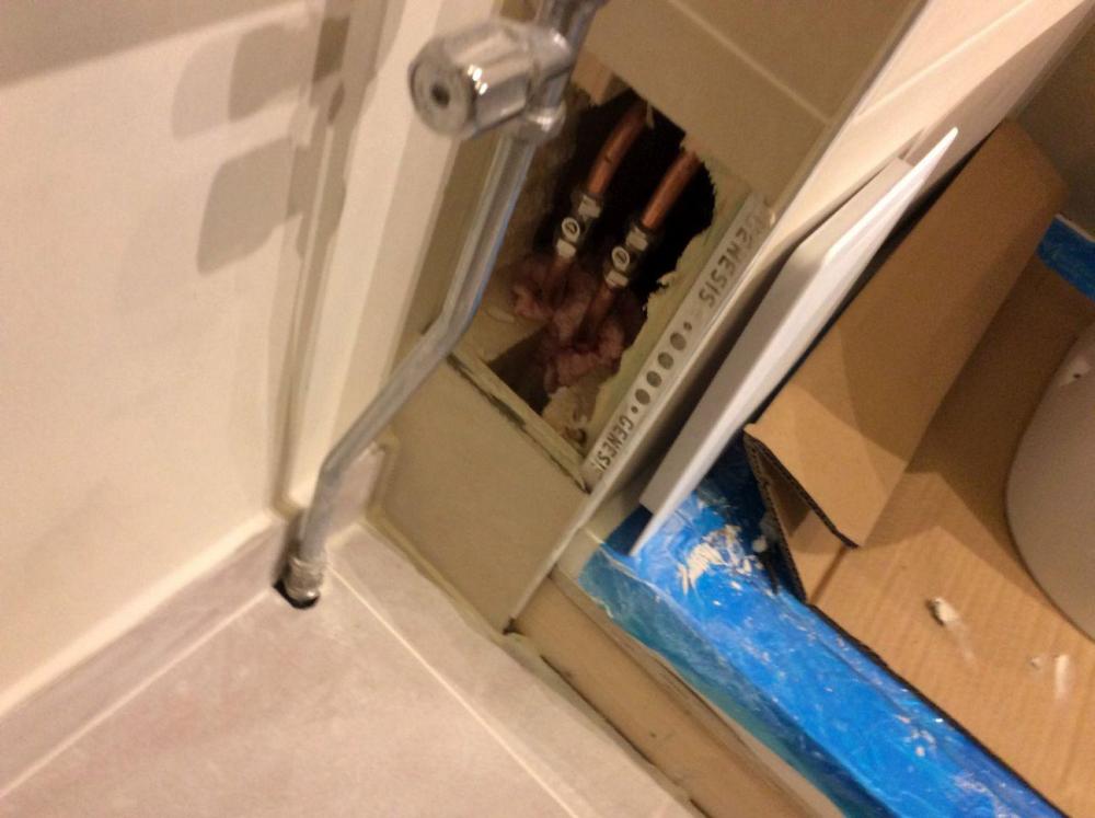

Access hatch for future maintenance
Give it a shout - get on and grout. It's Friday.

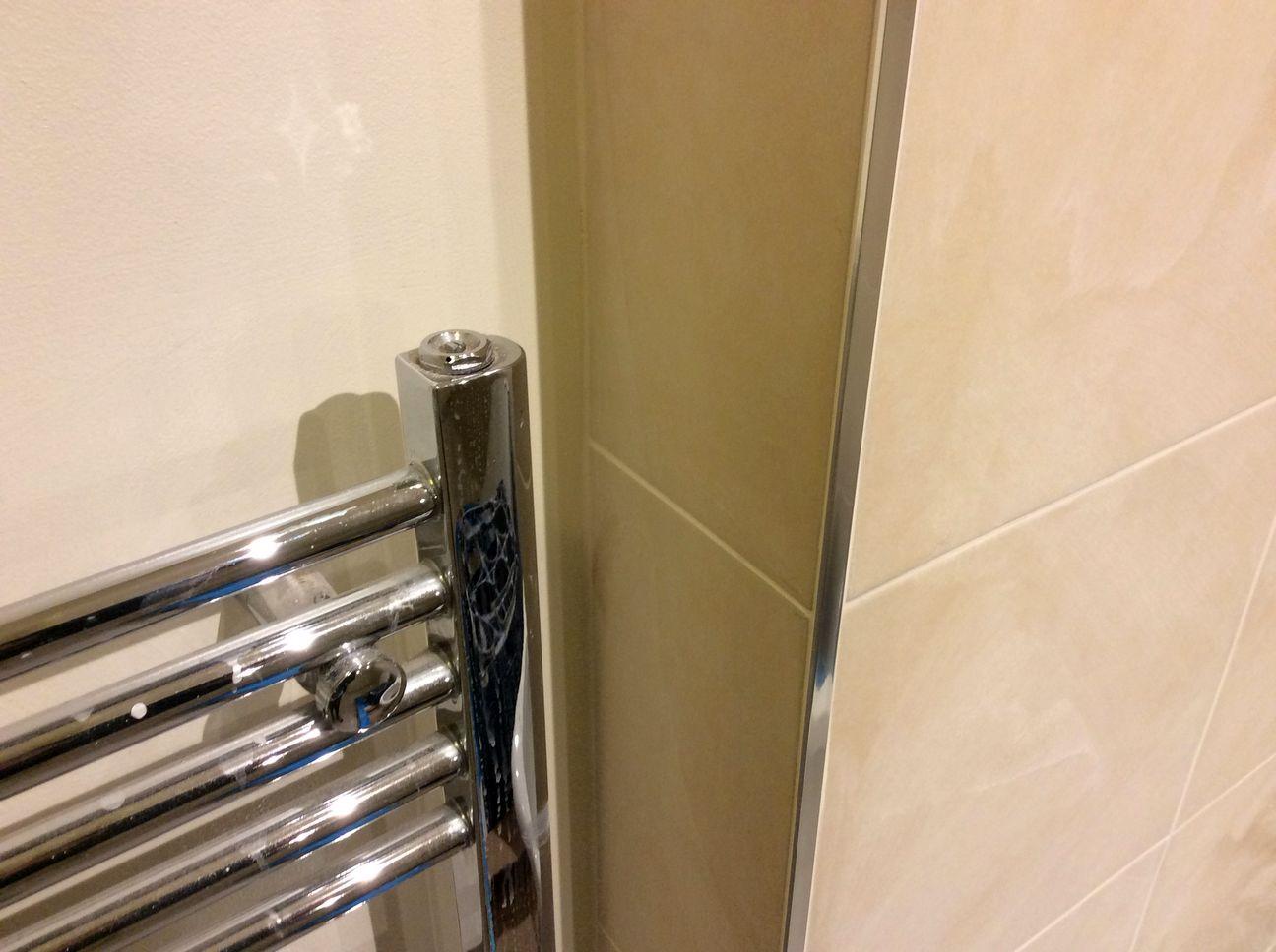

Nice corner detail
Stay out and let it set

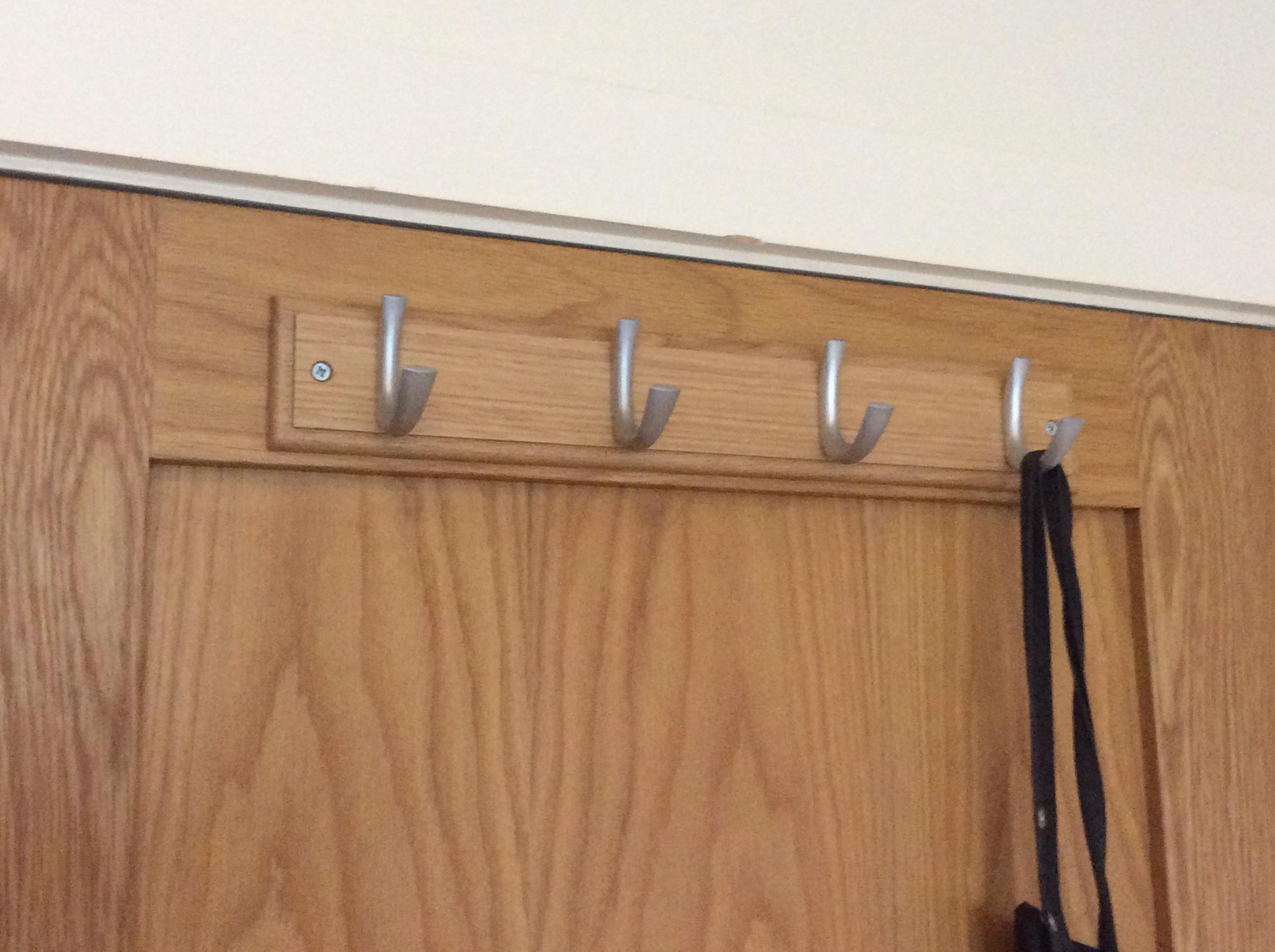

If anyone has any bright ideas, I need to have a set of hooks about a foot below these. Is there any product that hangs hooks off the other hooks?

59 minutes ago, Oz07 said:
Why can't you screw another set of hooks further down anyway?
Unfortunately it is a panel door, and the panel is far thinner.
In theory I could screw something right across, but I would prefer to avoid more screw-holes.
The best idae I have is one of those concertina racks, but I suspect I have thrown about 3 of those away in enforced tidy-outs over the years.

Why not get a nice piece of wood to match the door and glue it on, I have been using that D4 flooring glue and I bet you would need a hammer and chisel to get it off.
Link to comment
I have ended up doing that - a 75x25x1800 mm piece of oak was only £9.00 at the local Merchant, and I will just move the existing hooks onto this about 300mm down.
