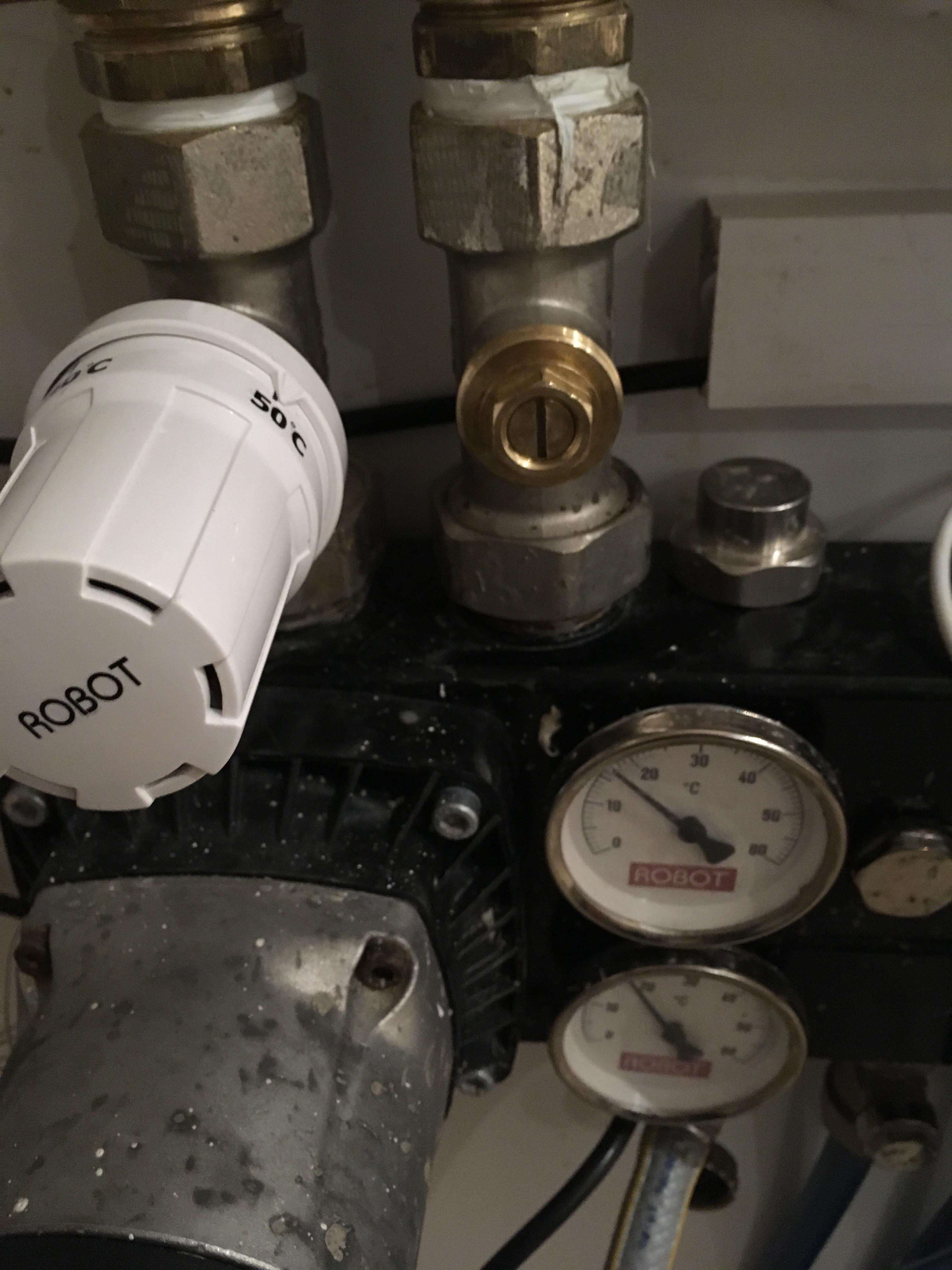

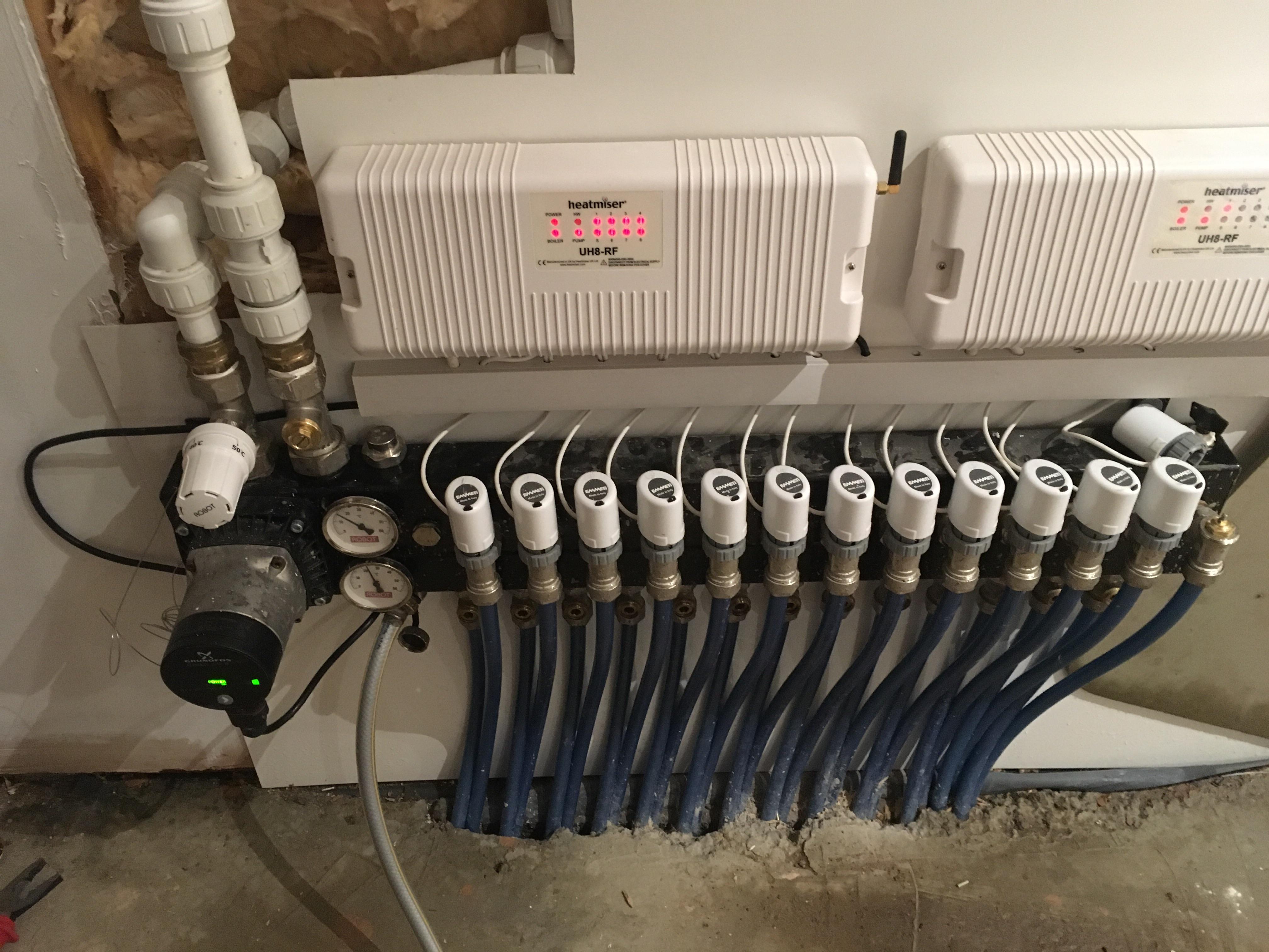

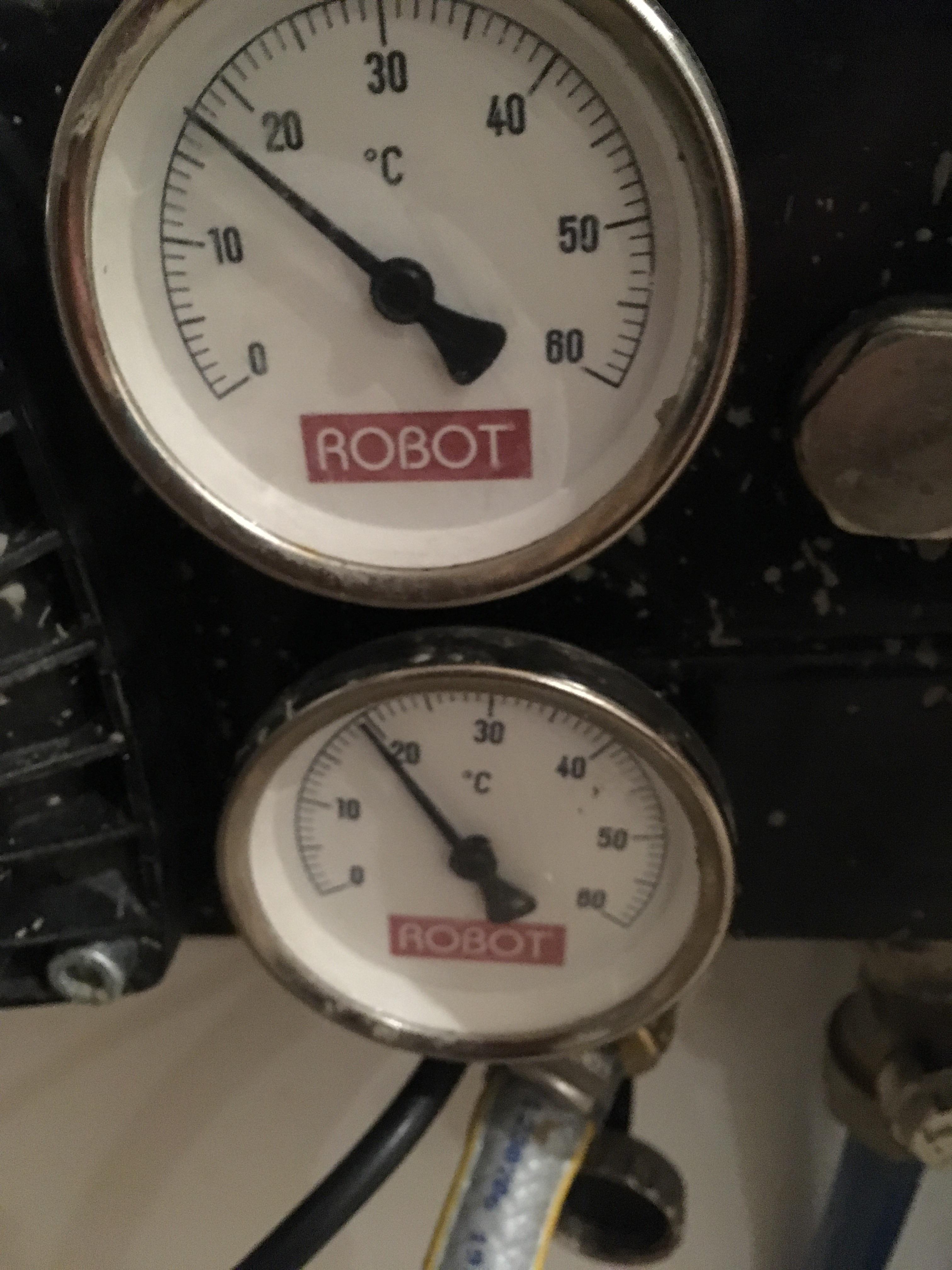

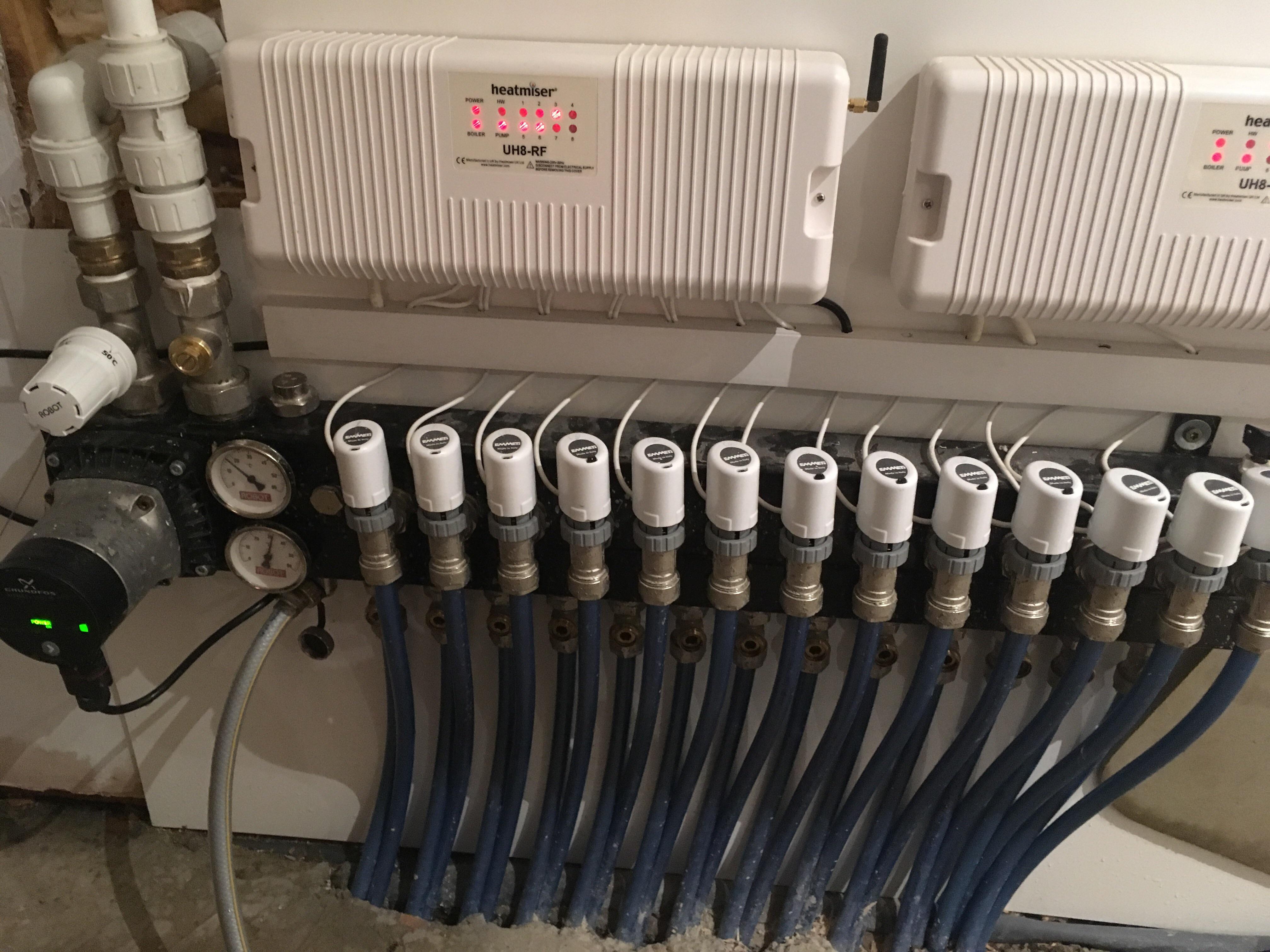

So the guy from Greenflame came on Tuesday and set up the pellet stove and thermal store leaving us to get it feeding the underfloor heating, that’s two days ago and still no heat, the stove gets up to 70degrees which it is set at and this should suffice for all the heat and hot water, it then cuts back and ticks over, the problem is the hot water is not getting to the manifold, the flow pipe is hot but everything else is cold, many wasted hours have now been spent with no results- help!

Got a photo of the blending valve..?? And the manifold..?
Blending valve could be on back to front

Is the manifold all open? Do you have actuators?
One rail has the actuators and the other should have flow gauges. The flow gauges turn anti-clockwise ( 3 revolutions maxinum !! ) to allow / regulate the flow. Check these are not tight closed ( try turning clockwise, if they move then they’re open ).
Link to comment
Can I see a better square on close up view of the manifold, I can't see any flow meters.  Also a close up of the actuators to see if they are "on"
If in doubt as a test unscrew all the actuators and by default all circuits will be on BUT mark which one is which before removing them so they will go back in the same order (otherwise you will have a whole different problem to solve)

Note the position of the thermostatic head with marker pen, and open it fully anticlockwise. Give it 20 mins and check for heat. If still no heat, get a flat blade screwdriver and turn the slotted valve, ( on the adjacent pipe to the right of it ), again anticlockwise, and see if that gets things shifting.

Has the system been purged? eg has cold mains been used to force all the air through the loops.
Next, are all the isolation vales open? Follow the pipes from the thermal store all the way to the manifold and see whats in the path. Confirm that they're all open / functioning etc. Hopefully you'll have a 2-port zone valve between the TS and the manifold to stave off unwanted heat loss during the non heating season.
Still be interested in that slotted valve to the right of the head.
Normally the slot would be vertical for open, it looks to be horizontal at the moment,. i.e. closed.

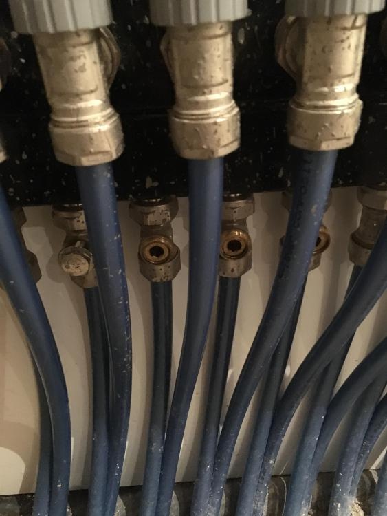

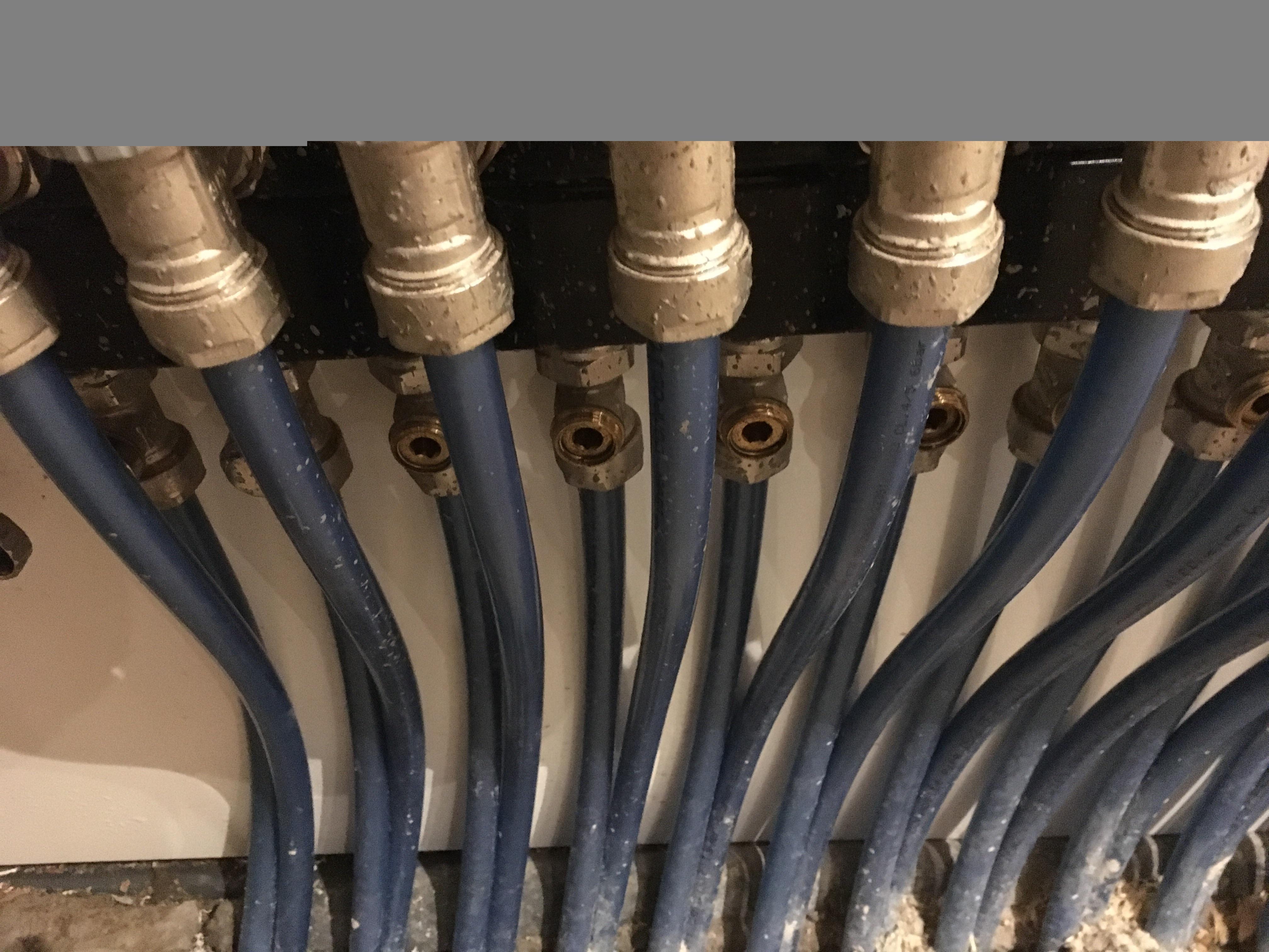

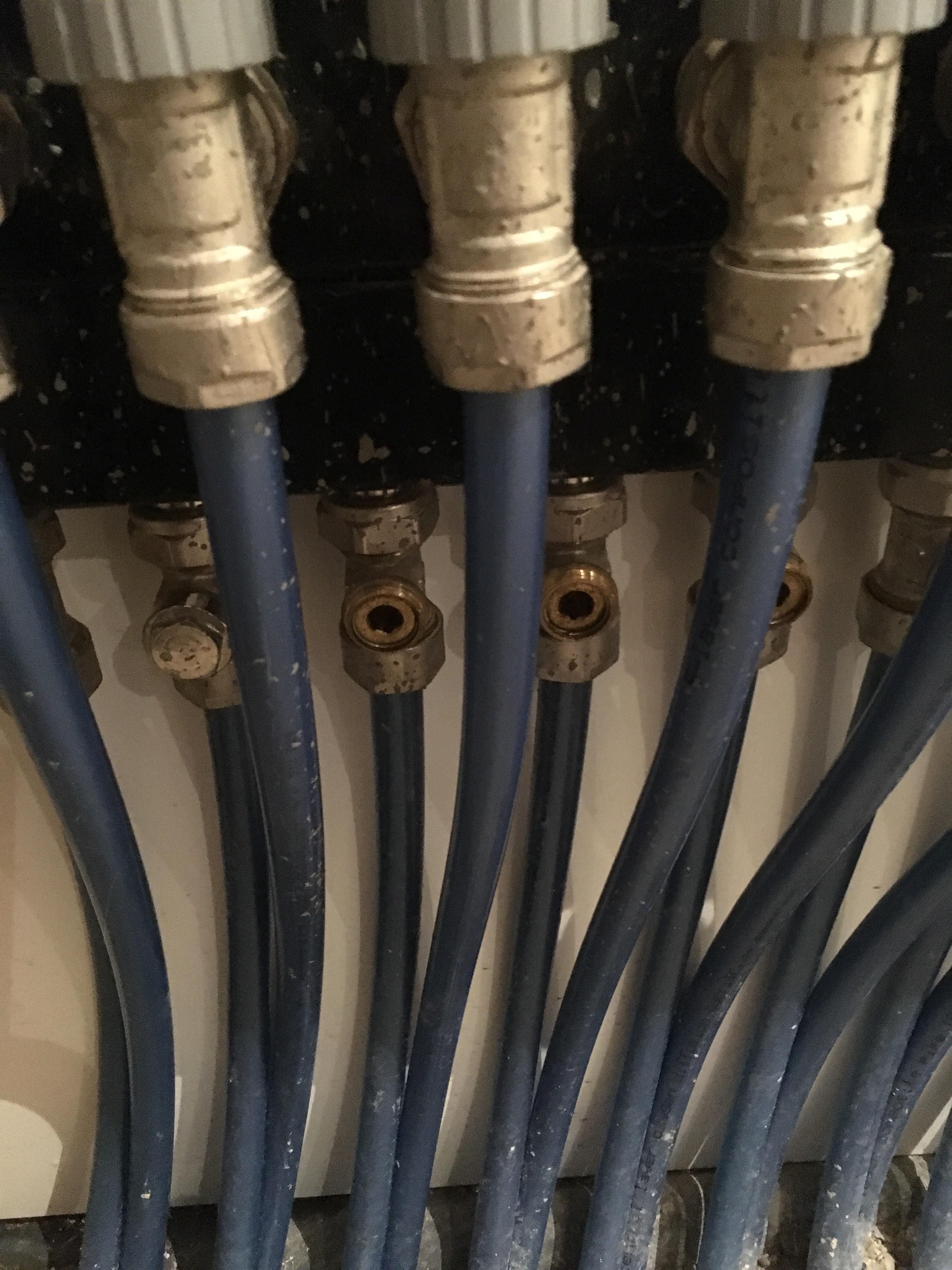

Can I see a close up picture of how those bottom row of pipes connect, I have not seen that type of manifold before.
Link to comment
Those bottom pipe connectors. Using an allen key, turn each one 1 turn anticlockwise. I think they may be the flow adjustment?

I KNOW WHAT THE PROBLEM IS ....... ?
Or at least I think I do... if the upstairs and UFH are on together, the upstairs pump will be pulling against a fairly low pressure circuit so the circulation pump on the manifold is basically trying to both pull against the circulator and push against several hundred meters of UFH coils .....
Do they both share a tapping on the TS..??
