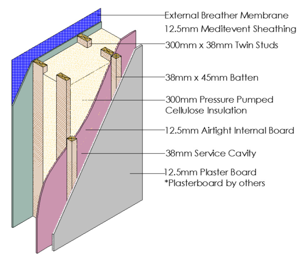

On 16/10/2018 at 21:04, Thedreamer said:
What's the make up of a standard MBC panel?
Sorry, life / build taken over recently.  If you mean the cross section.  It is this:
What you see in the photos is the green airtight internal board and the blue external breather membrane on the other side.
Link to comment
Thanks. I see a lot of blue MBC panels on the forum and always wondered what was behind it.
