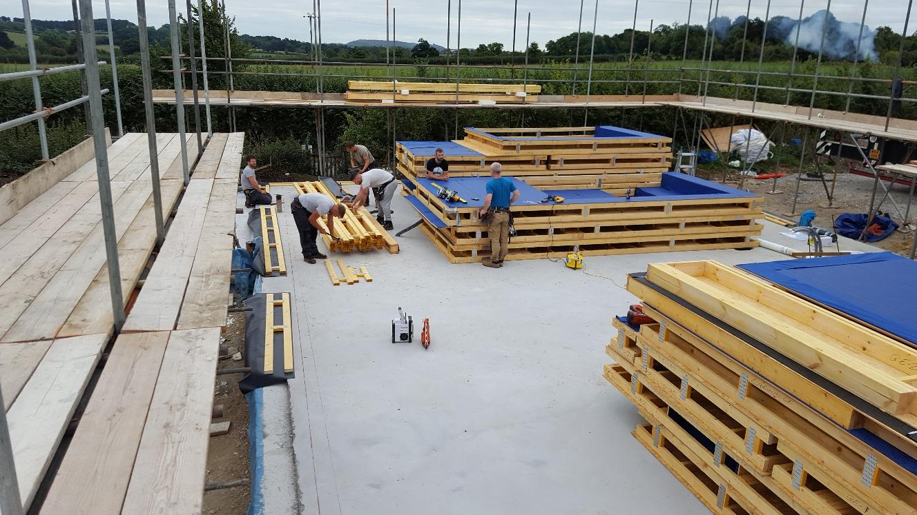

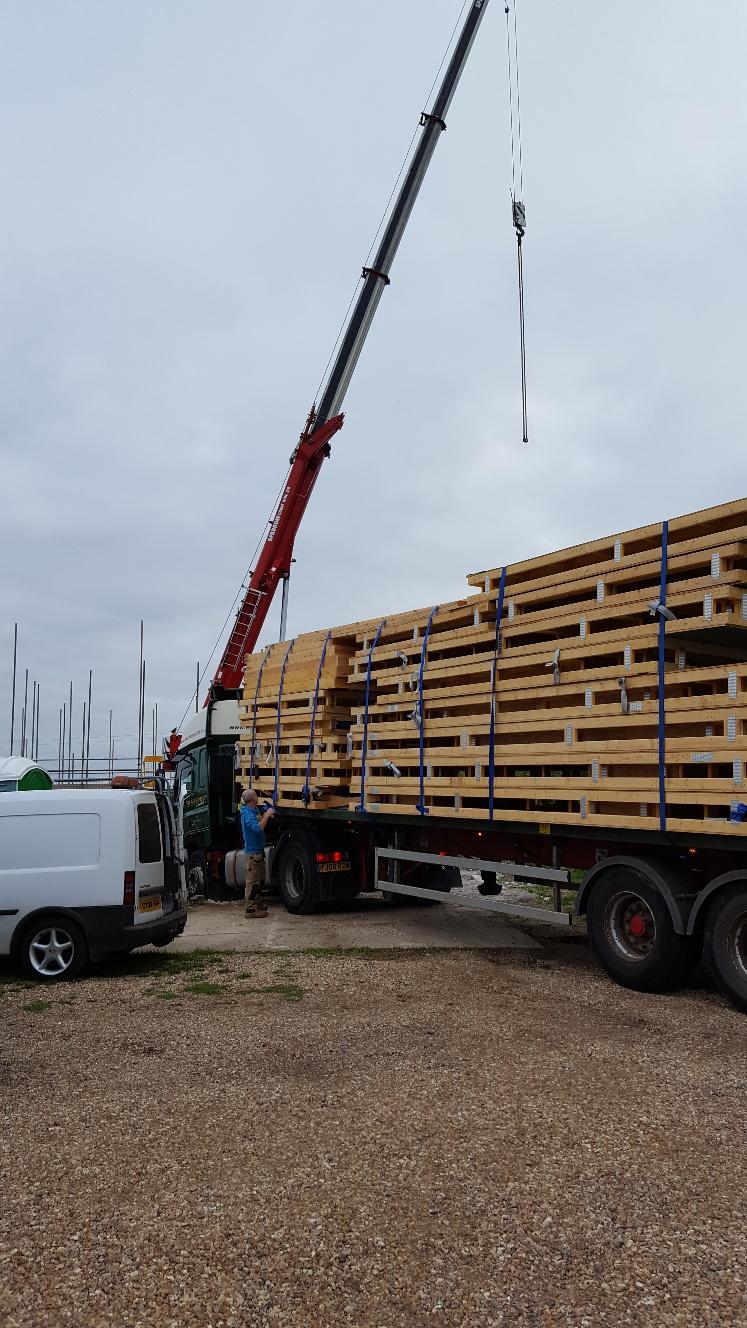

So, bright and early the day after the bank holiday, the first enormous flat bed lorry stacked with timber frame arrived.  The crane was already on site, as were the MBC crew.  Actually, I think I've got 2 crews, a total of 7 guys yesterday, which explains the blistering rate of progress.  It was a really tight squeeze getting that lorry up the narrow lane to the site and the drivers really prove their mettle getting in and out of there.

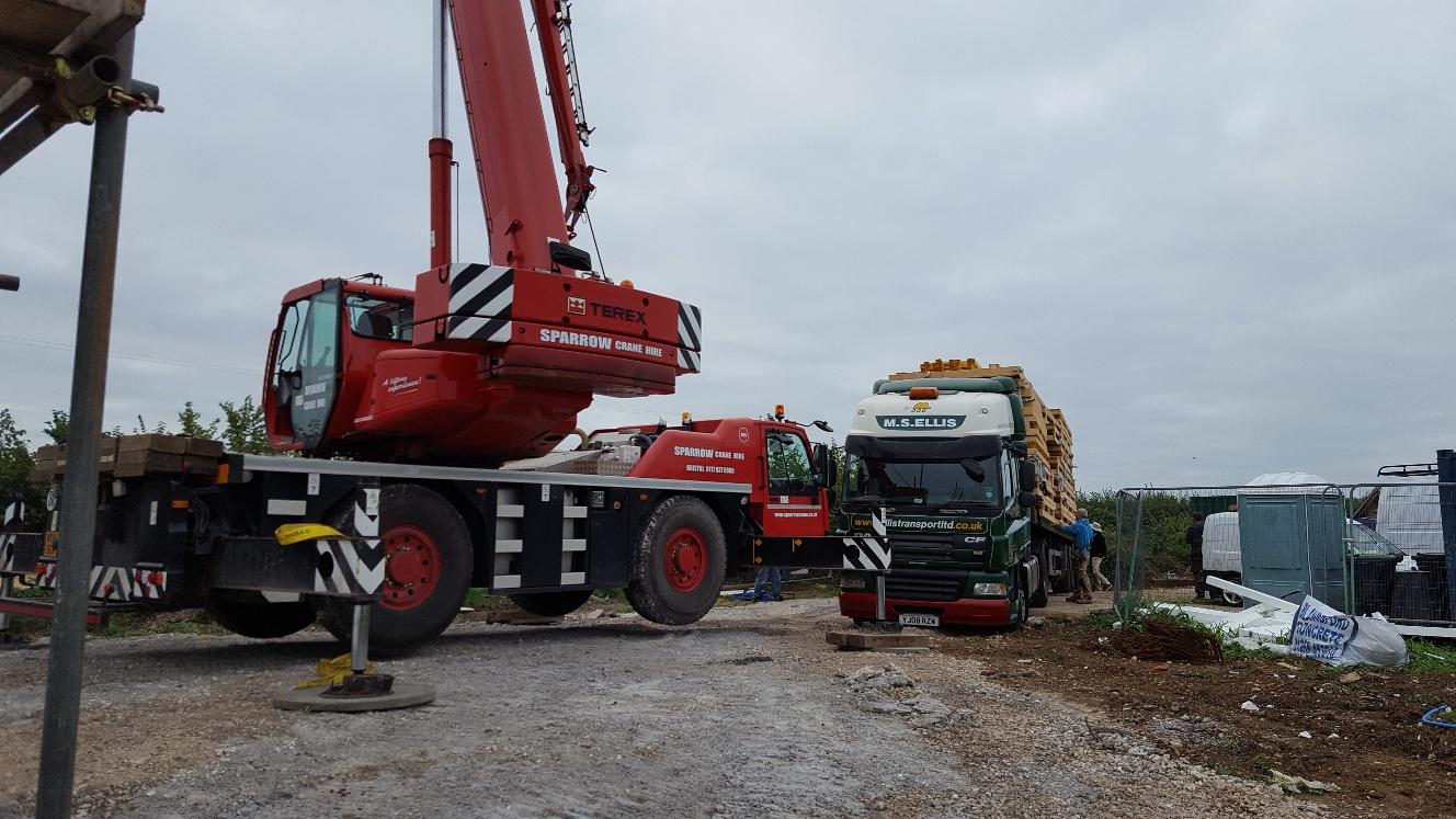

This is yesterday's crane.  They have an incredible reach and are quite something to see in action.  I couldn't get the whole thing in a shot.

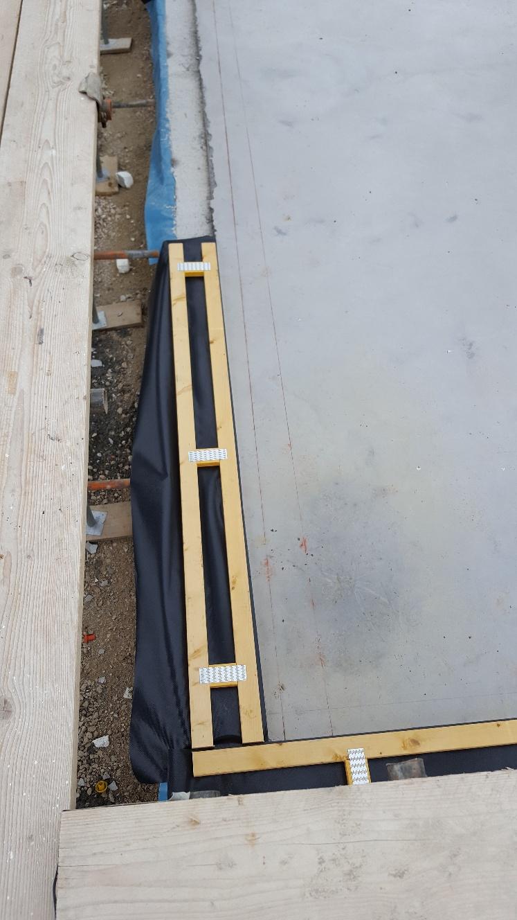

Before anything happens with the walls, the team go around string marking where the beams are and putting down sole plates for the walls to lock into.  The black stuff is the DPM which overlaps the EPS underneath.
Space was getting a bit tight on the site, but between the hard standing and the inside of the house, everything found a spot.

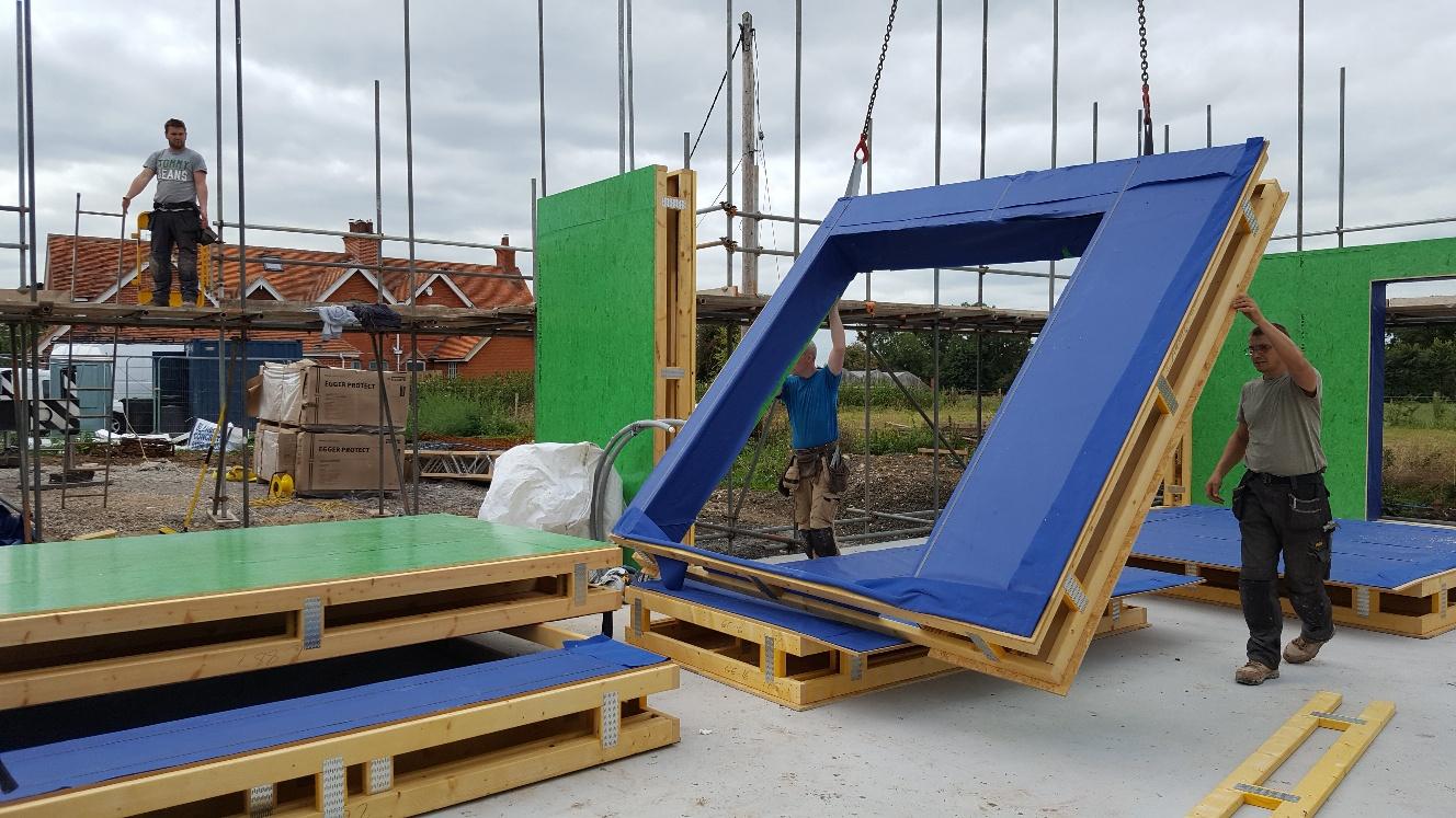

Once all the marking out was done and sole plates were down in the right places, the crane hauled the walls up and they were guided into position.

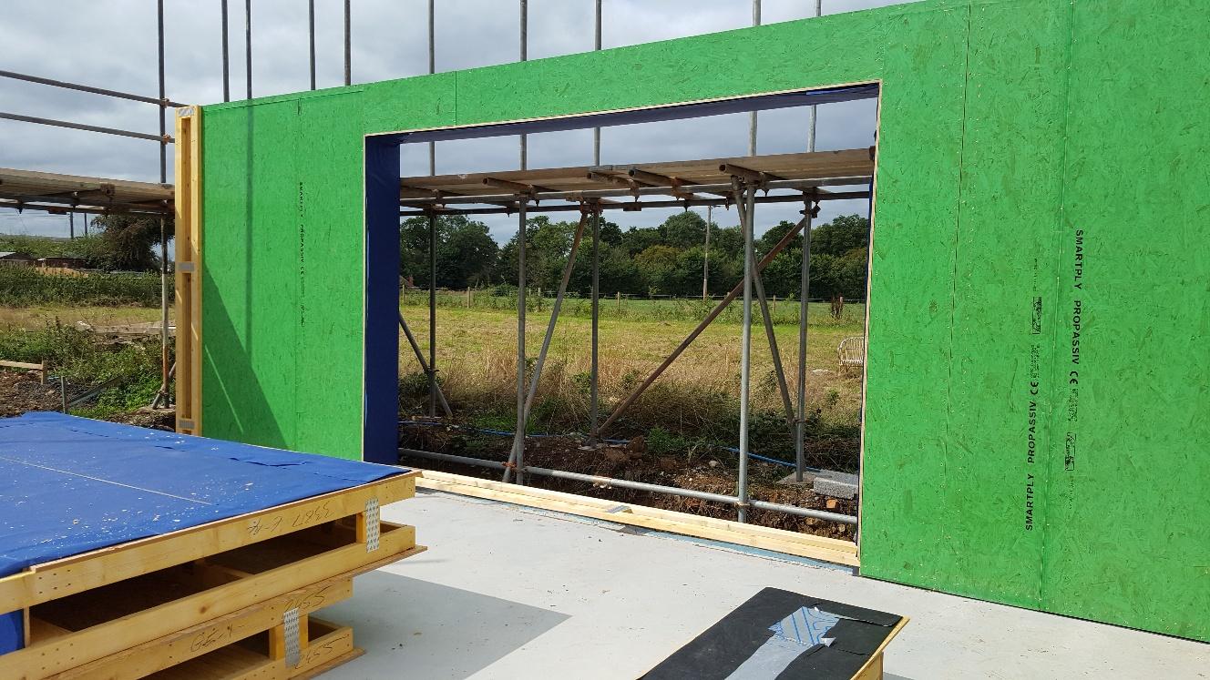

Here's the view over the field from what will be one of the living room windows.

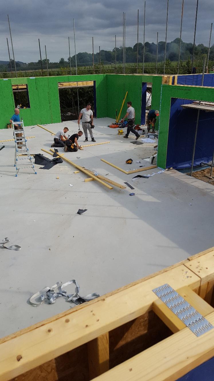

At the end of yesterday afternoon, all the external walls were up and they starting marking out for the internal stud walls.
