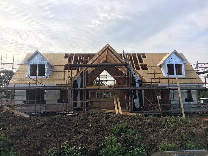

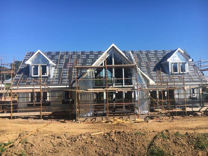

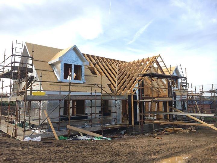

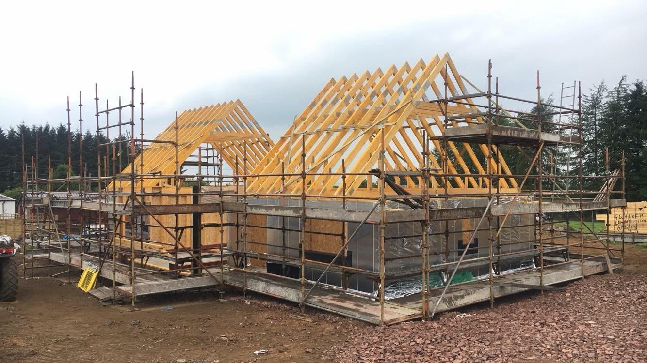

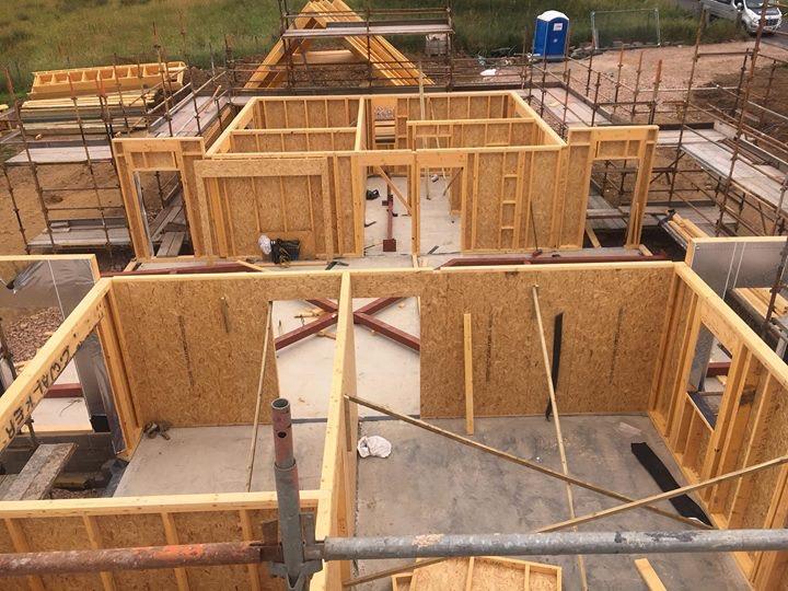

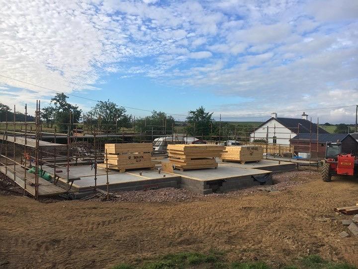

Another Claymore Timber Frame kit in various stages. Kit erected by Templeton Construction.
Client was most impressed by quality , service and speed of the build
this was the latest entry on claymore Facebook page 9487A841-F1B0-464A-A01B-DD1697F7B1FA.jpeg.dd8339906e50560fe3339eef5fe00098.jpegAB210E1E-8690-4E19-82EC-DDA61F5056CF.thumb.jpeg.2e817c6f8b0623606a8f3e3a8ba17b94.jpeg4B355BAC-D1E0-4F43-8F7E-4FE52E48486D.jpeg.097ed29b00b9edd21cd2a7b73c5419e0.jpegE6BB54A9-0AB0-4E54-89B5-0F5F7CA6D684.jpeg.4392d871fc539484aac41b35a82f610a.jpegCF43358E-BB5D-4AC2-A856-E19ADC47F0AF.jpeg.32cb2cc199bd06e23b0ccd39eaa189e5.jpeg4C3E02B3-0B66-4A66-B261-F9CDAAB3E757.jpeg.18b9fe100c8e50018593a312801f52fd.jpegE1CA3F03-98D7-4DC7-A0D8-5A832CDBDDDF.jpeg.f1f7d4870f2ad863daac810a0bade1ca.jpeg97A07D8D-C56A-458C-A199-8FB517D694CF.jpeg.75223de81e5e3123dbf792f4dfb5f130.jpegEE7FFB4B-D115-44C2-88D6-8AB84E3AE14D.jpeg.927a3eb492cb7c7e9ea5b1c35ab5eb8a.jpeg
