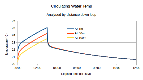

image.png.e558f16cbd3b03fa4e5a343aa87b1a4d.png   5a0dbd5c77170_UFLheating13-16Nov.png.198c5d9a778f2c4e8ff7204e2b48d447.png
The first graph is a theoretical model based on a few simplifications, and the second live data, warts and all, and complete with hiccups as I test and restart the control system.  The bottom line is that the slab is reacting exactly as I modelled in overall behaviour, though one of the parameters is different.
  • The UFH pump at its medium setting is under half the modelled flow rate, increasing the delta temp between out and return from 2°C modelled to  5 °C measured.
However, I decided to stay with this setting because the pump is almost silent at its medium setting, and the system and its subcomponents are still operating  well within specification at a delta of 5 °C.

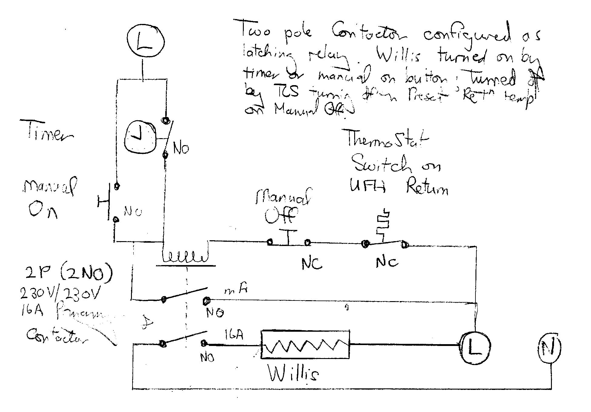

In terms of the relay version, I think that it would look something like this:
The alternative would be drive all of this logic at 24V DC with low voltage switches and a 2P/NO relay and use it's output to drive the SSD.

@TerryE if I was picking one thing up from your drawing I would suggest the Live feed to the contactor and Willis doesn’t go through the manual on switch but I expect that’s just how it’s drawn ..??
Link to comment
I will expand this is Part III when I get time to post it including a fixed copy of that circuit @PeterW, but I am a bit busy at the mo.  We've now been using the heating system for two months, including an interim NodeRED controller.  I still have to put in an upper level of control, but at the moment all I am doing is having the Willis on 00:00-07:00 (our E7 slot) and a top-up of 2 hrs in the late afternoon.  This leaves a residual ripple of around ½°C over the day (as @JSHarris has discussed previously), but other than that the house is amazingly stable.  If the external temperature climbs to around 10°C then the house slowly warms up by about 0.1°C per day on the overall ripple, but for an overall average of 4°C or so, this small delta seems to wash out -- to the point that putting in any more advanced control algorithm just isn't a priority.

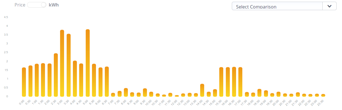

As we get into lat Feb / Mar if it does steadily warm up then I might have to trim back the afternoon heating to 90 mins or an hour and by the end of March we should have stopped it entirely.     But here is a typical day's usage:
The two top hats are heating the slab.  The other overnight spikes are the SunAmps, washing machine and dishwasher.  The other base ripple is our general electricity usage for cooking, lighting etc.  The main variation is the SunAmps -- you can tell if someone has had a bath because the spikes are fatter, and the type of cooking going on that day.
So our total energy bill per day for our large 4 bedroom house is around £5, and this should fall to around £3.50 by end March and around £1.50 by May.   You can see why the cost benefit case for adding an ASHP is marginal.
