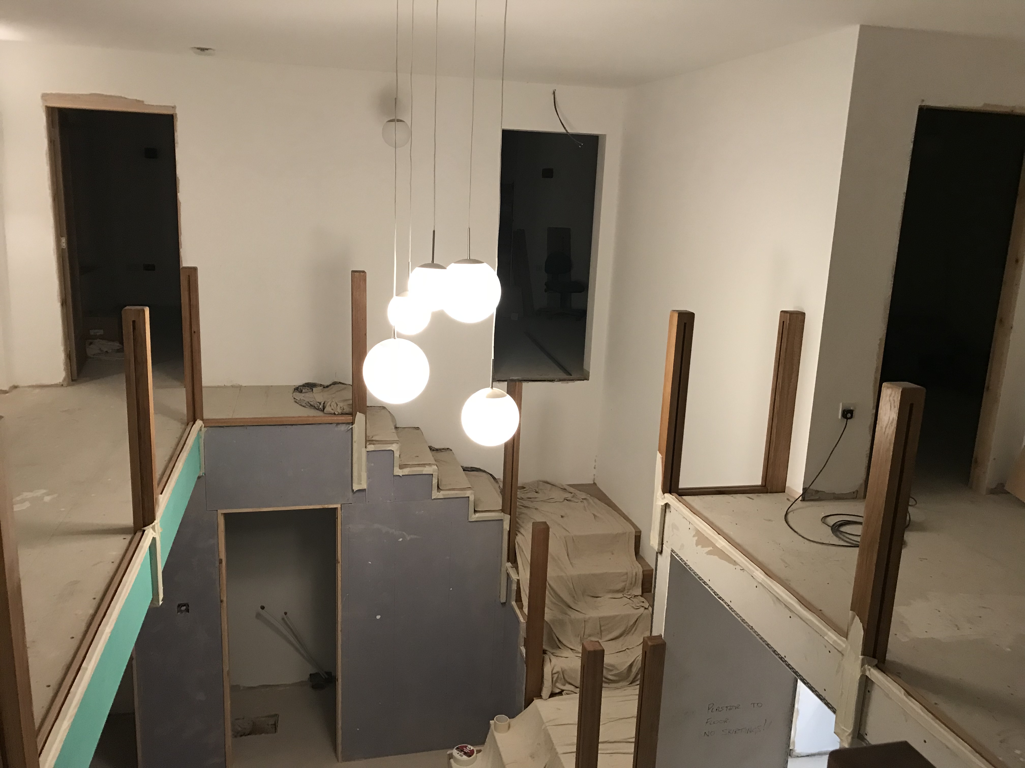

I'm impressed with the effectiveness of the one internal window I designed in.  By necessity (the planners wouldn't allow windows anywhere on the North elevation, plus I was averse to them because of the heat loss) our bathrooms ended up without external windows.  Adding a high level window, made of glass bricks (both for aesthetic and noise reduction reasons from the wide open, and very light, central hallway, to the main bathroom, is surprisingly effective at both allowing in light and making that room seem more connected to the rest of the house, especially when there is sun shining in.
The idea behind using glass bricks was just taken from an article in a Sunday newspaper, that had a photo of an old glass brick wall in an Art Deco building, so I hunted around and found that a French company still made a range of glass bricks.  They have a very slight tint, but that barely shows, and they are very good at both letting light in whilst seeming to have the solidity of a wall.

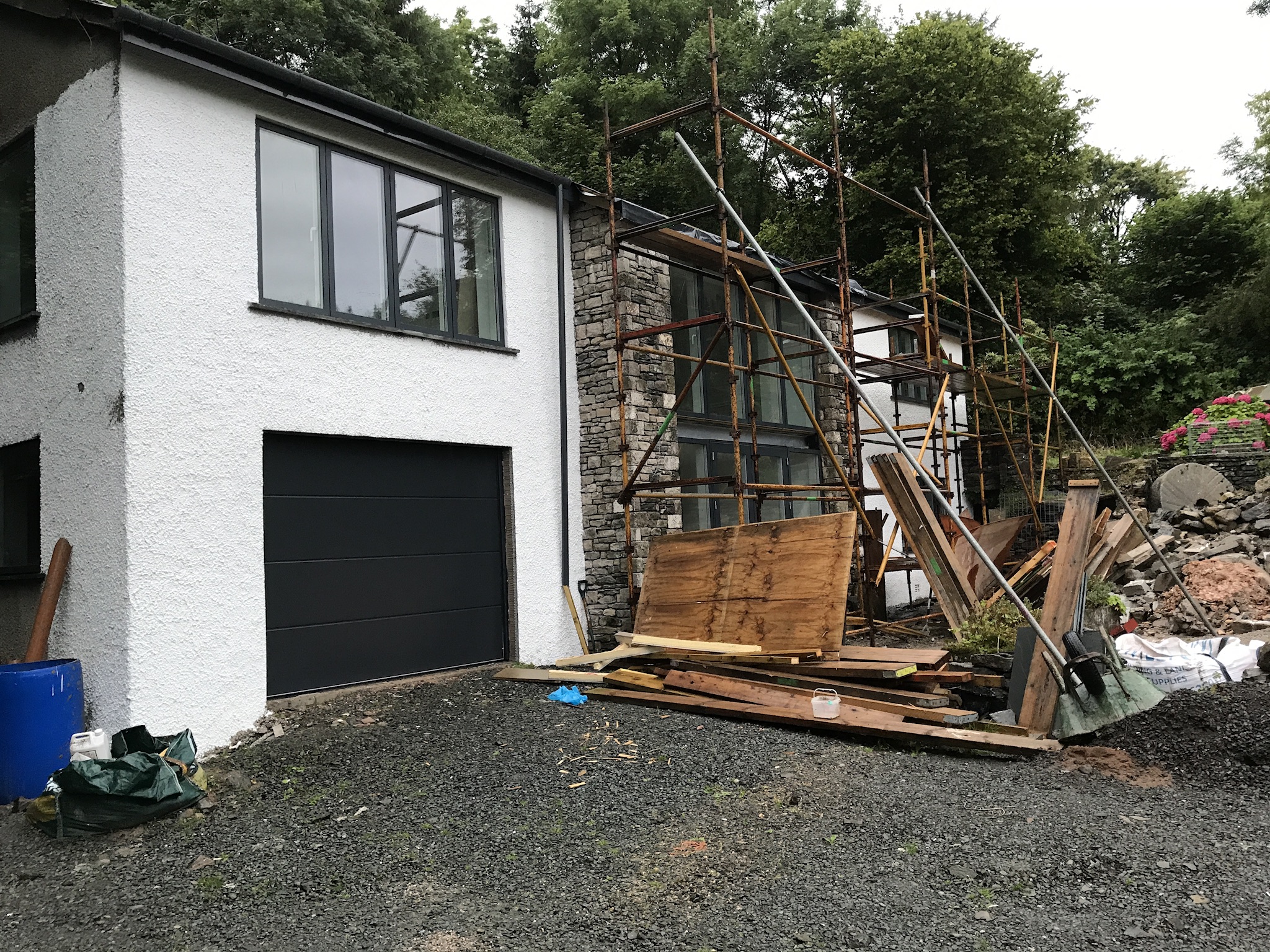

That’s interesting caliwag, we have also taken in an internal window, it’s there for two reasons really, one to bring the lounge in contact with the rest of the house, and it’s shape is driven by artifice and interest. We’ve massive redesigned the house and I wanted the building to read like that in places.
Hence we have a window that looks like it could have been door ( as part of the previous mill building ) but in reality it’s all new...
There is a top lurking here about pastiche and creating something that feels right.
The window In question
Link to comment

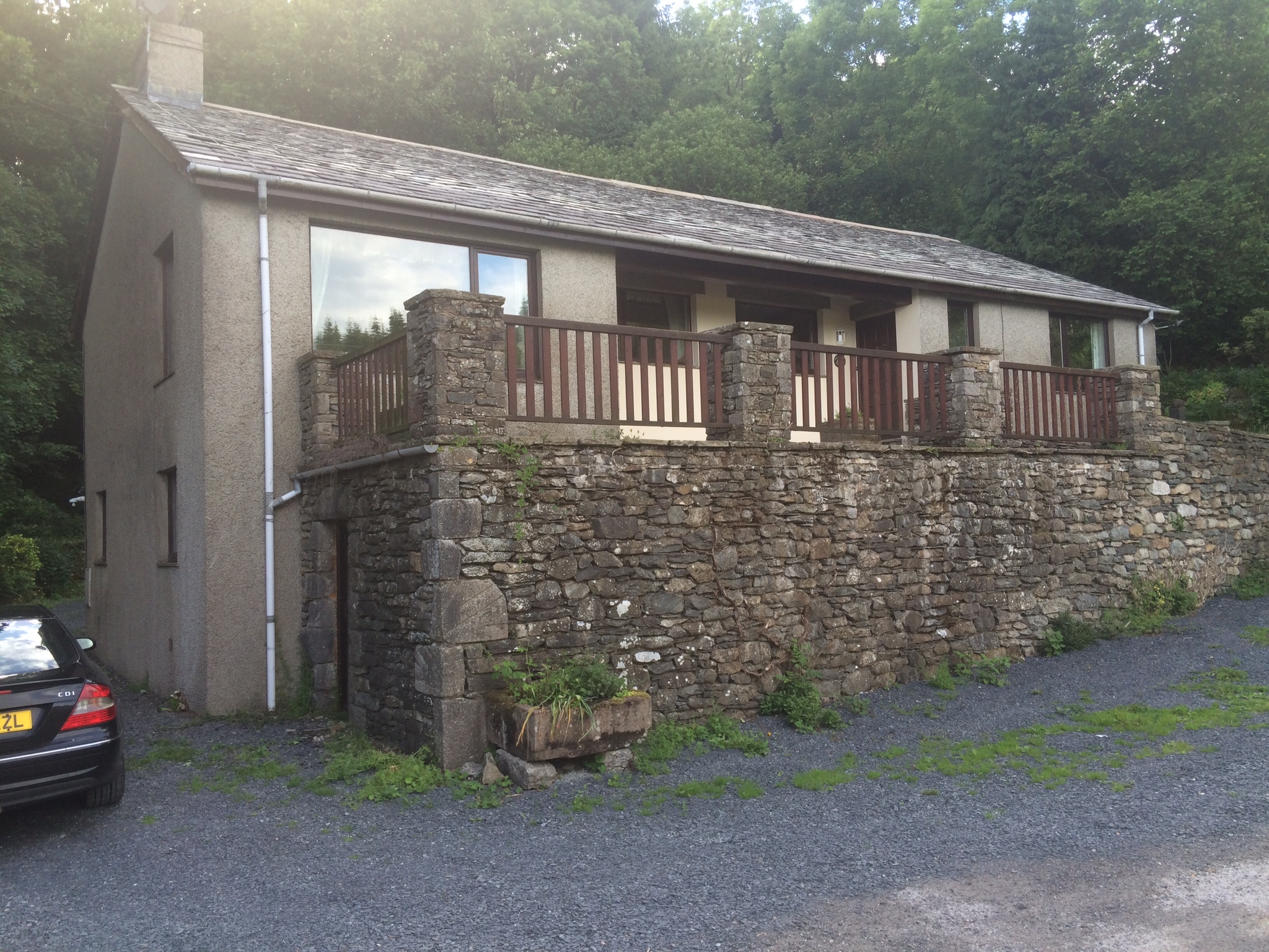

More artifice to be found here, an elevation that was designed to be looking like a barn entrance. Before and afters attached.
I’d be interested to hear how you present it @caliwag artifice and pastiche is a dangerous thing, but being part of a vernacular is key.
