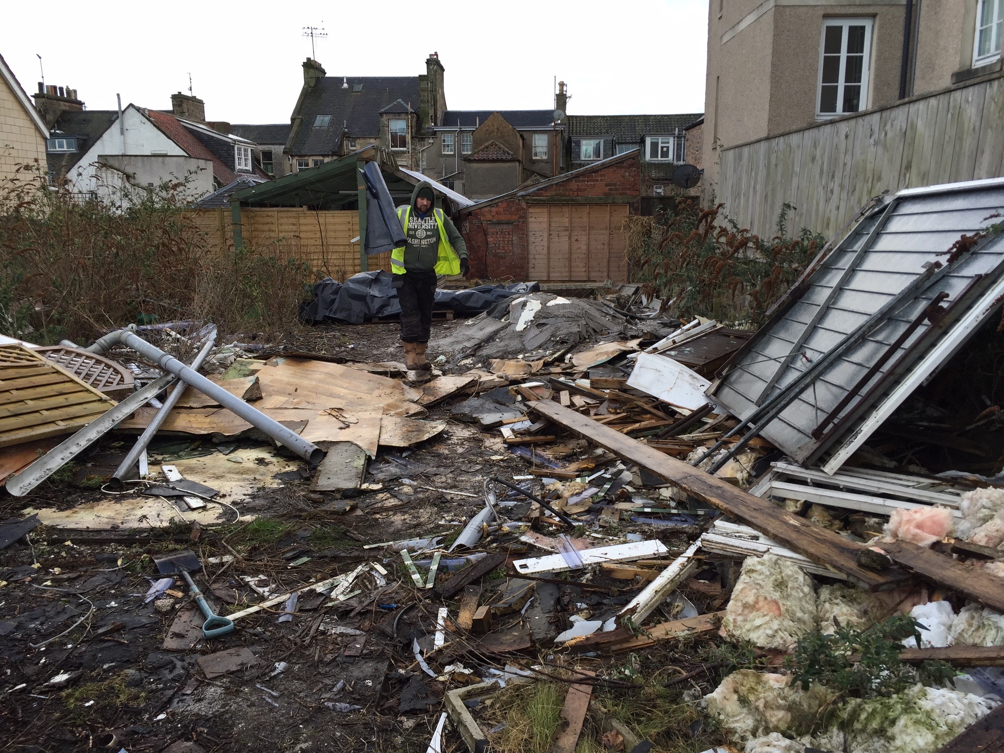

The site was a former garden centre, so there was a large timber building (previously a showroom), a play house, a load of slabs, display boxes, plant racks, millions and millions of plastic plant pots everywhere, and 5 world-weary apple trees to get rid of. And a lot of topsoil. Did I mention the topsoil?
IMG_0006.thumb.jpg.e3ac6d13458def93a823fba49f5d5046.jpgIMG_0006.thumb.jpg.f220d786678692319cf8371e98d75b19.jpg
It was a LOT of work and expense to get rid of all this stuff, as it all counted as "mixed waste" so the disposal fees were enormous. This is when we realised the importance of being on site to supervise. We'd had a holiday booked for months and months before we knew we'd be doing this work, so we briefed the guys doing the clearance (who we trust) who estimated the remaining skip loads.
We get back a few days later to discover it had been over double that number and our digger driver had got into a dispute with the skip collection driver over what counted as "waste". So instead of the expected bill from the skip guys of about £2-3000 at the absolute WORST, we came back to a bill of over £10k. This necessitated a somewhat hasty trip to the skip yard and a "full and frank exchange of views" with the owner. After showing us a random picture of some rubbish on his phone and insisting it was from our site, our bill was halved. Left a nasty taste in the mouth though, that's for sure. So, we eventually have a clear site, and now another problem.

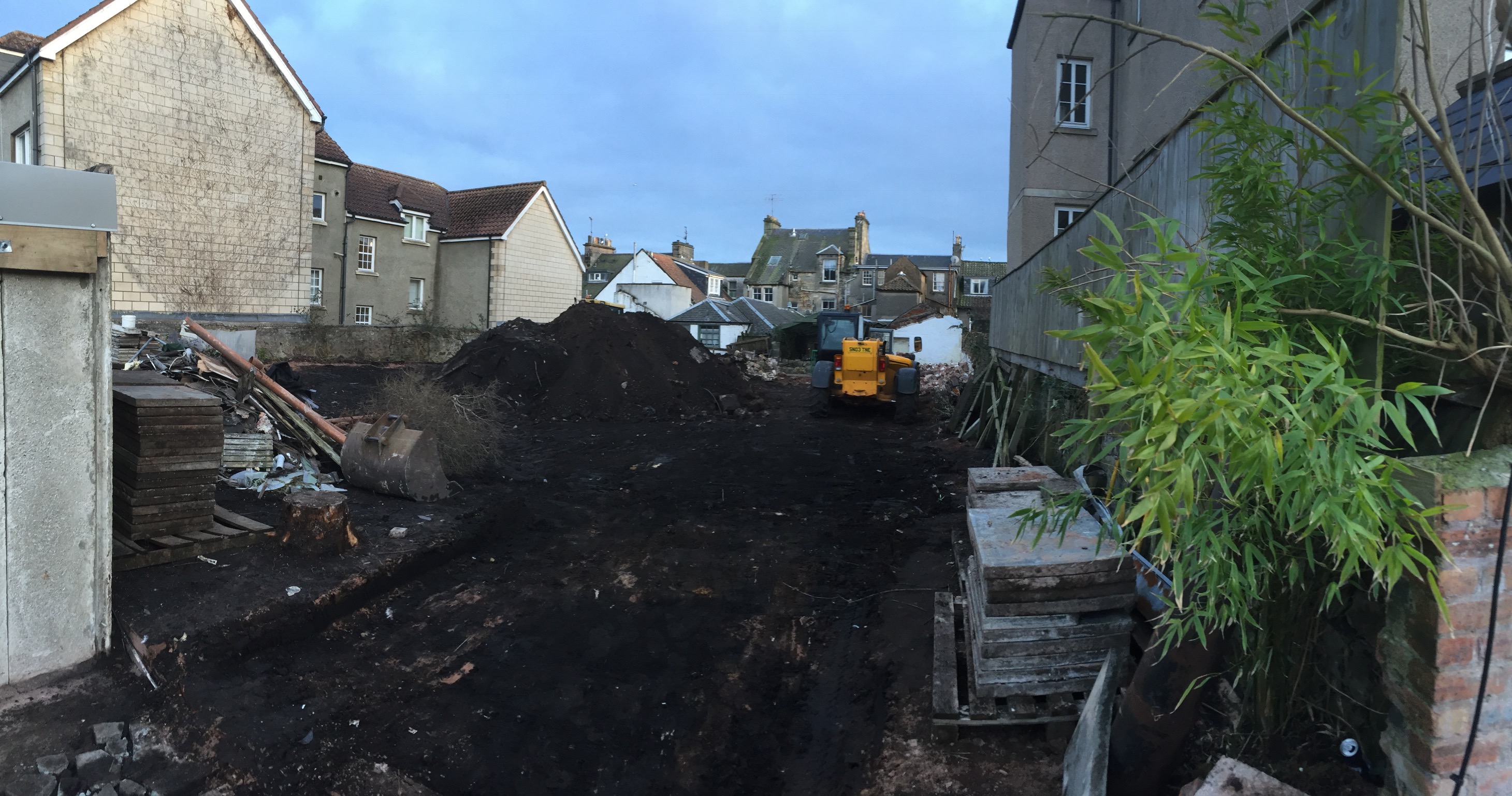

If you're a gardener, you'll appreciate how lovely this topsoil looks. And it is great quality - this plot has been used for nothing but gardens and grazing since medieval times. Unfortunately, that leaves a rather extensive period of time during which the topsoil has nothing to do, but get deeper, and deeper and deeper. By the time we came to own the plot, the topsoil and subsoil layer was over 2m deep in places.
Obviously, (after it was explained to us), you can't build a house on top of topsoil. Things grow in it. Things you don't want under your house. So, it had to go. BUT, we couldn't drop the level of the house by 2m, as the plot is surrounded by other buildings and dropping it down that far would cut out essentially all the sunlight coming into the house. If anything, we wanted it higher than the current level to maximise the light.
Two options - piling with a suspended floor or simply replacing all the soil with compacted hardcore. We also (briefly, until we got the quotes in) considered adding a basement. That idea didn't last long.
After speaking to Hilliard about piling, he mentioned that each pile would potentially be a partial cold bridge, so that was a little off-putting. But we got quotes anyway - they weren't horrendous, but a lot of piling companies weren't massively keen on the site, surrounded as it is by 3 storey blocks of flats, a listed street frontage, crumbling stone walls and potentially a LOT of angry neighbours. Despite this, it was an option we were considering, until every warranty company we spoke to said that they wouldn't issue a warranty for mortgage purposes if there was any black earth under the footprint of the house.

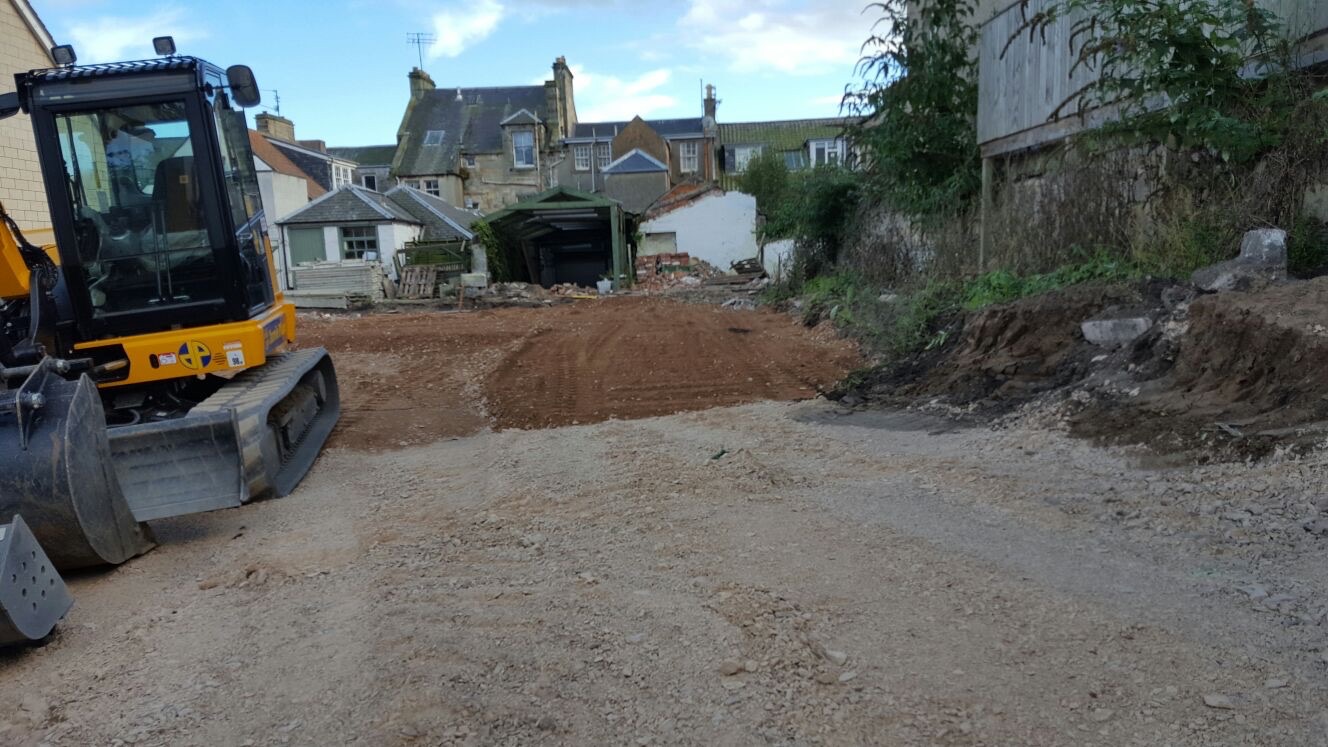

So, many many many many tractors and trailers (and pots of money) later, 1000 tonnes of soil was dug out, and replaced with 1000 tonnes of hardcore. And not any hardcore. Due to our engineer (about which a LOT more could be said), it's all Type 1 MOT. All 1000 tonnes of it. Compacted to within an inch of it's life.

What type of foundation will go for? Are you able to sit the trenches within the compacted hardcore?
divorcingjack
Bit late, I know! But we went for an MBC passive slab, so the EPS sits on top of the hardcore layer. No more digging!
