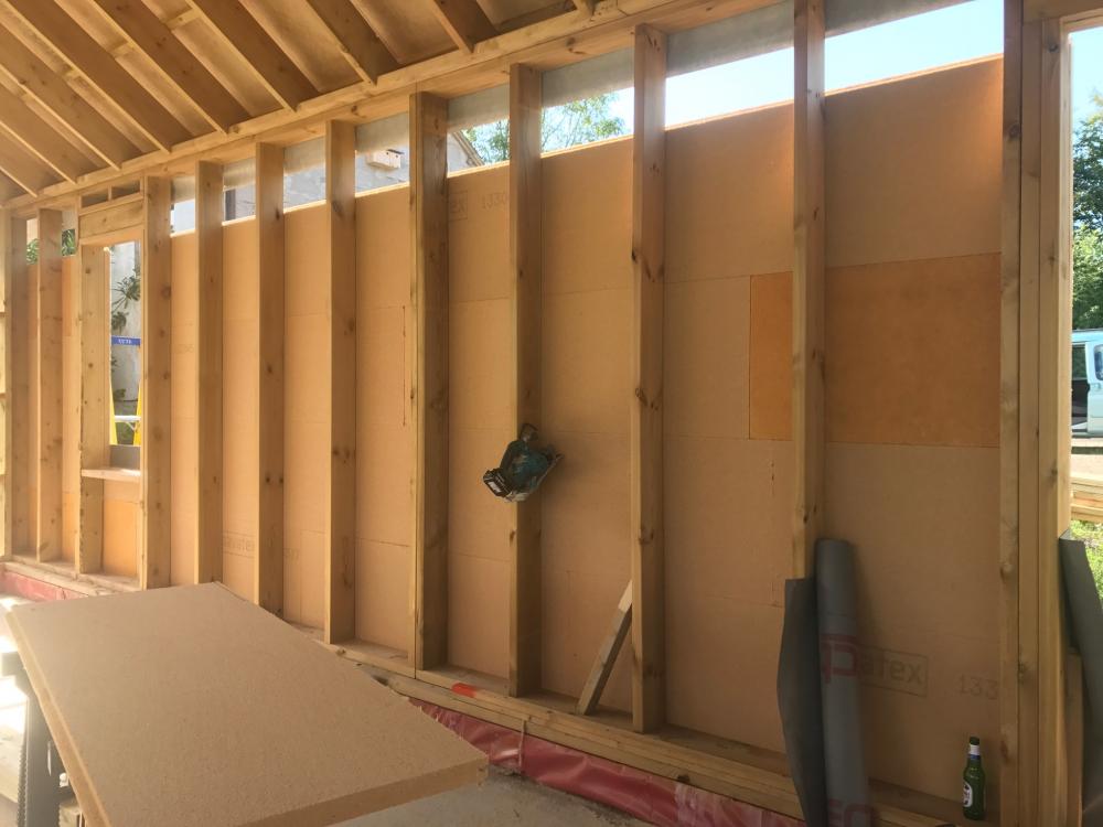

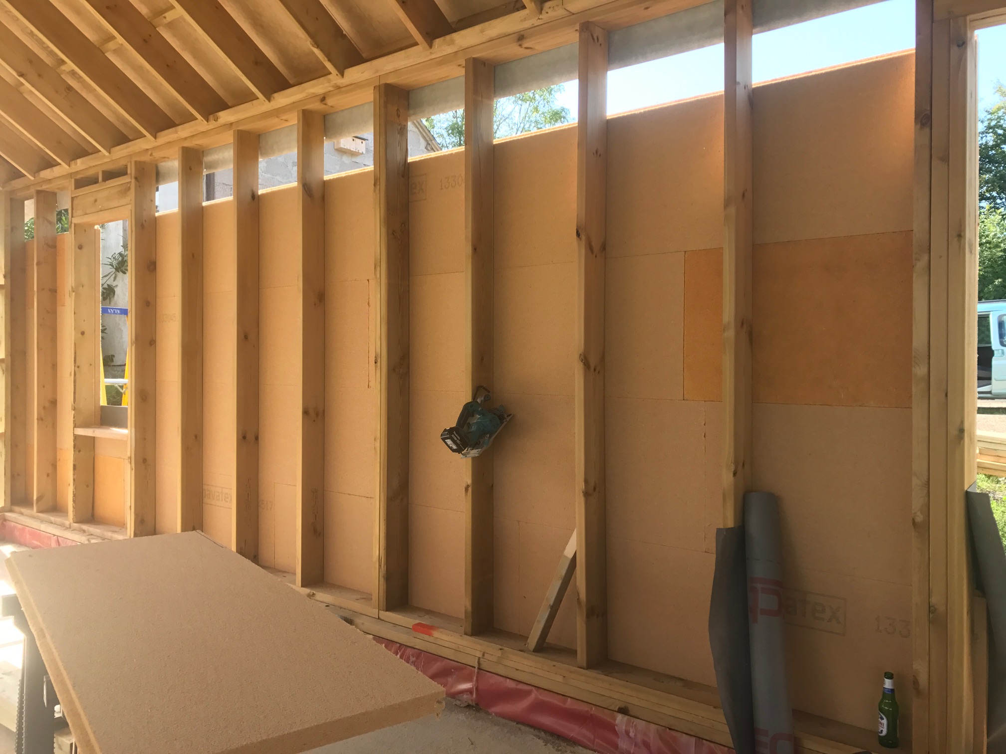

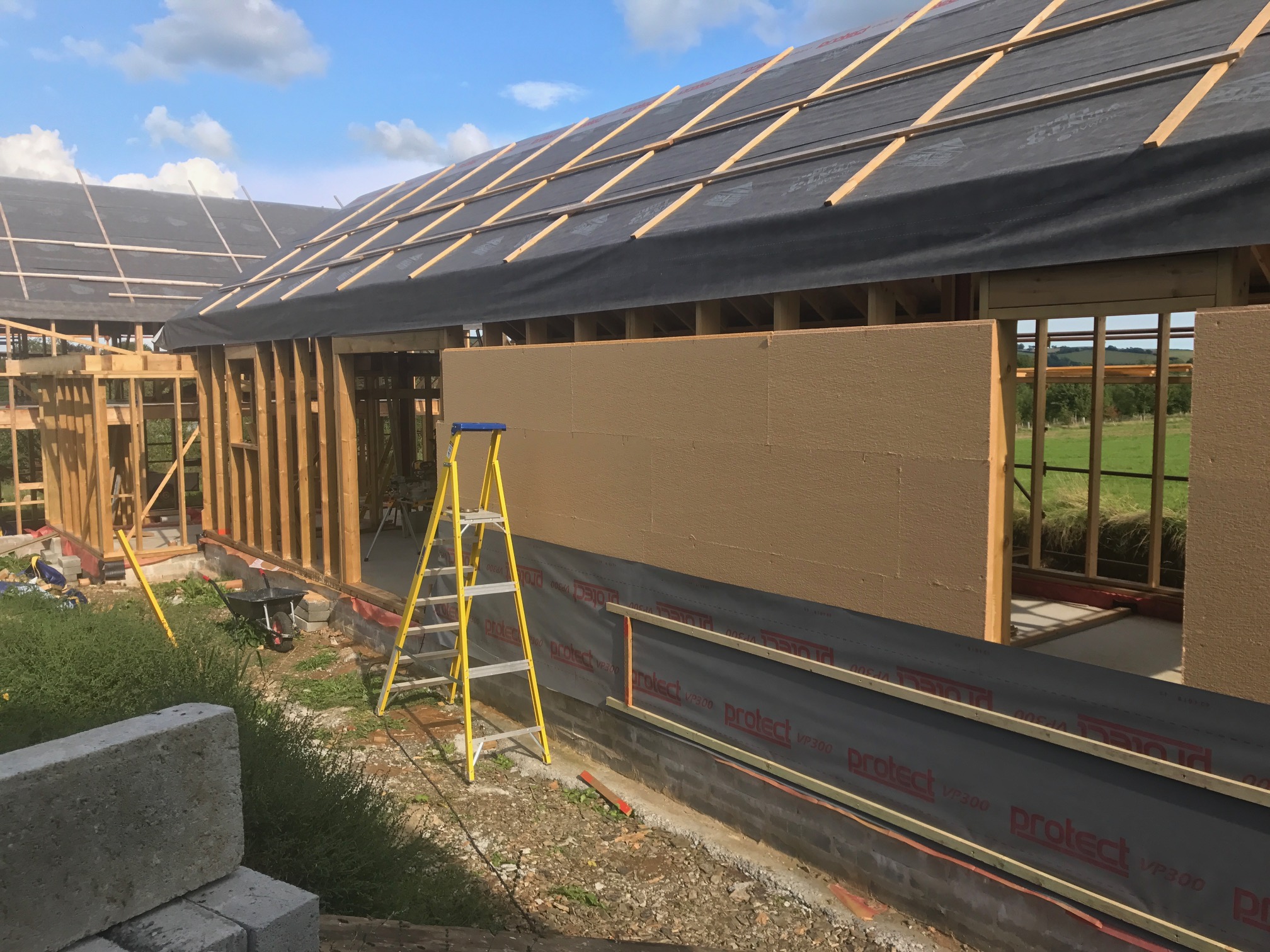

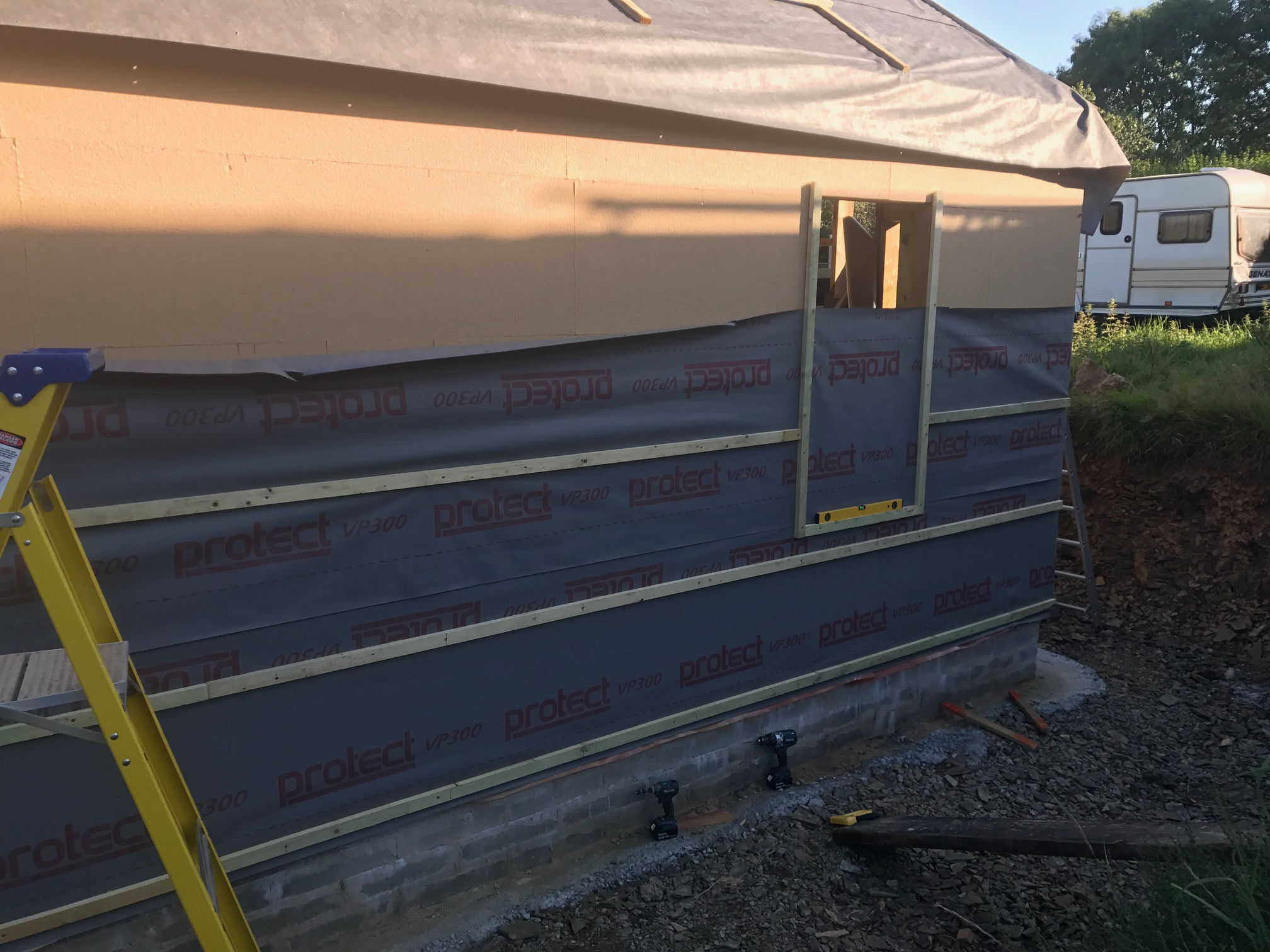

Started external wall insulation, 240sqm in total to fix.  Its Pavatherm combi, 40mm. Fixed a 40mm (cut down from 50mm) batten on the outside edge of soleplate and rested boards on top and off you go. Takes a while to then fit dpm and horizontal battens which I now need to remove and fix vertical battens first......Nearly finished the house frame except the flat roof, Seems a little odd to start covering walls after so long, I need to contact window suppliers again for more accurate quotes.

Interesting variation on what I used. I used the 100mm thick Pavatherm and rendered directly onto that.  I see you are cladding yours with timber or something?
What are you doing to give the building racking strength? the pavatherm is not strong enough for that. My SE specified OSB racking panels on the inside of the frame, and much of the house he specified 2 layers of racking panels.
What are you cutting the pavatherm with?  I found the dust it gives off clogged my circular saw in about 2 cuts, so for a long time I had one side of the guard removed from my circular saw to prevent that (keep fingers out)

Hi Dave, yes will be clad in timber. On the inside going to fix 75mm horizontals to increase insulation depth then OSB, batten, plasterboard.  My brother used 100mm pavatherm, great stuff but very heavy. He used a chainsaw as well as a table saw. The 40mm cuts fine with my Makita 18v circular saw. What thickness OSB did you use?

Hi James, do you have any details on the junction where the bottom of the wall meets the foundation. My wall is similar to yours, did you tape/seal the membrane to the foundation. My architect has this detail for mine but I'm worried water could leak behind the membrane and then pool at the foundation level as it is now sealed by the tape.
