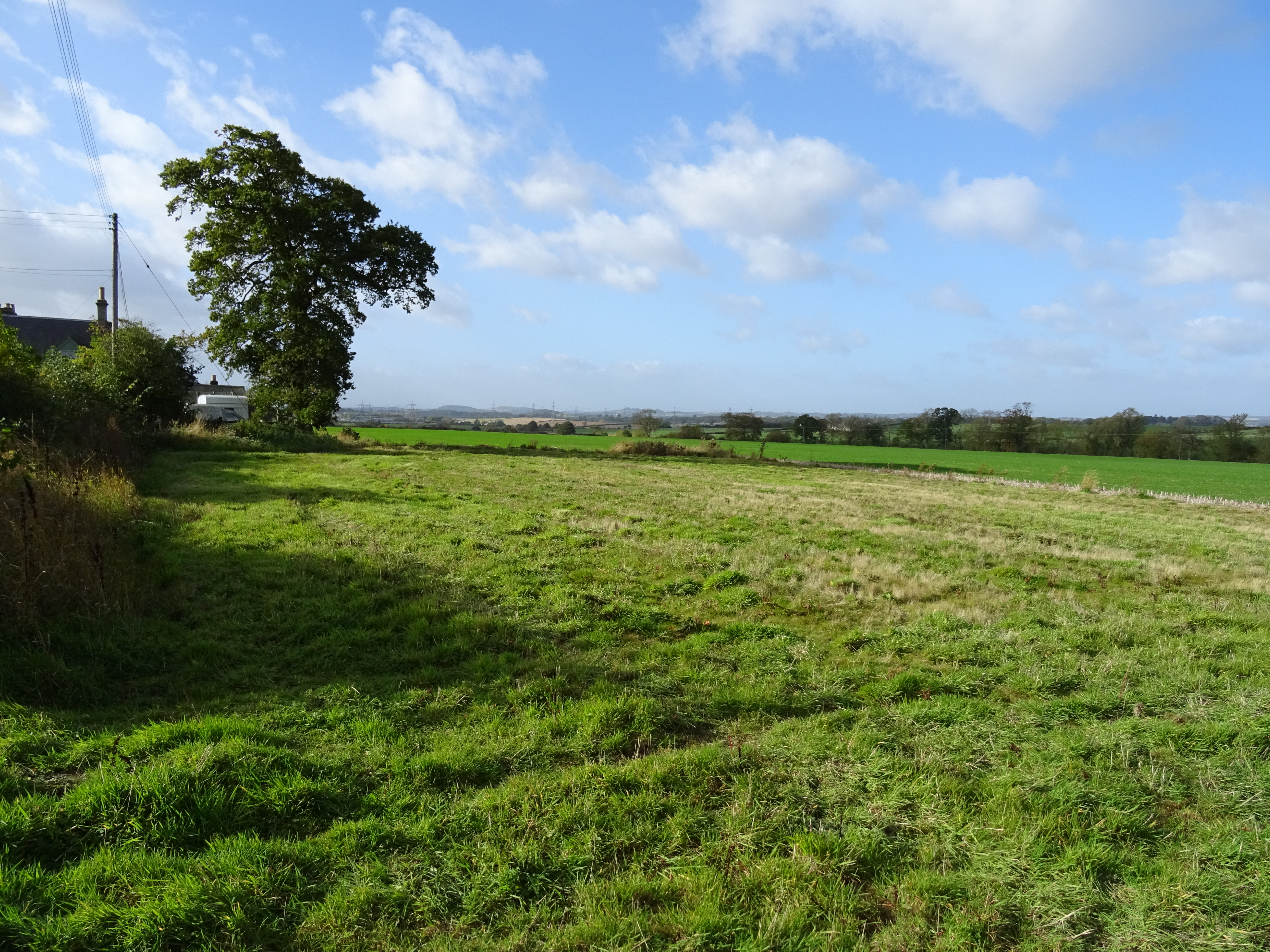

Finally, we have arrived at Base Camp –
Base Camp being the plot of land we have finally purchased after many months of legal based delays and a relatively quick and painless planning application, which was granted just recently.
The initial offer went in during May 2015 and it has taken all these months to be formally accepted. The offer was always going to be subject to certain conditions - cost of utilities, condition of ground and planning permission.
The reason for the delays stemmed from the complexities of our Plot being severed from a much wider area of land which had various financial charges against them. Quite why the Vendor hadn’t sorted this out prior to putting the plot to market, remains a mystery but thankfully, the delays have not impacted on our build schedule as we now intend to sit on it until early 2018, which is when we will start to cut the turf so to speak.

We also contacted local Utility companies and a local Ground Works company to try and ascertain “ball park” figures for a connection to Mains water and Electricity.  The water mains is on the over side of a single track road, which runs along side our plot.
Water – the tunnelling under the single track road, in order to join the water mains has been priced up at £1600. - Plus standard water board connections – should come in around £2000.
Electric quotes for connections – from 3 metres to post & to lay 45 m of low voltage main, termination and associated jointing equipment  - £2300. This was all done on-line and quite a painless process I thought.
We also had the soil tested for its strength and porosity - £1200. This test was done in our absence and I just wish that I was there for the exercise. Sadly living some 300 miles away, it just wasn’t possible, added to that, we didn’t anticipate such a delay in securing the offer!
The findings stated that we are good for “conventional strip foundations - down to 1.15m, with an allowable bearing pressure of 80Kn per q square metre” - I am hoping for an insulated slab but have not made any enquiries as yet into this possibility.

That looks like a good plot. If the ground is good for normal strip foundations I can't see a problem with an insulated slab.
Yes you will need the discharge permit from SEPA, and you will probably need to get that at the time of doing your building warrant, that delayed our building warrant as we "discussed" alternative drainage arrangements.
Re your water and electricity connections, You can probably reduce those charges by doing the trenching yourself. I got the electricity cost down by nearly £1000 by digging a short bit of trench and digging the connection pit (and filling it in afterwards) it saved them bringing a digger to the site  so they just had to send the jointers.
