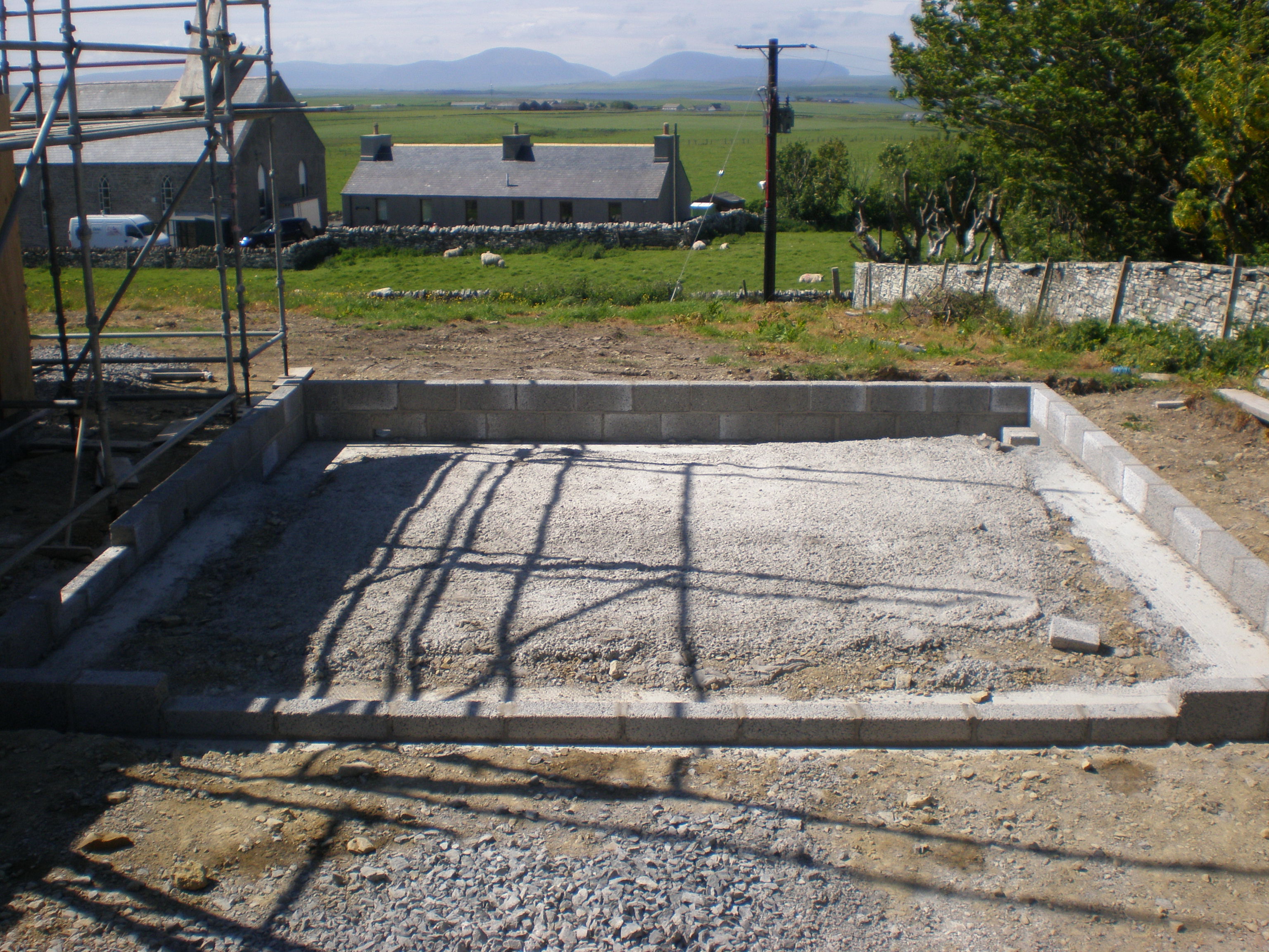

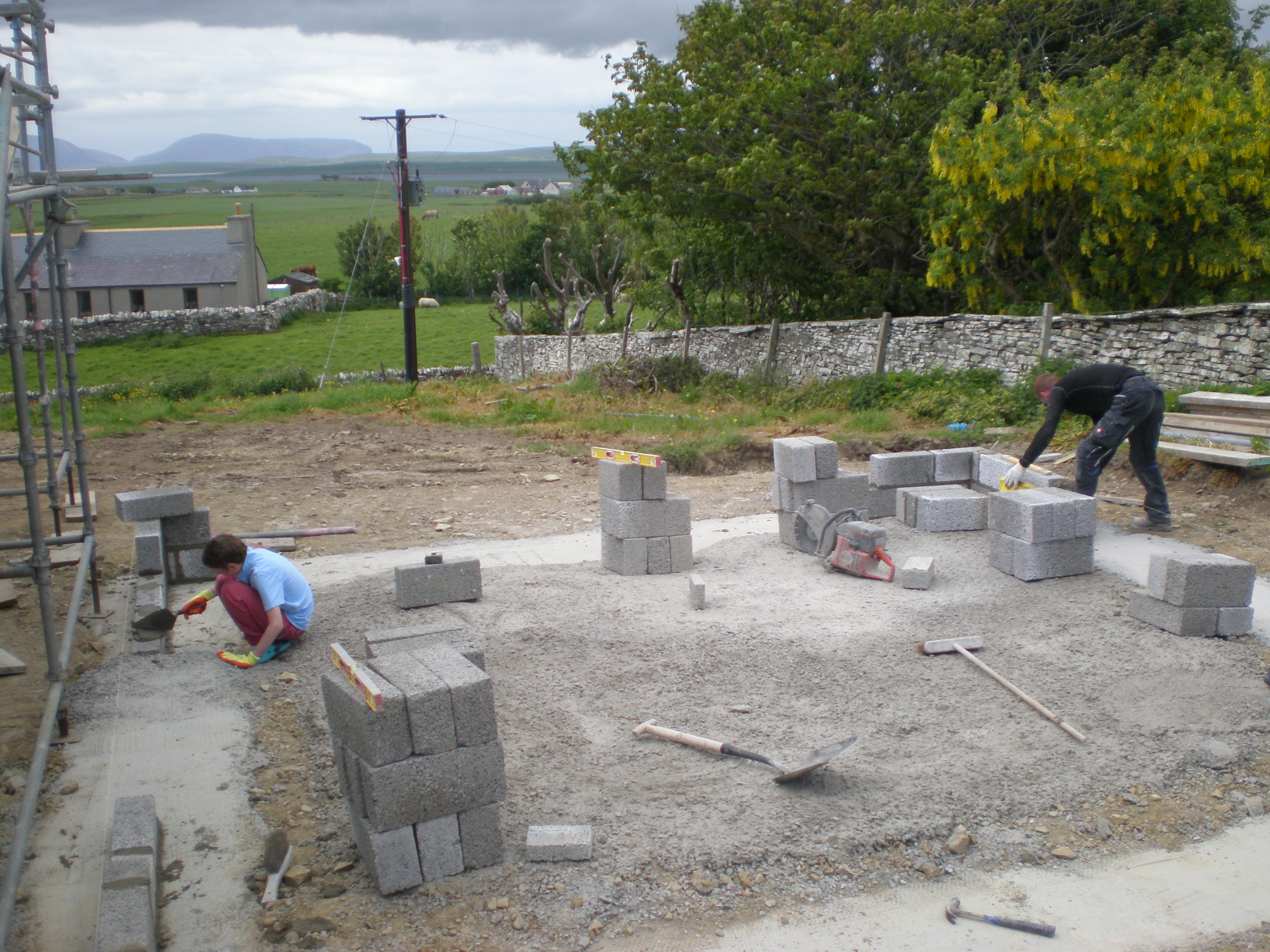

6" blocks were laid onto the strip foundations previously poured.  You can see my youngest 'helping' lay this foundation blockwork.

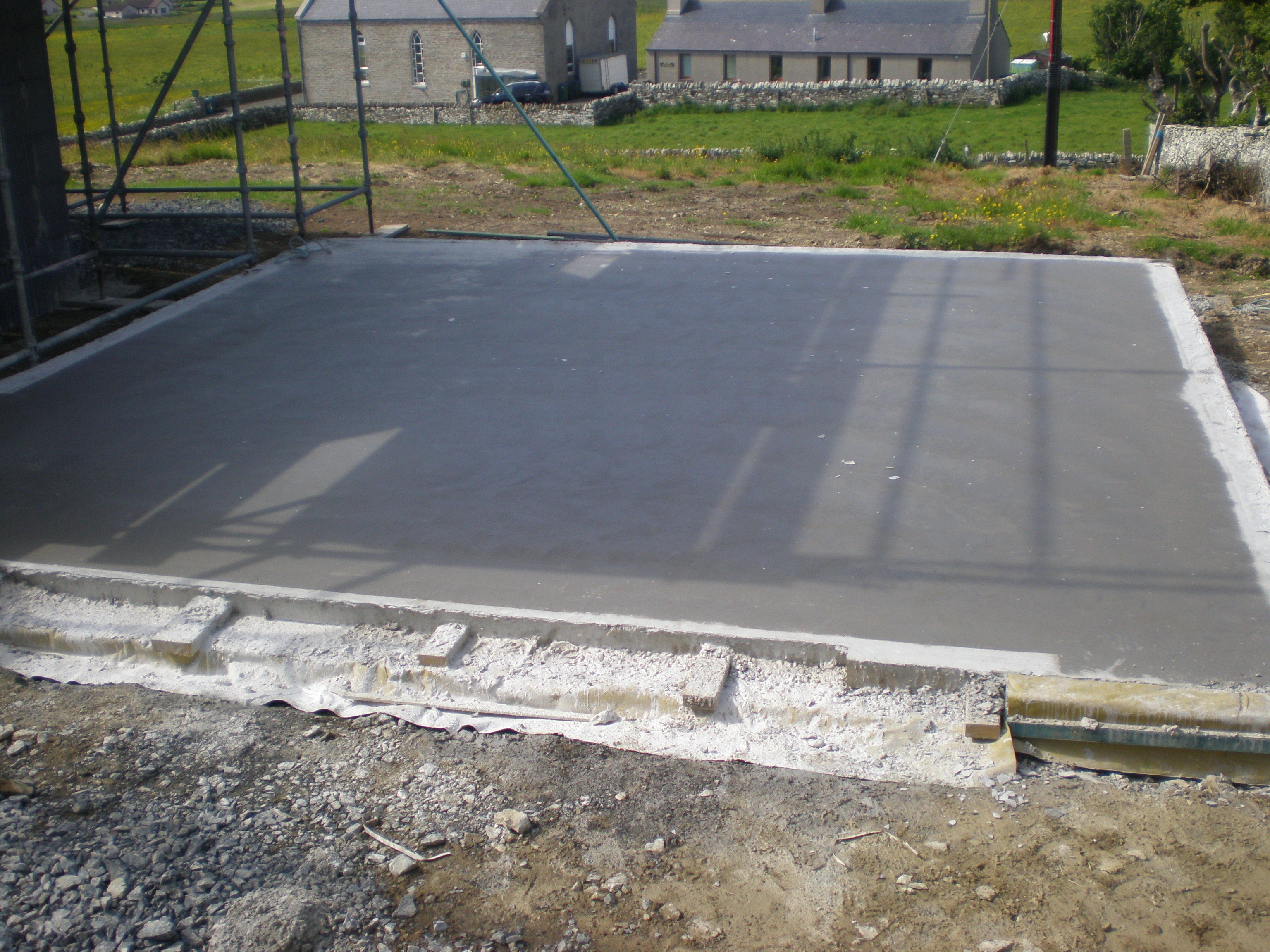

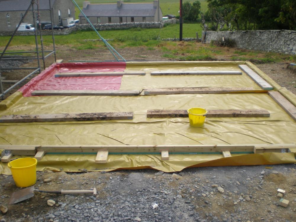

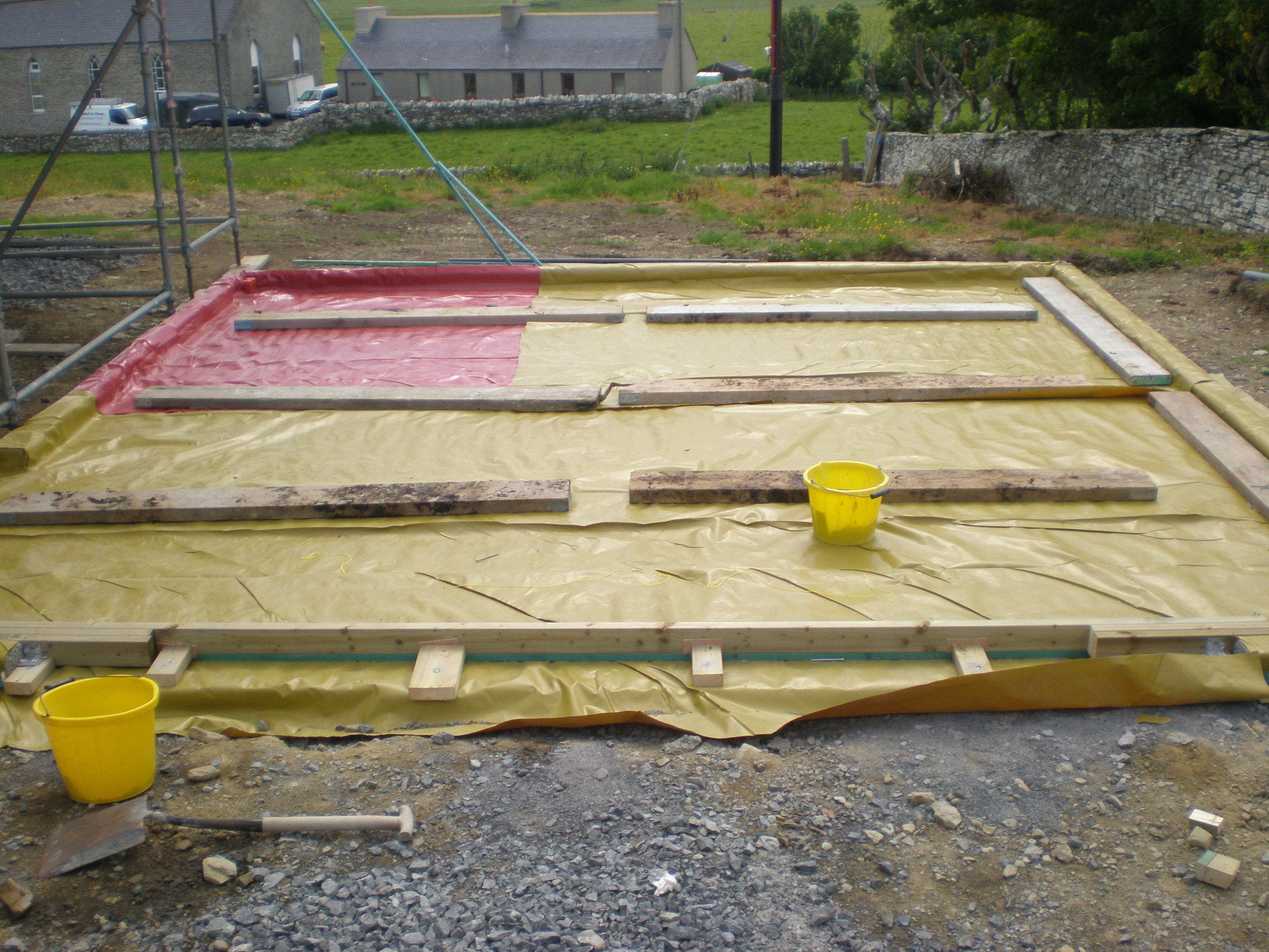

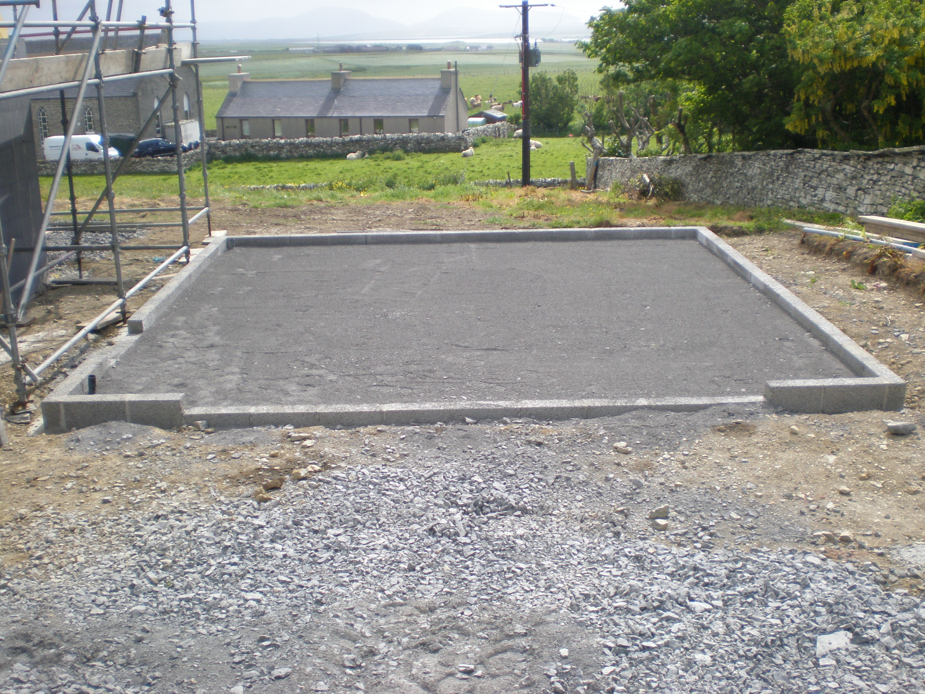

Upfill and blinding, DPC and Slab poured:

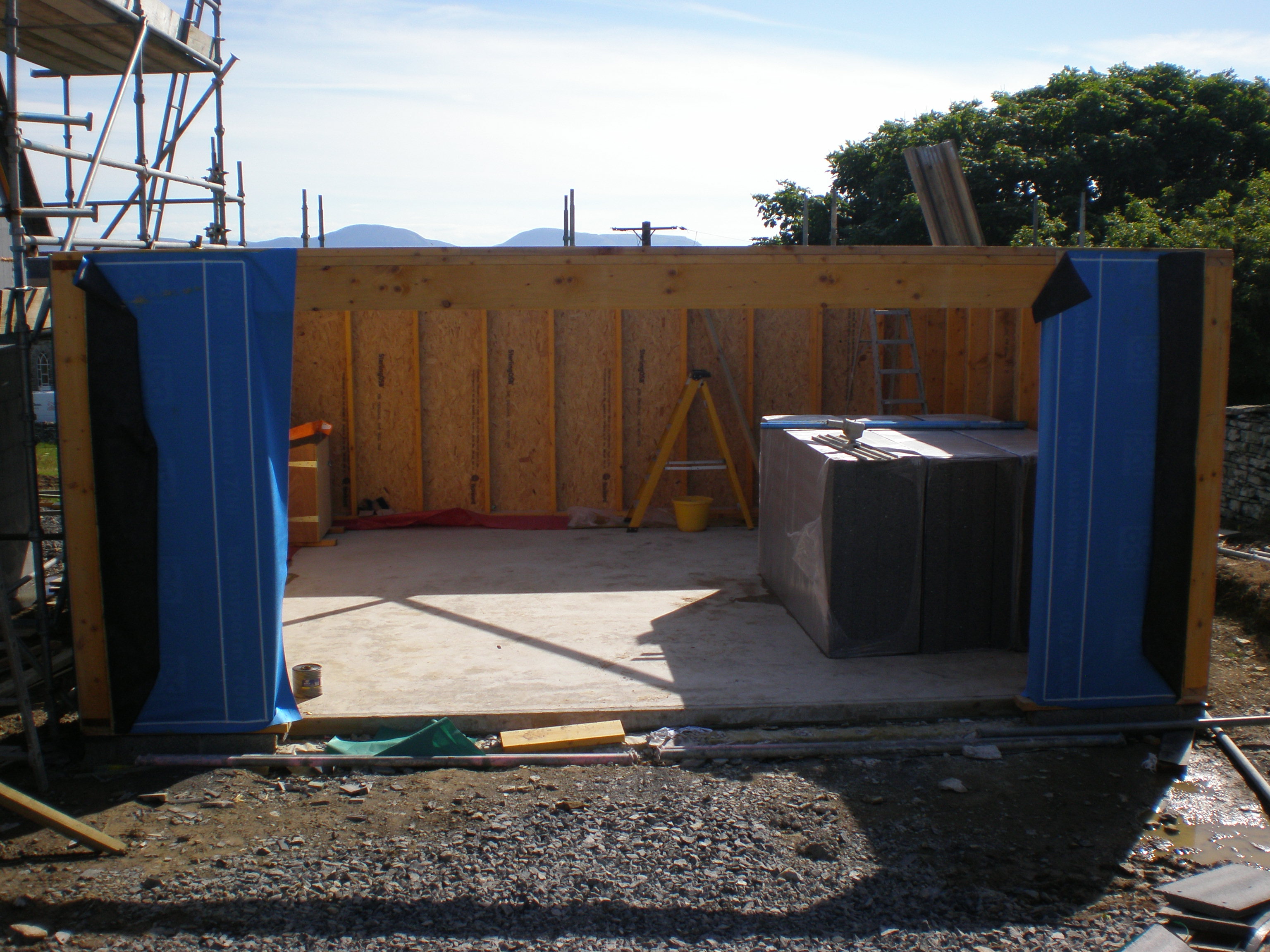

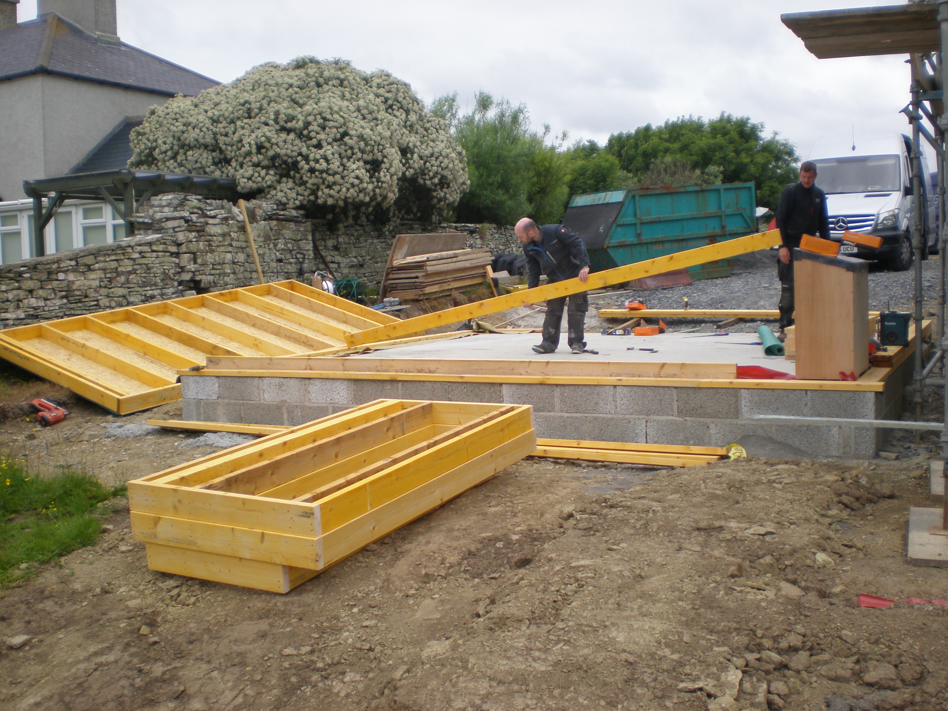

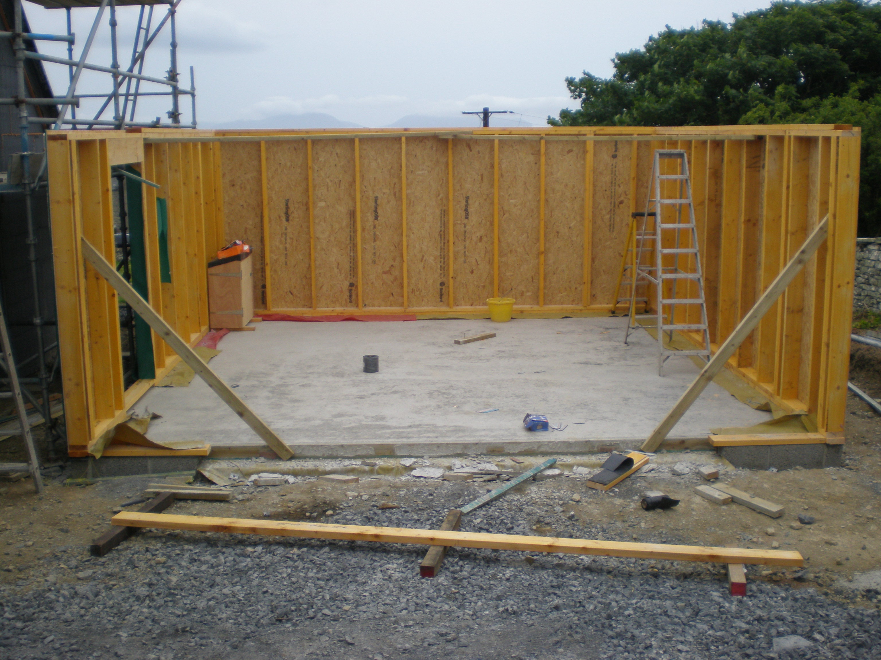

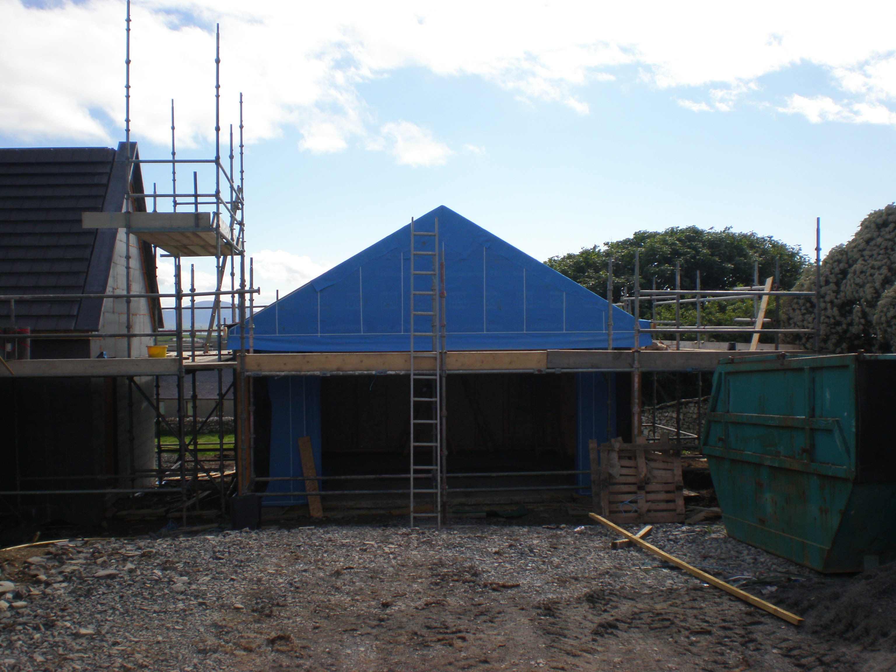

6" x 2" timber frame was constructed on site:

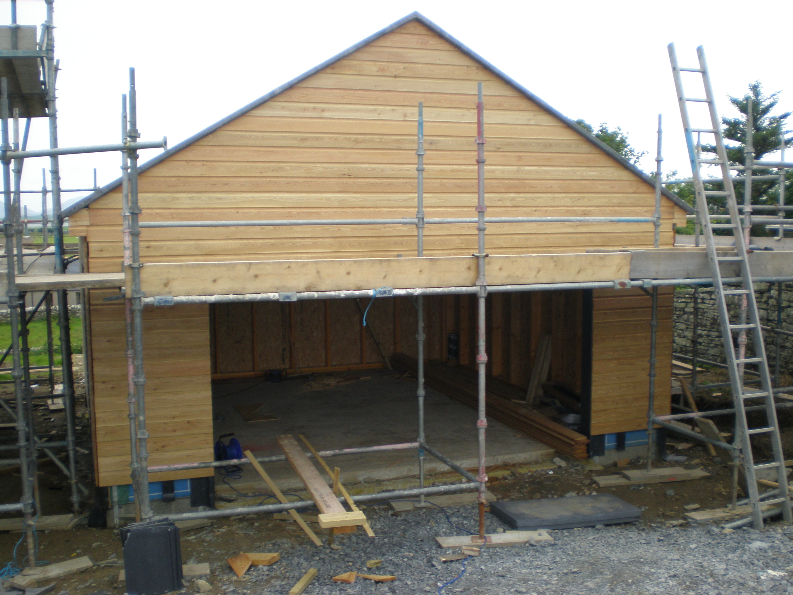

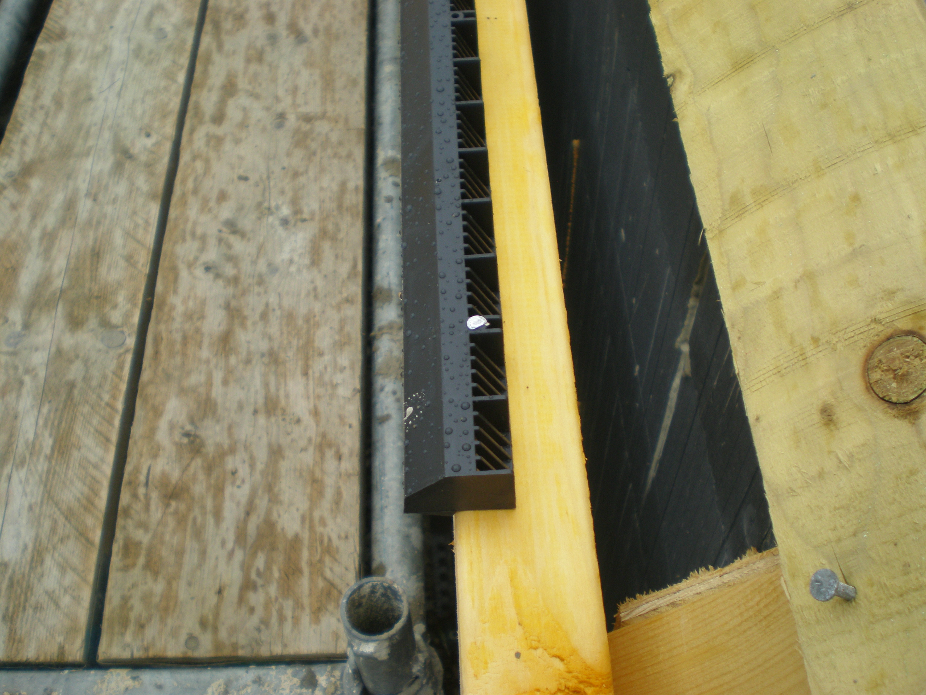

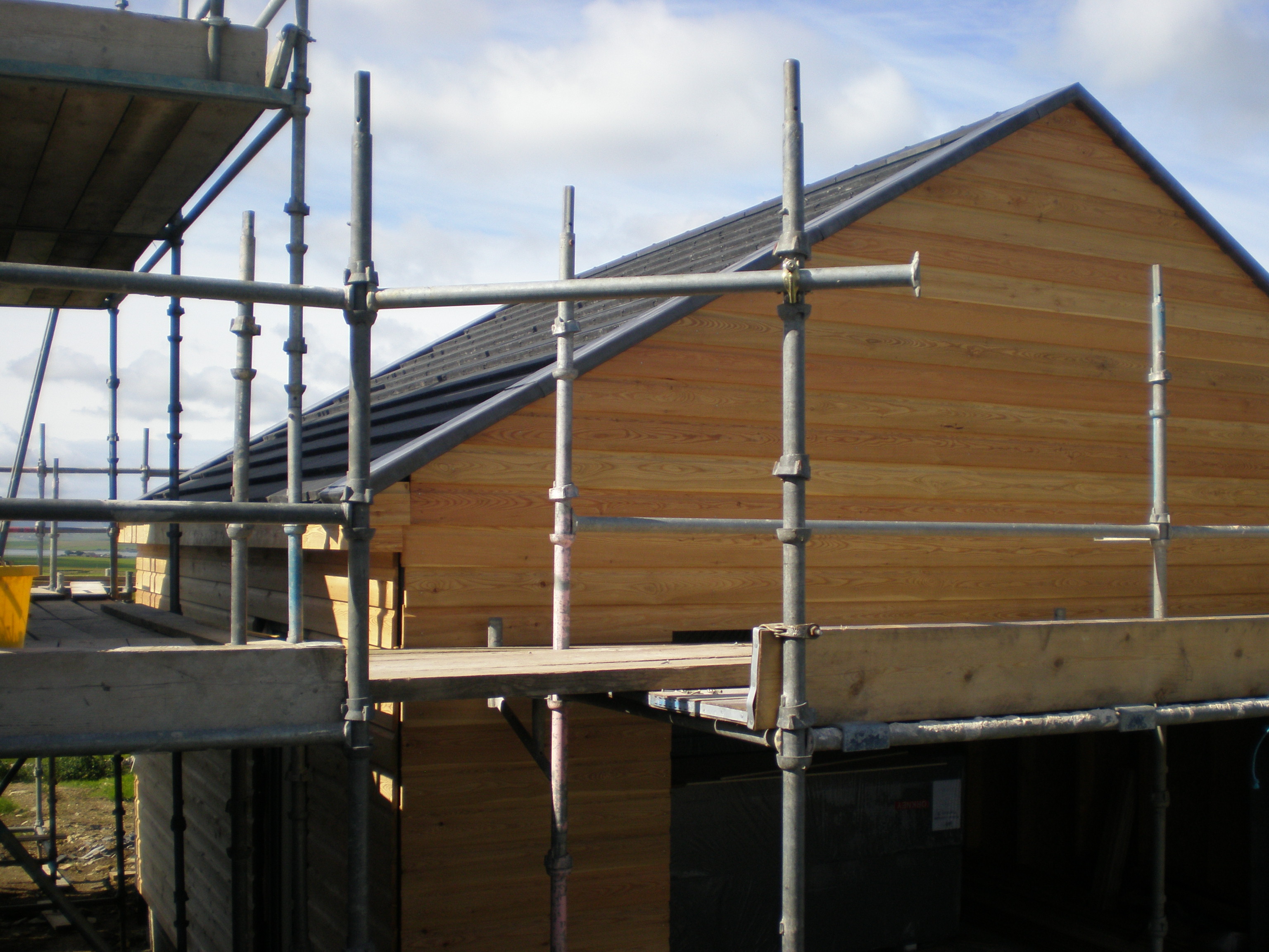

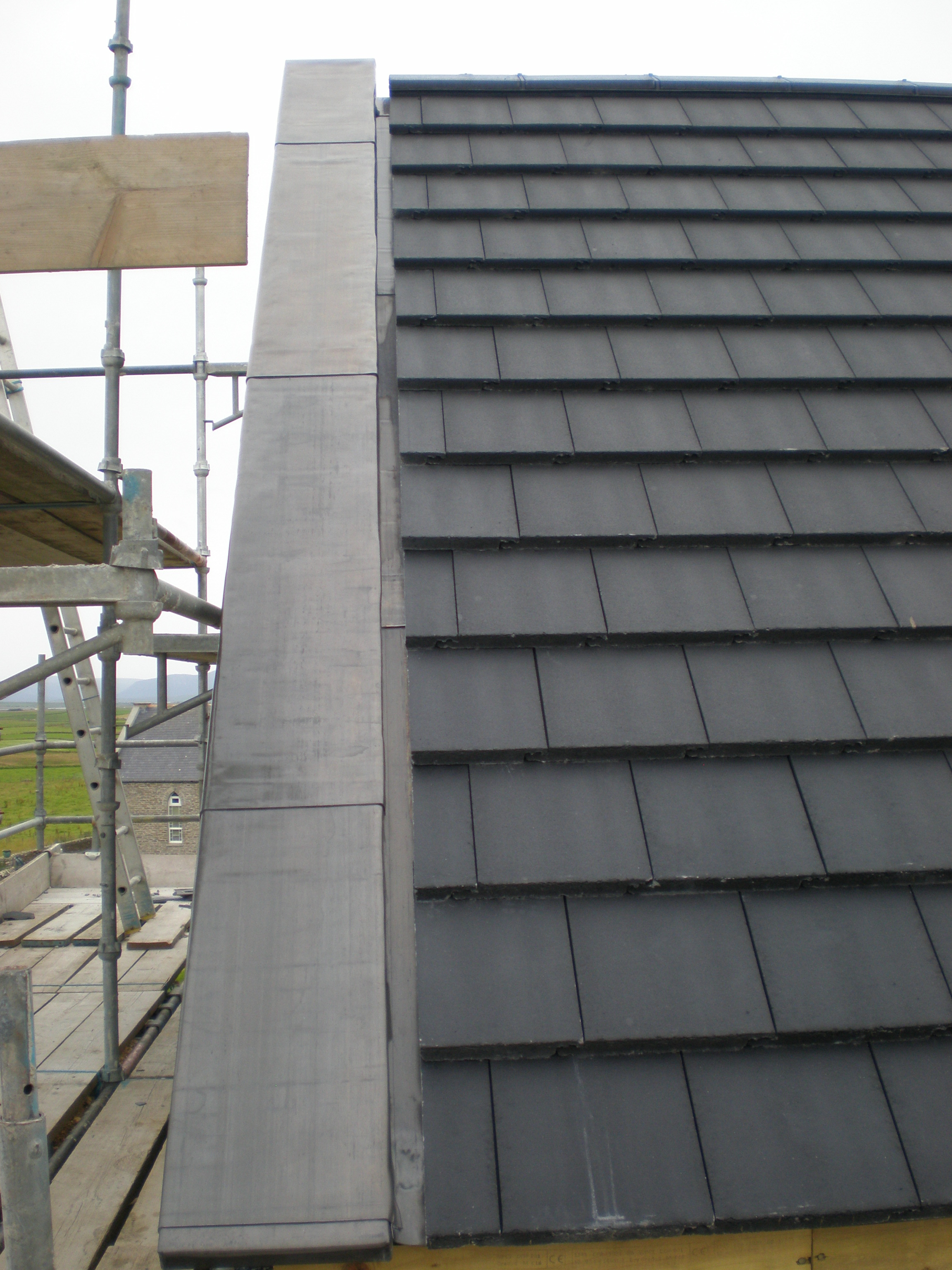

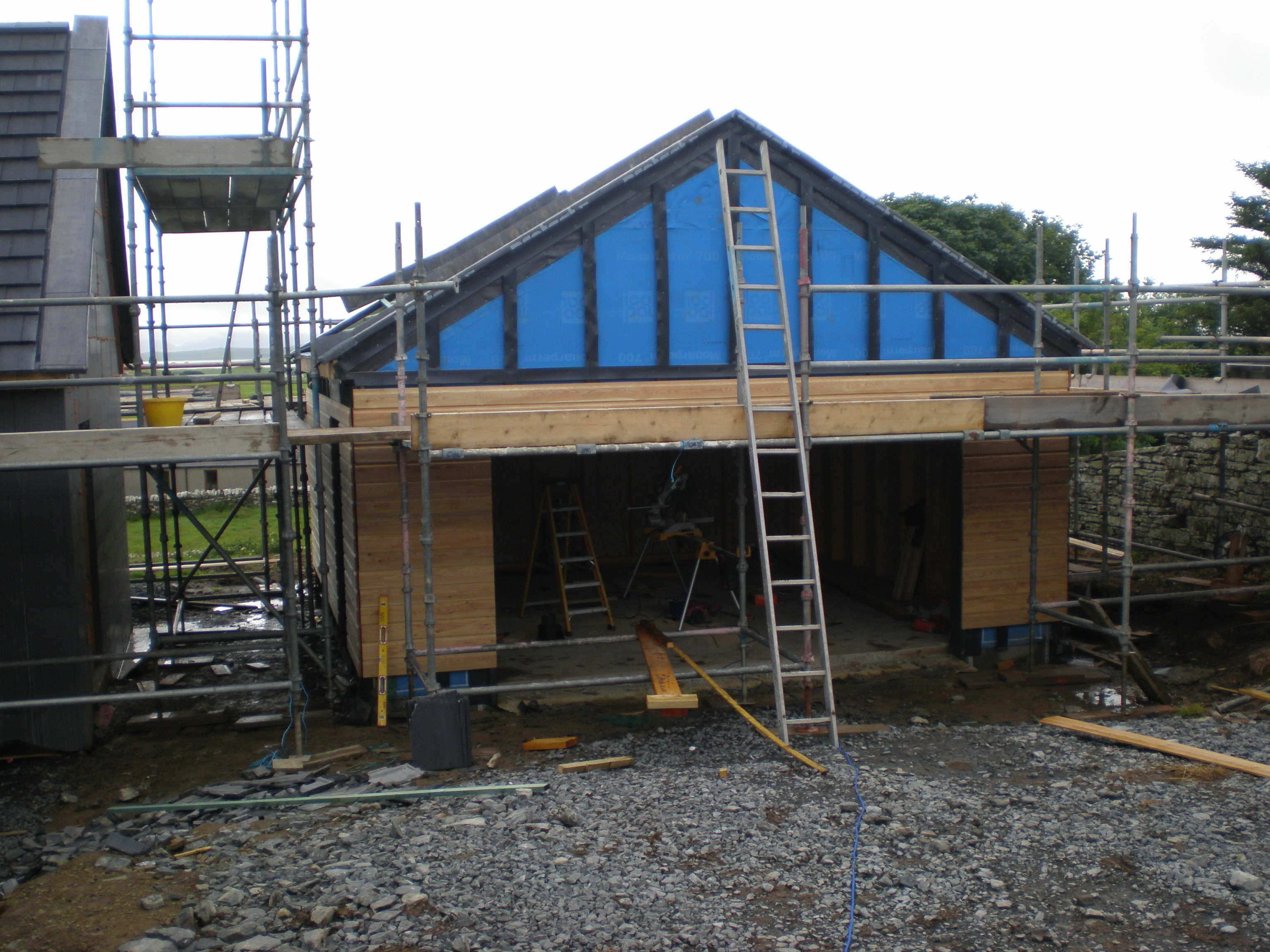

Timber Skews were formed and covered in lead as per the house, the roof battened out and tiled as per the house and untreated siberian larch cladding fitted using stainless steel nails.  Plastic ventilation strips were used instead of insect mesh at the bottom of the cavity between the timber frame and cladding.
The cladding still needs finishing off with corner pieces and a trim to the underside of the skews.  The side door has been fitted but we are still waiting on the main door. Ramp access into the garage will be completed further down the line.

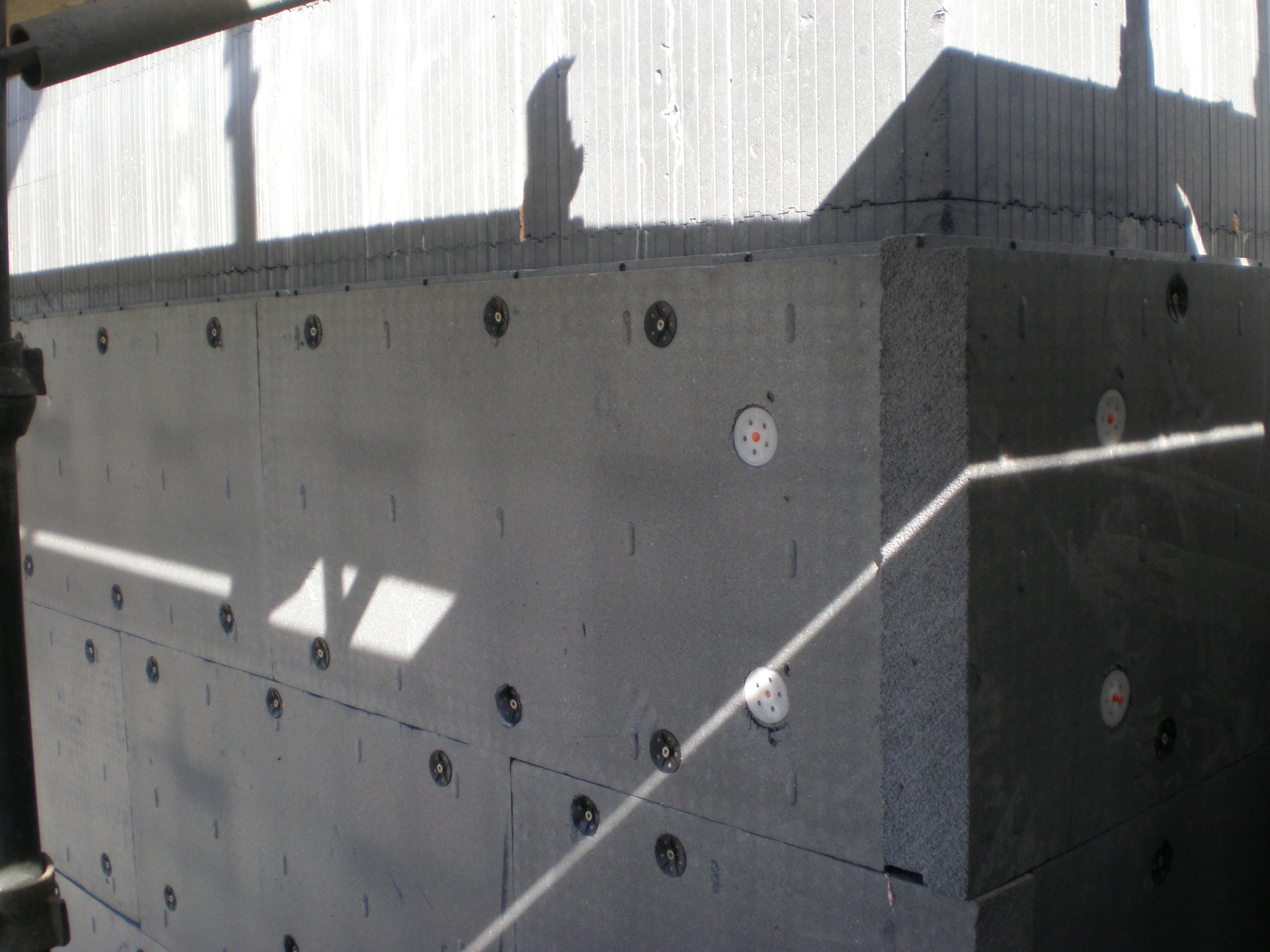

Other than some EWI being fitted to the outer face of the ICF blockwork:
and applying patination oil to the lead skews following a very useful discussion here:
we have been a bit limited in what we could get done.  With our windows on the way, and 4 joiners due on site from Monday, we should see fairly rapid progress.

you got a photo of the ventilation strip detail?
Sounds interesting and I can;t picture it in my head
Link to comment
Unfortunately not, but its the same ventilation strip used on the roof (pictured below).  Lengths were cut to size to close the bottom of the cavity between the vertical battens onto which the cladding is nailed.  I'll try and get a picture tomorrow.  IIRC the cladding board overlap sits over the sloping section of the ventilation strip, so you don't actually see any of the ventilation strip at all.
Link to comment
