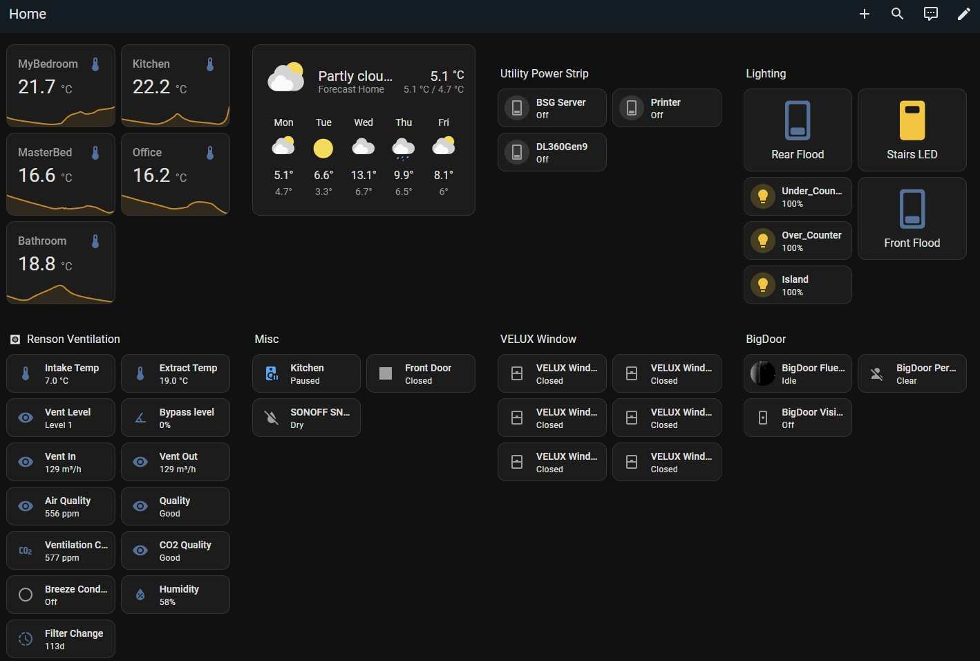

Alongside this I've a load of sensors and smart lights, switches and sockets around the house. Now I'm in a position to setup Home Assistant for the first time and figure out what I want it to do. I setup an initial dashboard to organise the myriad of sensors and entities and allow me easier monitoring and control. Work in progress but have a look at the setup below!
I've still to figure out Daikin integration (The app works fine, just nice to have more data / energy usage in one place) and get my Sonos text alerts to work but I'm making progress. I have older Hikvision cameras but the integration for that isn't working yet. I wanted to use human detection to trigger security lights front and rear but for now I'm using the smart doorbell out front and might use a contact sensor on the rear lift and slide door to rig something up - otherwise newer cameras might make things easier but I'm not giving up yet! There's a lot you can do with Home Assistant besides automating lights - one of the rewards of building your own house just as you like it!!
A lot of the newer appliances come with some type of smart integration but sometimes you don't want them all spying on you so just a smart socket that tells you when power usage drops to zero for more than 5 minutes is enough to warn you that the washing / drying cycle is finished in a notification message you can choose and hear. I've a couple of sockets that can do exactly this!

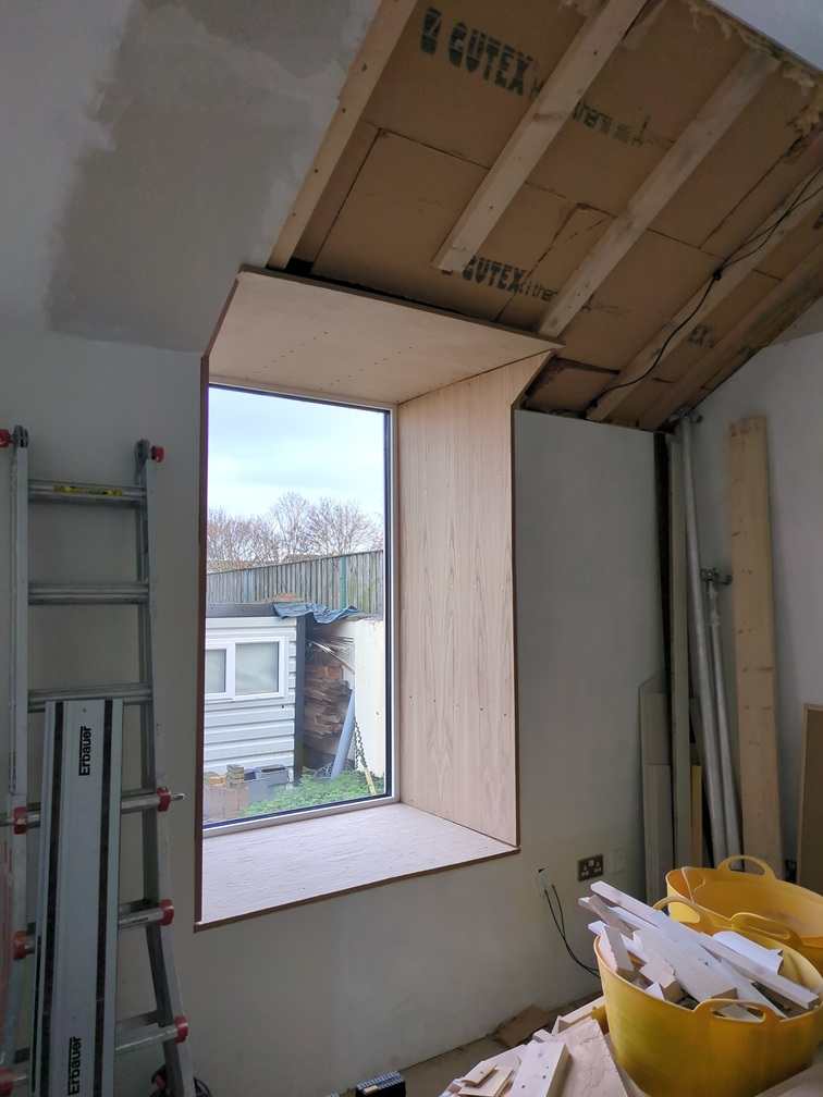

Over Christmas the plan is to finish the living room so I can sell the scaffolding tower and move the last of my furniture in. I put the sheeting on the rear oriel window and bought some cushions / edging and a blanket so it's suitable for reading a book / relaxing in. The bottom edge is already getting frayed so I'll need to source something tougher to withstand punishment.

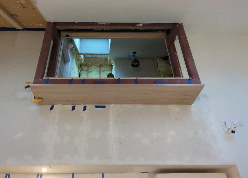

Next project is finishing the internal window at the landing that overlooks the living room. Got a price of €900 for the glazing - I'm blocking off the right side but will have a small window on the left in addition to the big main window. Again, there's a seat up there to perch on with a book and relax in and a double socket at your feet to plug a charge / light into etc.
