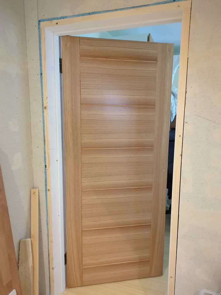

Getting internal doors installed (by someone else!) currently. Put some acoustic insulation around the linings and cut it back.
I like the look of the wood/oak veneer.

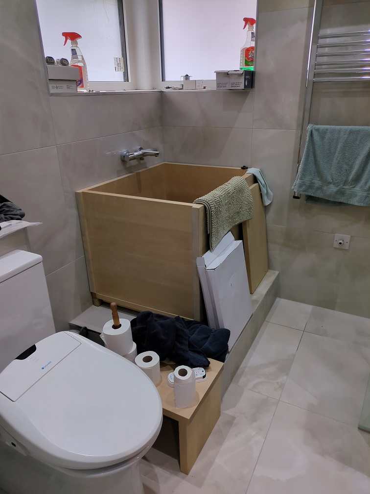

Had two floods to deal with. I've a japanese bath I was trying out. We'd filled the bath with a little water to check for leaks a few weeks ago and it drained fine. The bath is on a platform to allow for a trap to be installed below it. The drain for the bath just fits into a grill so it's open and can potentially overflow which is what happened after I fully filled it, used it and two days later pulled the plug! Luckily I put the plug back in and used towels to keep the water in the bathroom as it's tanked / is a wetroom so no damage was caused to the rest of the house. There is a seat in the bath so I was trying to get the most comfortable position and removed the seat. I'll probably put it back as it's a short bath and my back didn't like the sitting position on the floor of that bath all scrunched up. The seat means you only get heat around your hips so will have to have a think about it more at some stage. Or get a bigger bath!

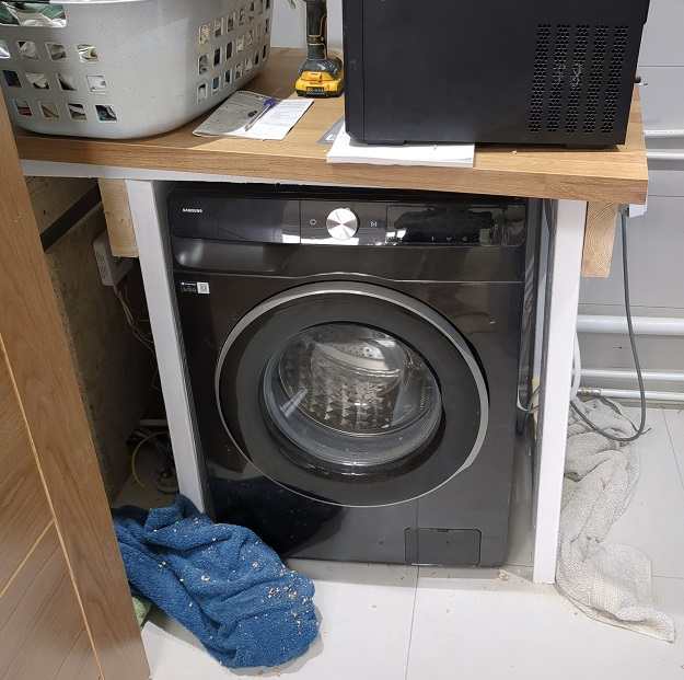

The second incident was with the washing machine last night. The discharge pipe isn't big enough for the tumble dryer, air to air condensate and the washing machine so I got an adapter that taps into the side of the pipe with a spigot for the washing machine discharge. This didn't seal/hold so it spilled everywhere. I think I'll go back to basics, replace that section of pipe and glue on a y bend to create two parallel discharge pipes and this way I can get everything connected at once and no risk of floods!
