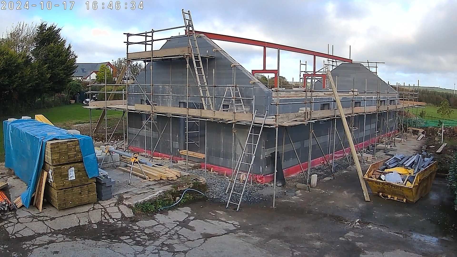

On Monday the second gable is poured and most of the internal bracing, corner bracing and window shuttering is removed.
Tuesday rains all day so no work on site.  The internal floor is under 1 inch of water with no way to escape, without us brushing it towards soil pipe.  Good to know we are airtight at the floor/wall joint.

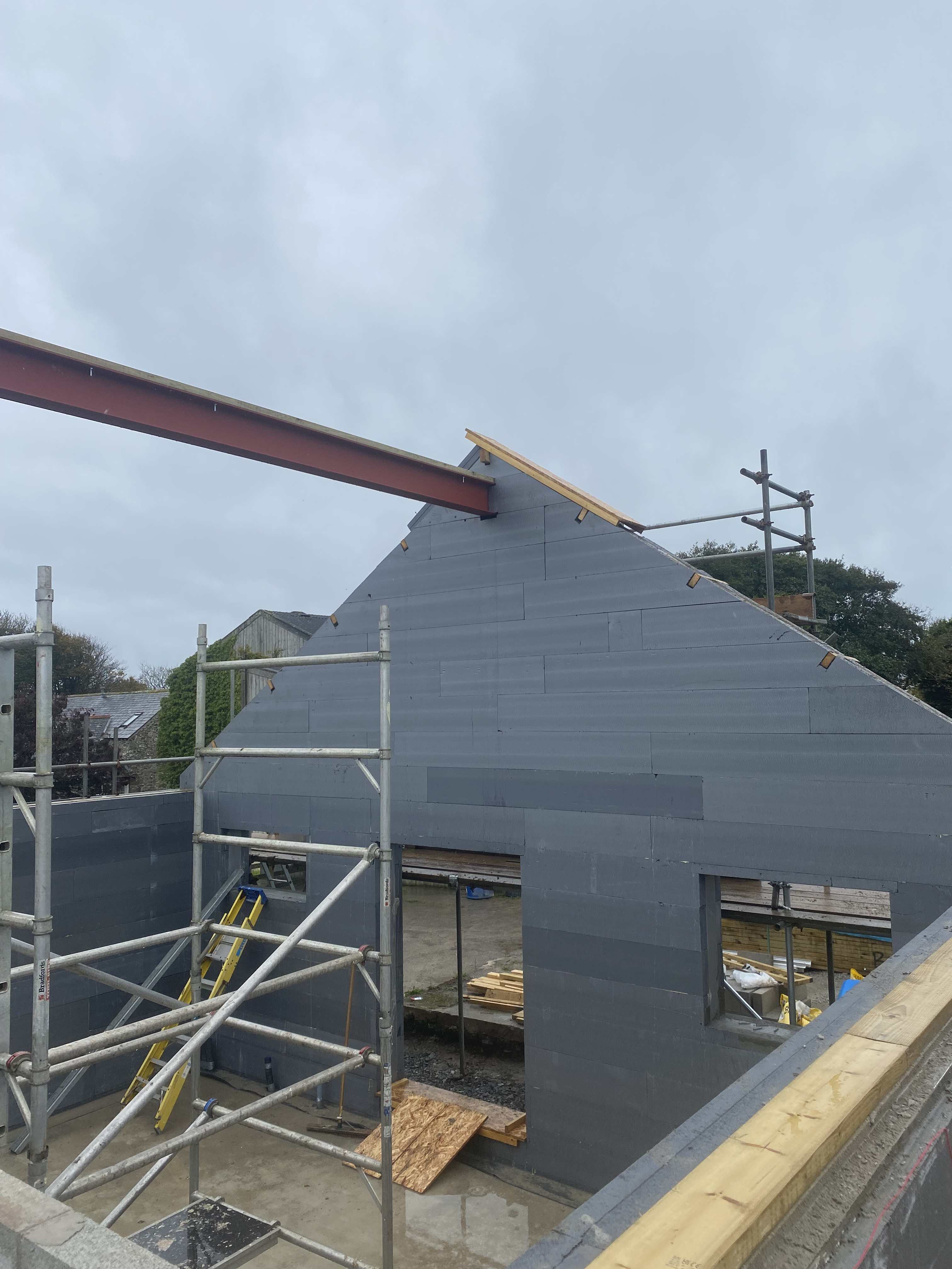

The steels are installed, we were supposed to have wooden roof beams but somehow this was not calculated by the architect who insisted the roof truss company would do the calculations later.  The roof truss companys only want to do the calculations when they know you are ready to order and they said the beam spans could not be done.  So on the last minute we had to go back to the SE who worked out our steel beams and the total cost of roof went up £8k.  I wish the architect had suggested the SE looks at the roof calculations earlier but unfortunately we just have to move on from this, and up to this point we have had no other extra costs.

That looks like a slightly scary prop for the ridge steel but I'm sure it's ok!! Just don't slam the door too much!!!! Great work and hope you're enjoying the paddling pool! We had to knock out a corner of the foundation as it was taking too long to brush out a hole we'd drilled which would get clogged up fast. The soil pipes weren't cut down at that point. Hopefully no ducks made their home there?! It's those calculations and little gaps that can cause such headaches, well managed though!

The doorway has no door on this opening only on the next one, and the walls are now built up further.  It has now dried out, even got to lay down where the beds will go to check the view out and ceiling angles.
Very happy with the work so far from the builders.

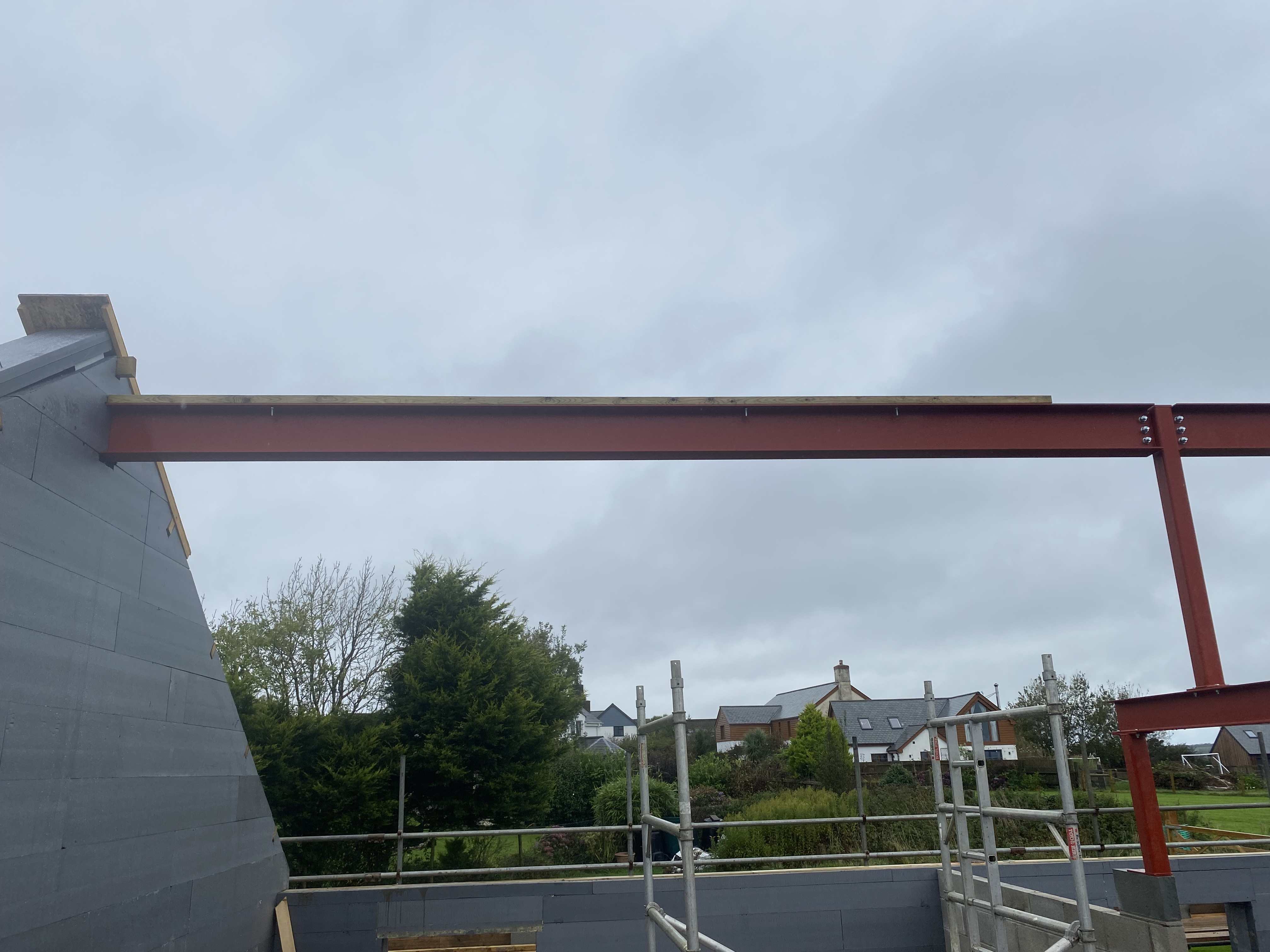

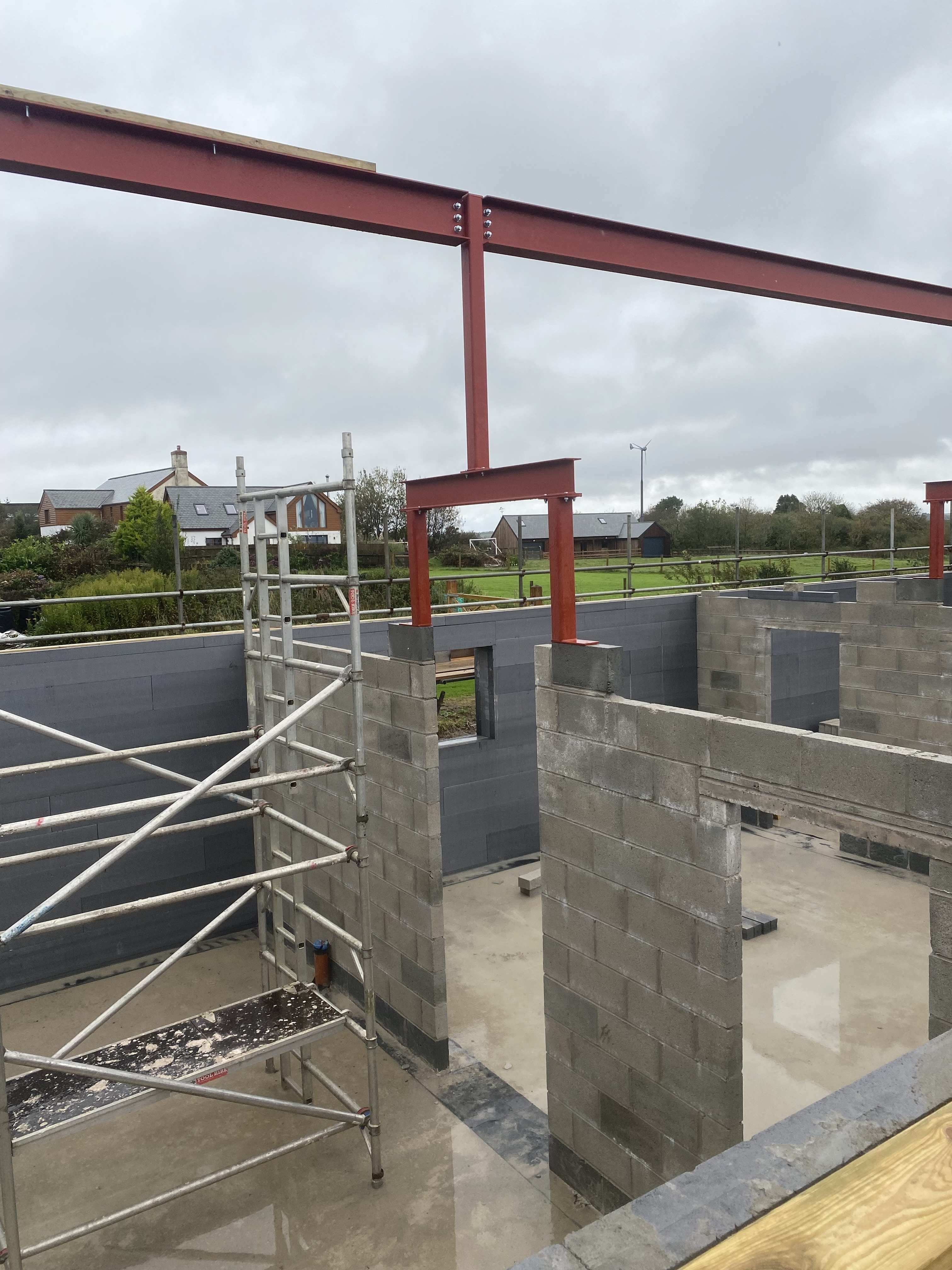

The loads imposed will be purely downwards and any sideways loading is taken by the cable ended. So all it's doing is limiting the downwards droop of the steel.
It will be scary if it's not properly restrained against not least movement in the direction of the ridgeline... in fact likely dangerous.
John you have a number of pivot points (like rocker bearings) and due to the nature of steel fabrication and behaviour it will tend to buckle sideways due to the vertical load. I can see where you are coming from ( gables taking out the wind load I assume) but it is very important that this arrangement of steel has solid restraint against moving in the direction of the ridge and also perpendicular to the ridge.
Please check your SE drawings and make sure you follow them religiously.. don't let the builder / steel fabricator go off and do their own thing. Do this before you load up the roof further. If in doubt get some temporary bracing in.

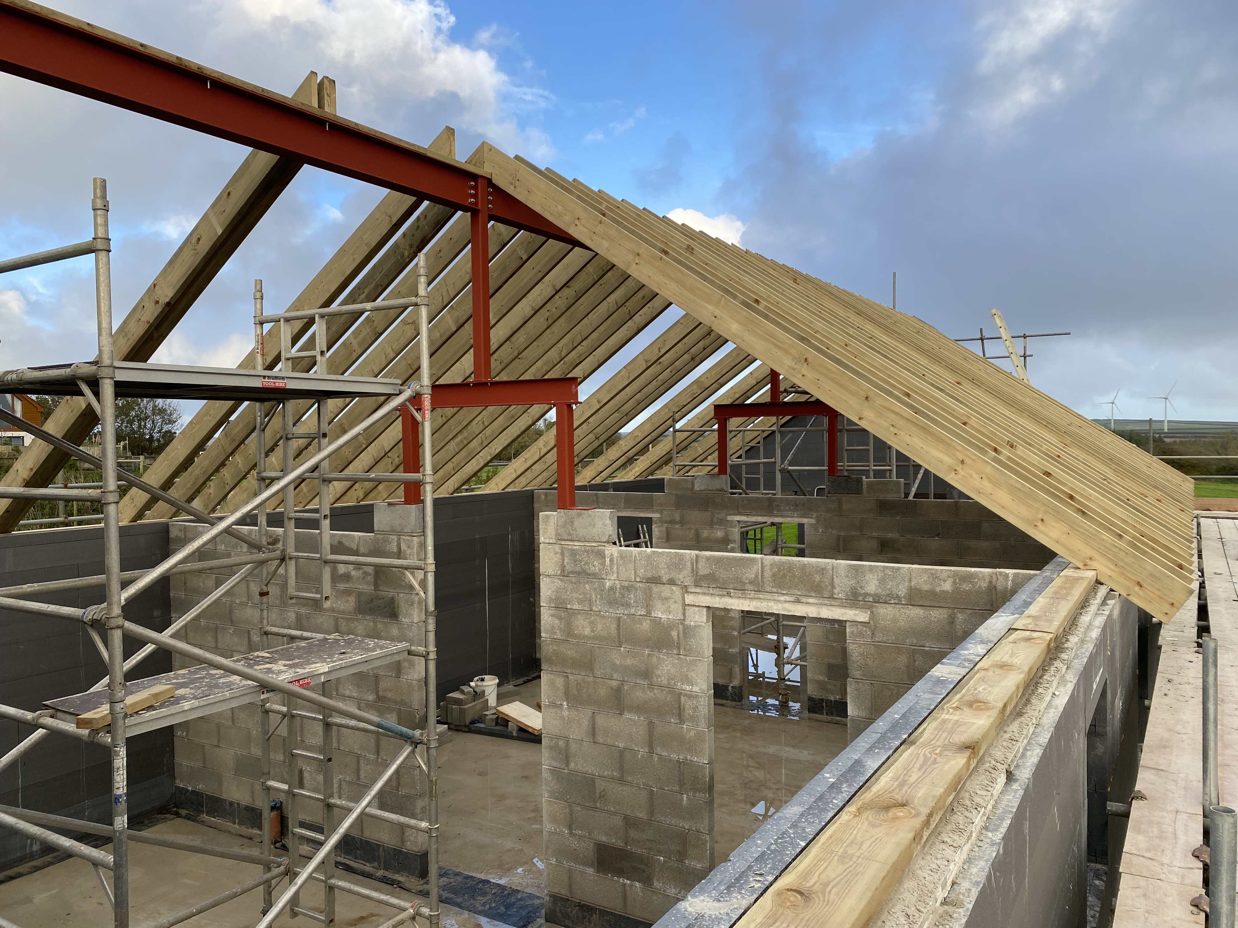

Hopefully when I publish last weeks photos showing the wall built up around the goal posts and that the rafters now have collars on them, all is well.
Thank you for all your concerns I will double check all the details.
We have not got as far as the OSB yet so it is all still visible to check.
