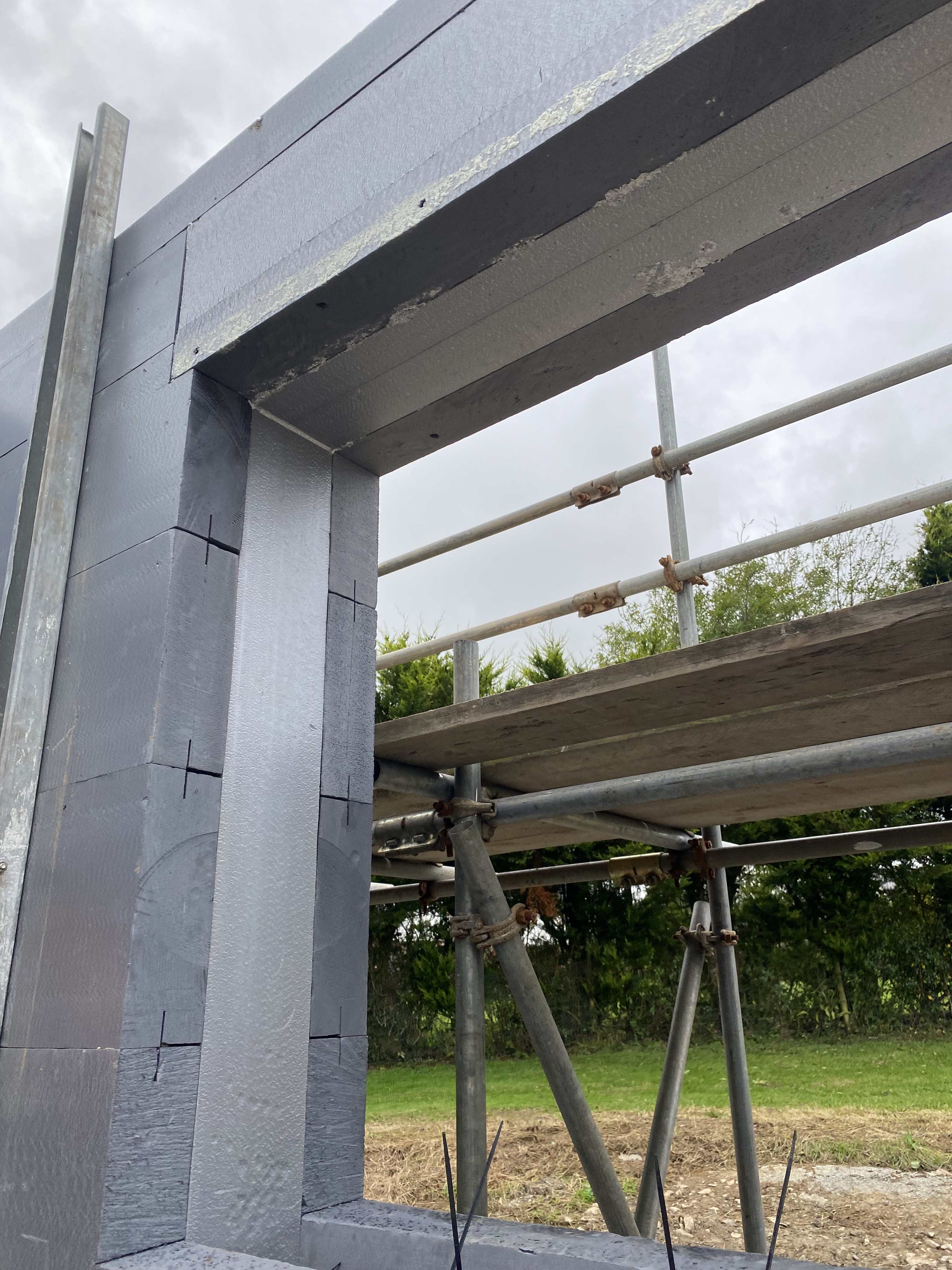

At the beginning of Week 5 the scaffold arrives.  The ICF walls get past window header height so they can be boxed in first with the ICF to close the side jamb, header and cill then the wood brace for the concrete pour.

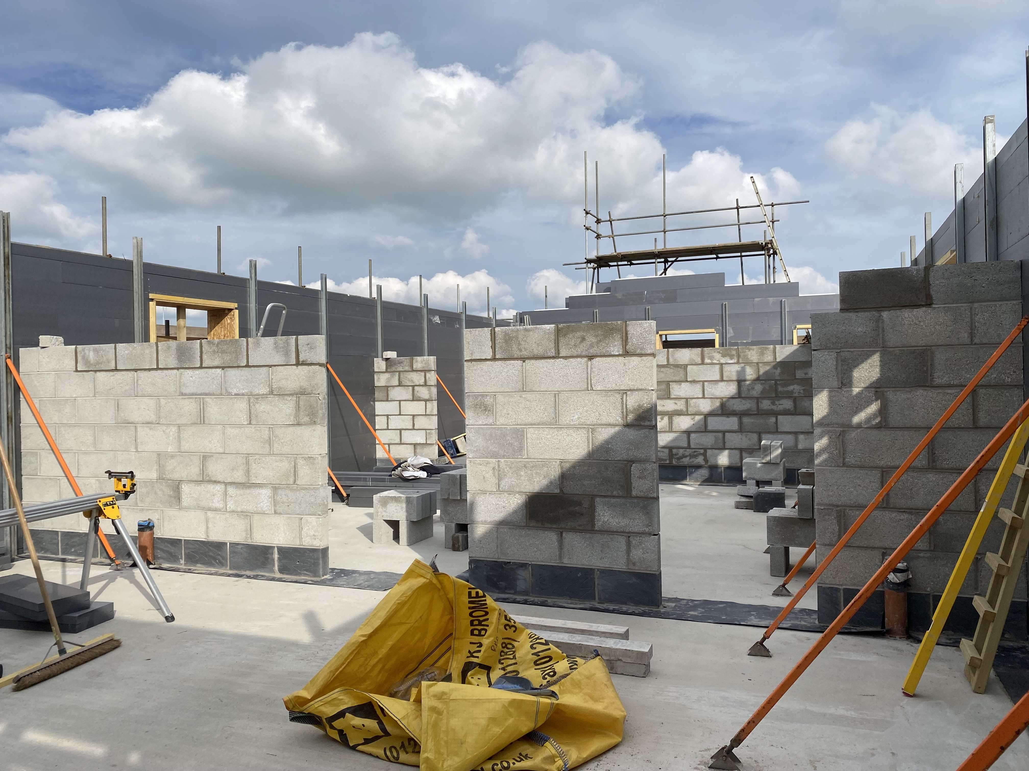

The internal structural walls are started and tied into the ICF. These are to support the steel roof beams.

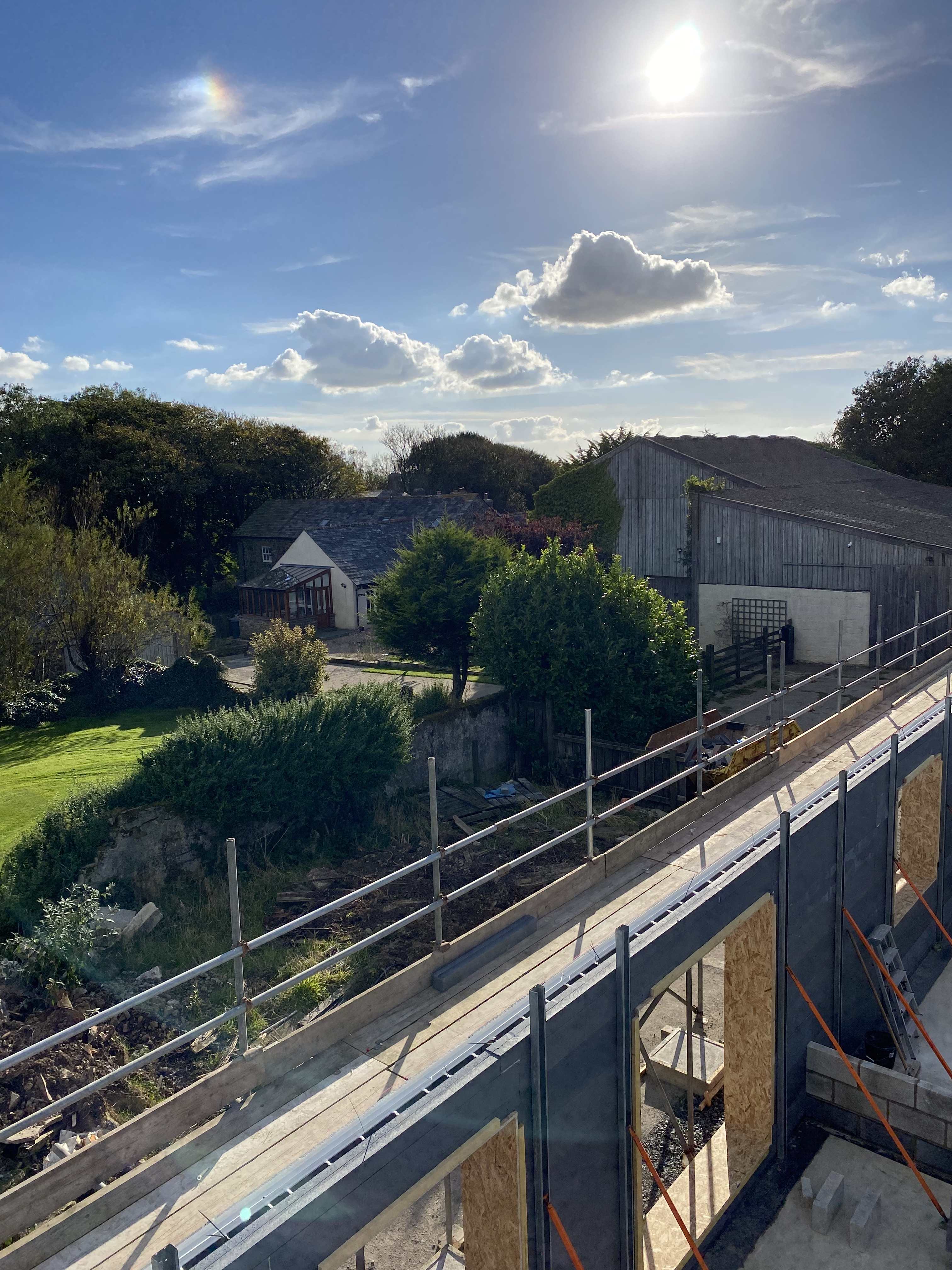

Its good to stand in the open plan kitchen and lounge area now and get the scale of the room, the three windows look down our field to the East and the slider door opening looks out South towards Dartmoor, visible on clear days.  The kitchen may look a bit dark but it will have 4 velux windows that as well as providing light help to zone off the open plan area.   The photo from the scaffold shows our workshop in the big barn and beyond that just visible is our current home.
The weather has not been too bad during working hours, a mixture of sun shine, rain and strong wind with gusts of over 43mph so I will be happy to see the pour next week.

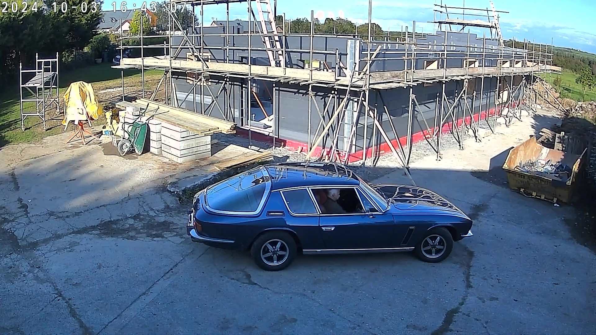

This week the car is our own Jensen Interceptor my husband took it out in the sunshine when he went to our local ‘Men’s Shed’ in Holsworthy.
