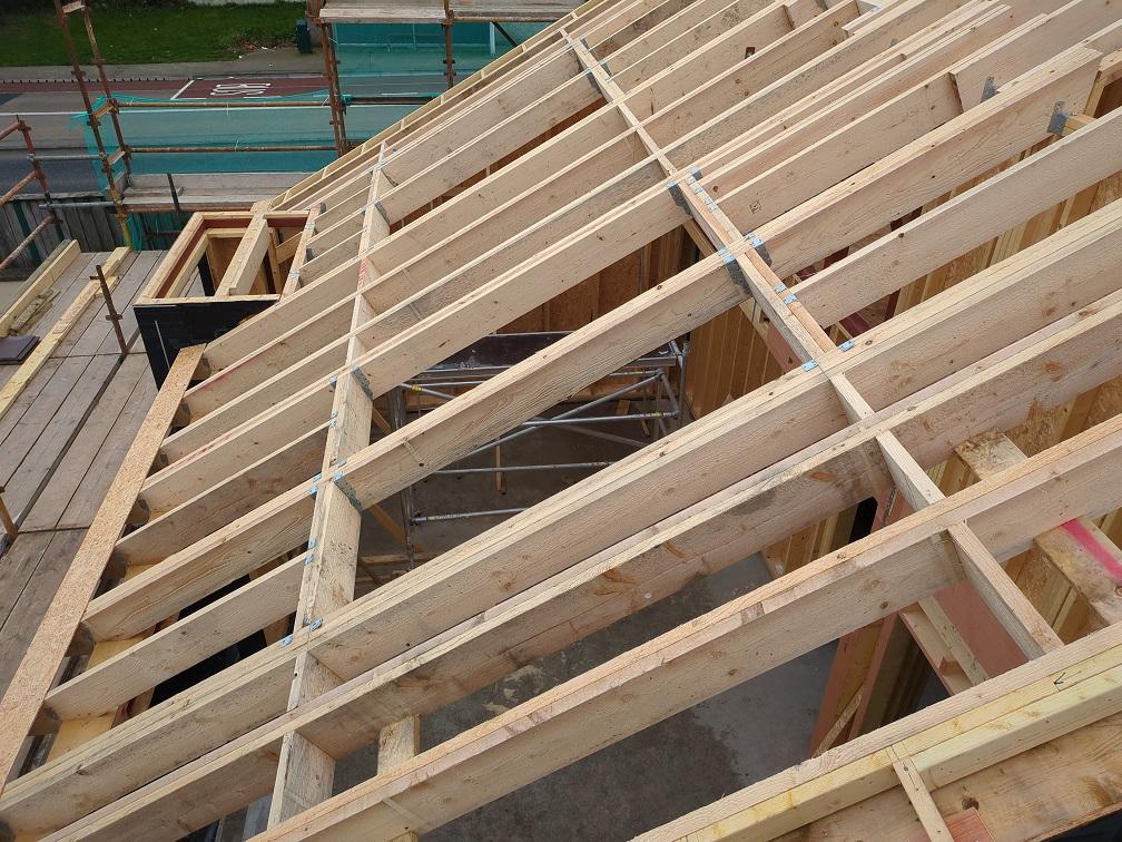

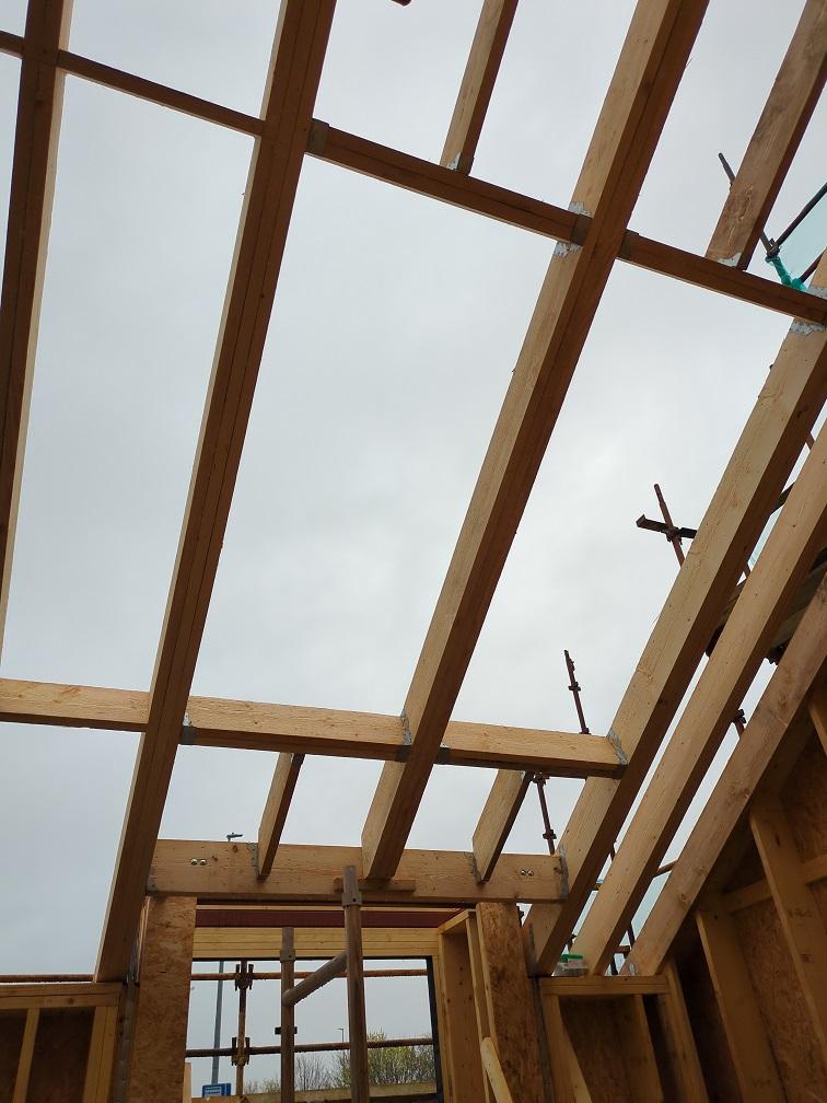

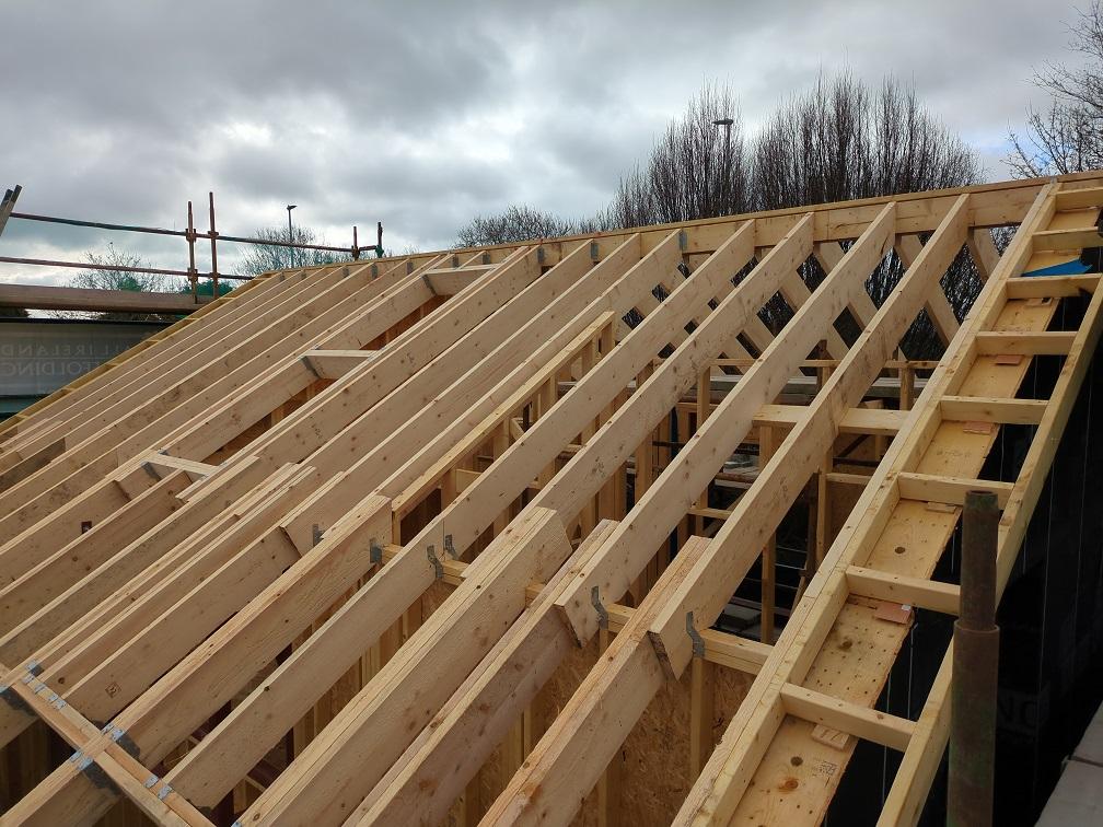

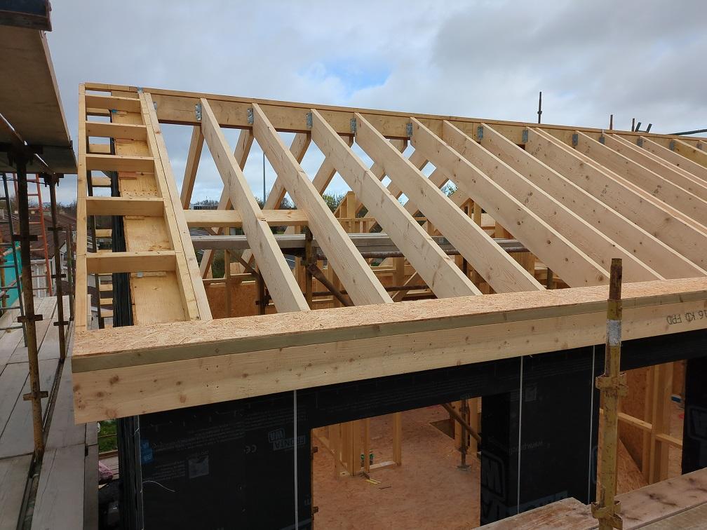

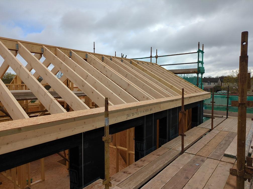

This week the roof was cut in. Can see the spaces for the Velux rooflights and get a different picture of the inside - the vaulted ceilings in the rear living area in particular. The builder recommended a ceiling in the upstairs  bedrooms at around the 3 meter / 9 foot mark which is high enough even if you're bouncing on the bed! Still leave a bit of space for storage so may leave a small hatch and floor this area after setting it up. It's a warm roof so this is all conditioned space. Next week they'll add OSB and Solitex WA, then baton and counter baton and that's them finished! The roofer is due in after Easter to install the tiles and the Velux will go in sometime then also. There is also an AEV for venting the soil pipe to install. There's a ventilated ridge, and other details that will be interesting to see installed. Should stop ice dams forming!
Big decision point is around the rear picture window - it's to be metal clad. There is the option of adding additional insulation on the outside and then stud work for the ventilation behind the steel cladding or just insulate internally only. Also the roof of this feature needs to be worked out. Some drain to the back of the house but that needs a gutter. Most drain towards the house which I didn't realise and the water channels to either side. This junction has to be perfect or it ensures rain ingress. There's a good local team recommended by the builder so I've left word and hope they'll get in touch next week so they can build out the 7 degree backward slope needed for the roof of this area.

Good progress. Nice tidy carpentry. A couple of suggestions if you like.
Solitex is top stuff but at a top price. If you haven't bought it yet I would recommend something like Glidevale vp400 or Fakro S65.
I used the VP400 on my garage and was very impressed, better than the Tyvek supro on the house. Look for a weight of 160g/m2 at least and a sd of less than 0.015 is my tip.
Tape and seal all joints in the membrane, as fastidiously as you would a an airtight layer and return it to the external windtight layer around the rafter tails.
I would bin the idea of Metac between the rafters. Its very expensive and itchy job to fit. Blown cellulose would be a much better option in my view. Much better for airtightness too. Ecocel in Cork did ours but there companies in Dublin too.
For the airtight membrane I used prodomo extra membrane and tapes from Prodomo in tralee. The black tape is the best. There is some on Donedeal at the moment. I just picked up 3 boxes for a bit of a discount.
