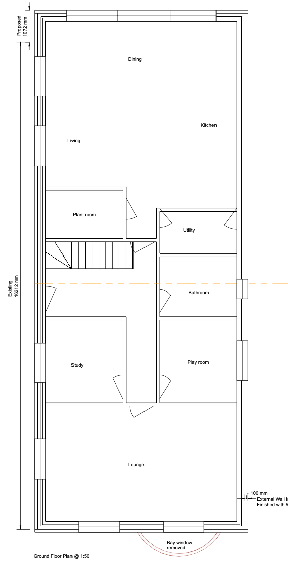

I used the knowledge of this forum to help me work out what i wanted to build. I was told repeatedly to knock down and re-build, and i kinda wish i'd of gone down that route now, but i decided to stick with what i had and make it work. With that said, i'm not paying much VAT, i'm doing a lot of the work myself, and the trades i do employ aren't VAT registered anyway. The 0% VAT incentive of going new build wouldn't have been quite as much as a game changer as i thought it might be.

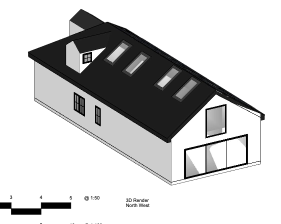

I had a bit of back and forth with the planners over 2 things, the height of the building, and the positioning of the rooflights.

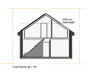

We managed to settle on raising the eaves approx 1m to give way more usable space upstairs, and a ridge height equal to the neighbours.

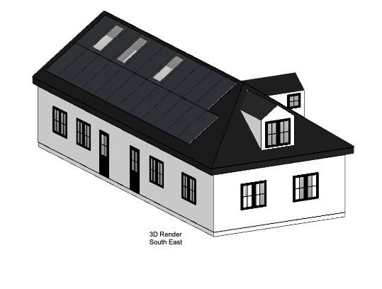

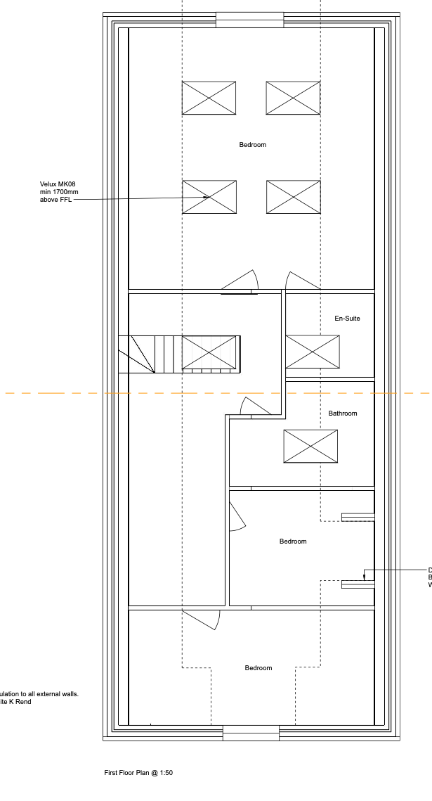

The rooflights had to be positioned at 1.7m above floor as to not overlook the neighbours, but i wanted to use the rooflight in the 3rd bedroom as a fire escape. In the end we managed to work in a dormer to that room, and position normal windows facing front and back at 1.1m for fire escape. (although, i think this is going to be quite difficult to work into the roof in practice, so idea's here would be welcome!)
In the end, after 3 months, we've ended up with approval.
Screenshot2024-01-04at21_26_13.png.075190eb3a78bc6c93082815add852bf.pngScreenshot2024-01-04at21_26_18.png.2fcc3d86d7c133994a2dcb9c09c32d41.pngScreenshot2024-01-04at21_26_20.png.6f4336532071e937d753d964767af867.pngScreenshot2024-01-04at21_26_26.thumb.png.e15ea20ad76f190fff8b5f8970b6456e.pngScreenshot2024-01-04at21_26_32.thumb.png.186f0344440fbd3ed896bde774d907ce.png

I should add, i did all the drawings myself using SketchUp and Layout.
