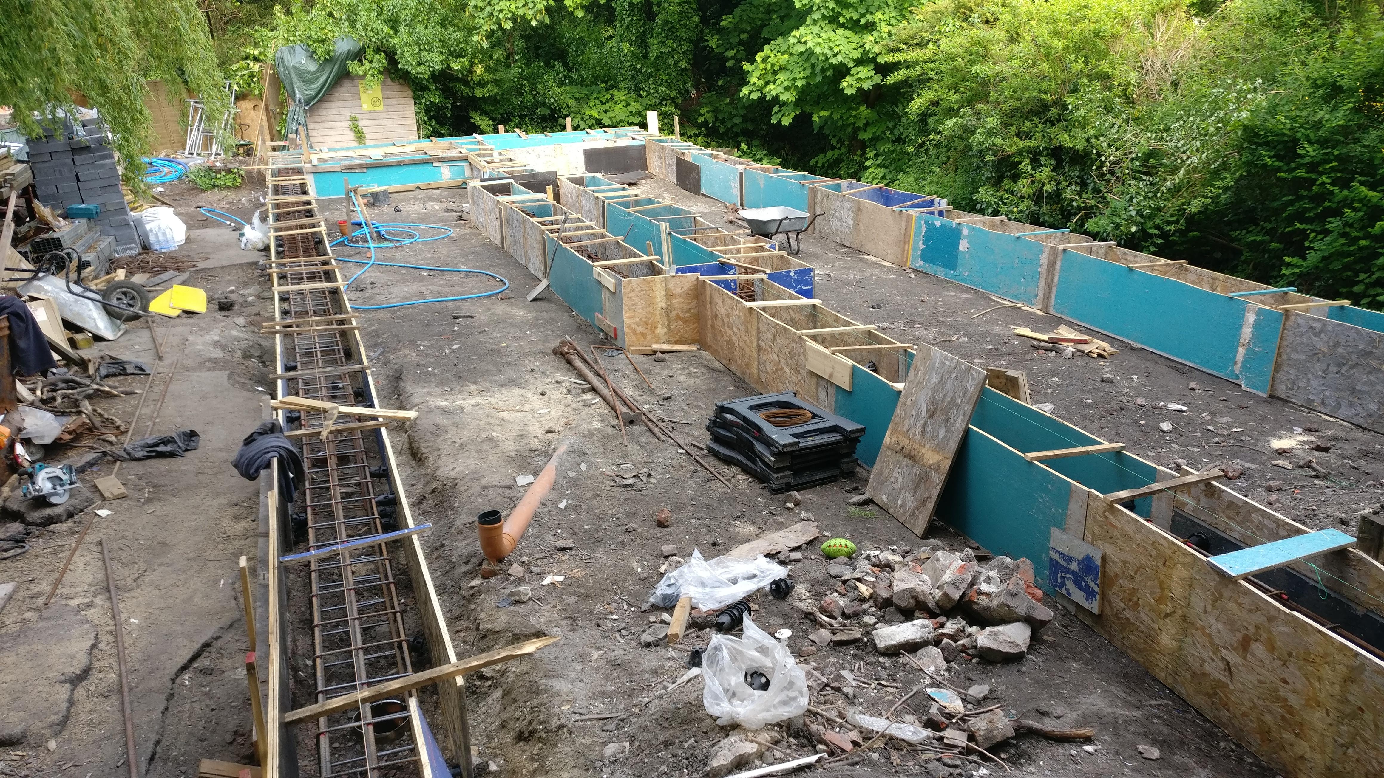

IMG_20200424_173631.thumb.jpg.815799b43ad85549b211f7d6965c656b.jpgSo finally managed to update the blog. Seems like nothing happened , but a bit of progress still.
Now just have to get this monstrosity past Building Control . Challenging task but I will manage. As always. I can tell I will not become a Groundworker in this life . Or the next.
http://tintabernacle.blogspot.com/2020/05/rc-beam-or-ringbeam-preparation.html
Here are some entertaining pics from this :
Above ground shuttering takes a bit of timber
Give over - it s gonna be inside a pile of concrete anyways ?IMG_20200424_173634.thumb.jpg.77e93ca398e61738ed3111f49ae0652b.jpg
Let s just assume this will hold.

Coming along. Did you have to compact the backfill or dies it not matter if ring beam connect to piles?
Patrick
To my understanding it doesn't matter at all . The ringbeam just connects the piles , so effectively is the pile cap. Load sits on the piles.
Simon R
Jeepers! makes our build seem like a cake walk. Good to see you making so much progress. Getting all that concrete onto site is going to be a challenge. Looks like the rebar caging is in good shape.
All Pat and I can say is "hats off" well done.
