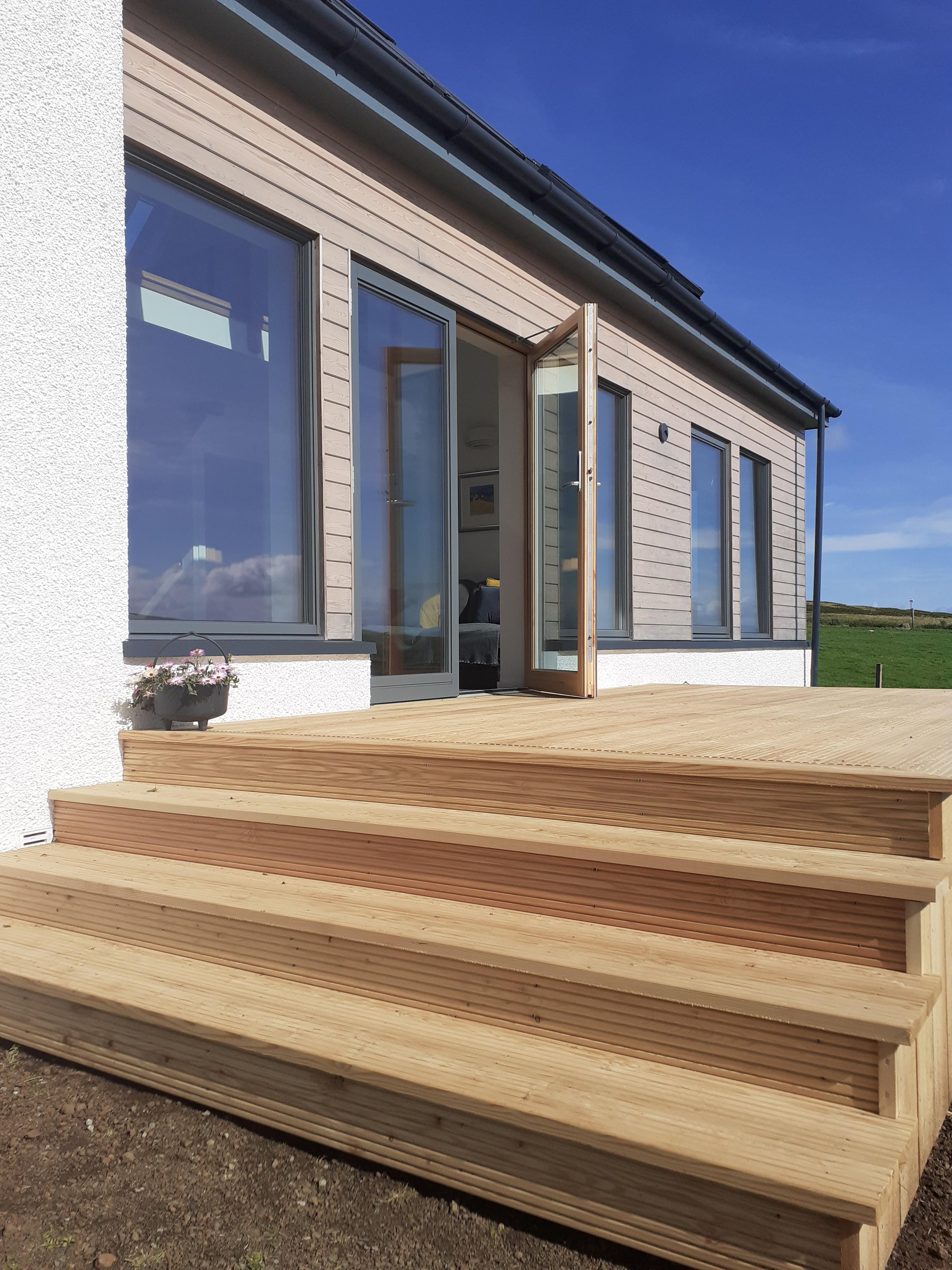

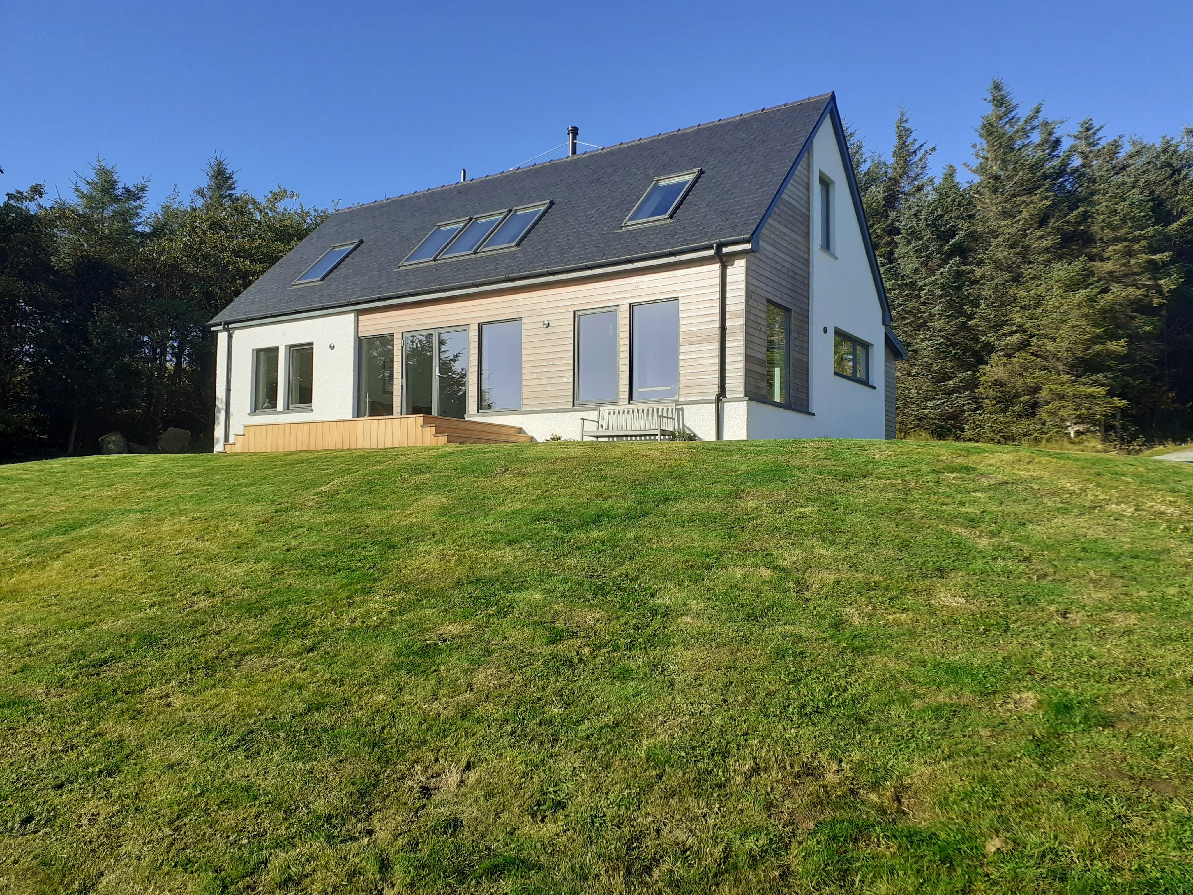

Reflection/Garden
It's been over a year since we finished our home and I thought it would be good time to reflect. We have not had any major snagging issues with the house. The only product which required some additional work was the LVT flooring, we found thermal expansion was causing some warping. This has since been resolved with the addition of two expansion joints.  In my last blog post I discussed how we were heating the house with just a wood stove during colder times of the year. I

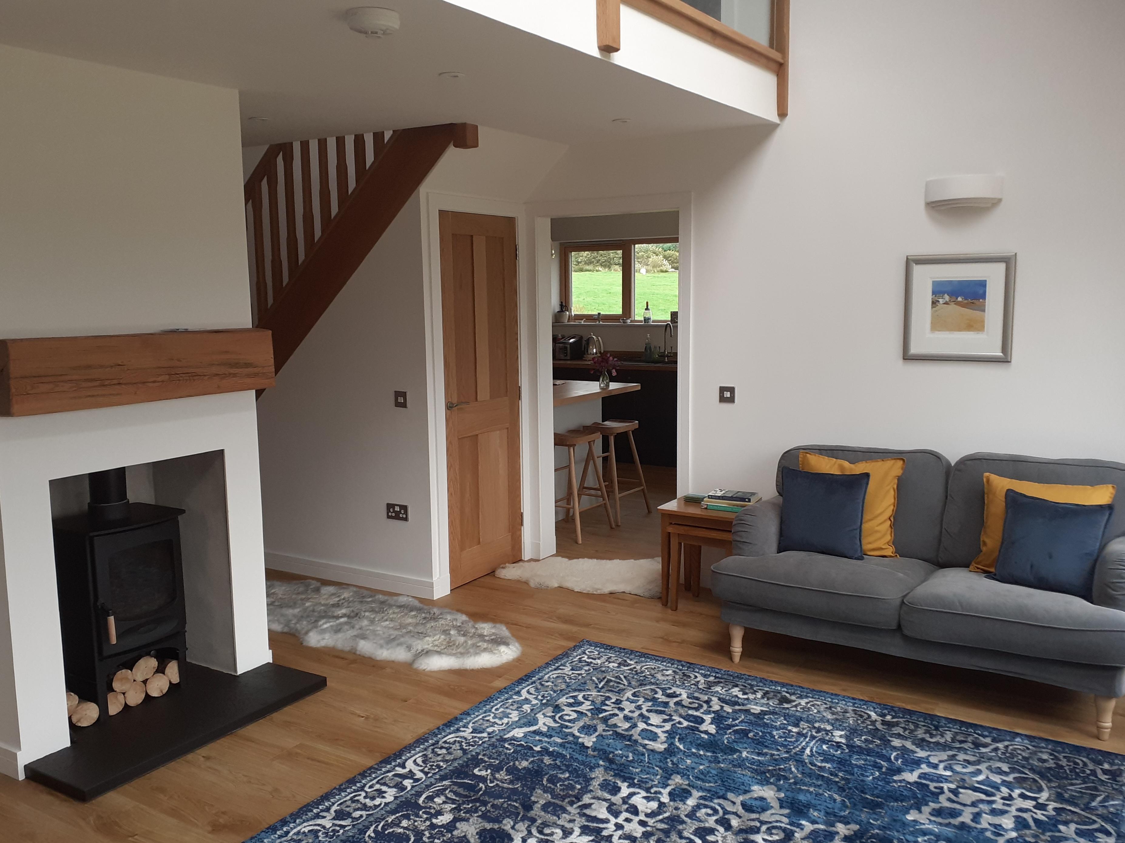

Finished interior
We had our final inspection yesterday and building control were happy with the house. Just awaiting on an EPC certificate and we should have our completion certificate next week. We had a little tidy up before the inspector arrived so probably the ideal time to upload a few pictures.
