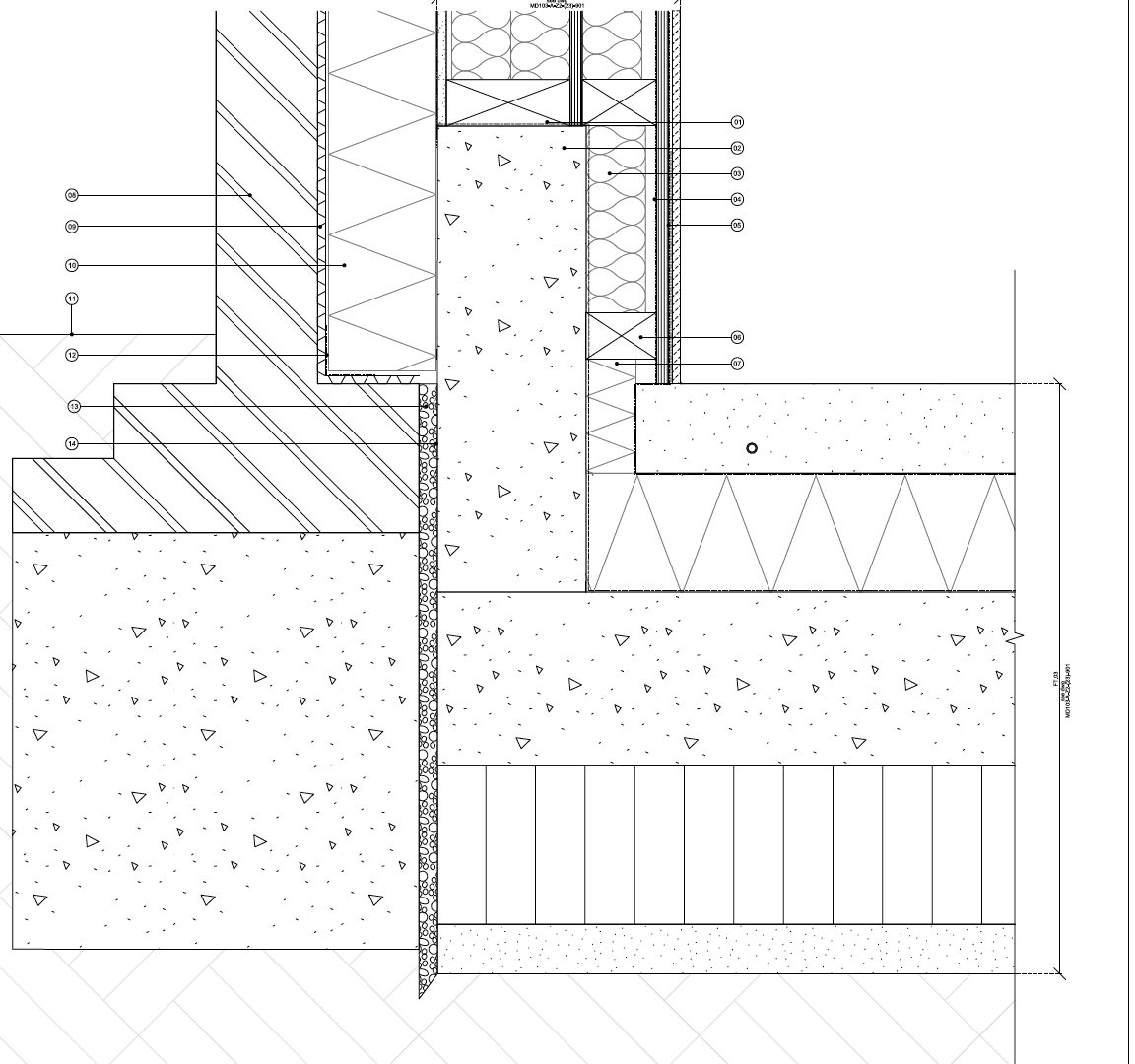

We are also planning to build (in tender stage at the moment) timber frame with polished concrete floor. Our architect designed with the concrete upstand on slab all around so that  concrete screed meets concrete upstand.  I guess its too late to install the concrete upstand?
