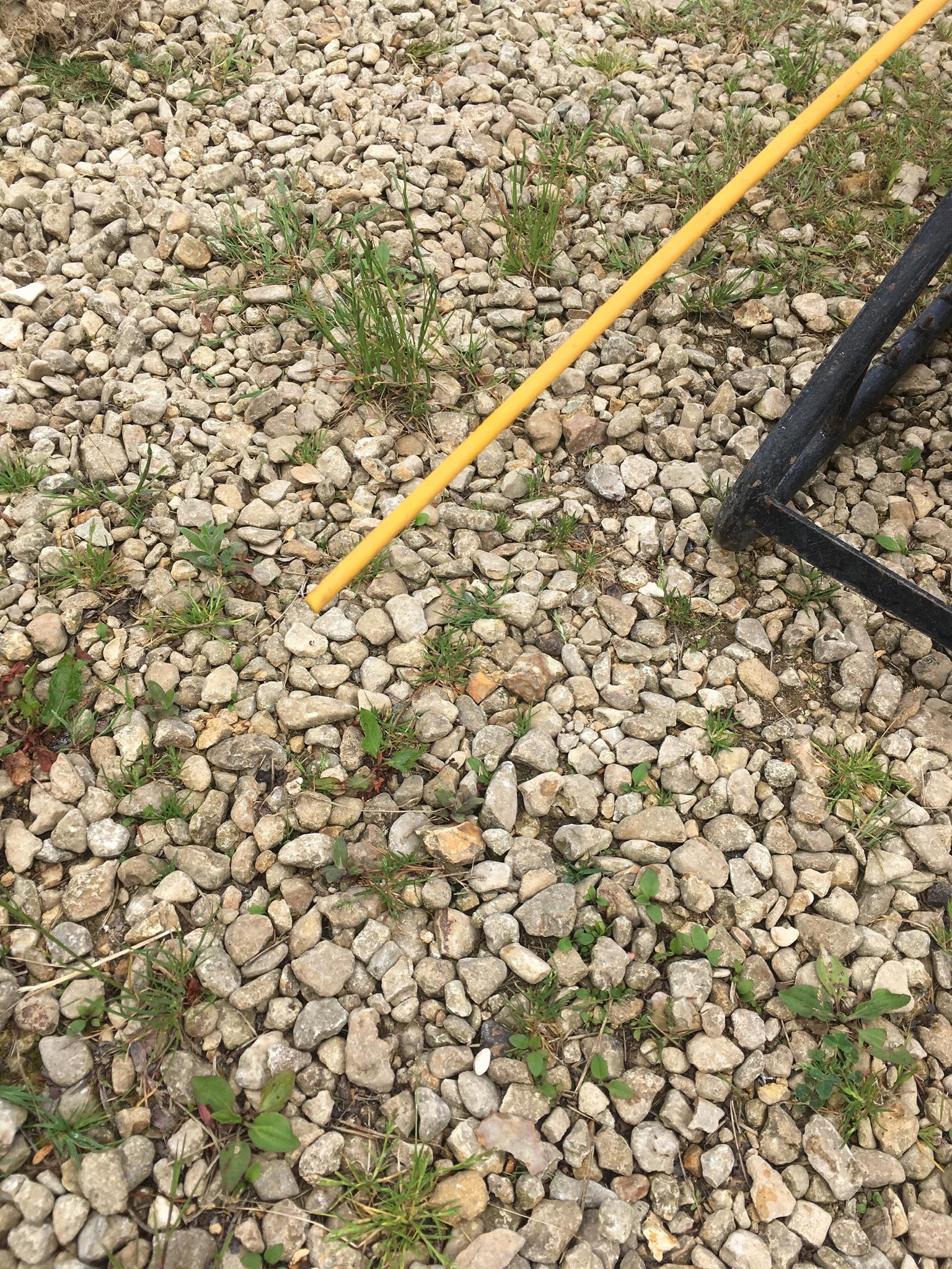

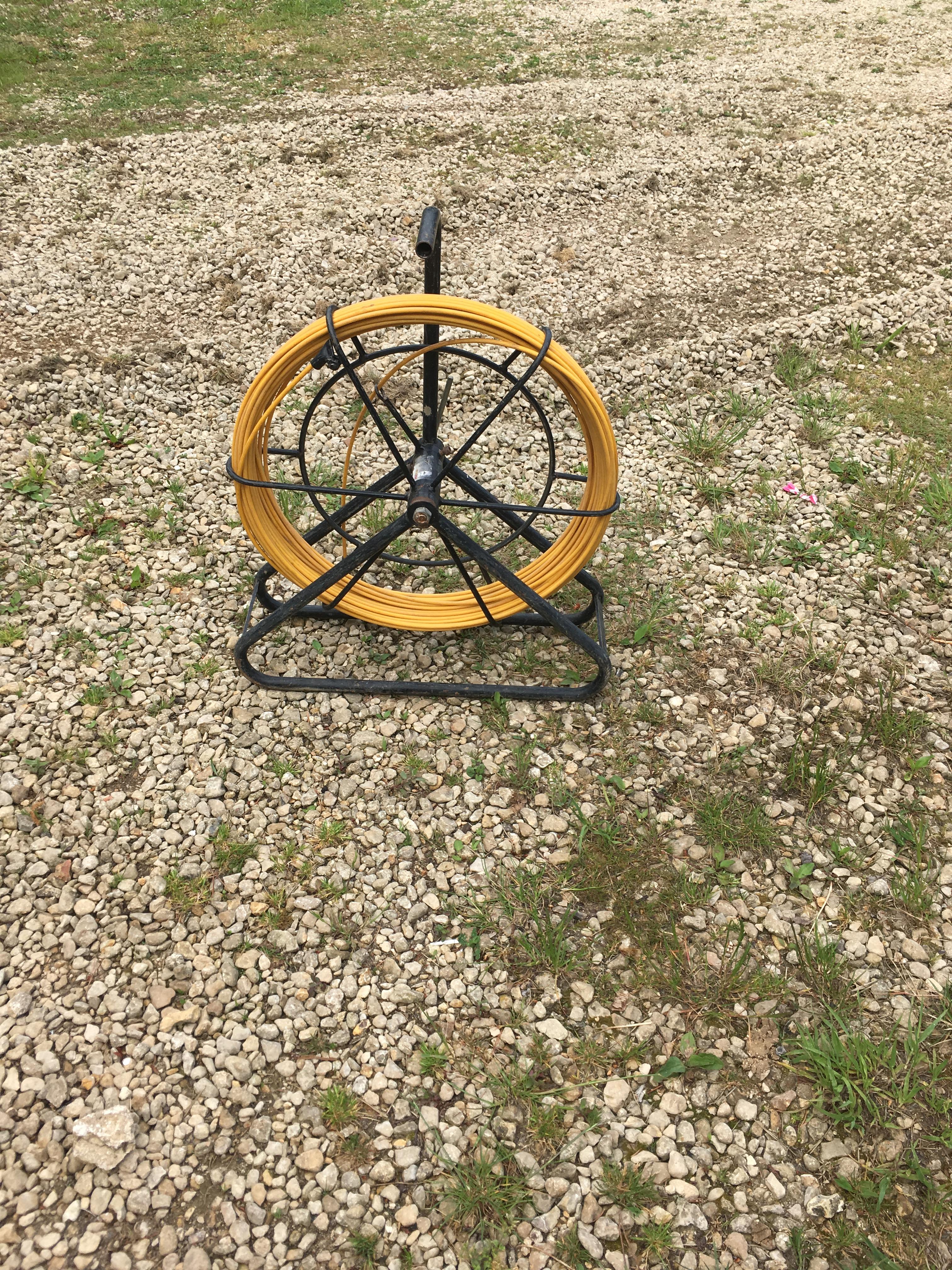

3 minutes ago, Russell griffiths said:
I new one of you would know.
Thanks @JSHarris  ??
No problem.  When you come to fit the new brass threaded collar on to the broken end of the Cobra, just clean the broken end up, cut it square at the tip and clean and lightly abrade it.  The brass bit is just glued on with superglue usually, the slightly thickened version is best.  The various tools for pulling cables, clearing rubbish from ducts etc, just screw on to the brass collar.
