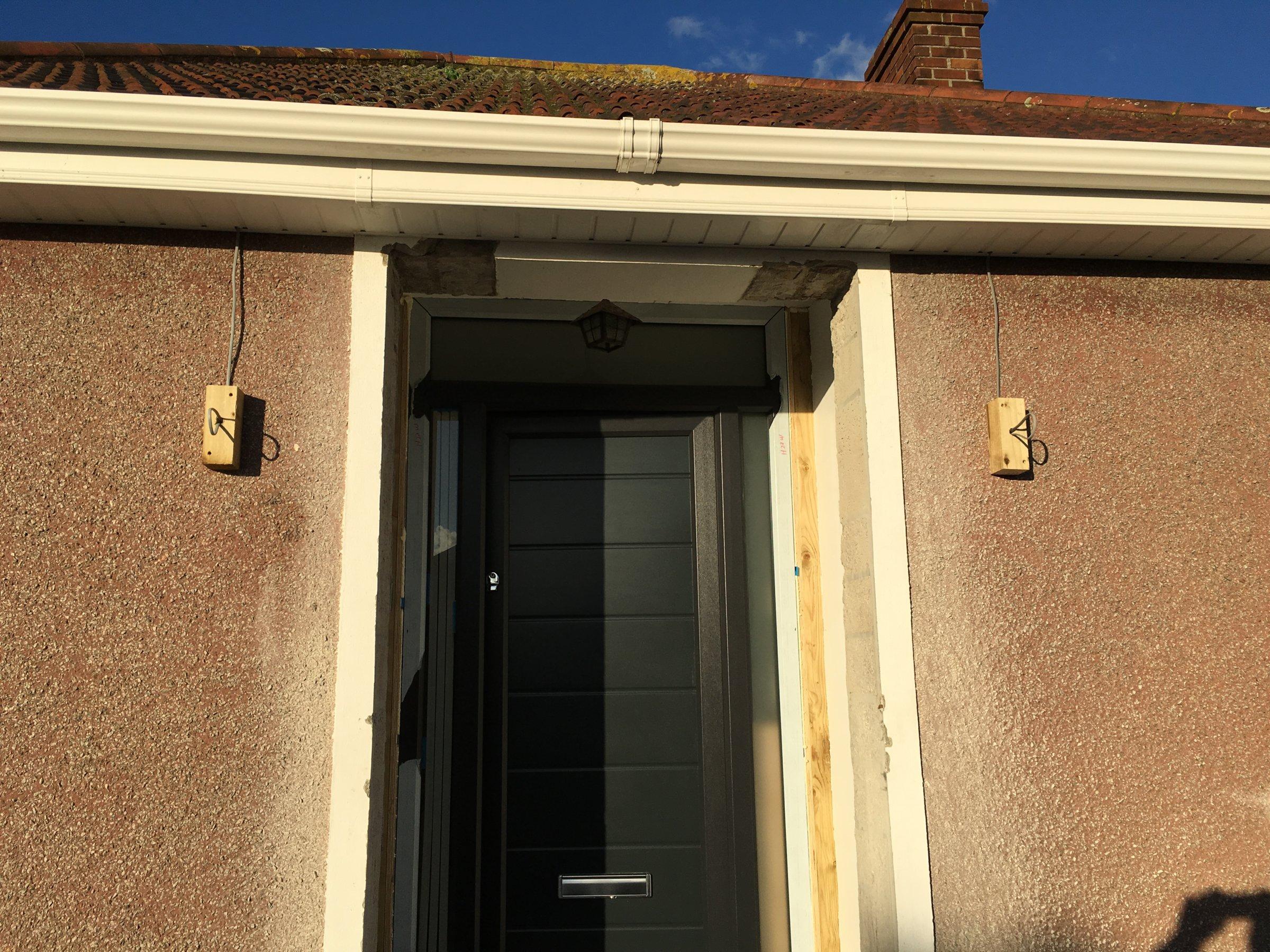

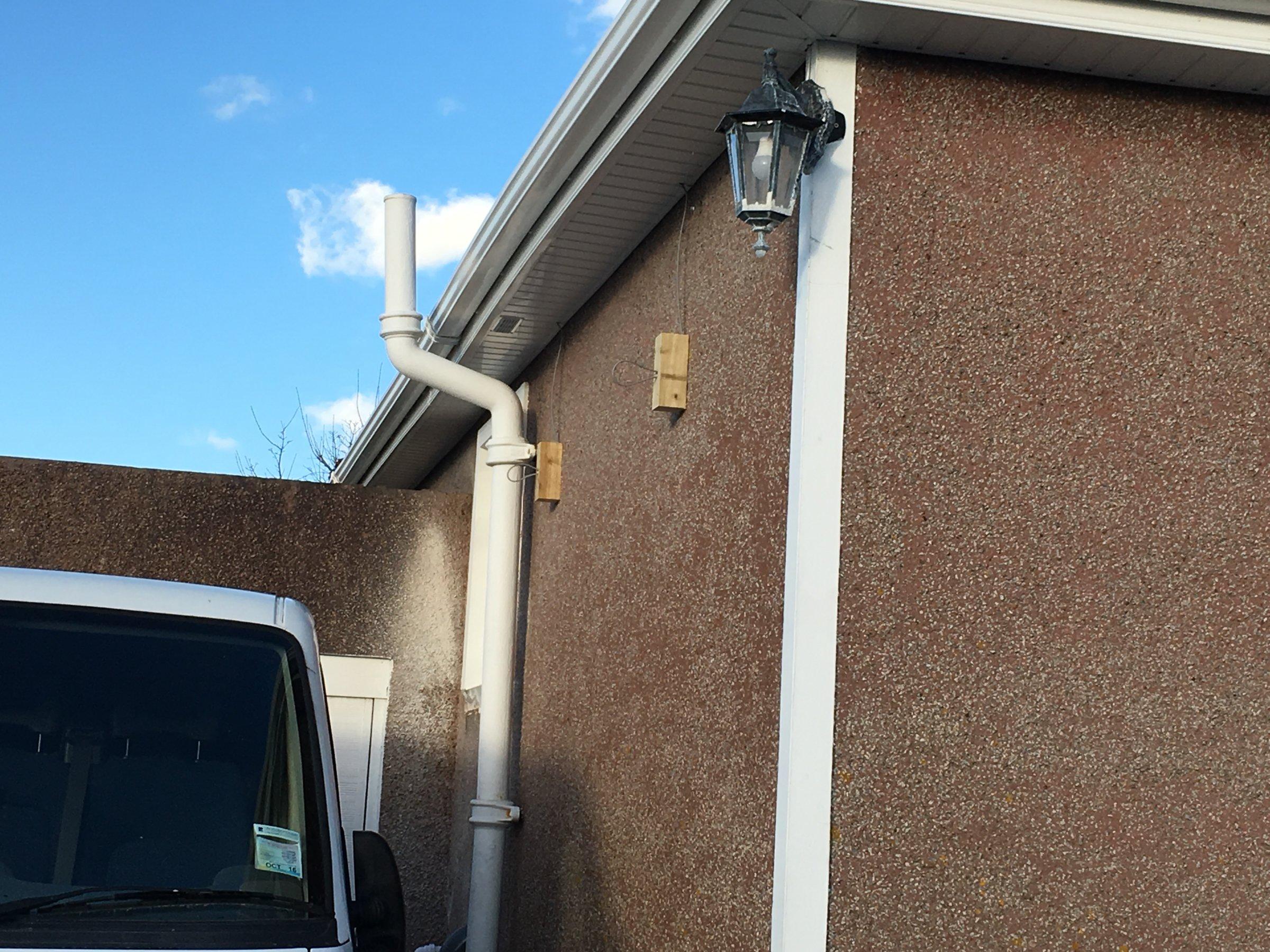

Let's say, 'someone' didn't know about the risks at the time, and the EWI installer didn't mention it before going ahead.... Is there a likely timeline before it causes an expensive issue?!

Well this is my situation.... the cables aren't ever likely to move now, and are behind about 90mm of EPS.  So also difficult to replace!
(Sorry for the thread hi-jack!)
