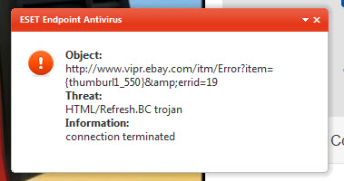

Barney12 Posted September 6, 2016 Share Posted September 6, 2016 (edited) P.S. No idea why also but that first link causes my AntiVrius to kick in: Edited September 6, 2016 by Barney12 Link to comment Share on other sites More sharing options...
PeterW Posted September 6, 2016 Share Posted September 6, 2016 It is odd as that link is the one directly from the app using share this item..! Link to comment Share on other sites More sharing options...
