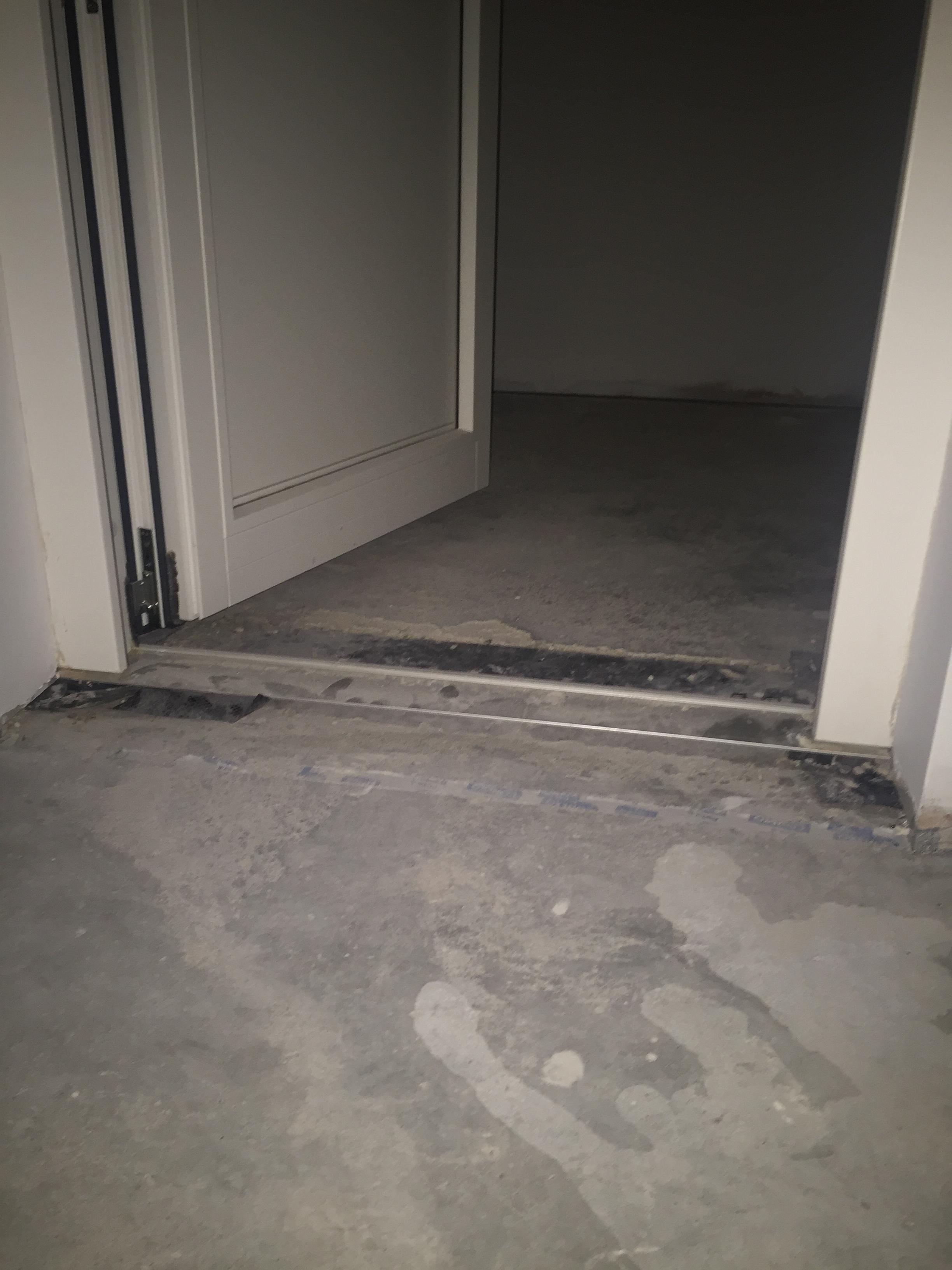

Weebles Posted May 22, 2019 Share Posted May 22, 2019 Noticed a small problem tonight. Our larder door has been fitted as requested with a 20mm gap under it (20mm gap to allow for floor tiles). But it is an external door (the larder is outside the passive envelope) and the door hasn’t been sealed against the floor/threshold . It’s basically a gap of 20mm letting outside air in (our air test was done with a temporary door in place). Our floor tiler is coming on Friday. So this problem is a bit pressing. How shall we fill this gap? We are passive standard (but not getting certified). Any advice welcomed. thank you. Link to comment Share on other sites More sharing options...
craig Posted May 22, 2019 Share Posted May 22, 2019 TP600, 30mm width with expansion of 13mm to 24mm will do the job. 1 Link to comment Share on other sites More sharing options...
Weebles Posted May 22, 2019 Author Share Posted May 22, 2019 Thanks @craig. I have messaged our fitter to see if he happens to have a short length lying around. if he hasn’t, given our time frame, is there anything else we can do? Link to comment Share on other sites More sharing options...
PeterW Posted May 22, 2019 Share Posted May 22, 2019 Expanding foam... or pack it with sand and cement made from a damp mix of sand and rapid set. 1 Link to comment Share on other sites More sharing options...
craig Posted May 22, 2019 Share Posted May 22, 2019 Let me check if I have anything in the office, might only be 15mm 7/12 that I have but can be doubled up. 1 Link to comment Share on other sites More sharing options...
scottishjohn Posted May 23, 2019 Share Posted May 23, 2019 just a suggestion tile right under the door ?- then a fix a sealed threshold plate, if needed to tiles ? Link to comment Share on other sites More sharing options...
Weebles Posted May 25, 2019 Author Share Posted May 25, 2019 Put in some compriband in. Hopefully that will do the job. Thanks everyone. Link to comment Share on other sites More sharing options...
