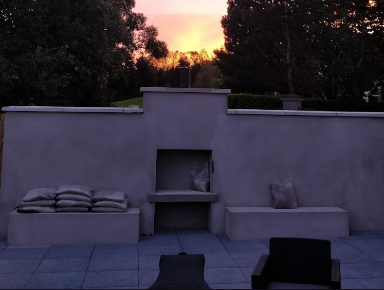

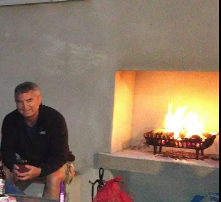

JohnW Posted May 22, 2019 Posted May 22, 2019 Hi, We had an outdoor fireplace constructed and lit it for the 1st time last weekend. It was a roaring success (if you pardon the pun!). I'm concerned that the plastered walls won't stand the test of time and intensity of heat and was wondering if anyone could recommend a suitable material to line the internal walls to give it some protection from the heat. Thanks

PeterW Posted May 22, 2019 Posted May 22, 2019 You could use a steel or cast fire back - they would look pretty good and easy to procure. They need a 25mm stand off to stop the plaster scorching. 1
JohnW Posted May 23, 2019 Author Posted May 23, 2019 Thanks @SiBee, I've been advised that vermiculite absorbs moisture and is therefore not suitable for an outdoor fireplace. Thanks @PeterW, I like the sound of lining it with steel. I guess I could make small brackets that would give me the 25mm buffer zone off the wall on each side.
SiBee Posted May 23, 2019 Posted May 23, 2019 When the metal rusts though, will this not cause nasty staining on the surrounding surfaces?
