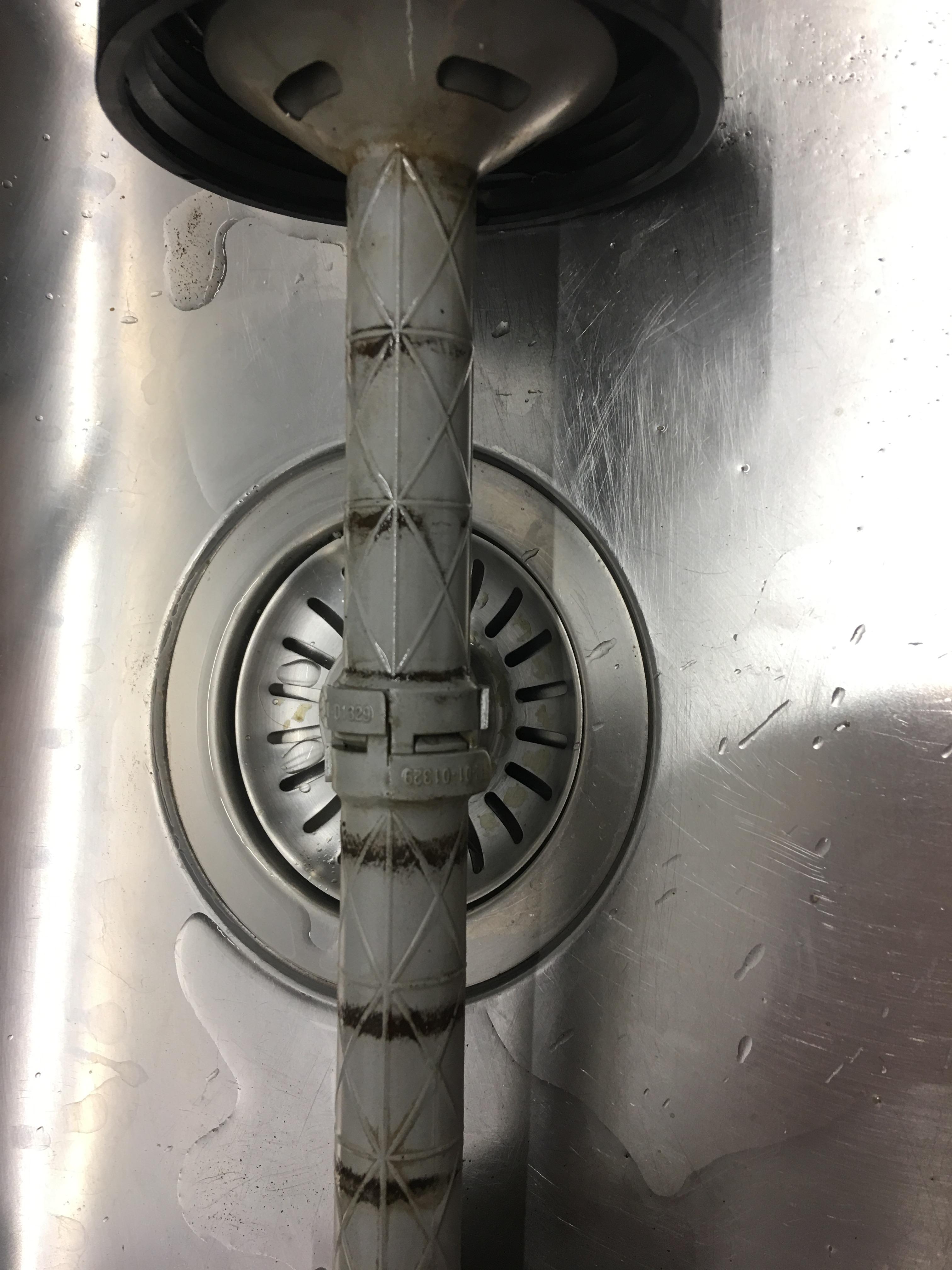

lizzie Posted April 23, 2019 Posted April 23, 2019 I have one of those magna clean things on my boiler. (Mains gas boiler running ufh and dhw). Man came to service boiler today and did Magna too. He said one of the cleanest he has ever seen even though ufh produces less than rads its still very clean........I am pleased!!
newhome Posted April 23, 2019 Posted April 23, 2019 I have one too and was surprised that when I took it apart to clean it there was pretty much nothing to clean.
