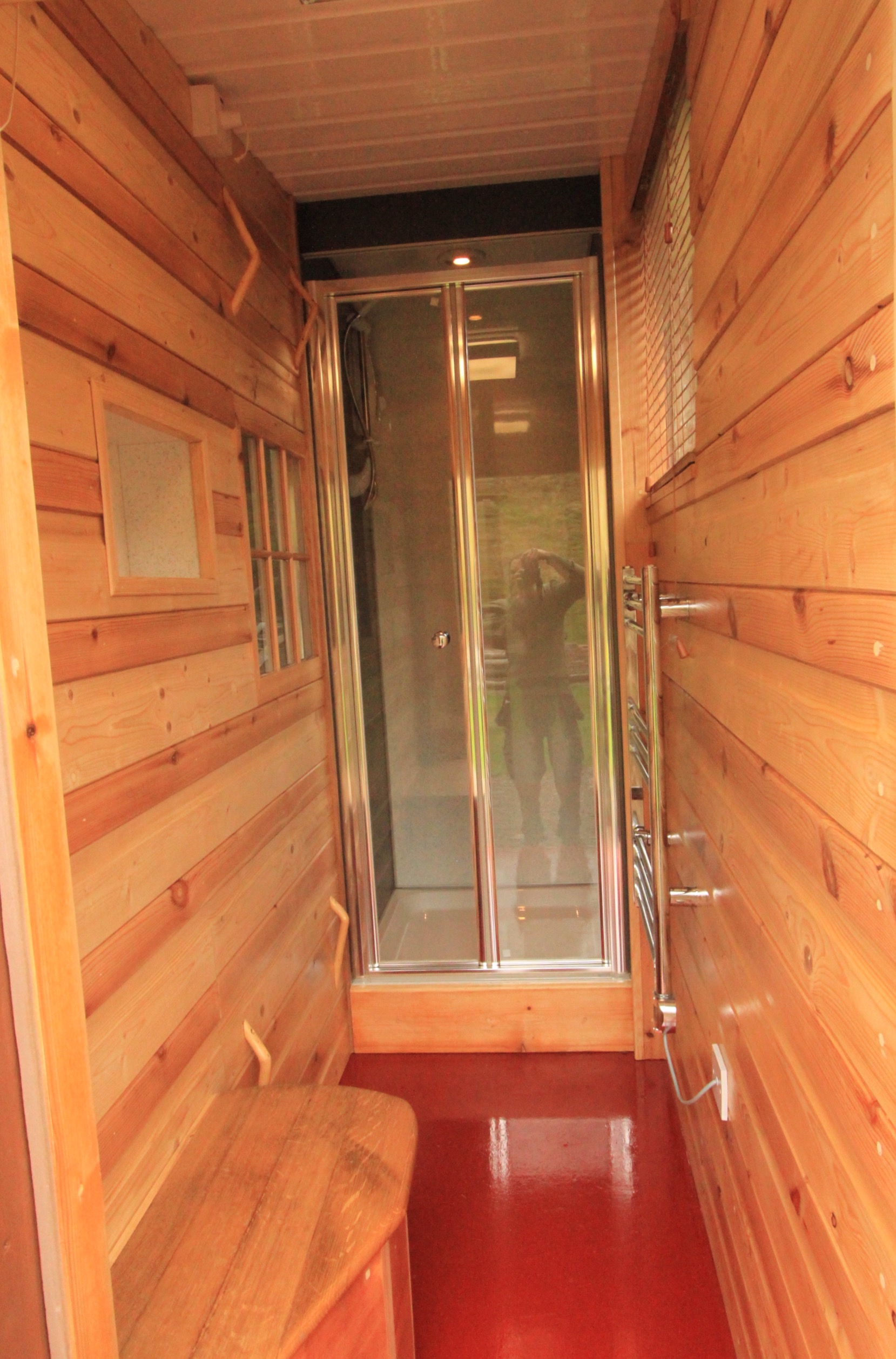

Cpd Posted August 25, 2016 Share Posted August 25, 2016 We have volunteer accommodation which works well, however i am in the process of upgrading the washing facilities. For ease and speed i am considering an all in one shower "pod" rather than re doing the shower area from scratch. The area available is max 900mm wide and over 2.3m heigh ( need to check measurements) surrounded by bare timber frame and a good timber floor. There is water power and waste pipe in place. However having looked into the self contained shower "pods" i am somewhat unhappy with the choices and there respective costs. The pod needs to be able to take an electric shower, have a front opening door and fit through a narrow door to be constructed...... After lots of Googal work i came up with. Kinedo Consort (Delta) Self‑Contained shower cubicle £380 cheapest plastic option Kubex Kingston All-In-One Sealed Shower Cubicle £660 more what i am after Now my question is for £660 am i better of buying a shower tray ( with up stands) Wall board and edge / corner fixings Door and other " bits" i am into doing things right but this is a rustic location and i want to keep it in perspective. I and my ever helpful though ageing farther are capable at advanced DIY if you call it that but i was looking to prioritise my time to other jobs, hence the pod idea. Your thoughts or experience would be welcome. Link to comment Share on other sites More sharing options...

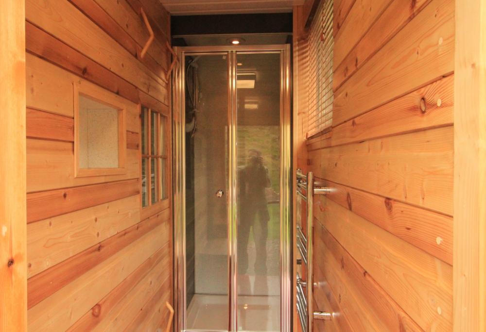

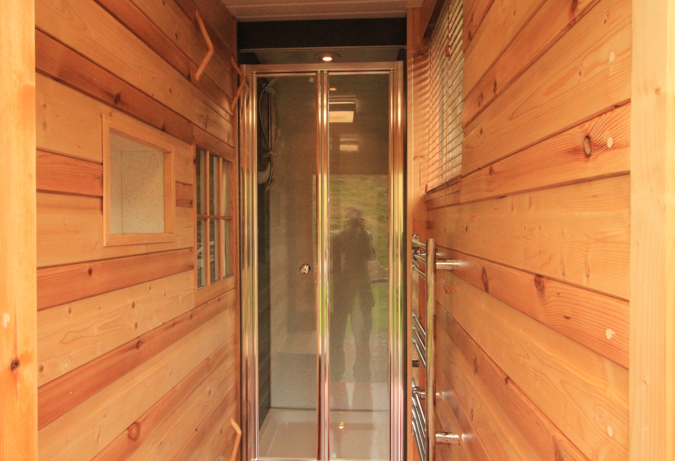

Cpd Posted April 20, 2017 Author Share Posted April 20, 2017 Well this is just an update.... shower pod or propper job. This was all done as cheep as reasonable so it took some time to acquire all the materials. Total price including all insulation and materials was about £700, Triton shower, Coram shower tray, vent axia vent and light. Its essentially a shower built on top of a towbar of a caravan....... hence only 900mm to play with and its going to be awkward to hitch it back up...... L 2 Link to comment Share on other sites More sharing options...
