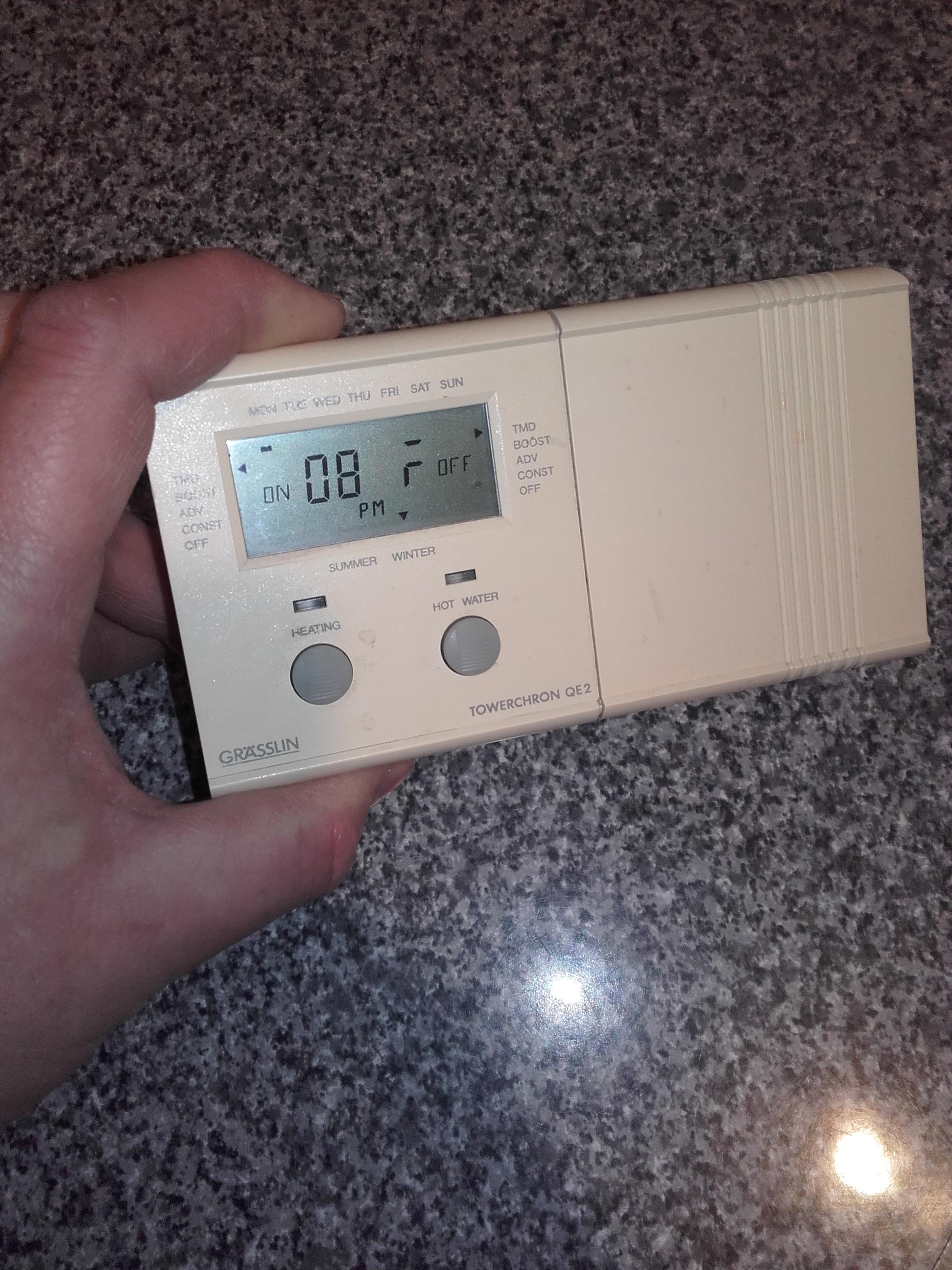

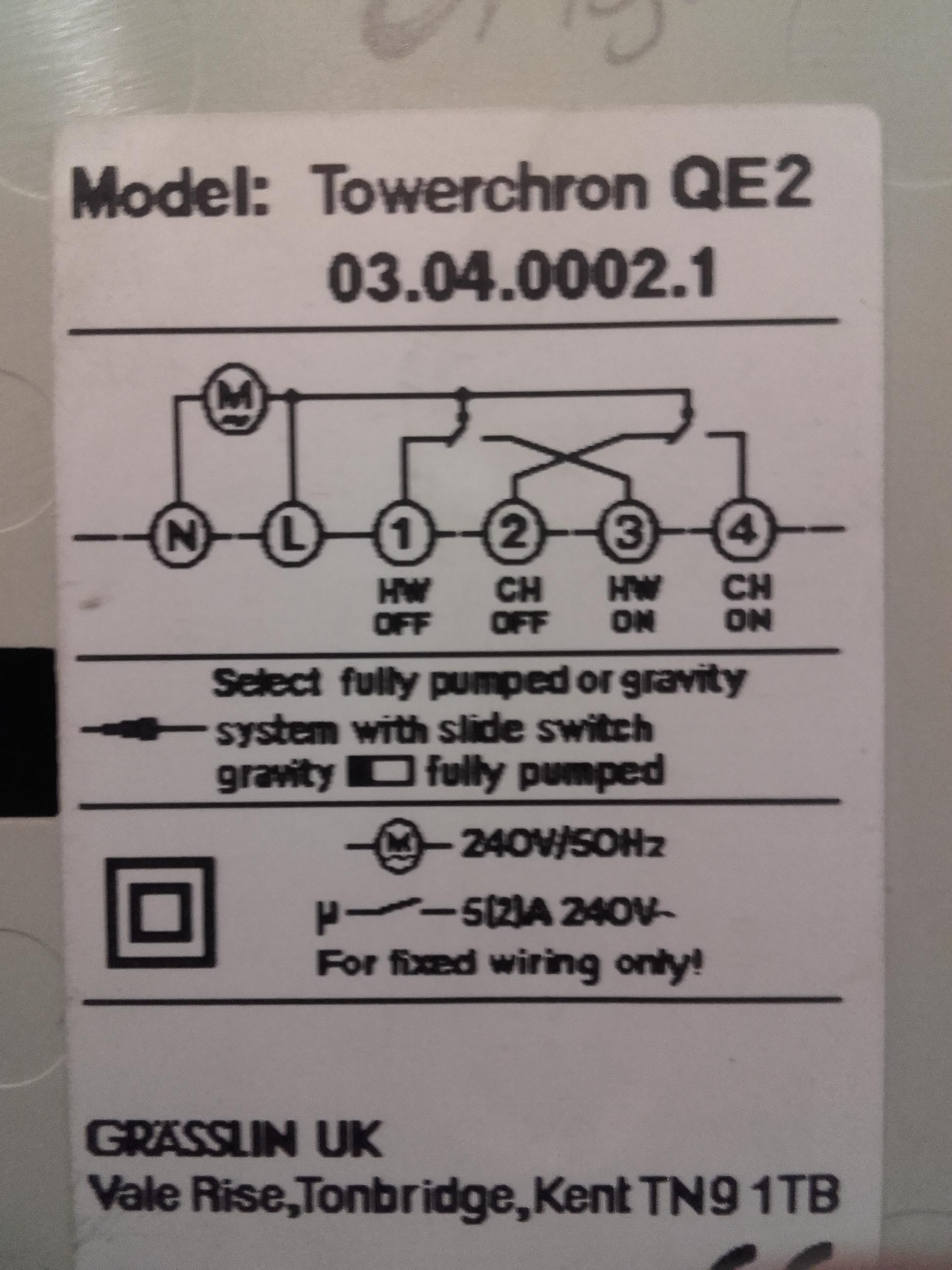

Onoff Posted February 26, 2019 Posted February 26, 2019 (edited) Came downstairs this morning to find the place uncomfortably warm. Downstairs CH had been on all night. The controller seems to be at fault. The LCD display has gone all squiffy and locked. I can press either of the grey buttons and nothing changes: Didn't have time to do anything other than whip it off the wall and tape over the connection plate then leave SWMBO a note. Taken it to work with me so I'll whip the cover off and see if there's a replaceable battery in there. Can't honestly remember if I've ever done this before, vague recollections maybe... I'll also chuck a meter on it and see if the relay has failed and is constantly calling on 4: Still, it's over 20 years old so has done well. Surprised it fails "on" though. This one does downstairs CH and HW. Worst case tonight I swap it out for the same controller above that just does upstairs CH. Was debating renewing with a 3 channel controller maybe, that'll do 2x CH & 1x HW. Any suggestions on a make? Edited February 26, 2019 by Onoff 3 to 4
PeterW Posted February 26, 2019 Posted February 26, 2019 Before consigning it to the grave, you did just try and take it off then put it back on the back plate after 30 seconds. ..? This sometimes clears them.

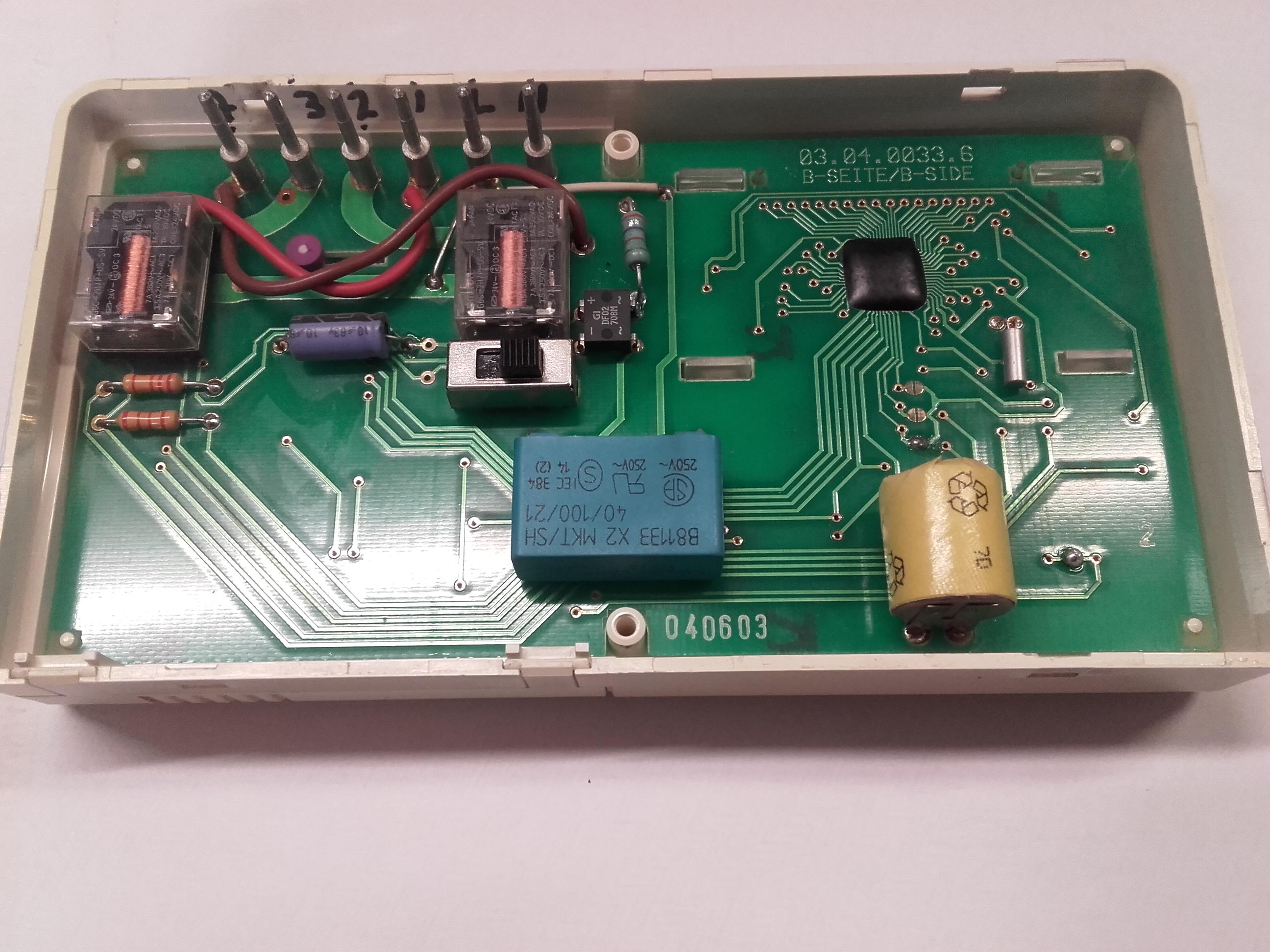

Onoff Posted February 26, 2019 Author Posted February 26, 2019 13 minutes ago, PeterW said: Before consigning it to the grave, you did just try and take it off then put it back on the back plate after 30 seconds. ..? This sometimes clears them. Yep did try. Had the back off. Nothing obvious. No idea on the soldered in battery other than it's yellow and has "70" written on it. At rest the pinouts seem correct. 1&2 are NC and 3&4 are NO with respect to L. Relays are obsolete, Omron G6C-2117P-US-SV. Just poked the reset button under the cover and it's come right. Wonder why, never happened before...battery? I'll slap it back on tonight and setup the times again.

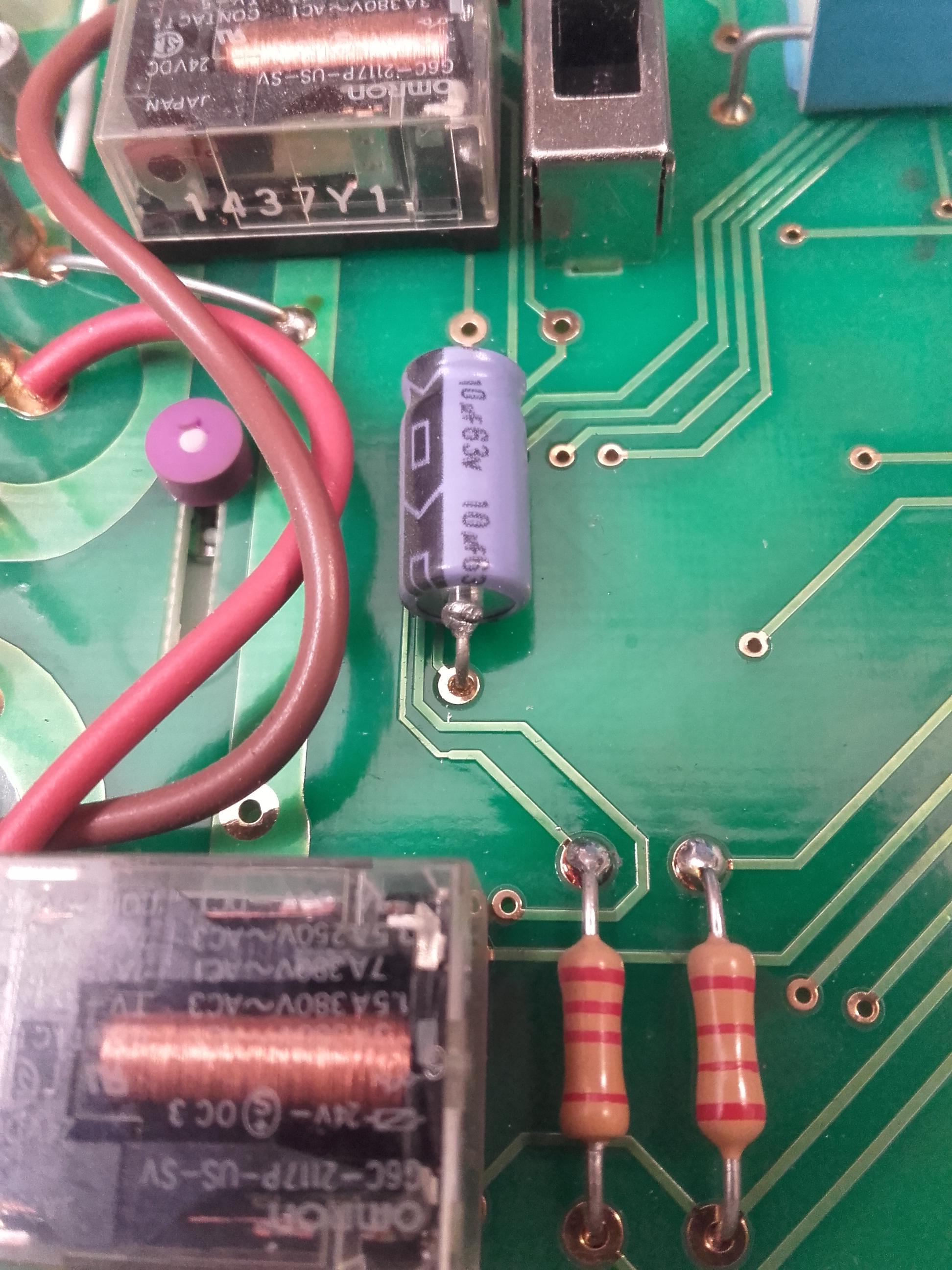

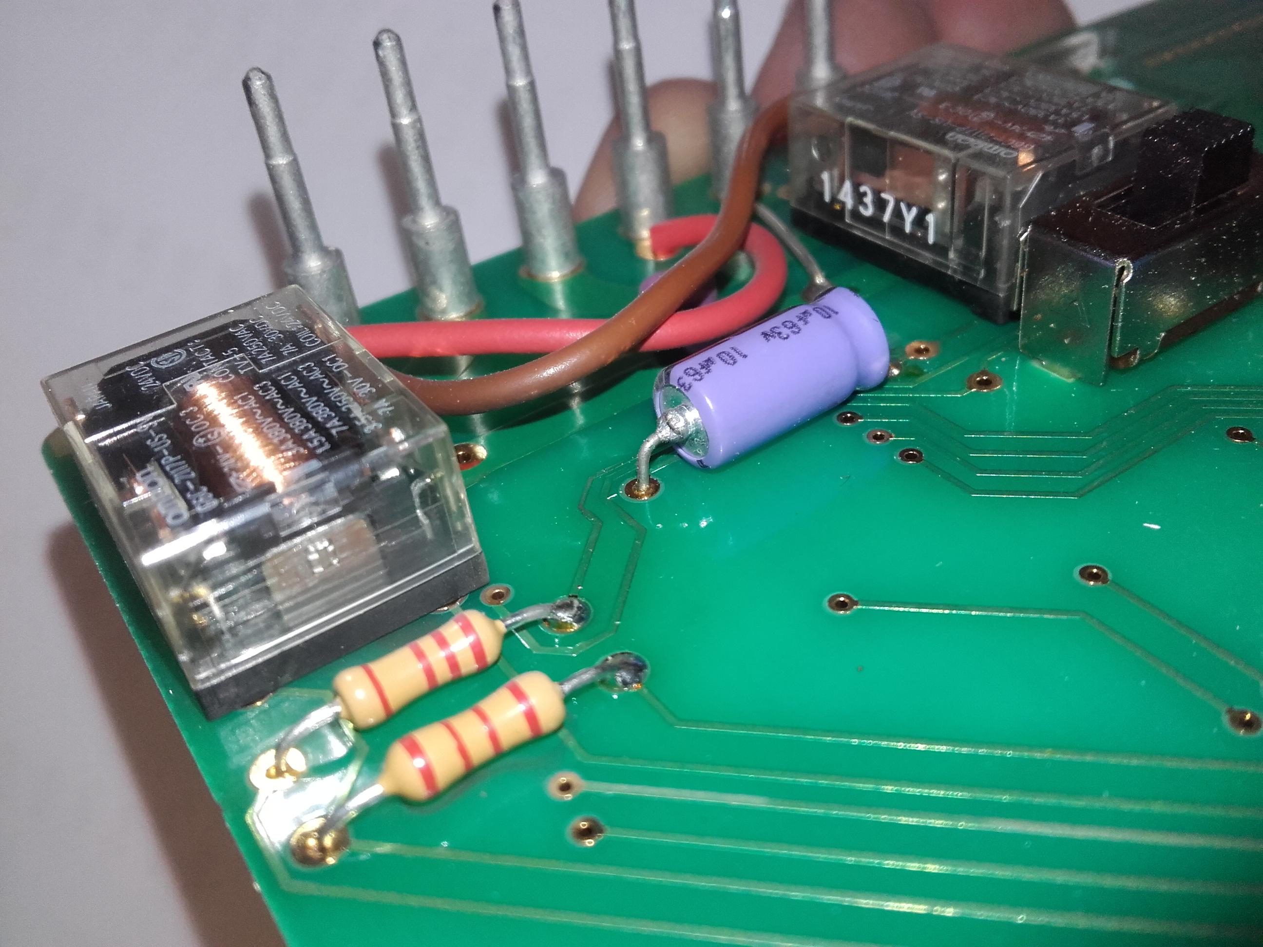

Jeremy Harris Posted February 26, 2019 Posted February 26, 2019 At ~20 years old the chances are that the 10µF 63 V electrolytic capacitor, between the relays, may have dried out and caused ripple on the supply. I had this happen on an old time switch about 4 or 5 years ago, and just replacing the capacitor fixed it. The life of capacitors like this is around 10 years or so, so it's done pretty well to last this long. 1
Onoff Posted February 26, 2019 Author Posted February 26, 2019 (edited) 15 minutes ago, JSHarris said: At ~20 years old the chances are that the 10µF 63 V electrolytic capacitor, between the relays, may have dried out and caused ripple on the supply. I had this happen on an old time switch about 4 or 5 years ago, and just replacing the capacitor fixed it. The life of capacitors like this is around 10 years or so, so it's done pretty well to last this long. Will probably have one knocking about. I did think the - end looked a bit odd, like a crack in the factory solder where the lead joins the body: Looking closer I'd say that - and should be soldered to both sides of the board. This side, well it might be making contact with the copper track by there's hardly any flow through: Edited February 26, 2019 by Onoff
dpmiller Posted February 26, 2019 Posted February 26, 2019 the track holes are through-plated. cap does look dodgy tho... Might also be worth shorting the backup battery briefly as a full reset.
Onoff Posted March 8, 2019 Author Posted March 8, 2019 Update. The controller was "hanging" more often. Up until tonight I've been able to reset it then redo the time, date & settings. Came in just now to the downstairs heating off and couldn't reset the controller this time. Changed the electrolytic, new one apparently Panasonic brand. All appears to be working again. Thanks all, especially Jeremy. 1
