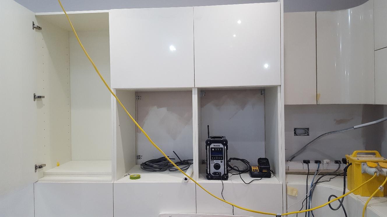

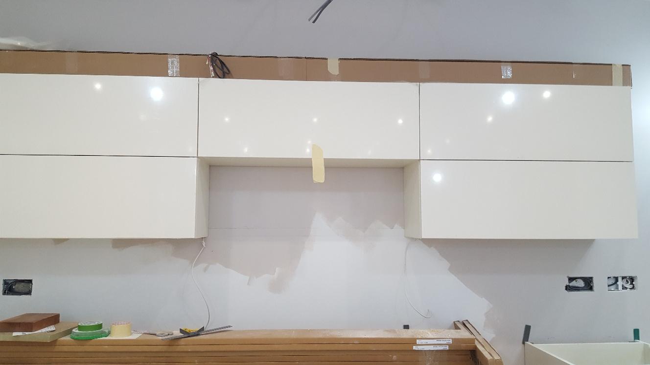

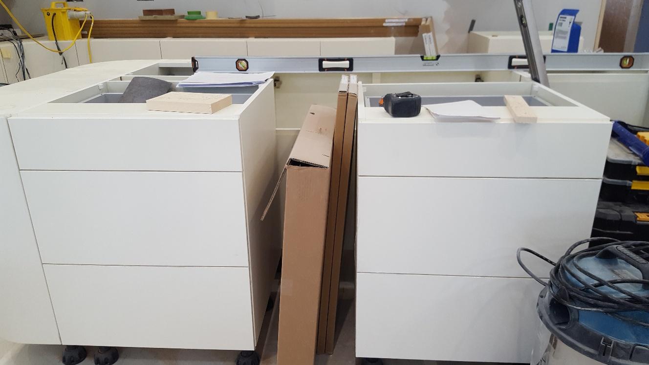

vivienz Posted February 12, 2019 Share Posted February 12, 2019 I recently posted on my blog that I was waiting for some extra end panels to arrive to insert between units for my kitchen, sourced from DIY Kitchens. @ultramods asked why this was and where they were going, so here's some detail. The first couple of locations are obvious when you see them, but as a novice kitchen orderer, I missed them at the time of the original one and had to add them on afterwards. These are bi-fold wall units with a top box straddling where the sink will be. There will be a plinth ( pelmet / cornice ) below the top box ( bridging unit ), but this still means that the inner edge of the bi-fold units either side have the external carcass exposed and whilst it's a reasonable colour match, it still looks like carcass against the gloss finish of the doors. A wall unit end panel will go on either side of the top box, giving an 18mm insert on the top section and a nicer looking, gloss finish on the inside of the bridge section. The next additional inserts are going into the island. I have a freestanding drinks cooler that will be going in there (they were out of stock at the time the rest of the kitchen arrived and will arrive in due course). The cooler is floor standing and the ventilation grille sits on the floor. Because of this, the run of the plinth will be interrupted and leave a not very pretty edge at the bottom. Again, to give a better finish, a base unit end panel will be added in on either side of the gap (leaving enough room for the appliance). Here's the start of the island and the location of the drinks cooler. Finally, I'm having two single ovens, side by side and at the level of the top of the base units. These come as standard oven housing units with pan drawers. In my current kitchen (old and very worn out now, not expensive in the first place) the sides of the built in oven get pretty mucky and it can bleed over slightly to the units/drawers either side of the oven door. For this reason, to the left of the left hand oven, a full length end panel will be inserted between the units to give some separation and an easy, wipe down clean for anything that escapes the oven over the course of time, rather than also having to clean the adjacent cupboard. Here are the oven units: Hopefully, this answers the blog query. 2 Link to comment Share on other sites More sharing options...
jonM Posted February 12, 2019 Share Posted February 12, 2019 1 hour ago, vivienz said: These are bi-fold wall units with a top box straddling where the sink will be. There will be a plinth below the top box, but this still means that the inner edge of the bi-fold units either side have the external carcass exposed and whilst it's a reasonable colour match, it still looks like carcass against the gloss finish of the doors. A wall unit end panel will go on either side of the top box, giving an 18mm insert on the top section and a nicer looking, gloss finish on the inside of the bridge section. Thanks - very helpful post. One thing to add is that if you are lining up base units with the bi-folds you will need to put end panels to the left and right of the appropriate base unit to ensure the base units stay in alignment with the bi-folds. You can use one end panel, cut it in two and put the halves either side of the appropriate base unit as the base unit will be covered by the worktop. 2 Link to comment Share on other sites More sharing options...
vivienz Posted February 12, 2019 Author Share Posted February 12, 2019 Good points, we are doing this but I forgot to mention it. Link to comment Share on other sites More sharing options...
